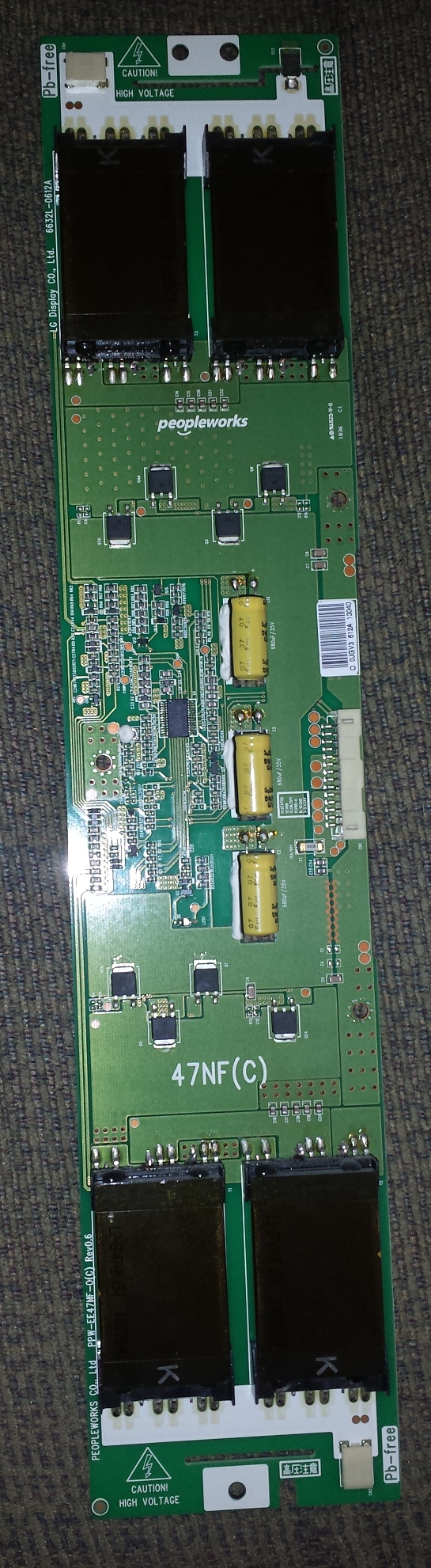

    During this time, the LED1 on the inverter (I think) will glow blue and fade out (approx. 3 seconds)

    Removed and visually inspected component for obvious heat or cap issues- none seen but not 100% sure I know what to look for

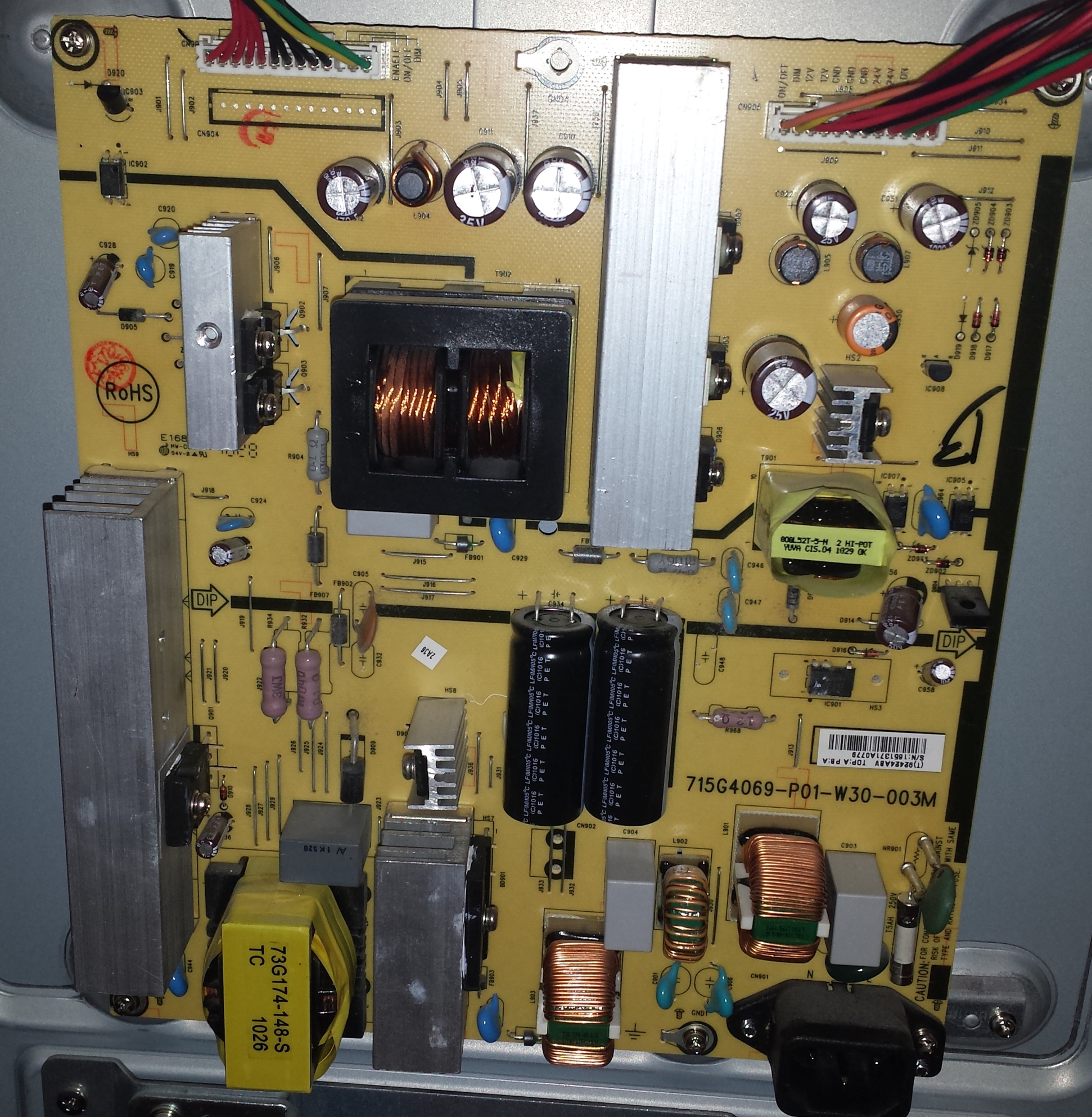

    CN903 to inverter
    TV in standby- no voltages on any
    TV On- 24volts, on/off=5v, DIM,3v
    CN905 to Main
    TV in Standby- 5v on 5v pins 11 and 12- no other power
    TV On- on/off=5v, DIM=3v, 12vOK, 24vOK, PS/ON=5v, 5vOK

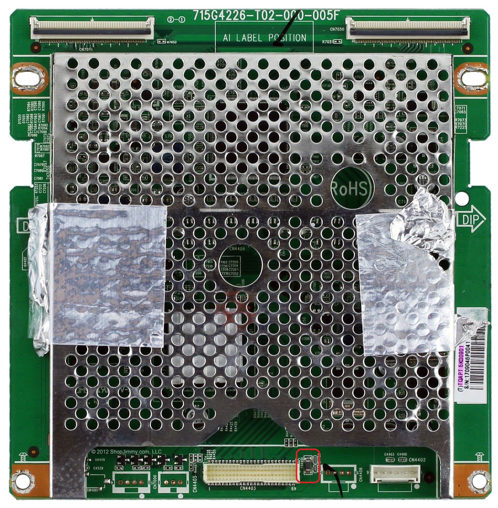

      I can check that. Any ideas what the voltages should look like going to the t-con? Nothing is marked
      • blackrifle71
        • Jul 2014
        • 11
        Re: VIZIO E470VA just glows black - Lots of details included
        also- this is the t-con I have
        http://www.shopjimmy.com/vizio-cbpft...1-pc-board.htm
          About 12VDC. How about the pictures of your T-CON, may be we can see something you are not seeing. Also try having just one cable between the LCD panel and the T-CON connected one at time to see what you get.

            The ones I looked at did not look like this, so I do not know if your fuse is marked F1 or where it is since I can't see through that shield
            I do see another heatsink under that shield, so if it has a BGA type chip under there, that could be a likely culprit

              That a PC board, that isn't a T-CON board. picture of your TV circuit board will help a lot.
                There are more than one version of this model, that is why it is important for us to see the pictures of YOUR TV.

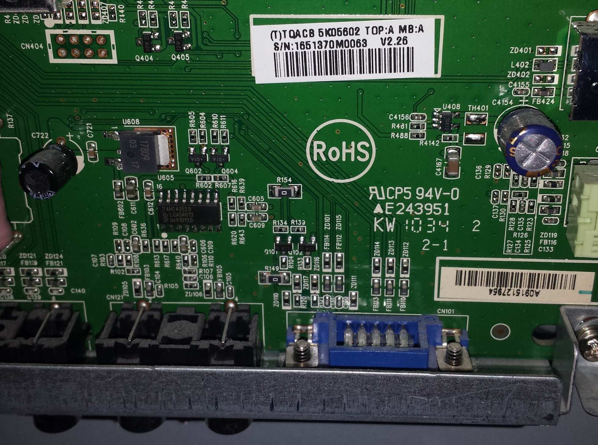

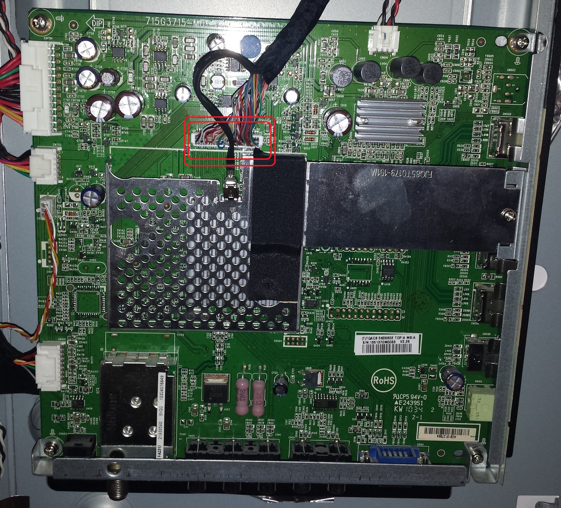

                  Sorry for the confusion- I am still learning what part is what
                  This is the pics I had on my phone. Let me know if I am missing a pic and I can have my wife take one from the house and send it to me. Still fuzzy on where the T-con is. Unless I need to dig deeper in the chassis. Thanks again- Dave
                    it is attached to the other end of the cable circled in red
                      The highlighted cable is patched into this:
                      Sorry, I am still waiting for photo of my actual board but the link is the exact model.
                        fuse is to the right of that main connector, circled on shopjimmys pic

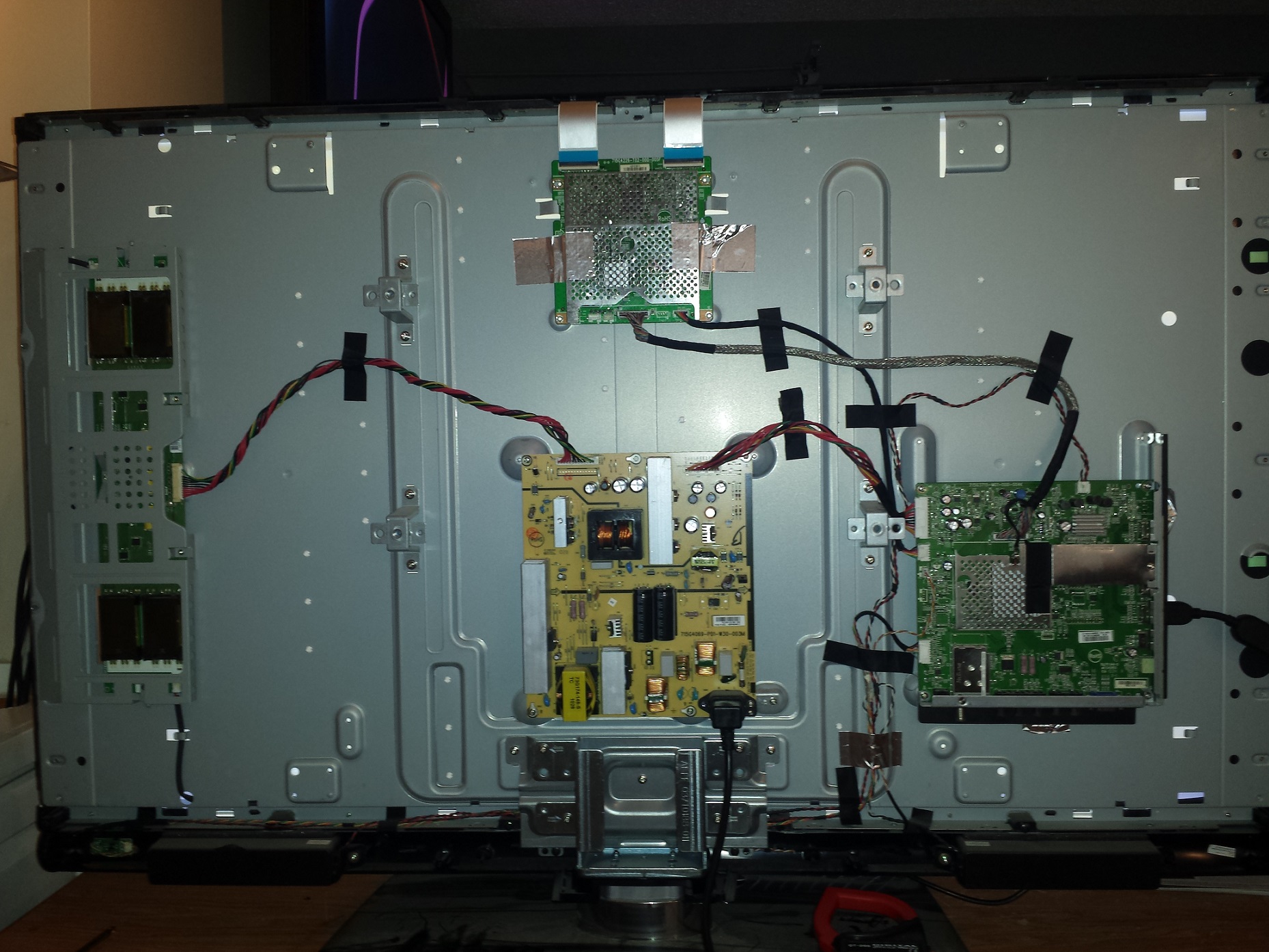

                              No pictures of the whole back side of the TV? That board looks to be for 60Hz/120Hz refresh rate processor.
                                Here is a pic of the back.
                                Caleb- the fuse is good and has continuity and voltage when on. Also, the little cable connector has power from the bigger board.
                                Budm- I did disconnect the ribbons one at a time with no change to the TV
                                  OK, it is down to either the main board or this processor board, you will need the scope to find out if the main board is sending the LVDS signals to the board or not, I lean toward this processor board being bad.
                                      The board I am talking about is the one that has two white flat ribbon connected on the Top which go to the panel.
                                      Without using the scope to see if there are signal present at the LVDS line to verify 100% for sure if the main board is bad or not, I have not seen many main board that failed to send ALL the LVDS signal and the sync signals to the T-CON board, it is possible though that can be main board problem. The main board is not cheap, the processor board is around $50.
                                      You can also contact shojimmy to see what they think. They may seen the common failure in this model and can give you suggestions.
