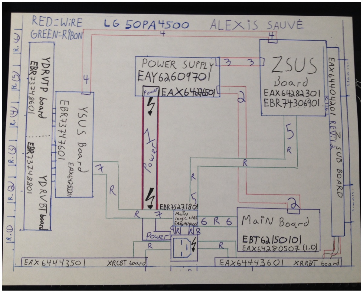

                  #48
                  Re: LG 50PA4500 Clicking troubleshooting HELP please...
                  How i can put a picture here? I did a schematic of the LG PA50PA4500 and i want to ask some questions. Thanks
                    #49
                    So here it is.
                    I can unplug any wire or ribon and the clicking noise does NOT stop. Clicking as soon i plug in it without pressing on any buton. Only way to stop the clicking noise is unplug the conection between point 2 to 2(power suply and main board) If my understanding is good i am supos to get 17v from ground to where is the blue wire but i get nothing. After that im kind of stock and don't know where to go. Hopefully someone is gonna be able to help me. Thanks guys!!
                    Alexis
