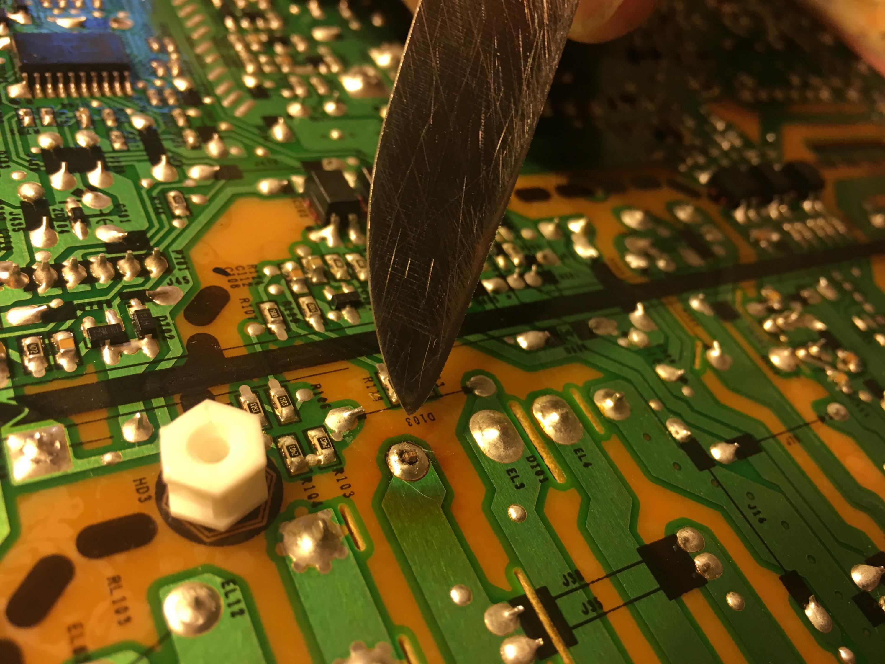

        Success! All credit goes to my father who I must give credit for this pretty impressive discovery. We replaced the C802 capacitor a few days ago to no avail. I was about ready to give up on this TV, but I asked my dad if there is anything else we can do with the power board. He inspects it and sees a spot of bad welding on the bottom of a transistor on the board. We clean it up as the metal on the pin had gotten dirty, and solder it as intended. Starts right up. Lets just hope it lasts :0.

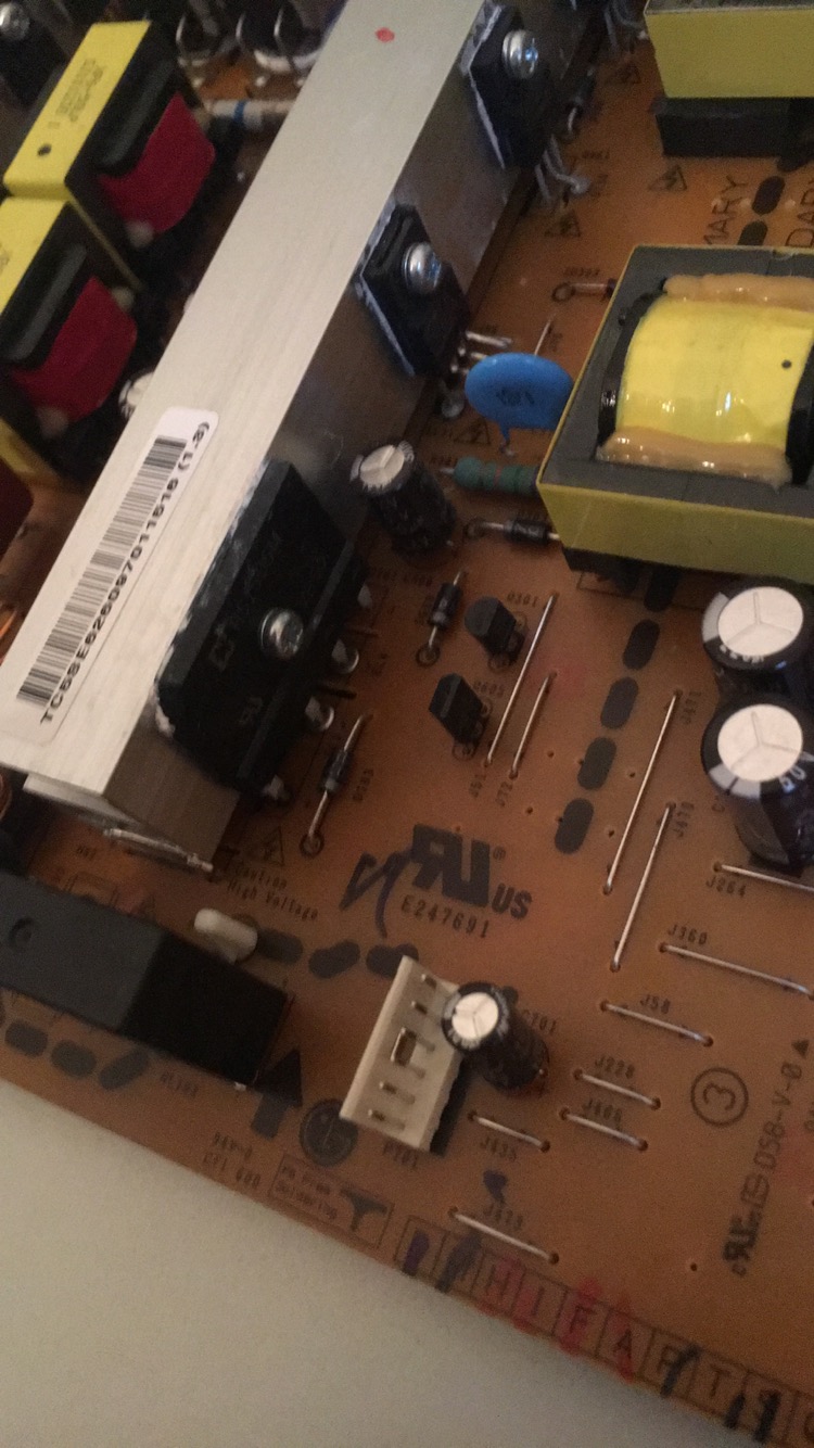

              Take a picture please close up and infocus of the bottom right of the powersupply
              Hi! I am BJ (new learning member) and have a similar problem. I change capacitor C802 although old one reading was at .o21uF. Did not solve problem and relay on PS board still clicking.
              So I did the test shorting pin 1 & 3 and relay click only ounce at power up and then stayed normal. This would tend to indicated an issue with PA/PK/PU/PD/PB23A EAX64696604(1.1) board... Any suggestion? Thanks in advance.

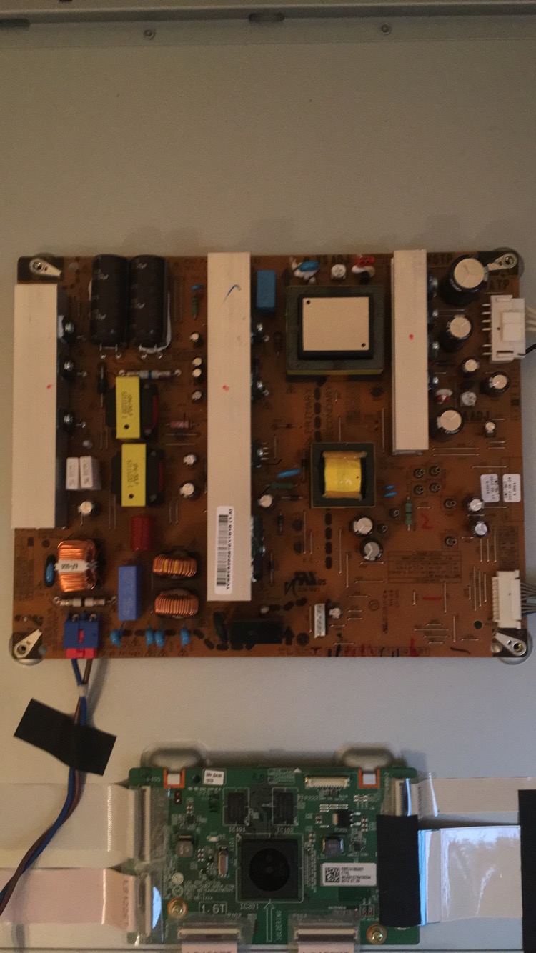

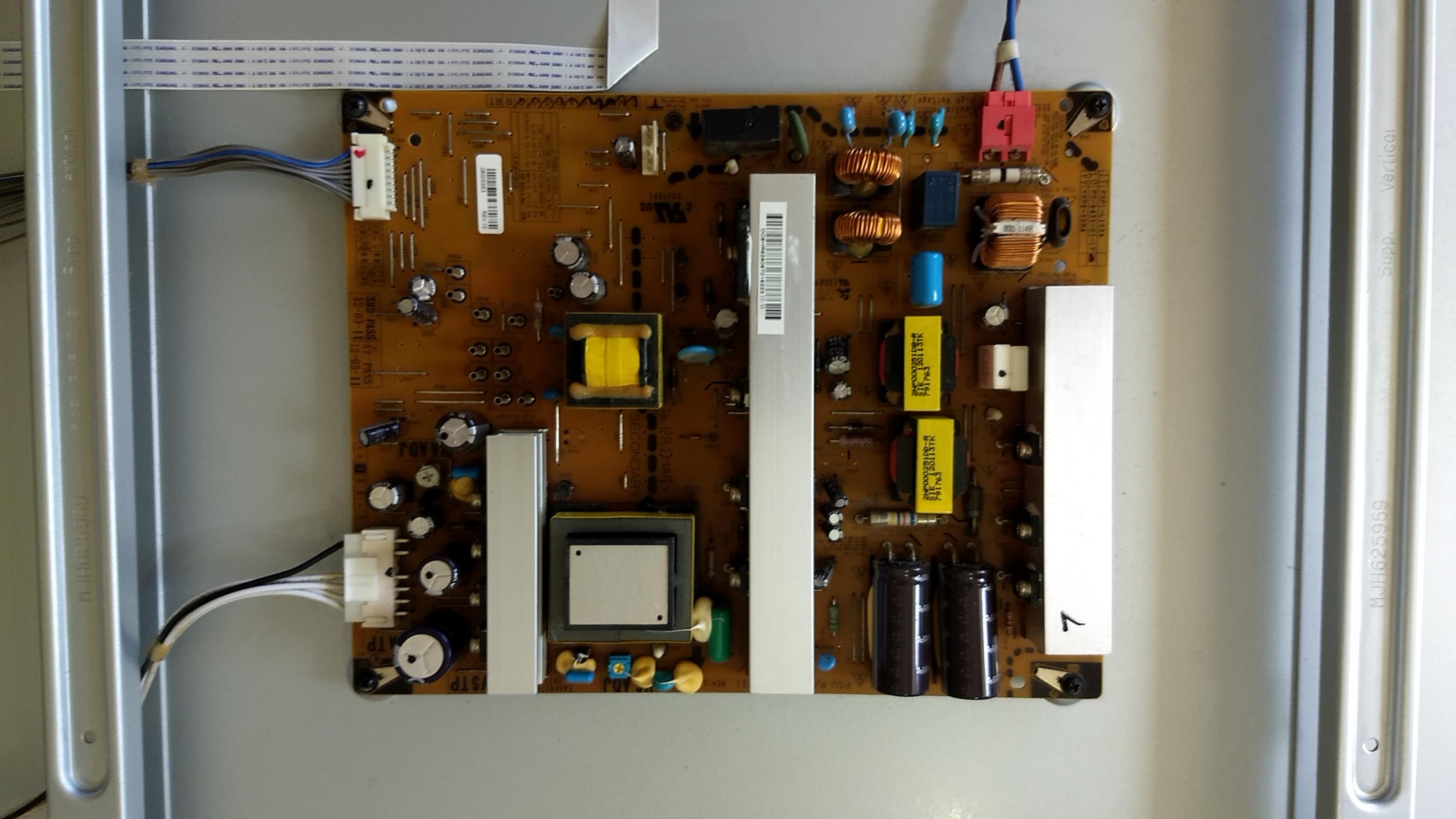

                  Hello, I also have a question regarding the TV 50pa4500, my model seems to be a little different, the power supply board isn't the same as the one described at this post.
                  Also, when I plug on the TV, I hear one click, followed by another click from the relay (the standby light is on). The same thing repeats after I try to turn the TV on.
                  I've opened the TV back panel and disconnected everything from the power supply board and started to connect each cable and wait out for the second click from the relay. So I first connected the cable that goes to the main board (bottom right), I just heard the first click, so I've powered off the TV and connected the cable that goes to the SUS boards (top right), but with the YSUS cable disconnected, I heard only the first click, so I've powered off the TV again and connected the YSUS cable and I heard one click, followed by the other.
                  I tried to rule out the YSUS, so I disconnected the YSUS from the Ydrive boards, so I disconnected them from the YSUS, and the same double click.
                  Could anyone help me out?
                  Thanx

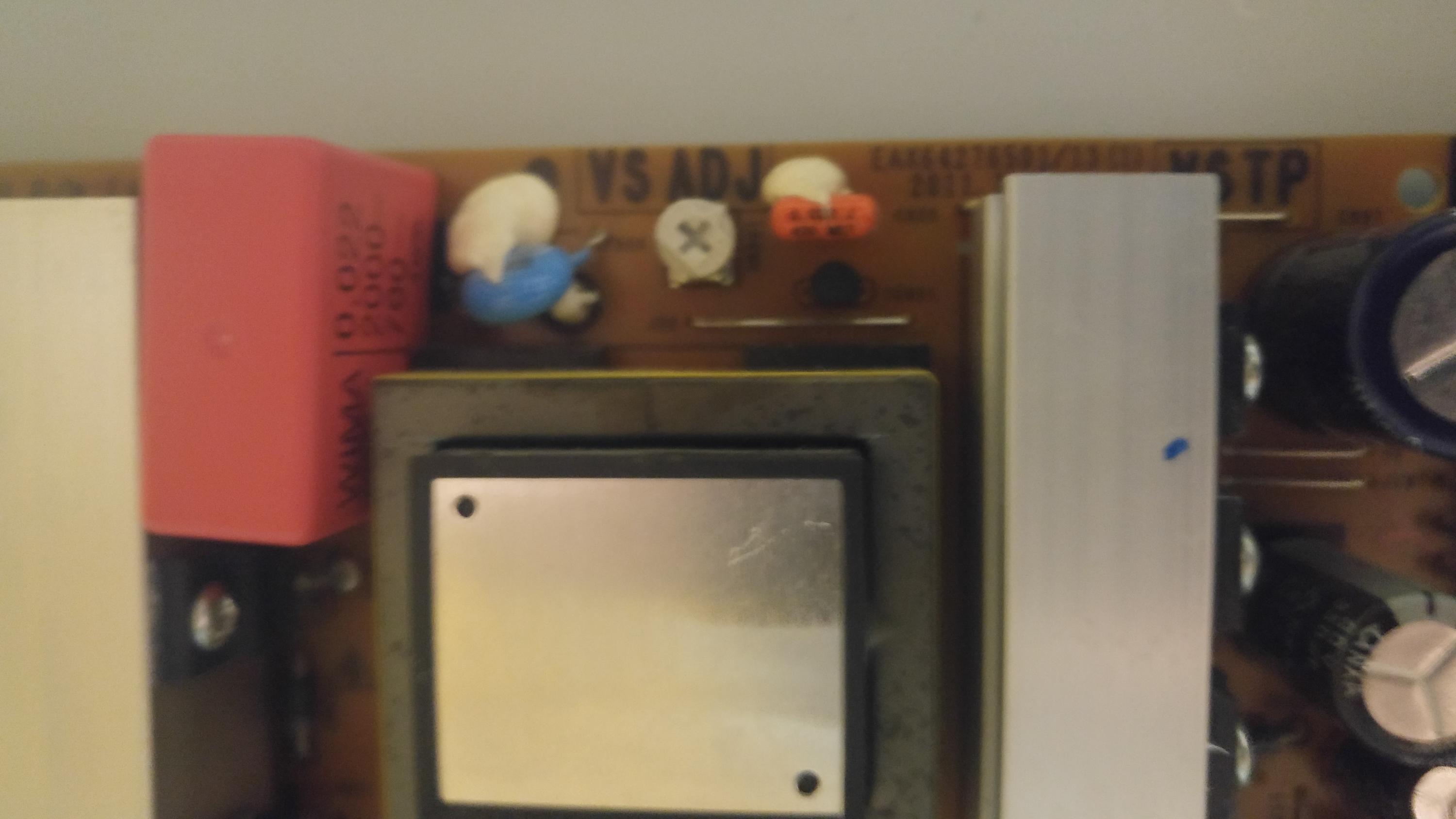

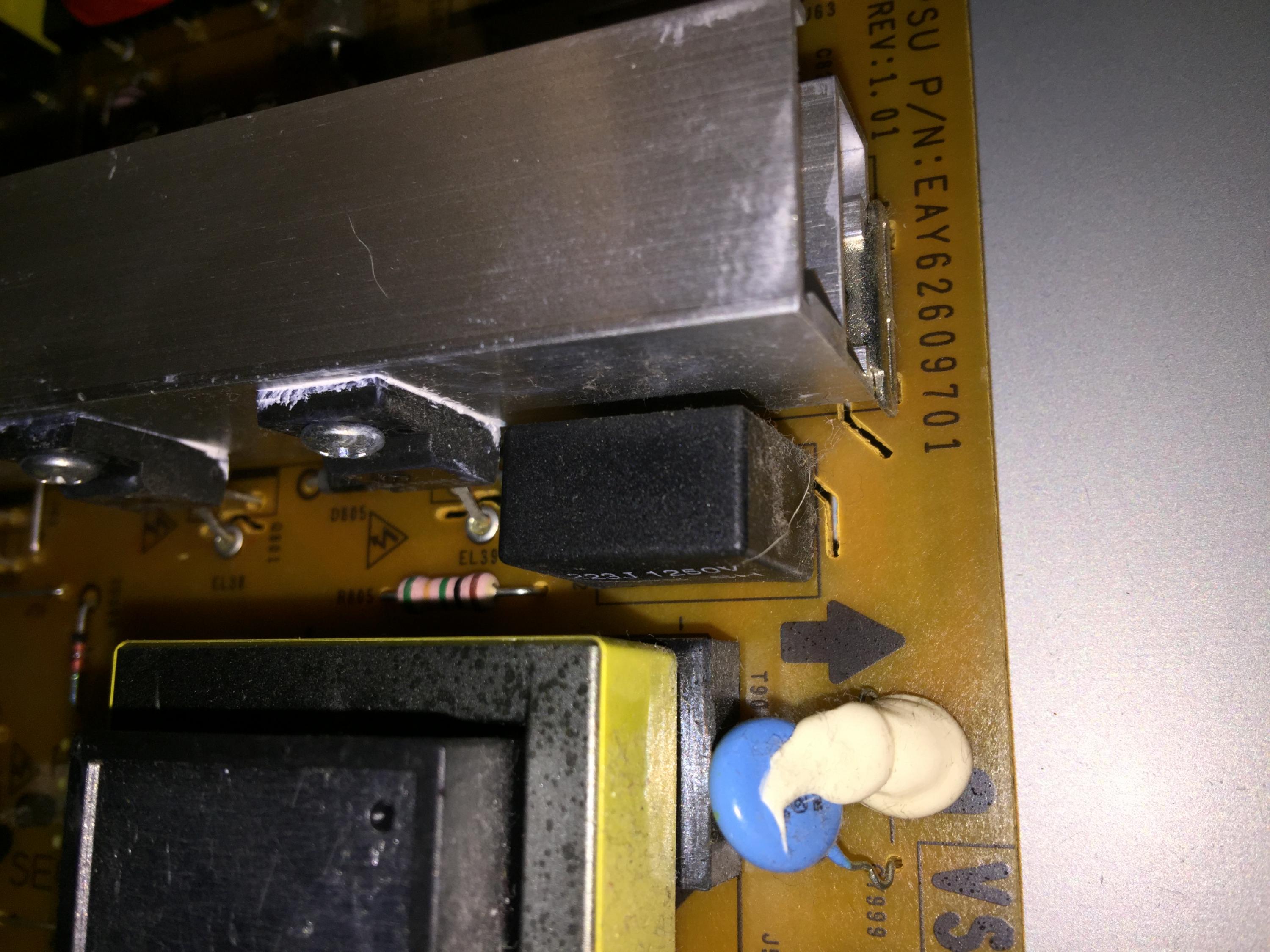

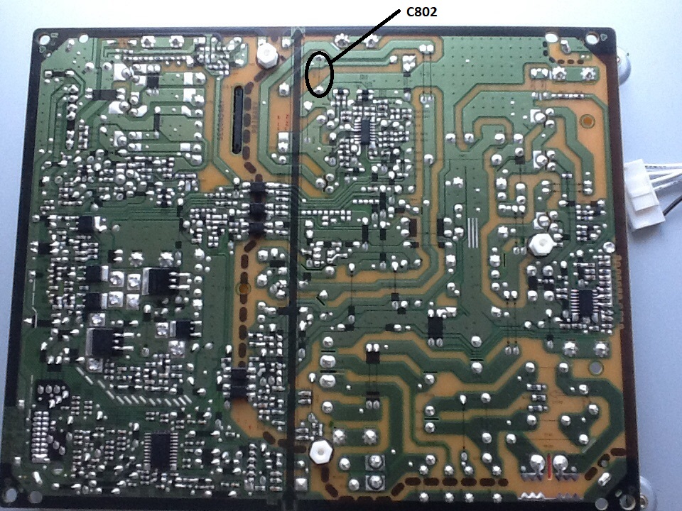

                    i look for solve the same problem....(relay clicking) then green cap on your board is c802 is it probably my problem ...because VSTP is 0v (200-206v need) and VATP is 0v (55v need) , the c802 is juste before t901 (this transformer feed VSTP and VATP.

                        So have you changed-out the identified capacitor?
                          #72
                          Re: LG 50PA4500 Clicking troubleshooting HELP please...
                          i look for a replacement parts..
                            #73
                              i buy wima 0,022uf 2000vdc 700vac from digikey, the capacitor are tight fit , i extend wires and install it.
                              plug the tv and only 1 click and the screen power up.
                                #75
                                Congratulations! You got your TV going again. That capacitor should work fine. From memory, I think it works as a coupling capacitor at either the input or the output of the switching transformer.

                                    You need a 223j 2000v capacitor (.022uf 2000v) .
