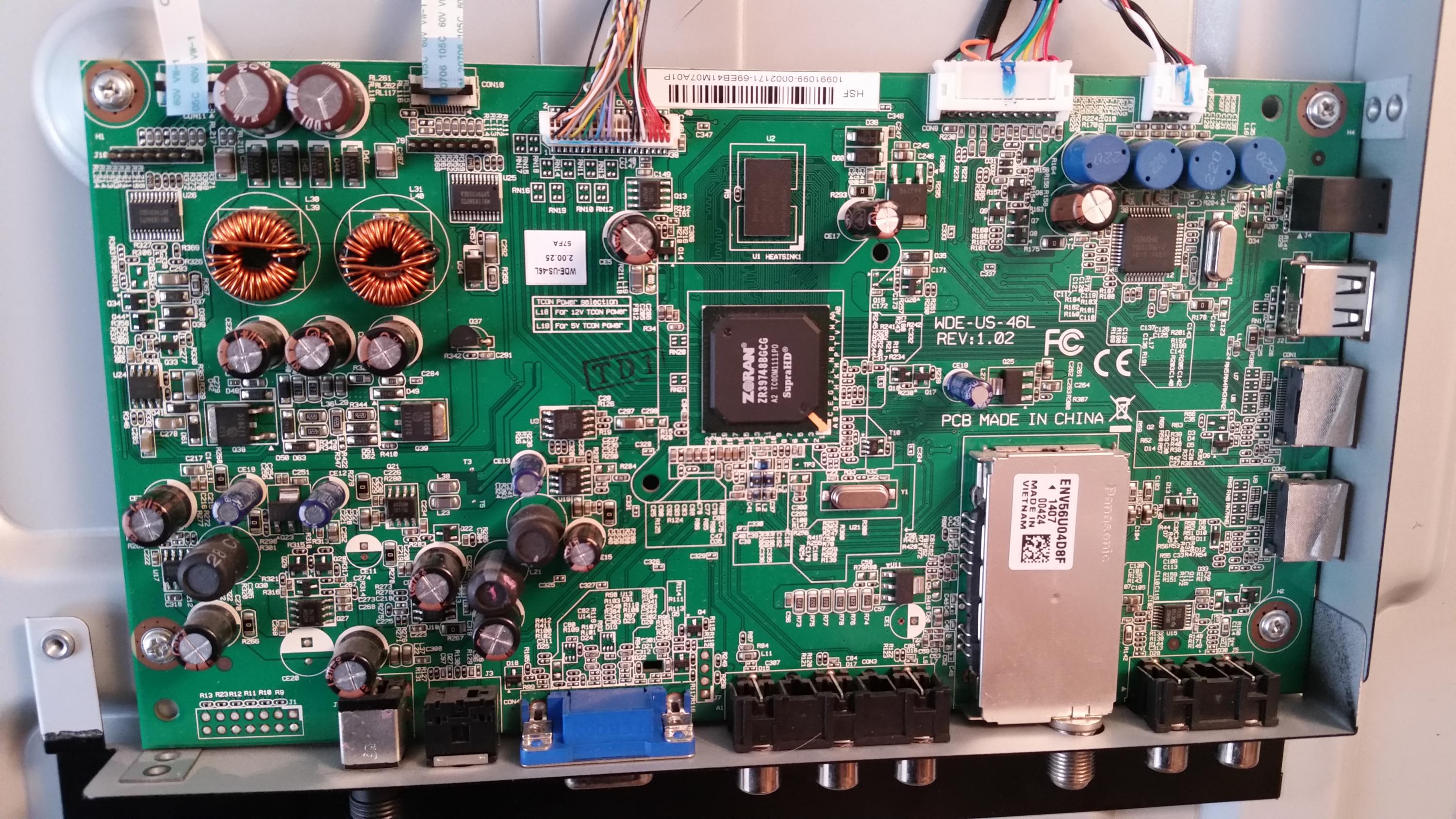

Westinghouse LD-4680 - no power - seems to be stuck in stanby
  • Dgtech
    E. Technician
    • Apr 2009
    • 1462
    • Steeler
    I read another post here about these sets. The post said to disconnect the ribbon cables and power up and reconnect one at a time. I tried this method first. There is no response. I got 19 volts on the board in a few spots.
    Only one 1117 regulator is being powered at this point.
    Q25 has 5 volts in and 3.3 out.
    Is there any way to trick this on?

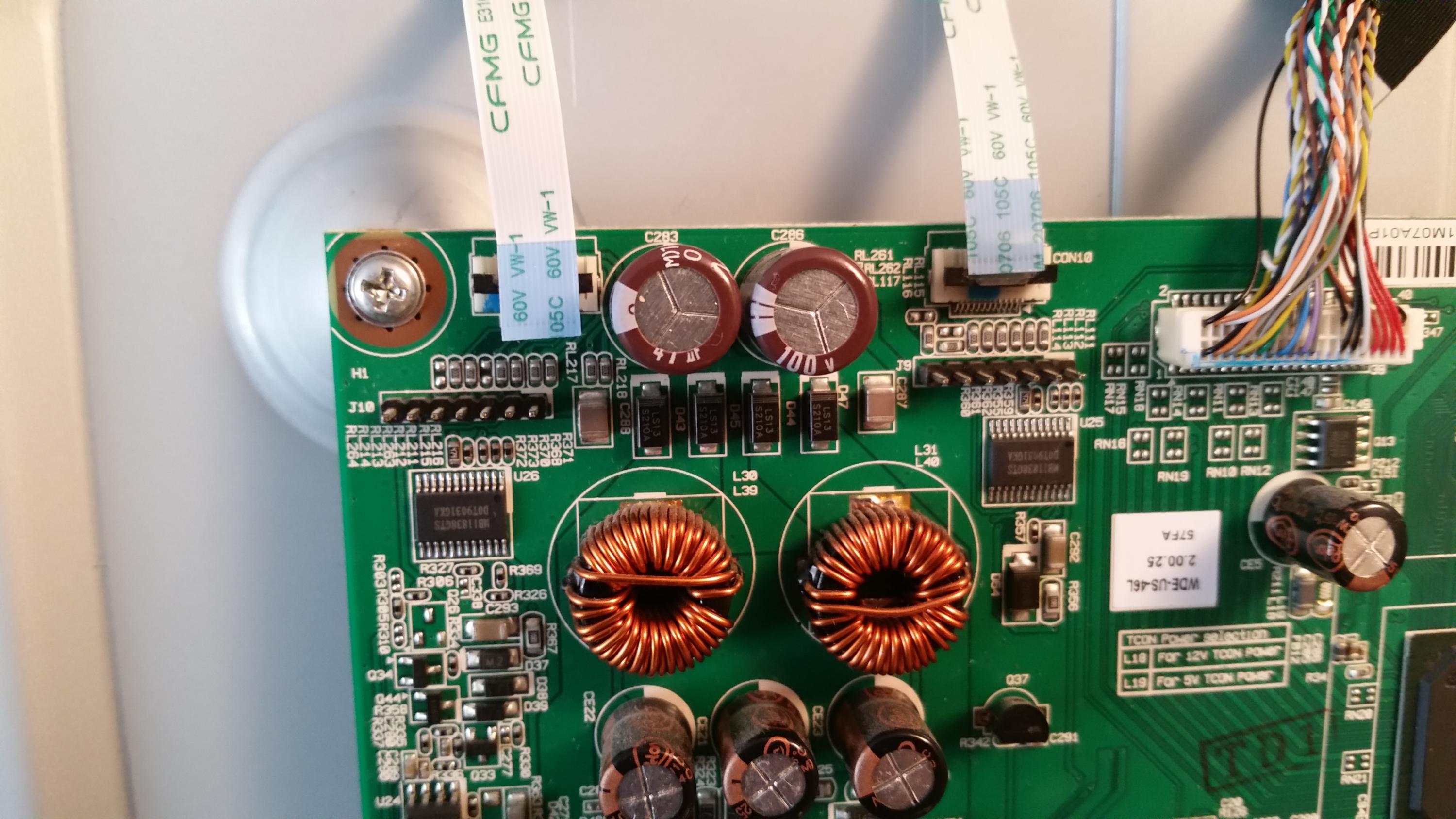

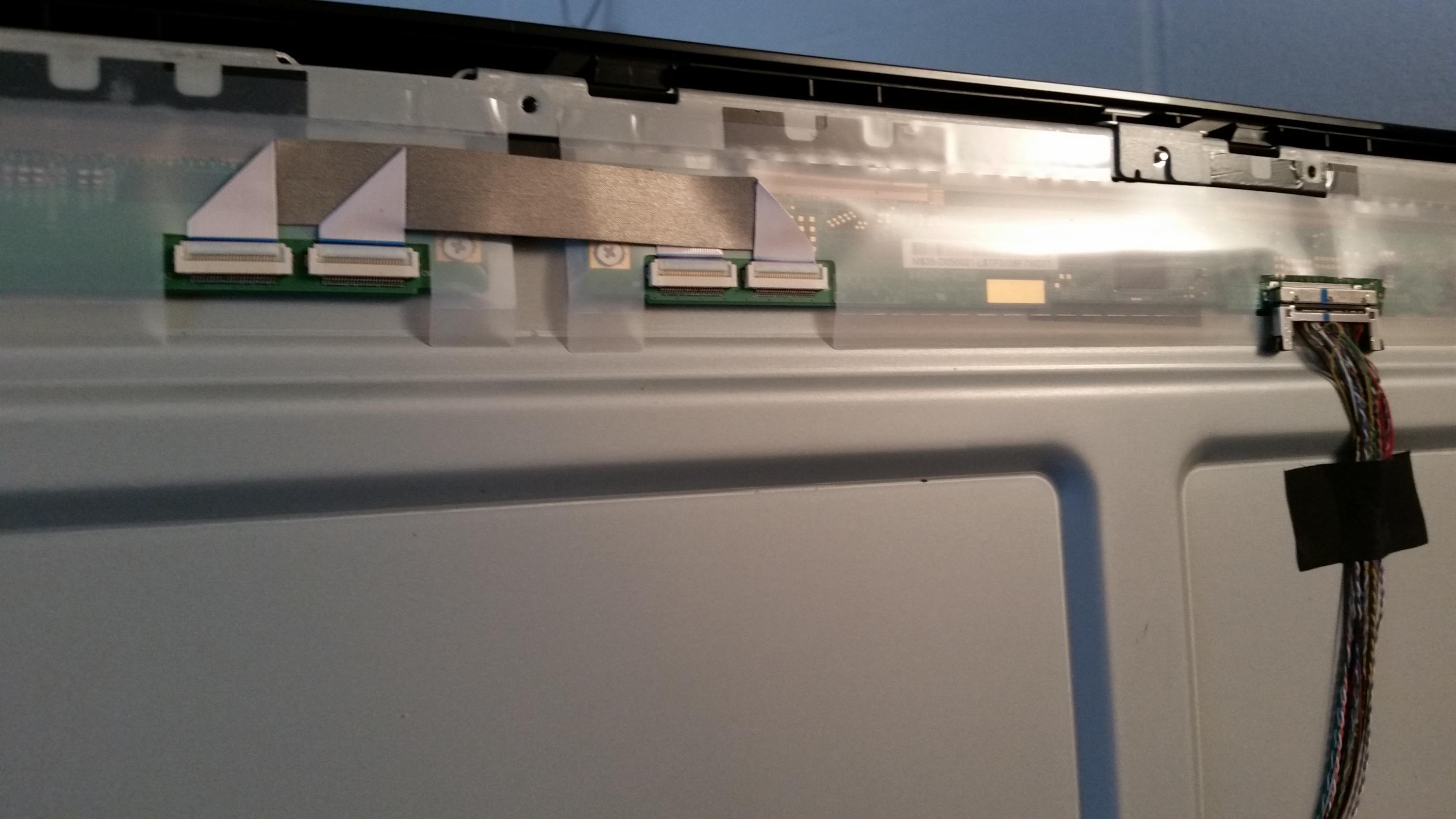

        Re: Westinghouse LD-4680 - no power - seems to be stuck in stanby
        Which ribbon? See pic.
            Picture of the power supply? any clues on the connectors from it to the logic/main board as to what the pins are?
                the ribbon in the picture are not the LED ribbon cable
                  The ribbon cables in question are the two on the 2nd picture in my first post right?
                    Ok...update.
                    I disconnected both ribbon cables and reconnected power. Checked screen with flashlight and there was a menu. I don't know about my confusion from before.
                    So... to make a long story short, the ribbon cable that goes into connector con 10 is grounded on all pins.
                    For anyone following this post in the future, one of the meter leads touches the aluminum chassis and one touching the pins of the ribbon cable with the meter set to ohms. Zero ohms is a short. Bad
                    Now I must fix the short just as those on the other threads did for similar sets.

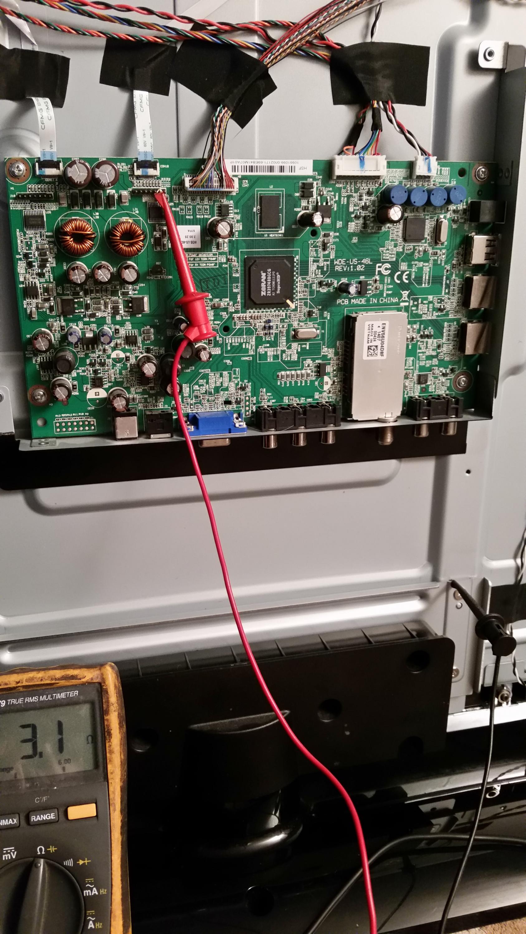

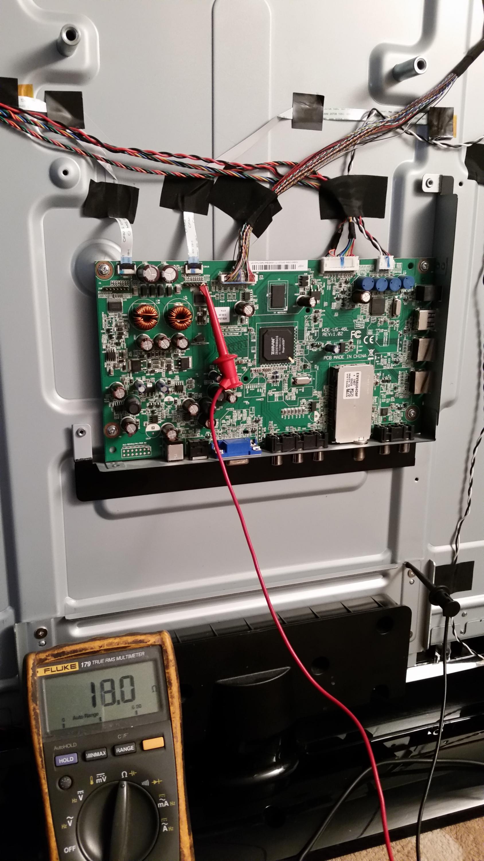

                            Here is something interesting - Refer to the pictures below.
                            I took these pictures to show that the ribbon cable has some sort of ground. Here's the thing though, with the set standing like this, If I slightly push the screen forward (not much), the resistance will increase/decrease. I have done this directly from the ribbon cable - disconnected from the board. I just wanted to show in the picture a good test point to test this theory.
                            I will try to light this thing with that site that Selldoor suggested. Although, I would have thought that if the one side was grounded, in any case, with just the anode tied high from the board's supply voltage, the lights should have come on being as it would have had a complete circuit.

                                "I took these pictures to show that the ribbon cable has some sort of ground" Those two white flat ribbon cables that go to the LCD panel LED strings should show no resistance reading between the conductor on the end of the cable and the chassis (cables not plugged into the sockets CON10, 11), they are isolated from the chassis, if you can read any resistance at all, then there may be a cut in the cable some where and it is making contact with the metal chassis. So you are getting close to where the problem is.
                                  Here are the pictures that I forgot to include in my post above. They show the different resistance readings.

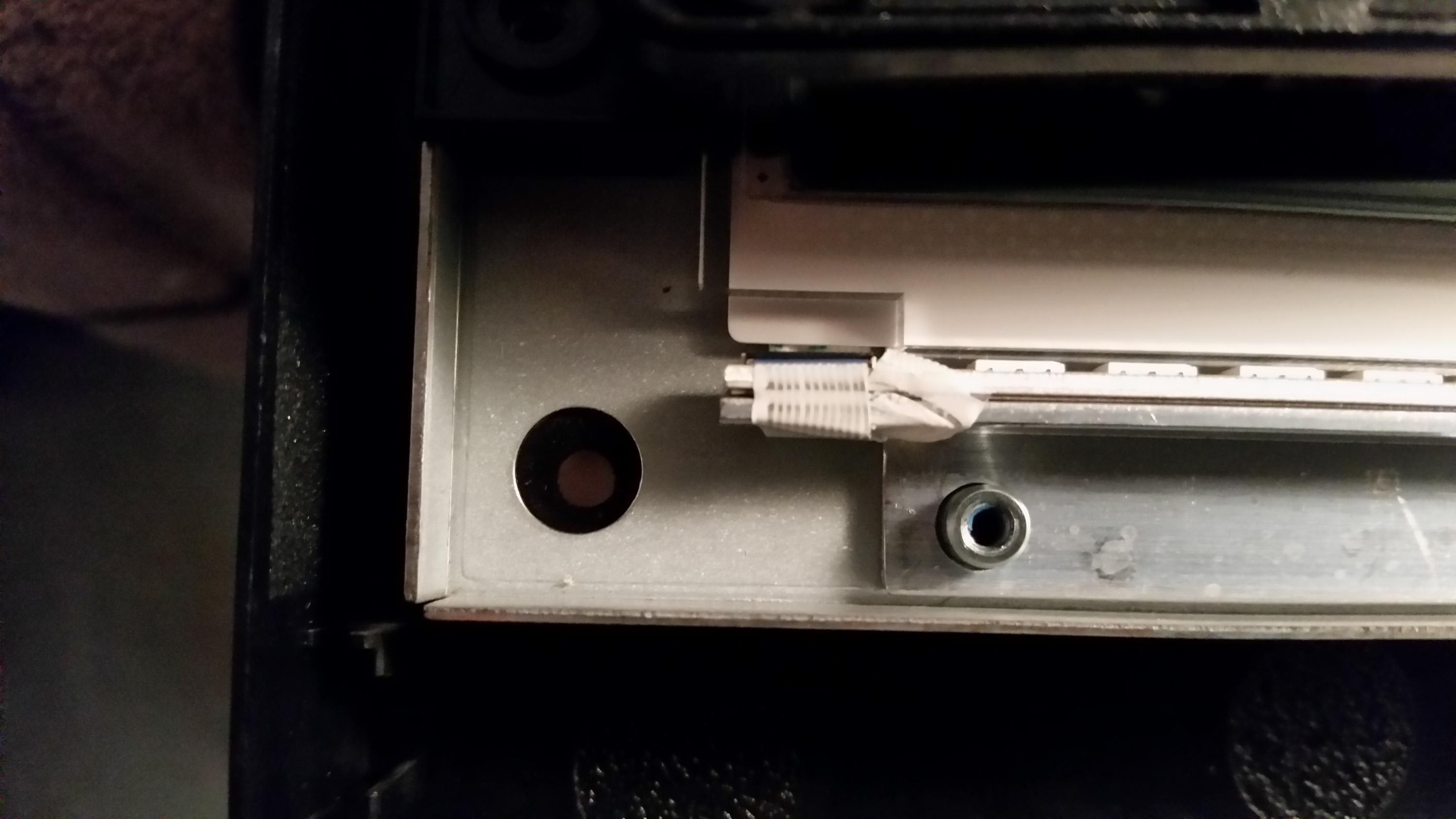

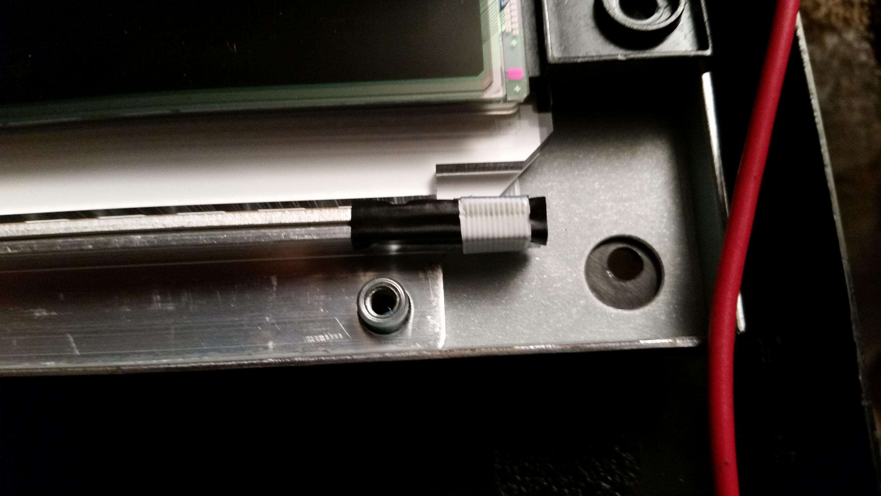

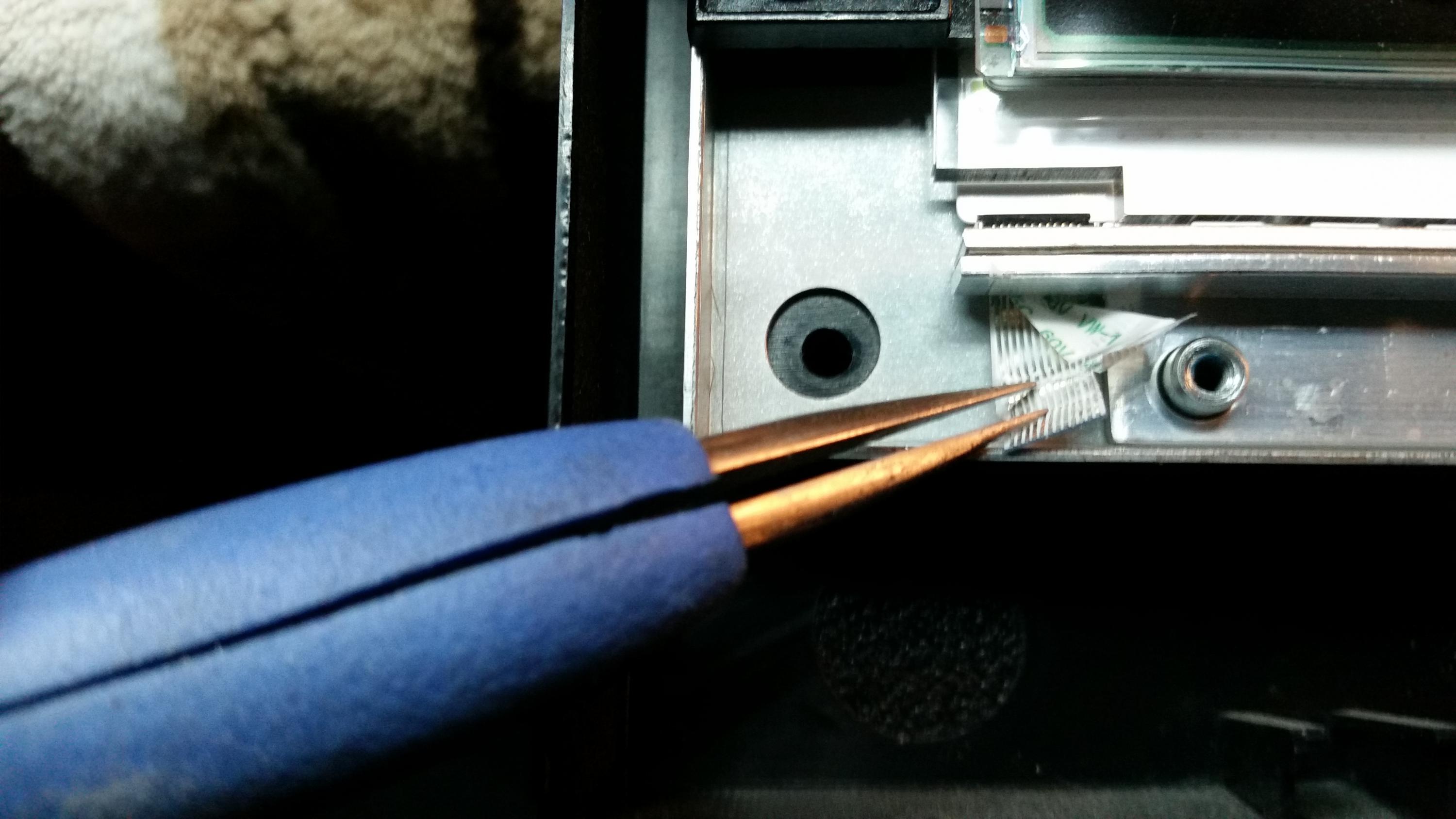

                                    Problem found - just as people found this same problem before. I never saw pictures of the exact failure point in other posts. Therefore, here they are. What a crappy design flaw.
                                    I don't know how this TV ever worked at all.
                                    In the one picture, you can see the protective insulation tape sliding off of the side of the ribbon connector. This is very sad.
                                    You can also see my fix. I used a blade to cut very thin strips of electrical tape to apply to the aluminum chassis point where the ribbon cable folds over top and reaches the connector on the other side. Afterwards, I checked the resistance to chassis ground, much higher resistances now.

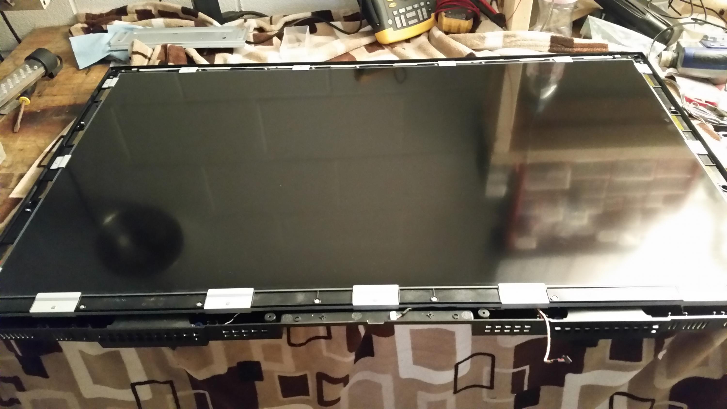

                                      I powered up, the lights came on. I'm looking at it from backside with the unit face down on my work desk. I put it all back together and start to program channels to find another problem. LOL
                                      I'm wondering if maybe I can loosen up a screw that maybe I over tightened for the clip that holds the panel in.
                                      Either that, or maybe I didn't put the ribbon into the connector quite right. I will try a little later.
                                      Thanks for all who chipped in. Any suggestions for this issue? Anyone correct this before?
                                        I just realized, that was the side with the worse connector. That was the one with the tape peeled off exposing the conductors. I'll play a little with it later on and report back.
