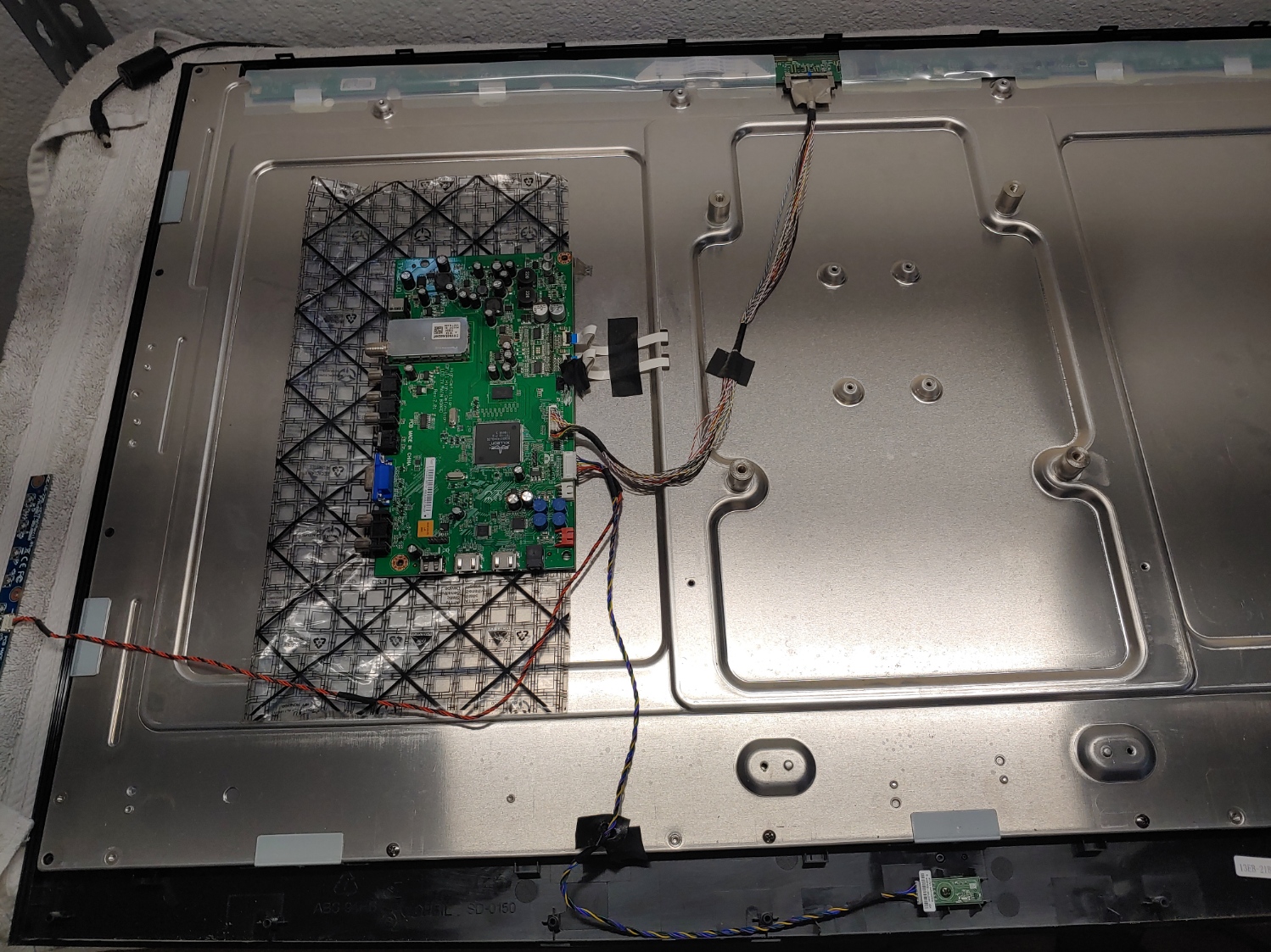

    I know that a few similar Westinghouse models had an issue where the backlight ribbon cables would short out against the LCD frame, but I have tried turning it on with the backlight ribbons disconnected and nothing changes. I also partially disassembled the panel to inspect the ribbons and they look fine, I even added some electrical tape to insulate them from the frame just to be safe.

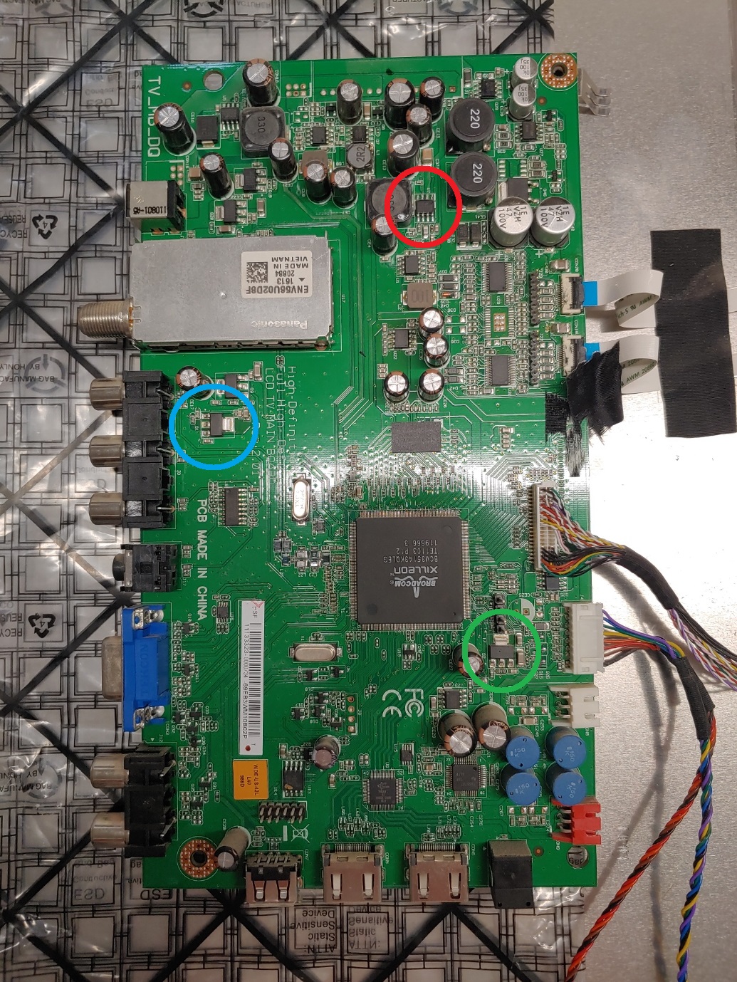

    This TV has just one board that handles everything, and power comes from an external 19v supply. I don't know much about board level repairs but I started by checking voltage regulators - only 3 of them had power, a MP2403DN and two 1117's. Here are the voltages:
    MP2403DN (circled in red)
    pin 1 = 9.8v
    pin 2 = 19.46v
    pin 3 = 5v
    pin 4 = GND
    pin 5 = 800mv
    pin 6 = 1v
    pin 7 = 7.6v
    pin 8 = 3.6v
    1117 (circled in green)
    pin 1 = 444mv
    pin 2 = 1.83v - fluctuates between 1.45 and 1.53 after about a minute
    pin 3 = 4.9v
    1117 (circled in blue)
    pin 1 = 169mv
    pin 2 = 292mv - shorted to ground
    pin 3 = 4.93v
    Looks like something is shorting out the last 1117. Not sure why the other 1117 starts off at 1.81v and then lowers to around 1.5v. Also, the main processor is hot to the touch and the tuner module is warm as well, I may be wrong but I don't think either of those should be warm when the set is in standby... at this point I'm not really sure what to do next. Are there any components that I should check for shorts?

    Can you lift the regulator (blue) and check if pad 2 is still shorted to ground?

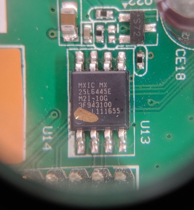

      you need first to clean the boards complete with air pressure. and tell what are the label of U13. its sound the set at half boot.

        Maybe try cooling or heating U13, power up see if there's any change, could also try heating the capacitors on the board with a hairdryer, see if there's any change, U13 there if it turns out to be the issue: https://www.ebay.com/itm/36332330489...cAAOSwefBgT0b1

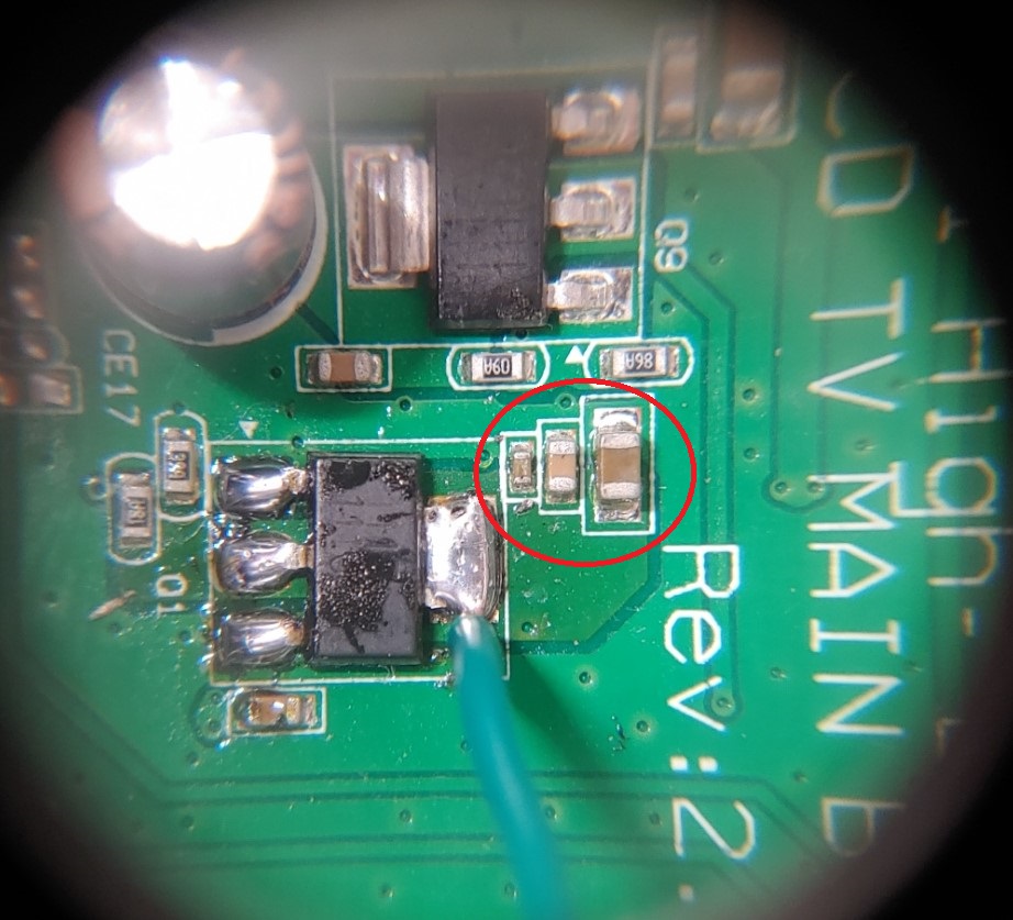

          Sorry for the delay, I finally got another chance to look at the board. I was able to remove the blue regulator and pad 2 is still shorted to ground. I also tried freezing U13, no change. Will try heating both U13 and the capacitors with a hairdryer later tonight and see if anything changes.
          I also attached a pic of the label on U13 for Diah

            The Blue regulator is the adjustable regulator IC, there should be filter caps connected to pin 2 of the IC, one will be MLCC (Multilayer Ceramic CAP) type connected in parallel with lytics type cap, so the short can be from shorted out MLCC or shorted load.
            BTW, when you say shorts, how many Ohms is it? <1 Ohms?

              The short I'm measuring is <1 ohms at about 0.56 ohms. Is the MLCC one of the three circled caps connected to the output of the blue regulator? I'm going to try removing all three and seeing if that changes anything
