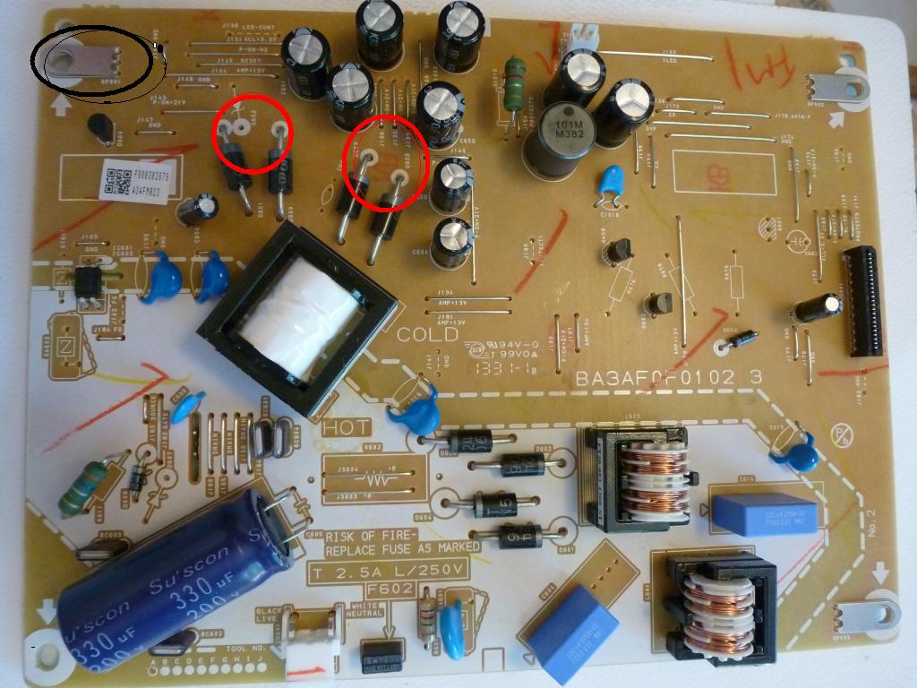

                                Re: Funai LF320FX4F Power Supply Issue?
                                Check voltage at the two red areas
                                use the black circled area as a ground.
                                Check this power with the board by itself
                                then plug in the input board (do not connect the actual screen panel yet) and check them again.
                                then with a video source connected , power on the unit and check them again
                                If the voltages stay steady and do not drop, the board might be ok
                                so then we'll have to check power to the panel

                                  Mr
                                  Sorry I haven't got back to testing it till now, family stuff and all.
                                  I tested every thing unplugged and plugged in, (input & screen) and had power of 10.9v on two diodes and 6.5v on the other two at all times. I also (a week ago) went and bought a cheap used power board because of the problem with the previous reversions of it, and of course it does the exact same thing.
                                  Powers on, power light flashes 17 times, I see the Funai logo and...nothing steady power red light, no pic. It seems to be picking up a video signal with a HDMI hooked up to my pc video card. The pc kept recognizing a display being connected.
                                  Thanks for the help so far, with the number of these bought and the failure rate already (from my searching) I'm sure this model will soon pop up quite frequently.
