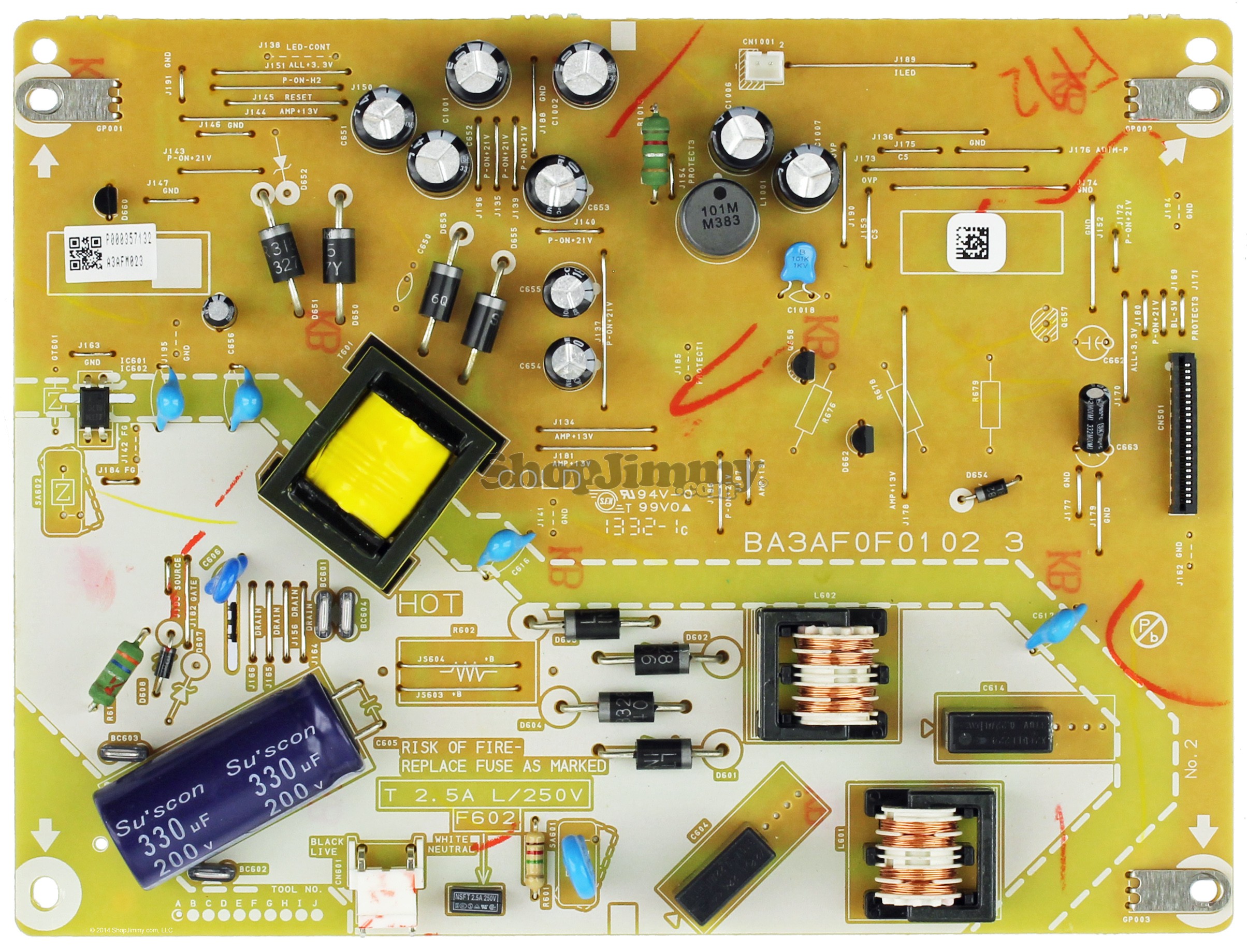

        I was given one of these Funai LF32FX4F TV's
        I replaced most of the capacitors on the board (Except for the main big one and the two really small ones) and the set still has the same problem.
        It powers on just long enough to see the Funai logo and then shuts down.
        I did not test voltages but I did unplug the LED strip and it still does the same thing (I pointed a bright flashlight at the screen, and I was able to see the Funai logo just before the unit shut down)
        What else can the problem be?
        PS: I am a new member to the forum and also new to board level electronics repair, I only decided to try and repair this power supply board because buying a $54 board for a $100 TV does not make sense to me

            #45
            Re: Funai LF320FX4F Power Supply Issue?
            I have had several of these with the same problem. Shuts off after the splash screen. Could be Magnavox,Emerson or others made by Funai. Don't know what the exact cause is but they are easily fixed by increasing the value of C1006.
            You need about 470uf /100 volts to be on the safe side.Due to size I usually don't try to mount it on the board just have some wires from under the board.
            Plenty of room adjacent to the board.

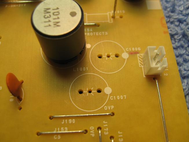

                  #48
                  Had the same issue with flashing of the name for 2 seconds. I replaced the c1006 with 470uf 100v and the tv is now working. Does anyone no why this is?
                    #49
                    C1006, C1007 are connected in parallel, they are the filter caps for the boost converter to produce the drive Voltage for the LED string.
                    Did you measure the capacitance and the ESR of that cap.
                    Pictures provided by shopjimmy.

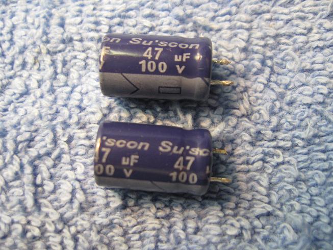

                          • ron350
                            • Feb 2014
                            • 296
                            #53
                            OK C1006, C1007 are 47uF x 100v by 10mm x 12mm with 5mm lead spacing.
                            I think the largest caps that will fit are 12.5mm x 25mm with 5mm lead spacing.
                            What would be the best caps to use that will fit vertically?

                                #55
                                Hi Budm the tallest cap on my boards are around 12mm.
                                I soldered a 12.5 x 25 in place of C1006 and put modeling clay on top and there is about 4mm vertical clearance under the plastic back cover.
                                The problem is there is not enough side room for two 12.5 mm caps so I guess that limits the size to 10mm x 25mm.

                                    #57
                                    That is why I am asking what would be a good quality replacement of a higher value in a 10 mm x 25mm can.
                                    The original C1006, C1007 caps on my board are Su'scon SL 47uF x 100v 85*.
