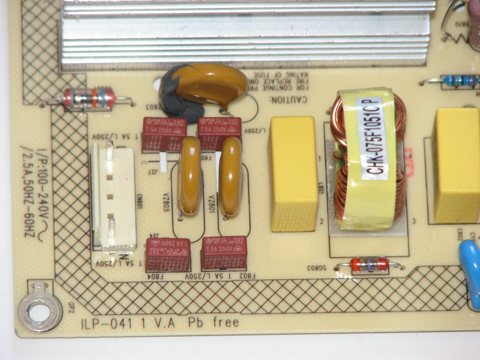

    Hello. I have a Sharp LC-32D59U that is completely dead. No standby,etc. Found out that all 4 fuses are open. Assume it was hit by a surge. They are little square fuses. 250V/5A. I am trying to determine a part number to order these and they are odd sized. Does anyone have any part numbers for these? I found some previous threads where budm provided manuals,etc but I could not find a part listing.
    Thanks!
    Re: Sharp LC-32D59U - Need Fuse Part number.
    Can you show the pictures of the fuses?
    • jstiene
      • Feb 2013
      • 148

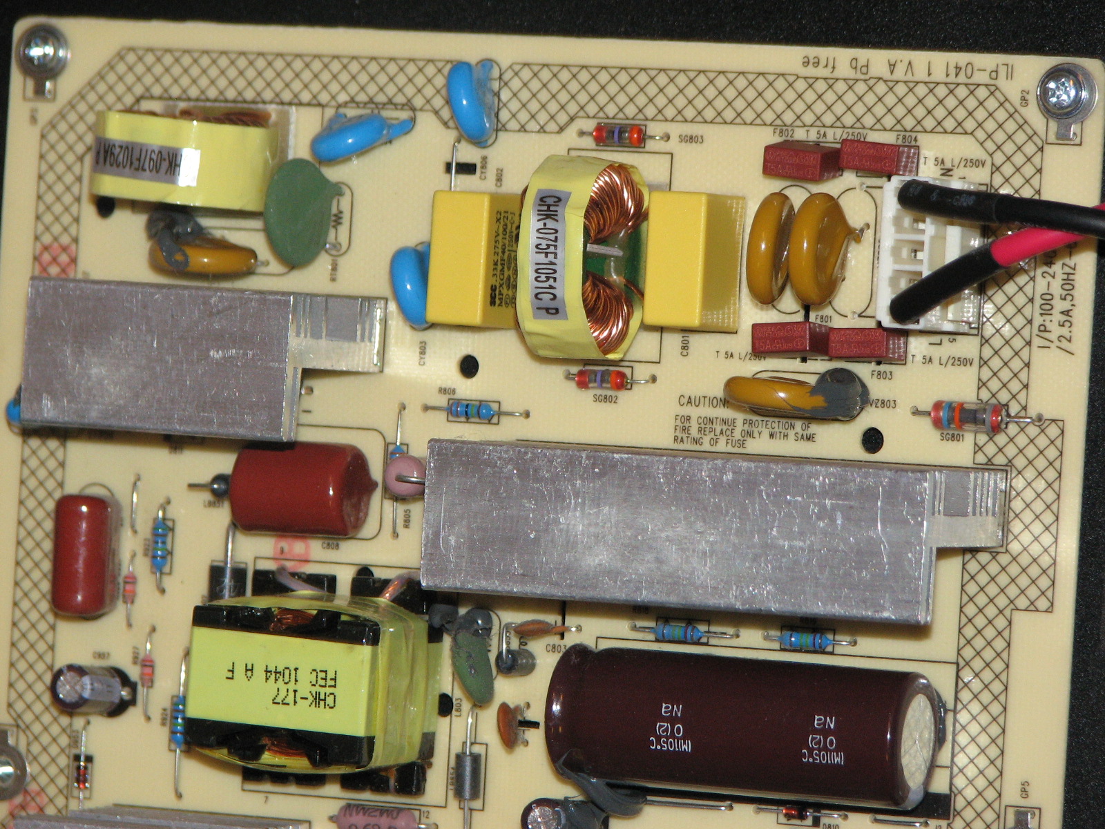

      Hi Budm,
      Sorry about that. Forgot to uploads the pictures. Here you go .
      • R_J
        • Jun 2012
        • 9553
        T5A 250V 392 series Square Type Radial Leads Miniature Micro Fuse
        also check that VZ801 VZ803 VZ804 and VZ805 are not shorted,

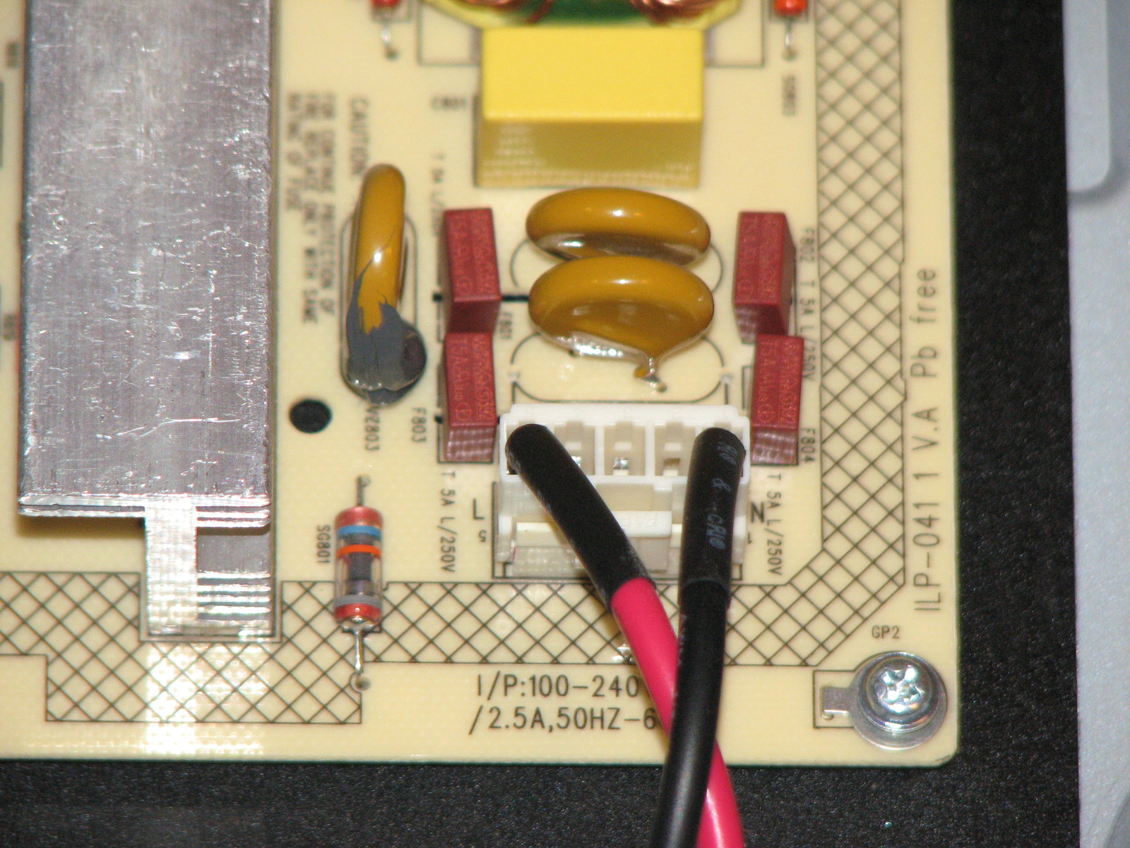

            Thanks for all the responses. It is much appreciated. I did check VZ801 VZ803 and VZ805 and no shorts are present. I guess all the fuses blew and there doesn't seem to be any other damaged. Check all obvious diodes..etc.
            • Ow5856ba
              • May 2014
              • 3
              Did replacing fuses fix problem
              • jstiene
                • Feb 2013
                • 148
                Ow5856ba,
                replaced all 4 fuses and poof the moment I plugged in the AC. All other components seem to test good. I am obviously missing something. Has anyone else worked on this particular model?

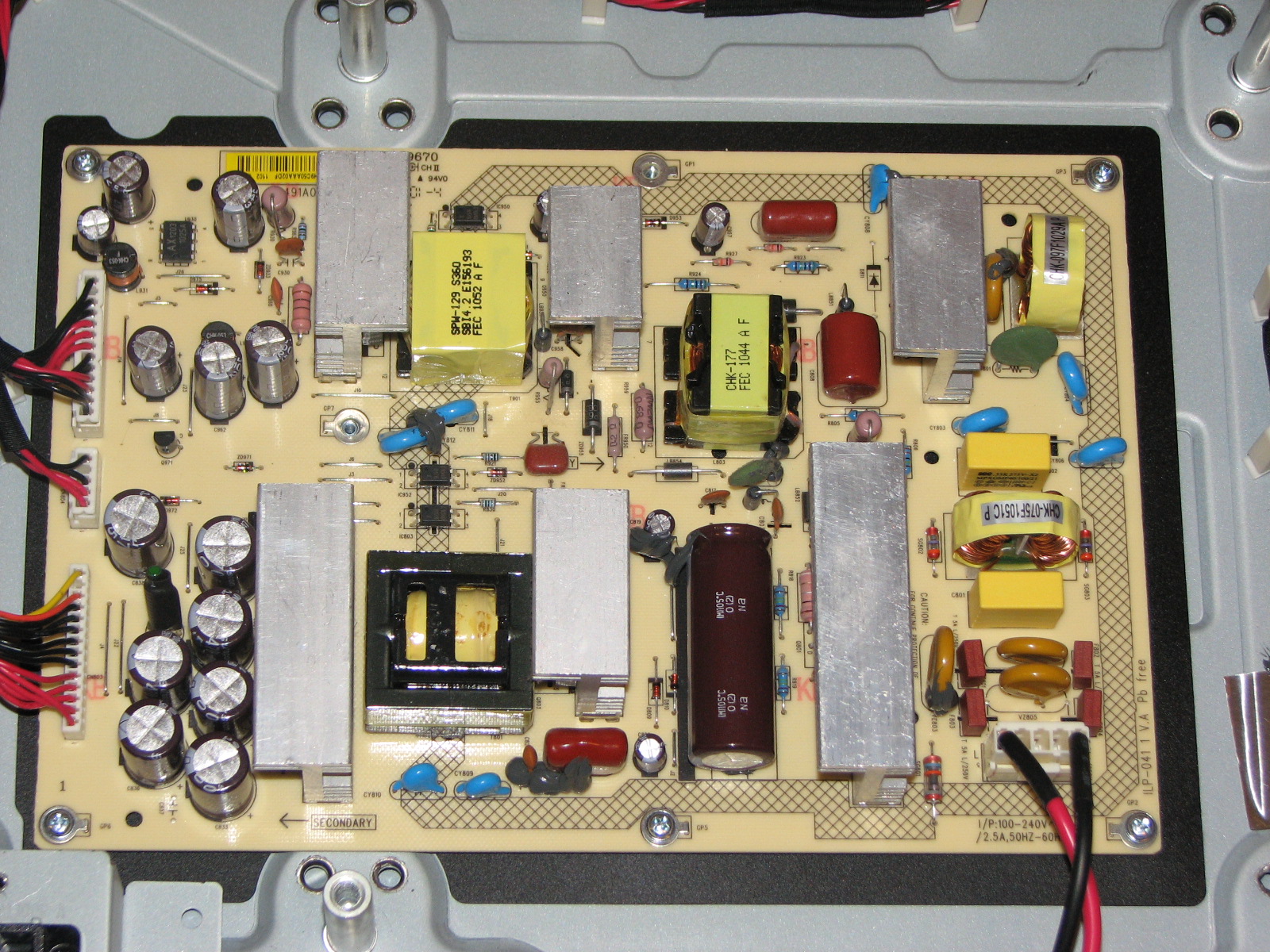

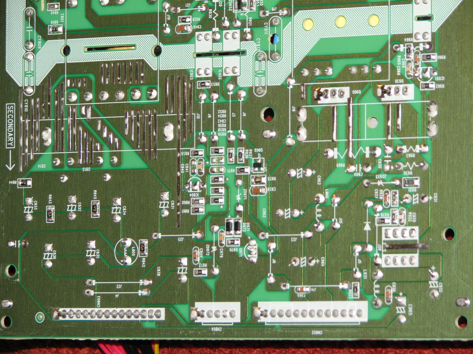

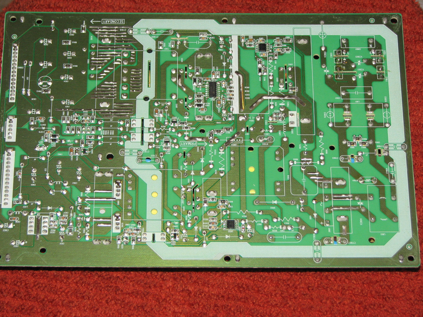

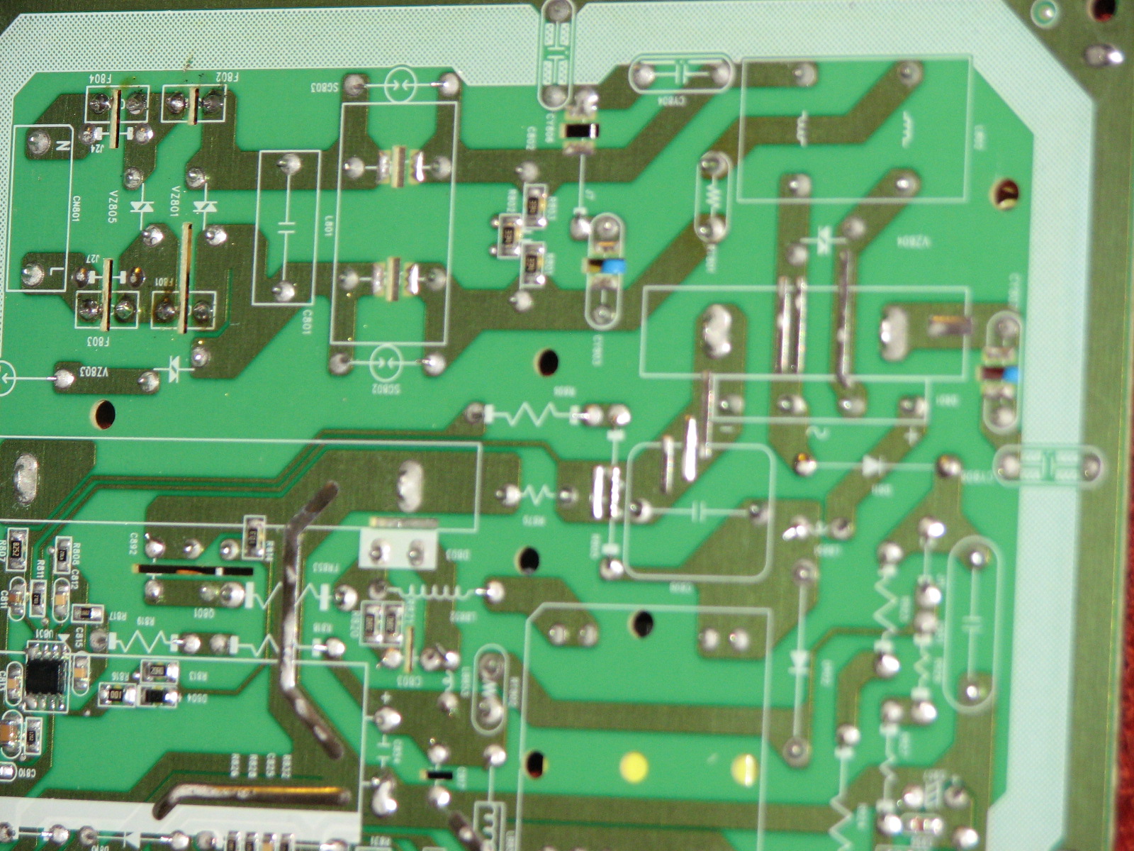

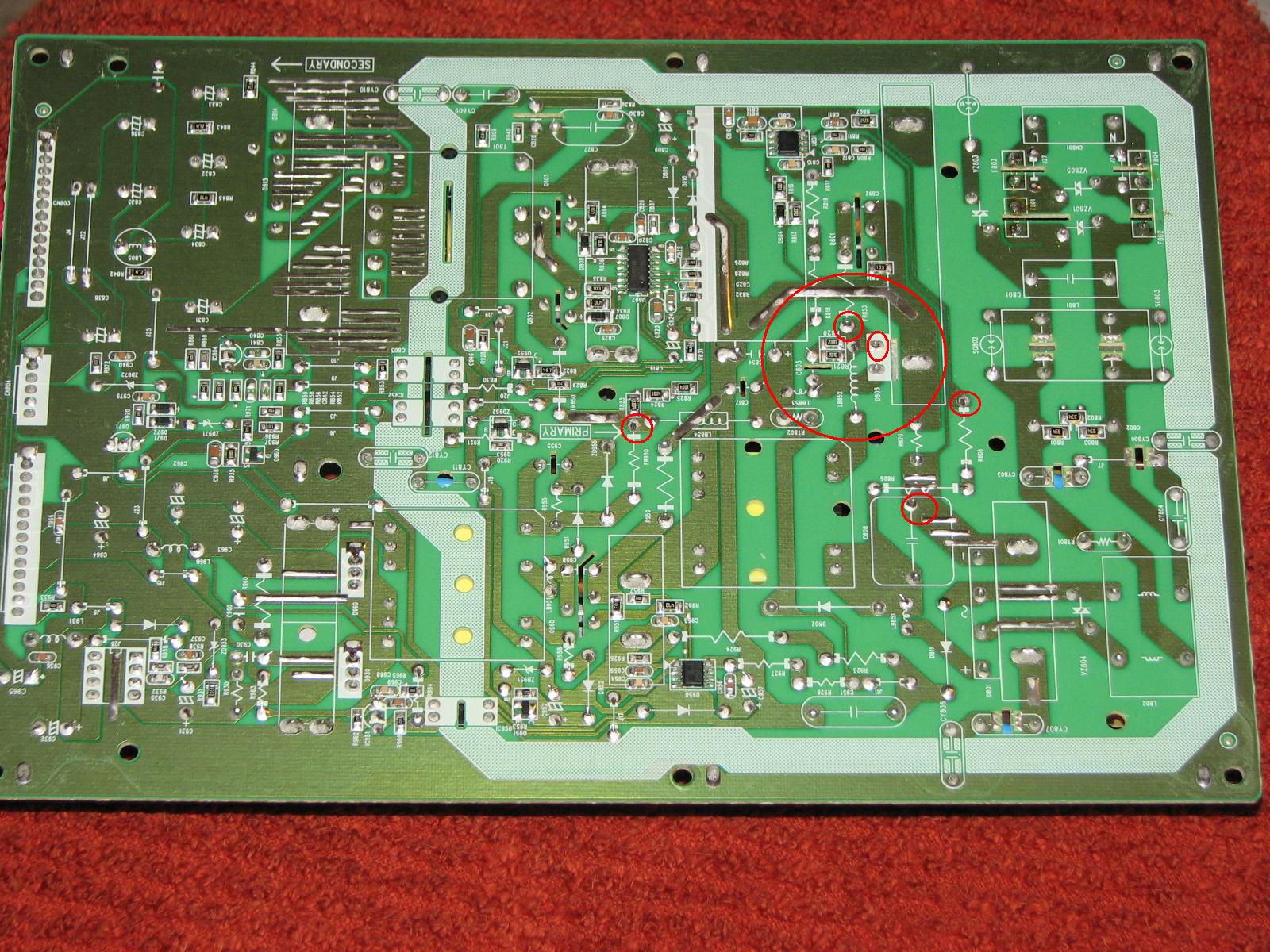

                  Need straight shot pictures of both sides of the board so I can trace out the connections on the bottom side.
                  • R_J
                    • Jun 2012
                    • 9553

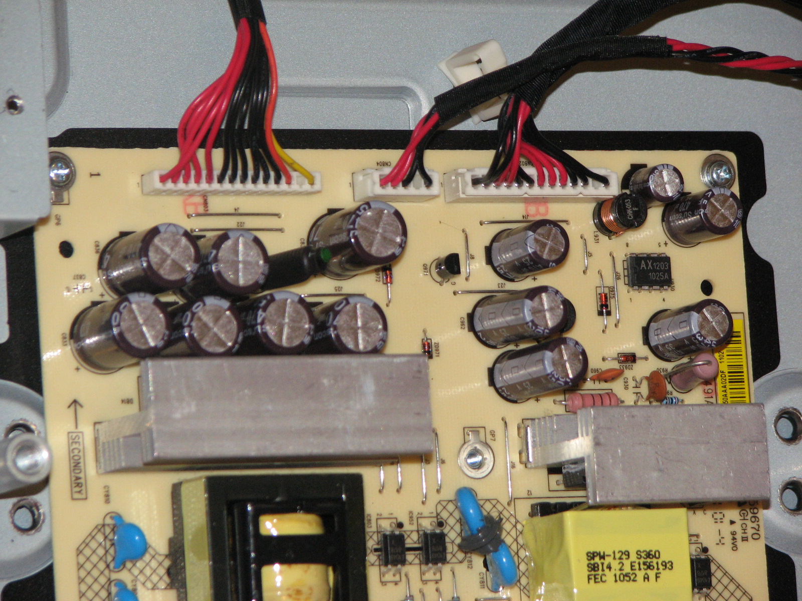

                    Here is the ac input and part power supply
                    • jstiene
                      • Feb 2013
                      • 148

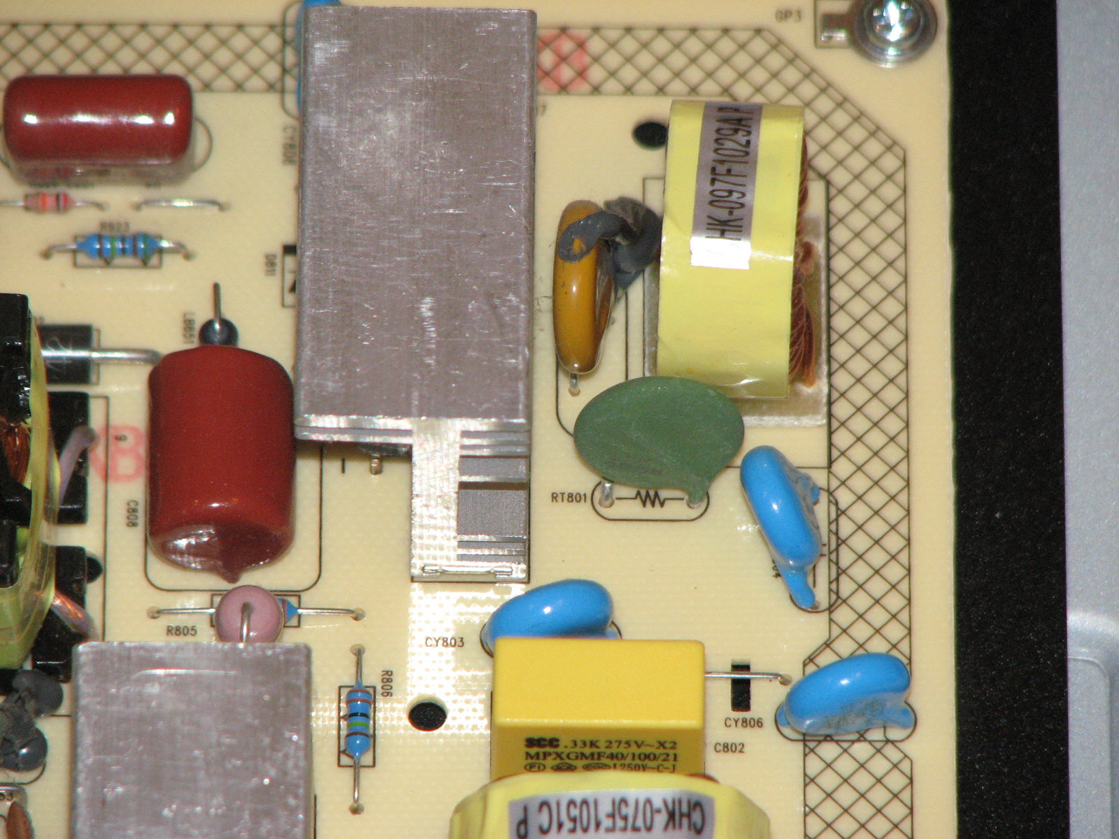

                      Hi Budm,
                      Here are the pictures.
                        So what resistance do you get when measure between the two inner pins of the bridge rectifier? The resistance be tween the two outer pins of the rectifier?
