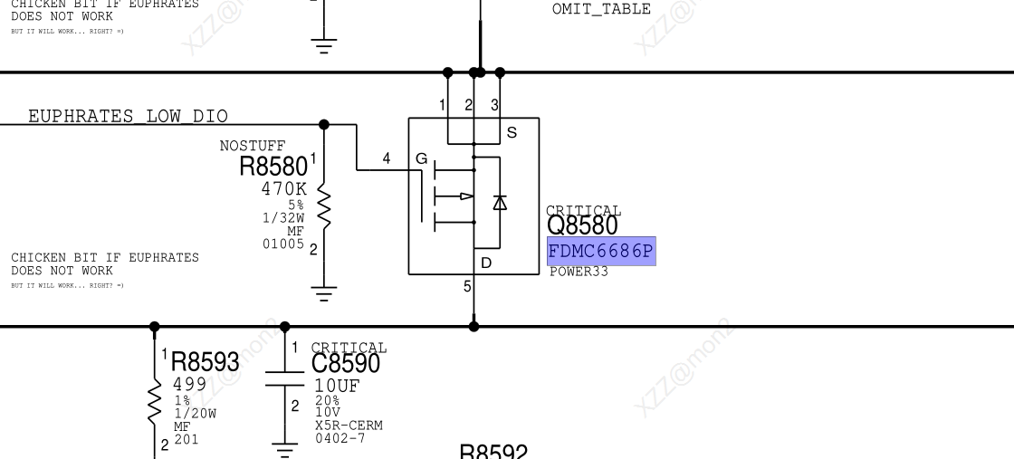

    So My iPad was not charging and booting up . i went to a local technician and he checked with thermal and this Part marked in 1st Photo is Short.
    So then i went on to boardview and downloaded the schematics and identified this part in 2nd Photo. Now i am confused what exactly is the part called ? where should i get this from ?
    i contacted my technician and he sent me his BoardVIew screenshot in 3rd Photo. In his Boardview the part is called X2826.... Something
    SO My main concern is what part should i order what should i search the name for ?
    on Ipad Chipset this part says S4
    so can someone tell me what is the part exactly called
    so far i have found these two parts named S47 AND S48 by going through all the info which i gathered . attaching an image in 4th slide.

    Q8580 = part # FDMC6686P

      This mosfet does not have any connection to ground, it can't be the reason of the short.
      Check if it is a vcc main short or vcc batt short.

        Also review the resistance to ground of C8590 which is mated to the drain of the Q8580 mosfet.
