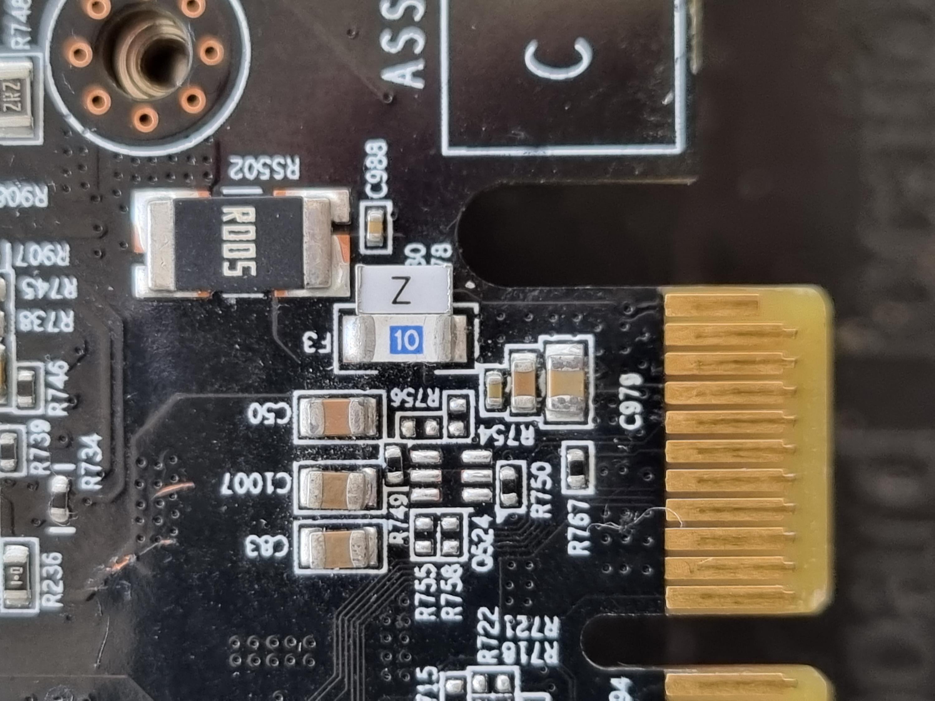

    I need to replace a fuse on one of the graphics cards I am working on. It is a 1206 SMD fuse, white in color and has a "10" written in a blue rectangle on it.
    How do I find a suitable replacement? What is the general rule to identifying fuses' parameters? I found something in an eshop near me (see photo) but am very hesitant to use this as a replacement.

    Looks like a 10-ohm chip resistance.
      You mean 10 amps
        Surface Mount Fuses Fundamentals Datasheet
        TE Circuit Protection offers the widest selection of surface-mount fuses available for addressing a broad range of overcurrent protection applications. Helping to prevent costly damage and promote a safe environment for electronic and electrical equipment, our single-use chip fuses provide performance stability to support applications with current ratings from .5A up to 20A.
        TE Circuit Protection also offers the telecom FT600 fuse for telecommunications applications. This telecom fuse helps comply with North American overcurrent protection requirements, including Telcordia, GR-1089,...
