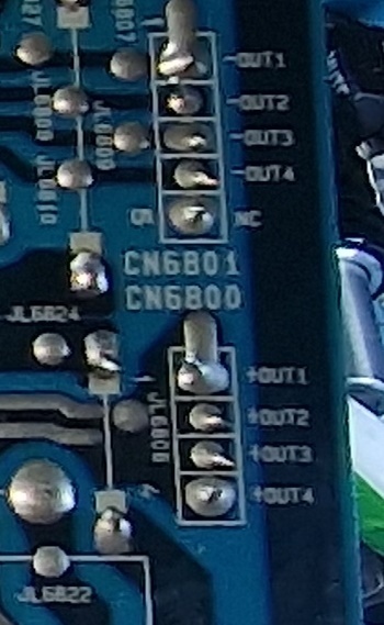

              #126
              Originally posted by labello
              I'm here again, so I already inverted the strip and I have the same problem so the problem is on the board. I took some measurements and on the side of working both strips led i have almost 240v (both)120 one and 120 one. The other side where leds doesn't work in have at max 40v (80 both). The colours of the wire of bad side are 2 blue... the good side the wire are red.. That's a real challenge 😫
              wrong from me , the small socket LED+ for all.... and large socket 2 are LED -
              Click image for larger version  Name:	image_360520.jpg Views:	0 Size:	39.7 KB ID:	3520721

                #127
                Originally posted by Diah
                wrong wiring... you have 2 channel each Chanel / side should be one blue led - a one red led +
                Nope... i didn't touch anything. I would like too if that was the problem but im afraid the clips can't be exanged. ..(see picture) One is a bit less than the other.. maybe I'm wrong, but probably there's some component that cause this problem..

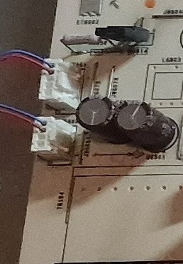

                    this i know .... show yours strips socket

                      #130
                      i was wrong and i correct my last post,,,,, small socket are LED# and the large socket both are 2 lines LED-

                        #131
                        You mean the clips i check already they are good and 100% like the original.. i really thinking about this component (mosfet) that could be defective...I mean in the circuit its going to protect himself....🤔

                          #132
                          you need to undestand what i am talking
                          you have 2 soclets both are correct no need to do any for them..
                          the small socket have blue and red this both LED + connected to gether..
                          the large socket have also 2 one red and blue... this lines are each out LED - now the red on this latge socket working.... but the blue not.... you need to flip the PSU and follow the track line of the blue one you will have Diode and many other sync smd R need to check if one open

                                #135
                                Hi guys I'm back. So the tv works again, thank you so much for your reply guidelines and time!Then I wanna to say Happy new year to all of you 🎉

                                    #137
                                    Well that's good, can you describe the solution? Or did you give it? All I read was it's working now.
                                    Yes at last wast bad connection of the negative rail including the little capacitor on the secondary side

                                          #140
                                          looks like Diah was on that path in post # 47. Bad soldering is often overlooked. More than once even, my bad soldering that looked good was the issue.
