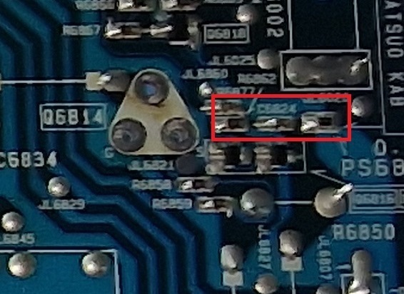

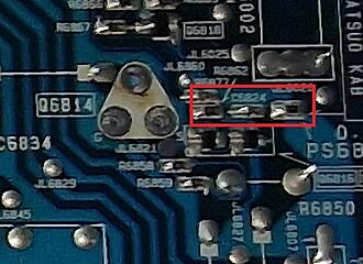

                                      #118
                                      all what mentioned many time i linked you to the position where need to change... and here again which izs over this threat 4 time uploaded

                                        Men first of all, thanks for the reply. Second, I already changed the smd capacitor , and I the resistor smd if you look the picture above you'll see.. Tomorrow I'll replaced the original resistor and see what happened..

                                          #120
                                          Hello guys, so I replaced the original resistor back, the tv turn on and then back off, the red led blinking 6 times, I look beyond of the chassis and seems one side of the tv the light is less than the other side.. How's it possible 😫😫
