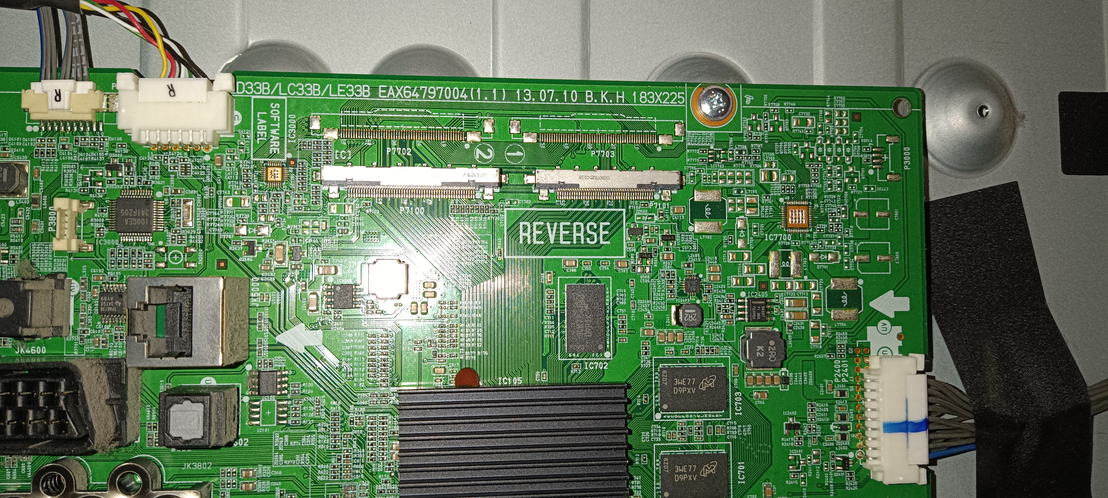

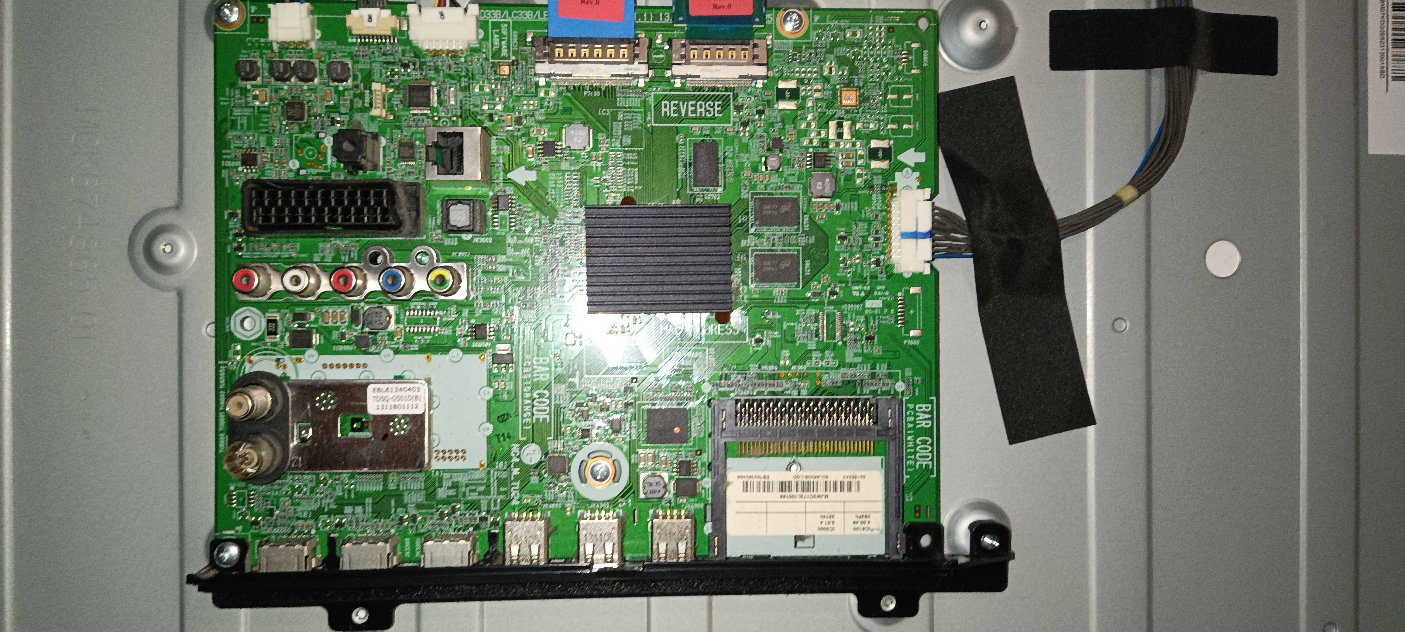

    hello everyone I am looking for a solution for my tv, I think corruption of the eemc,
    the TV starts, LG logo, then nothing (rear backlight)
    no reaction to rear command or infrared
    the usb procedure that I tried on the LG site is a procedure with the screen and the remote control so I can't.
    I have a chance with a usb procedure or other if you have .bin
    if any people have this main board
    Sony LG 60la620s EAX64797004 (1.1)

    there are Russian web portal they have good sources of all web os ( engineering firmware ), for many years i posted here over LG threats but still i cant find it... it will recover yours TV
    edit: here you are
    to use USB you need to make folder name LG_DTV and put the firmware inside... while it on insert the usb stick hope yours screen will show you dialoge
      You are right in thinking that the problem is either in the eMMC or in the processor.

                    Hello, I tried the general public LG flash procedure a while ago, it doesn't trigger the flash for me.
                    Thank you if people have .bin or other way .
                        And you hoped that this would work, if the problem is with the eMMC, then only replace it with the already programmed one.

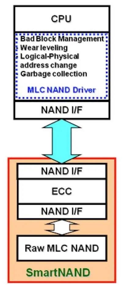

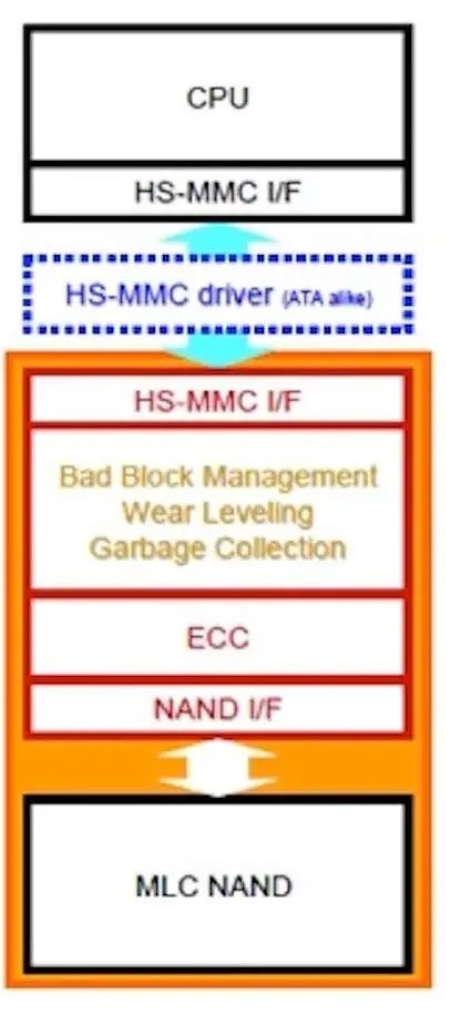

                            In plasmas they usually installed Nand memory, in old LCDs they began to install eMMC of small volume 4-8Gb and the memory was filled almost to capacity, and rewriting became more frequent (eMMC is a nand flash + built-in controller (two in one), which contains its own firmware and now this controller monitors the health of nand memory; when its health ends, the controller blocks access to memory).
                            • Diah
                              • Feb 2013
                              • 6365
                              eMMC contain NAND too .. only emmc don't have erase function.

                                    The board can have bga soldering issue or both data fail and bga issue for me, so for the common humans a replacement board is the only way to run, the best way is reballing+kindly rom writing, when the first is the less problematic, the second needs a good donor board or friend tech.. which way do you prefer?
