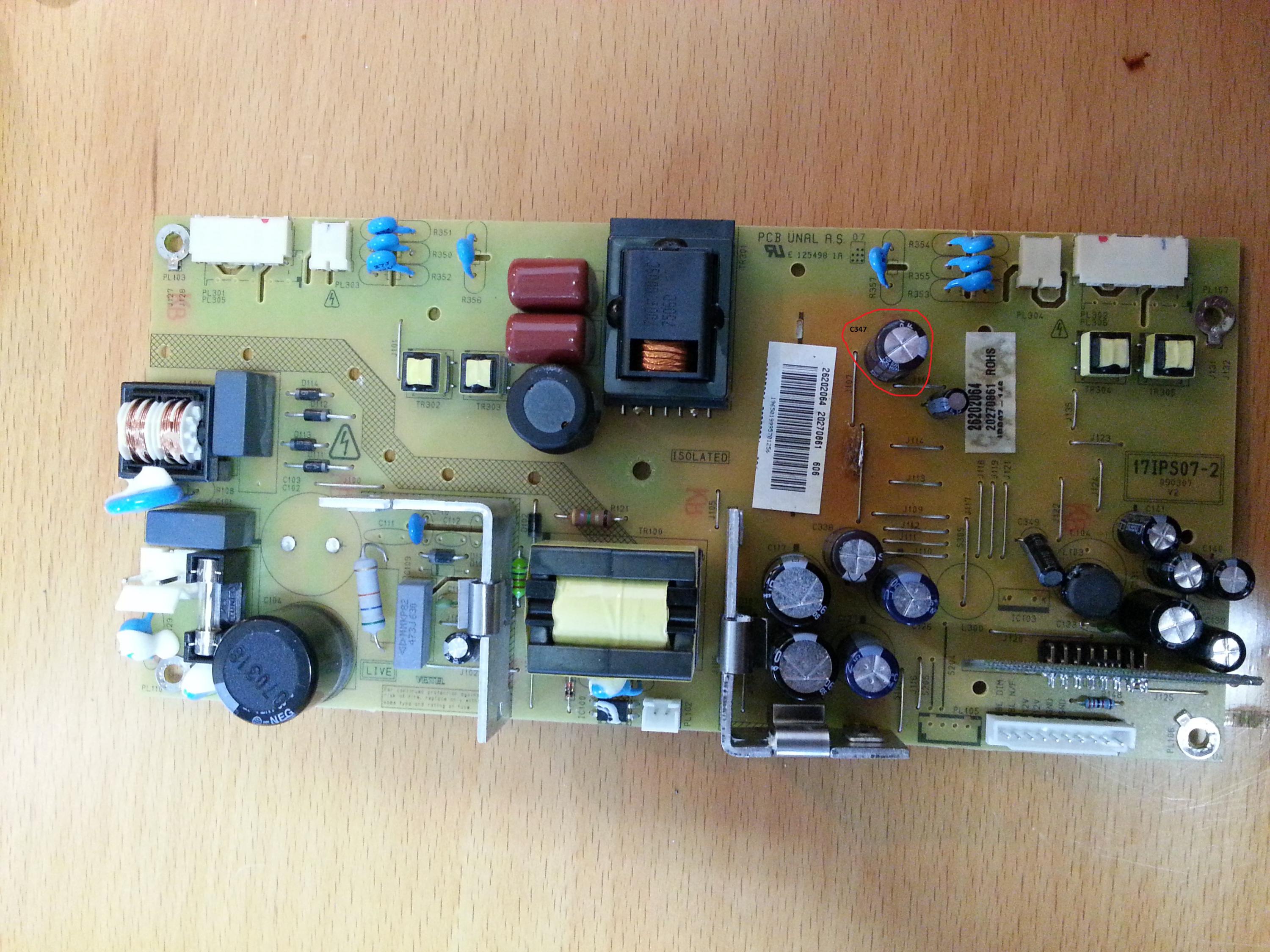

    Hi there
    I have a Toshiba LCD TV that has black screen (no backlight)
    but shows image when directed a light onto the screen.
    C347 & C338 (both are 470uf 25v chang) were bulged, I replaced them with 470uf 25v su'scon I had here.
    Both fuses are ok, I only found 2.
    I noticed no change in that repair.
    What else could be the culprit?
    I hope the pictures are good enough, I took them with my galaxy s3 phone.

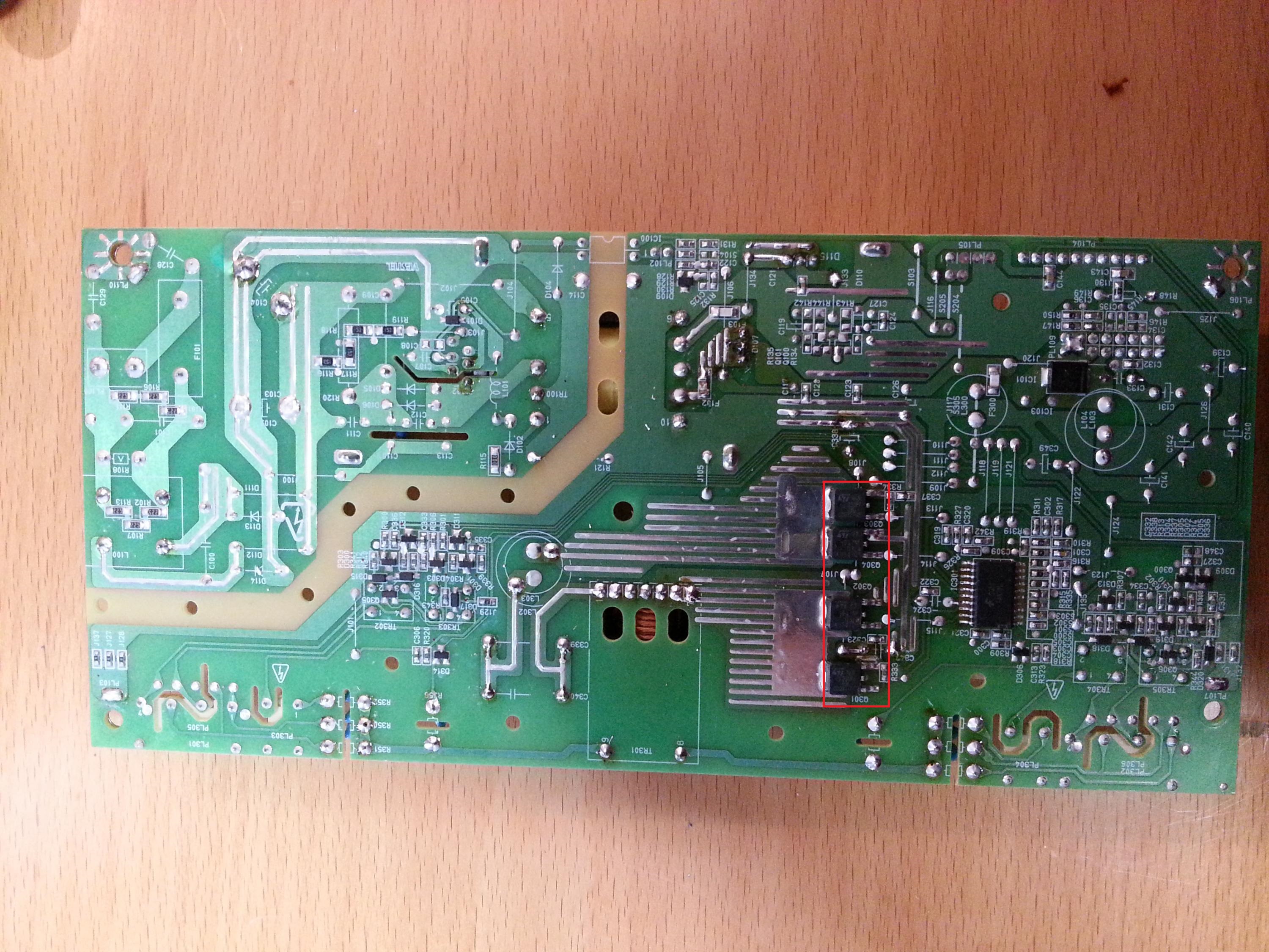

      have you checked white smd fuse f300 on back of board?
      • playman
        • Jan 2011
        • 252
        Re: Toshiba 20W300PG No backlight
        I checked it in circuit got no reading @ 200Ohm, switched to 200kOhm and got a reading of 53.1 then gradually
        lowering down to 39.7 which I stopped measuring, checked it again 3-4 Min later and got a reading of 1.7 @ 200kOhm
        and it gradually raised to 7.1 which is when I stopped measuring.
        Is that normal?
        I also noticed another fuse on the board F103 which measured 1.3Ohm @ 200Ohm
        I can always measure SMD fuses in circuit right?
          the fuse should read the same as when you have the red and black leads together (short circuit)but must be measured across the fuse not to ground Flocko
          • playman
            • Jan 2011
            • 252
            yea that's what I did, I measured across the fuse, the meter gives me 0.8Ohm @ 200Ohm reading when I connect my leads together.
            Do you believe that the F300 is broken?
            • flocko
              • Nov 2012
              • 1121
              • uk
              looks that way,if you have no new fuse to replace itwith use a fine wire across the fuse for testing only, if that works and the backlight comes on then you can get the correct fuse. Flocko
              • playman
                • Jan 2011
                • 252

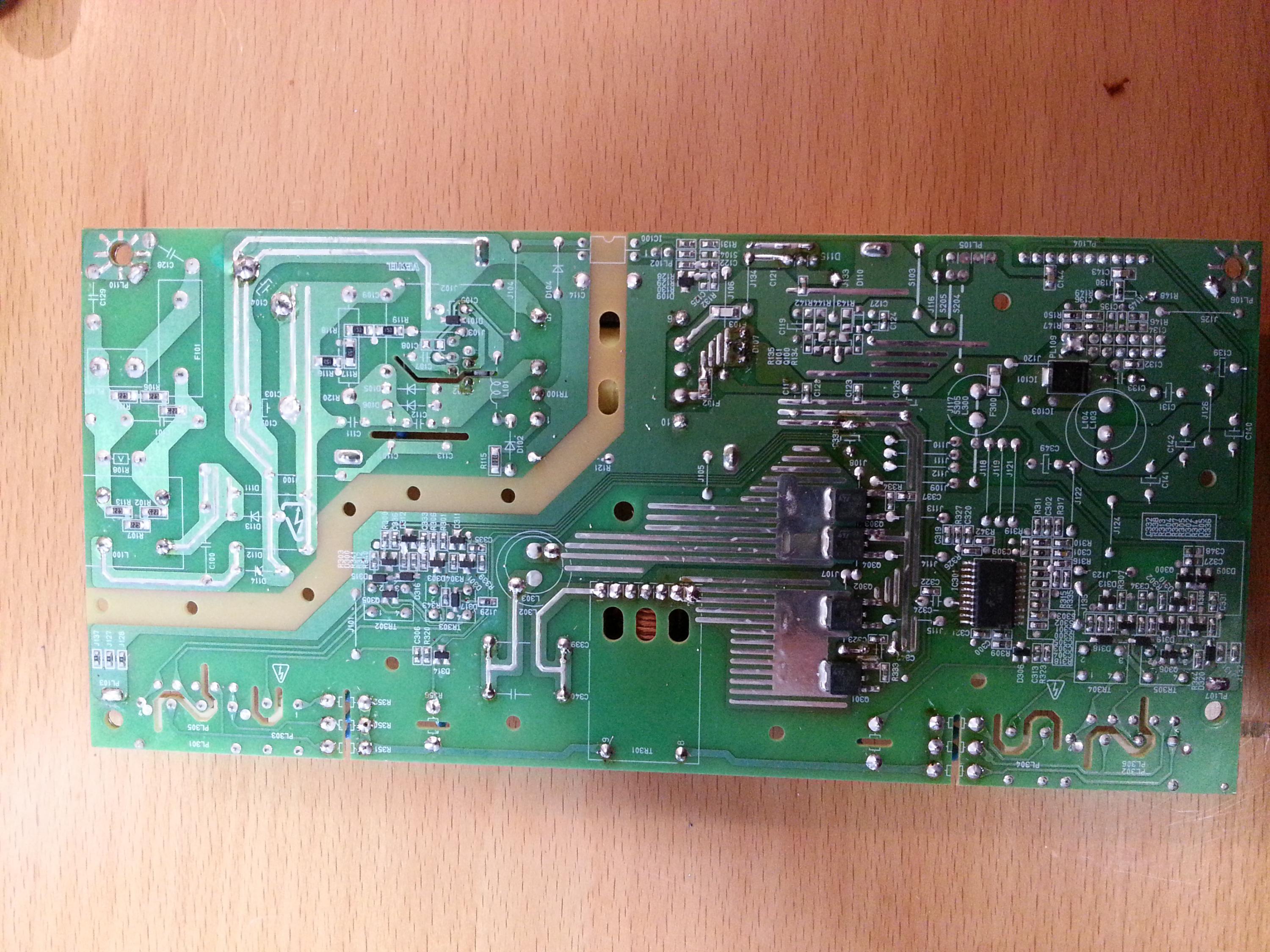

                Ok I de-soldered the fuse and tested it and it was broken, it says 3 on it, that means 3A fuse right?
                I soldered a wire where the fuse was, plugged the TV in and saw a standby light, tried to turn it on and nothing
                happened, standby light changed into fast blinking and then few seconds
                later it disappeared and now it's like the TV is completely dead, No lights visible.
                Wire seems still be intact.
                No visible damage can be seen, no sound was heard or smoke/smell.
                All 4 the fuses (main, F102, F103, F300 wich is a wire) are okay, I just know of those 4.
                        Need to check those 4 SMD Power MOSFETS Q301~304 to see if it has S to D shorted out or have very low resistance.
                          Originally posted by Caleb
                          remove the wire you put in and see if it returns to its previous behavior, if so you havent fouled anything else up yet, then work down the line and see if you can find shorted components in that section. I would look at that quartet of mosfets as likely suspects.
                          After I removed the wire it seems to return to previous state, show's standby light and
                          turns on and I can see the menu with a flash light.
                          Then I would guess that D is pin 2 and S is pin 3 right?
                          Q301=Red probe on D(2) Black on S(3) = Open Cirquit (no reading)
                          Q302=Red probe on D(2) Black on S(3) = Open Cirquit (no reading)
                          Q303=Red probe on D(2) Black on S(3) = 188.4 @200Ohm
                          Q304=Red probe on D(2) Black on S(3) = 10.4 @200Ohm
                          Q301=Black probe on D(2) Red on S(3) = 1638 @ 2000kOhm then open circuit (no reading)
                          Q302=Black probe on D(2) Red on S(3) = 1677 @ 2000kOhm then open circuit (no reading)
                          Q303=Black probe on D(2) Red on S(3) = 53 @ 200kOhm and degreasing rapidly down
                          Q304=Black probe on D(2) Red on S(3) = 10.5 @ 200Ohm
                          Is it right to guess that all FET's are broken except Q304?
                            Looks like Q304 is definitely bad, Q303 maybe.
                                Given the cost of four FETs is likely to be minimally more compared to just two, I would replace them all.
                                • playman
                                  • Jan 2011
                                  • 252
                                  I was about to order the parts when I noticed that the FET's have two different
                                  type numbers 2x STD30PF03L & 2x STD17NF03L, I hope that does not make the measuring bad.
                                  The problem is the STD30PF03L has not been available in the store here in Iceland since 2009, and
                                  Farnell their supplier don't have it either.
                                  Is there any other FET I can use instead of the STD30PF03L?
                                  http://pdf1.alldatasheet.com/datashe...TD30PF03L.html
                                  http://pdf1.alldatasheet.com/datashe...TD17NF03L.html
