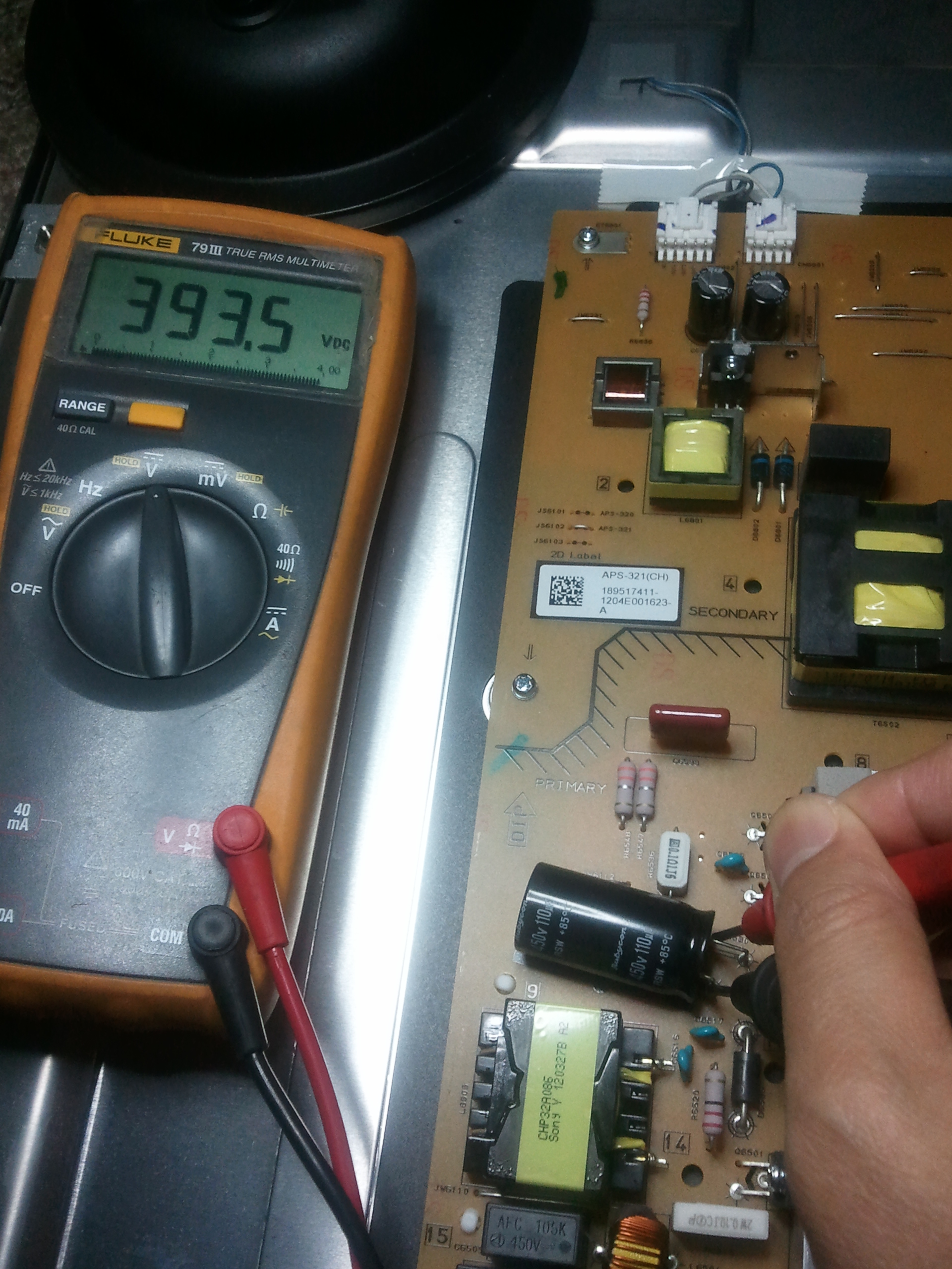

Sony Bravia KDL-46EX640 no power

    Switch should be fine. Use ohm meter (set unplugged) to test switch. Your getting 390 vdc on big filter cap. Your signal from main board to p.s. is telling set to turn on. Unplug the main board and plug it in wall if it still turns on there USA PS issue too

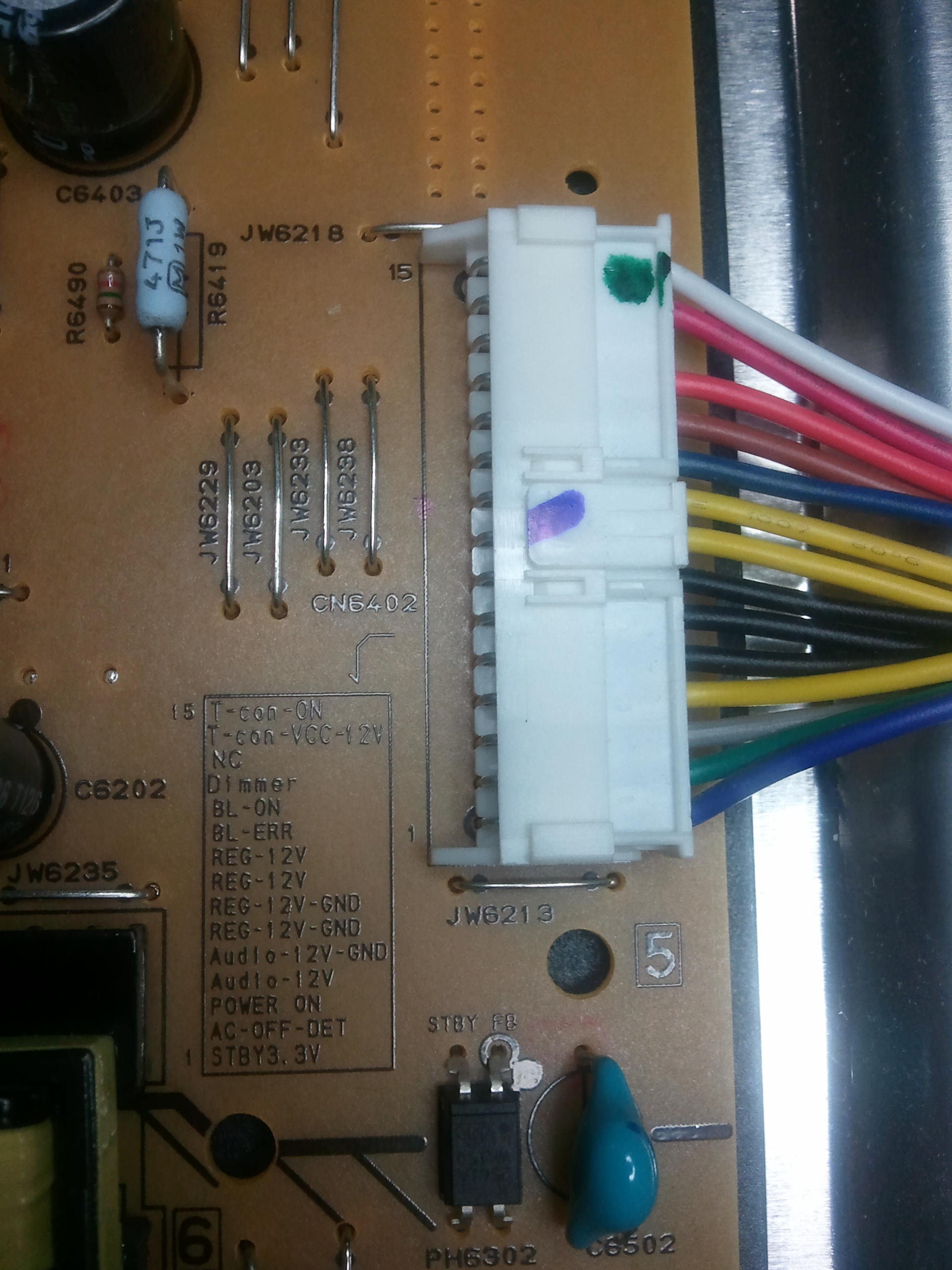

        By the way what is this component labeled as FB6301 at the power supply board?

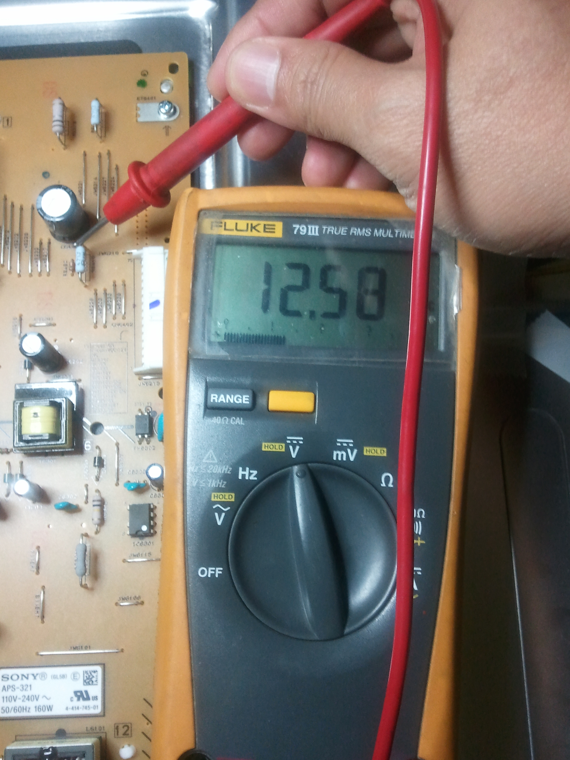

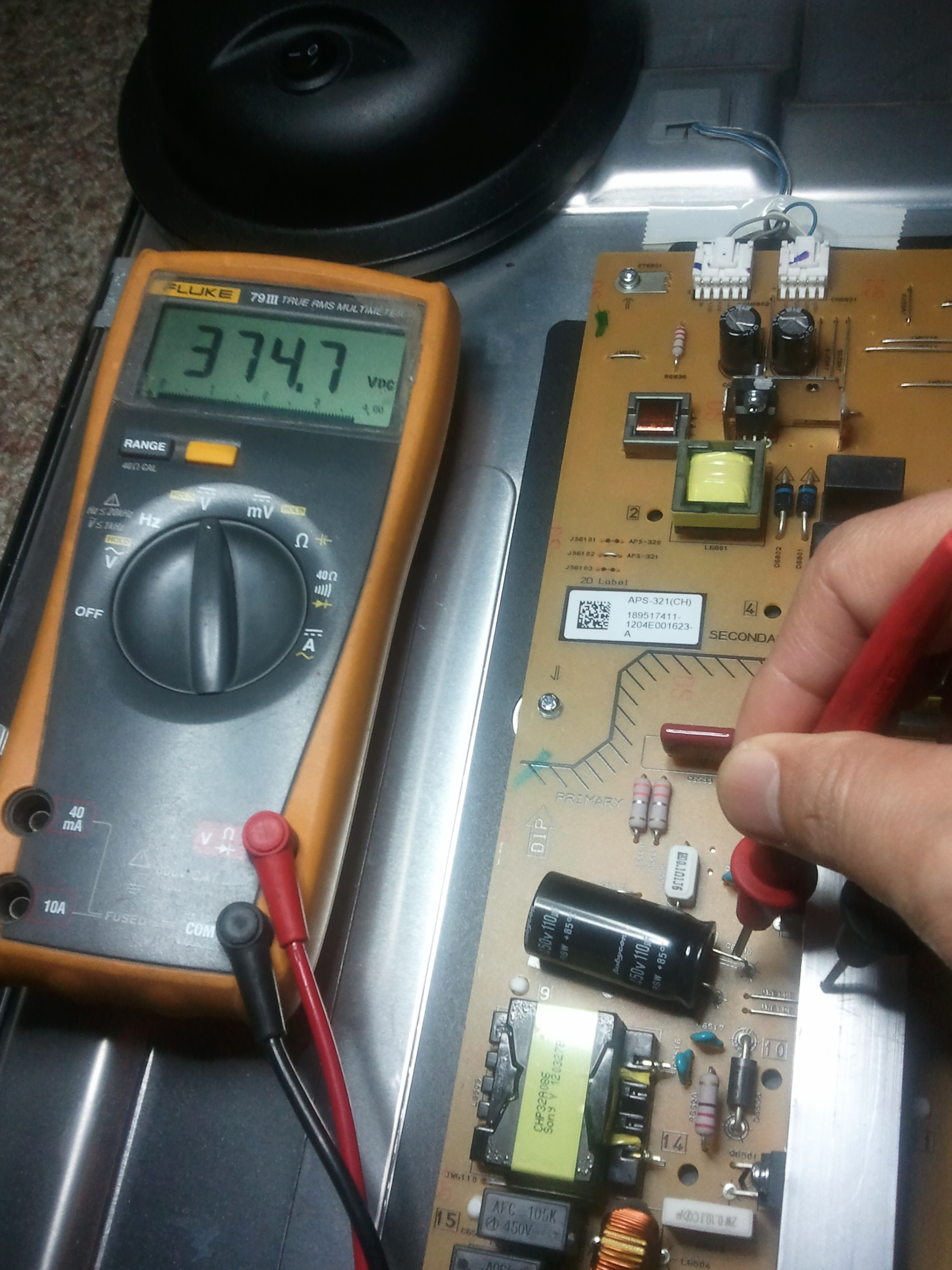

            I have done some simple voltage tests. Please see attached pics.

              Re: Sony Bravia KDL-46EX640 no power
              At the white connectors:
              T-Con ON = 0 V
              T-Con-Vcc-12 = 0 V
              NC = N/A
              Dimmer = 0 V
              BL-ON = 0 V
              BL-ERR = 3.310 V
              REG-12V = 12.58 V
              REG-12V = 12.58 V
              REG-12V-GND = 0 V
              REG-12V-GND = 0 V
              Audio-12V-GND = 0 V
              POWER ON = 3.307 V
              ACC OFF-DET = 2.933 V
              STBY 3.3V = 3.327 V
              Any suspects?

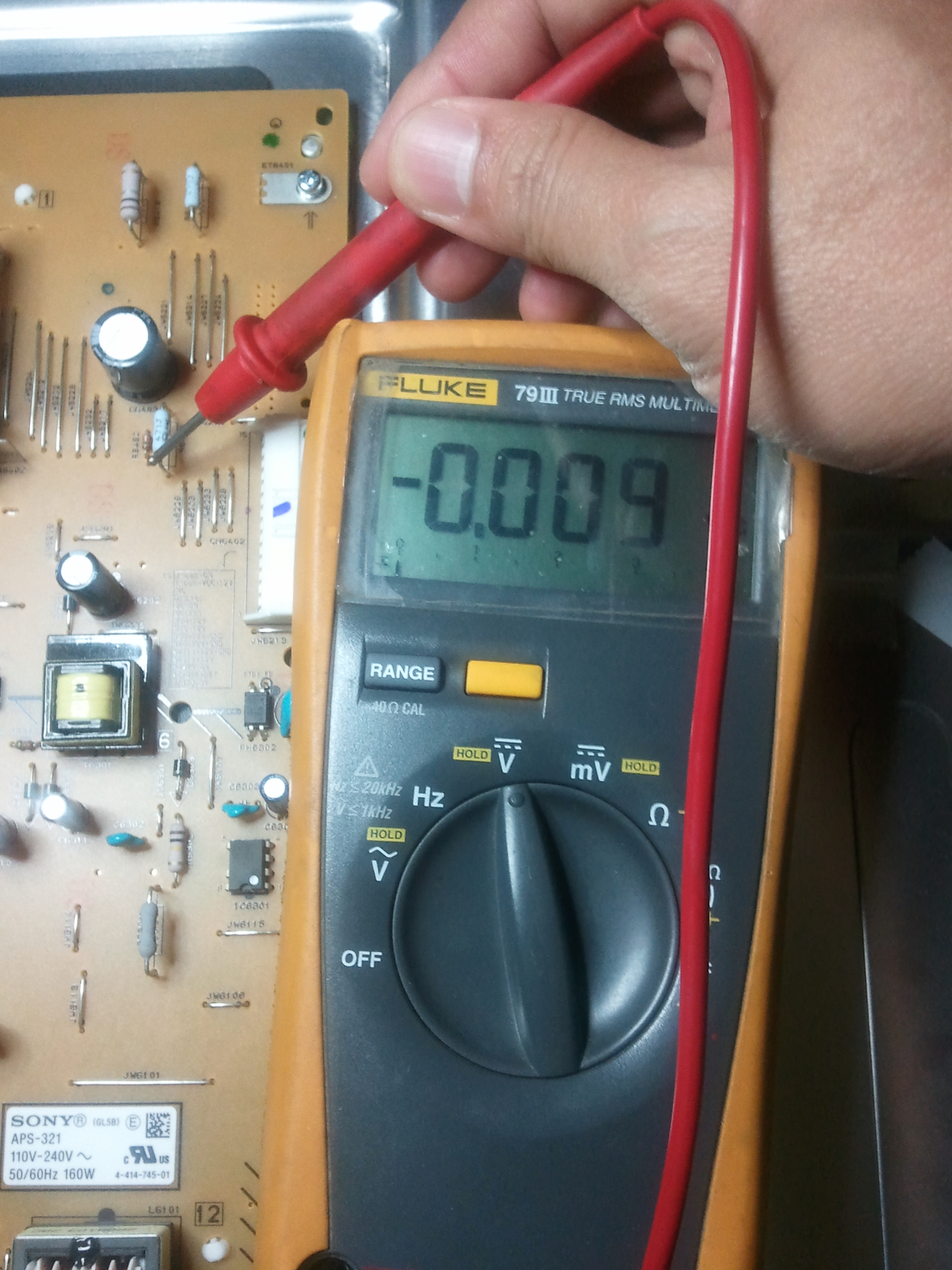

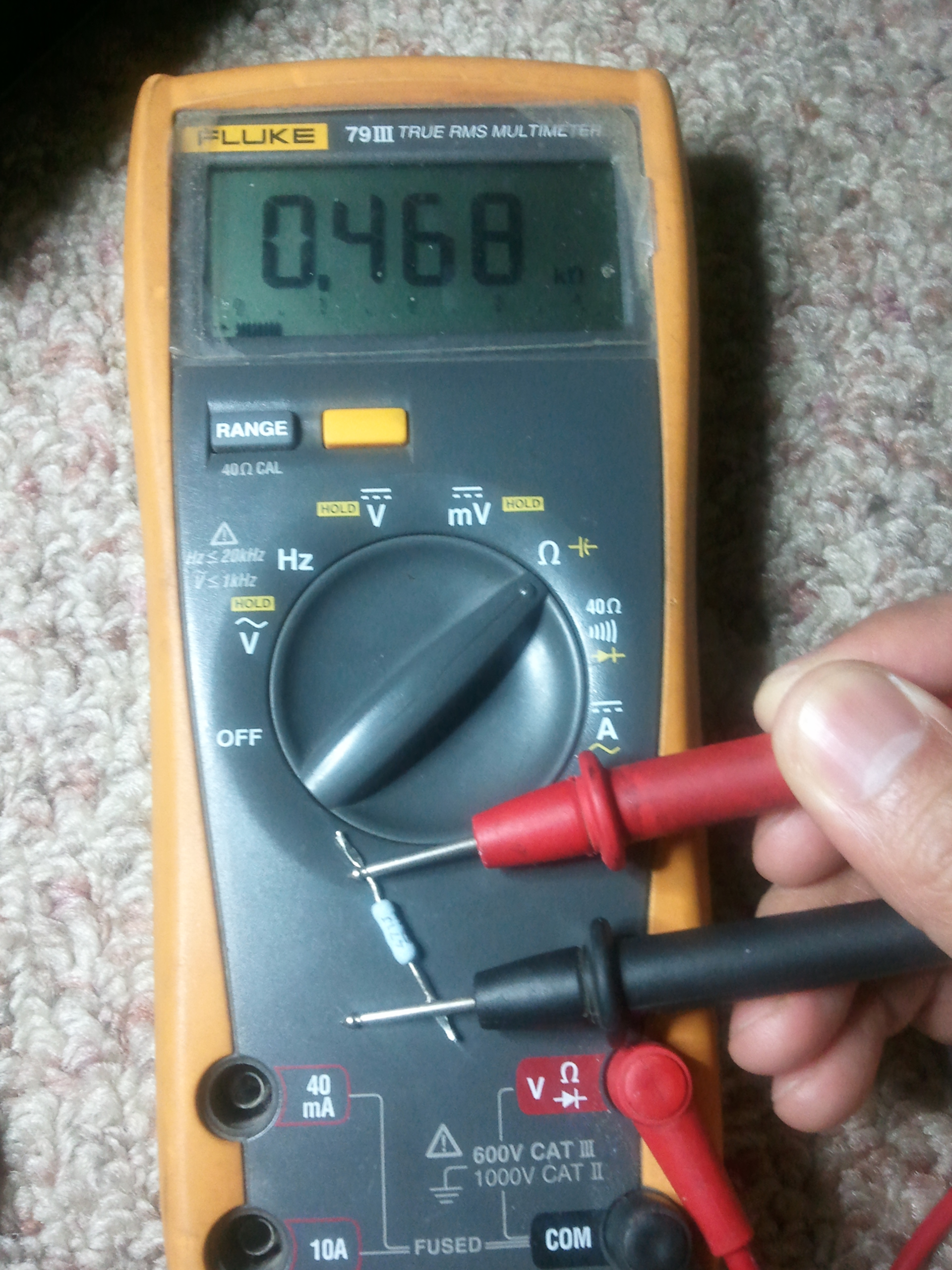

                Also, if I voltage check R6419 the one side is 0V but on the other side is 12.5V. You can see the component on the first pic posted above.
                I pull out this resistor labeled as 471J 1W and here is the measured resistance 468 ohms.
                  Maybe one side goes to ground.
                    Possible since looking back at the white connector designation it directly connects to the following pins:
                    REG-12V-GND
                    REG-12V-GND
                    Audio-12V-GND
                    But, the other side of the resistor is directly connected to the positive side of 1500uF/16V electrolytic capacitor which I also checked the capacitance and ESR values and are OK.

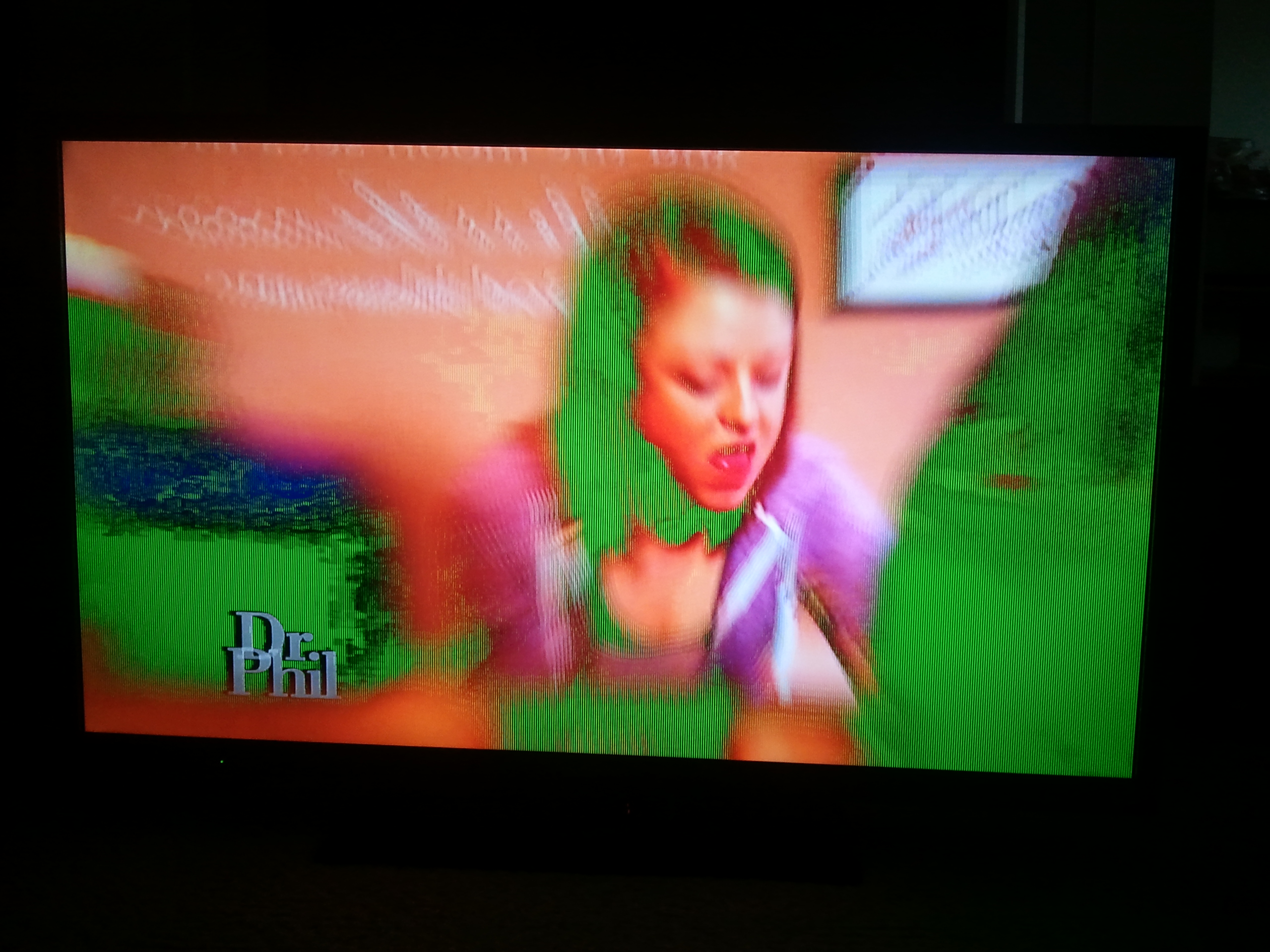

                                      just received the mainboard I ordered. It finally turns ON but here are the results.
                                      Any inputs?
                                        #39
                                        Well, now at least the TV comes on and have pictures. Does this main board match the old board P/N?
                                          #40
                                          Check the LVDS cable is properly seated both ends.
