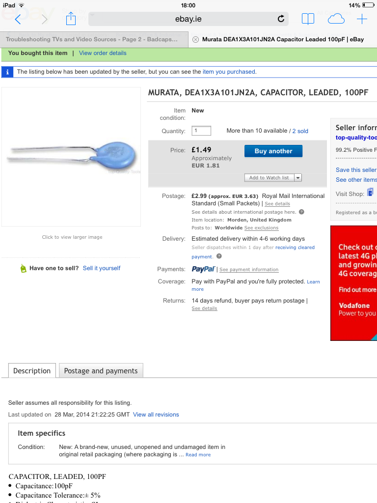

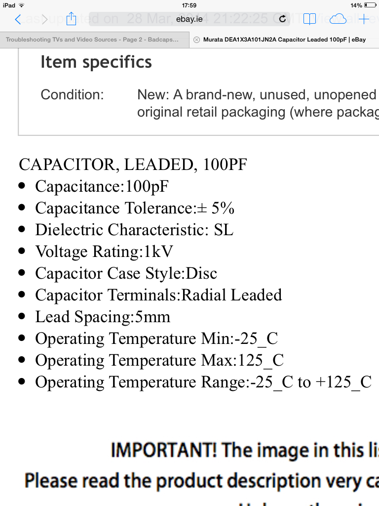

                          I bought a new cap from ebay, havent installed it yet but ive attached pics of the specs. It is however a bit smaller and thinner.
                          I'm wondering now what risks will come into play if it is the wrong cap. I've searched the net but cant find any info on my board so it'll have to be trial and error
                            #33
                            Re: Cap exploded...help required. Philips LCD 42PFL5404H/05
                            The spec matches the one from Mouser, hope it is not fake.
                                So I soldered the new cap in, connected everything back up and the tv powered up as normal. Happy days, I'll monitor it for a bit just for peace of mind. Cheers lads
