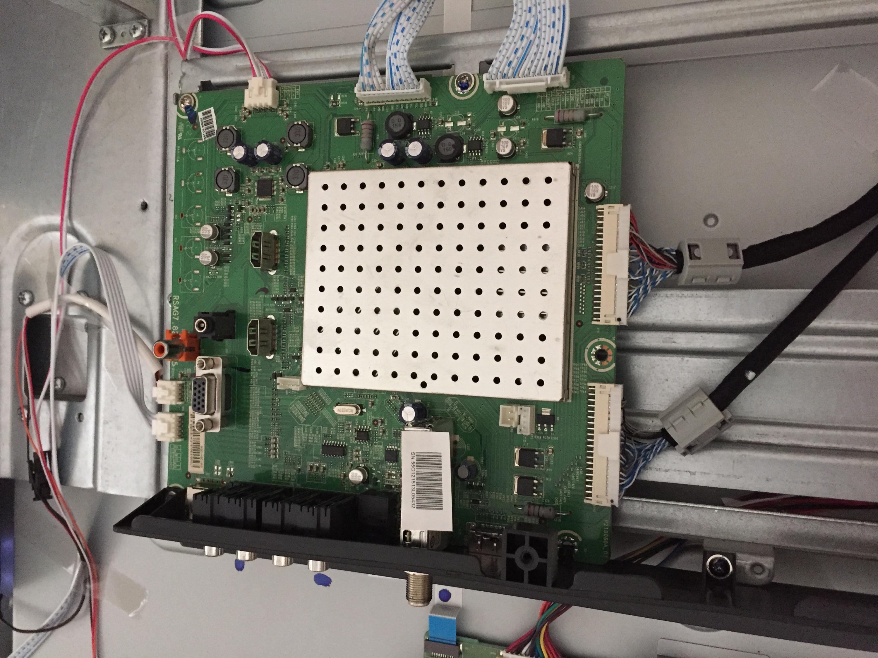

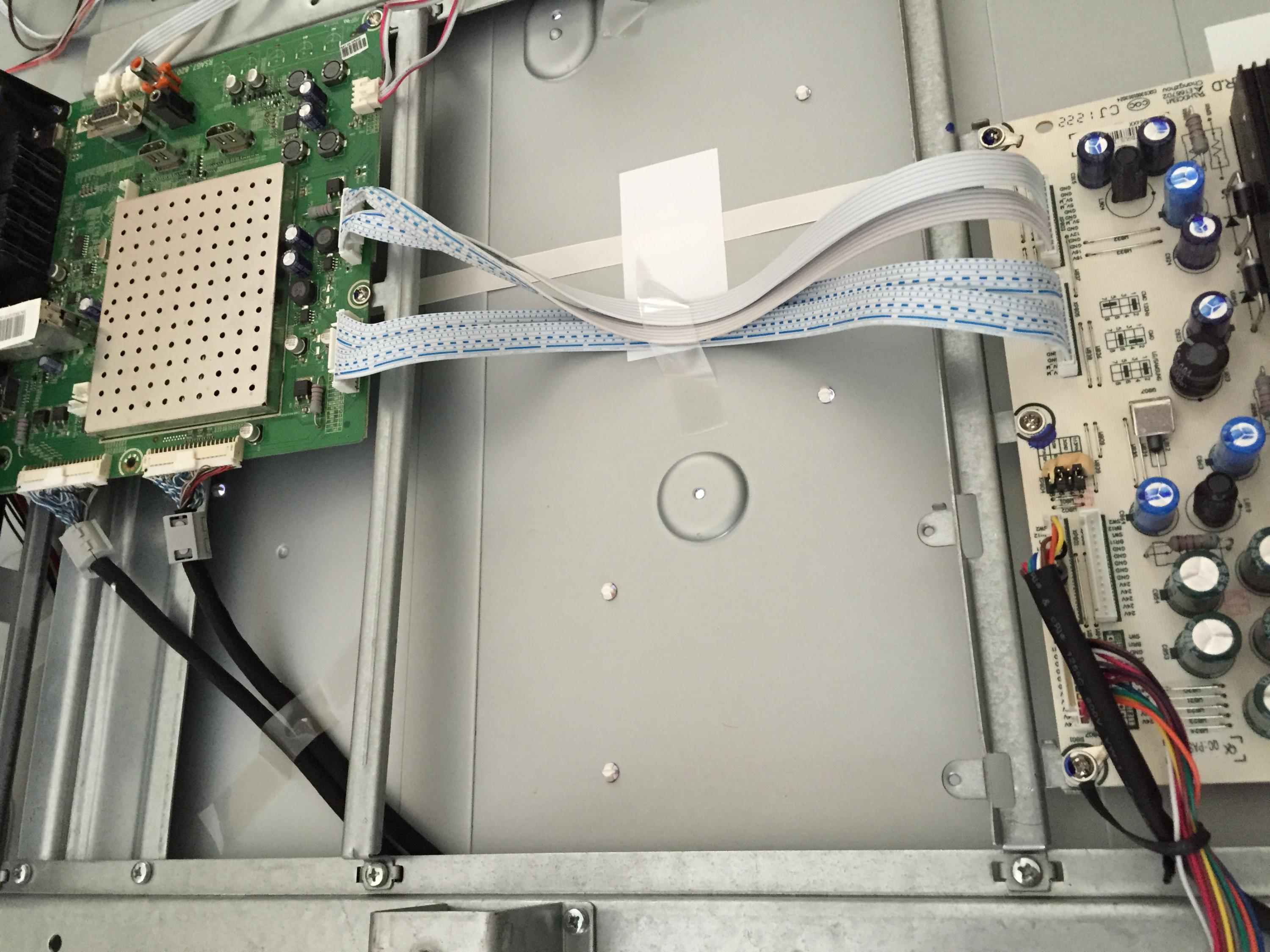

      l am having essentially the same issue with my Insignia NS-55L260A13 the Dynex and Insignia are closely related devices.
      The TV often will not turn on. I have to remove it from Power completely and plug it back in for it to turn on. (And this only helps sometimes)
      I found many people having the same issue on the Insignia Forum (http://community.insigniaproducts.co...own/td-p/72958) However there was no Technical Help given.
      So I took the TV apart and started to read the Voltage values and two of them (12V and 5V pins) were Low.
      There are no Bulging or leaking Capacitors.
      My Question now is, how to procede with the Troubleshooting, I do not know how to move on to the next step in resolving the issue.
      My next step would most likely be to take out all the capacitors and check their values, but I was wondering if you could guide me to a more efficient way in solving this.
      Unfortunately the replacement board is sold out. (http://www.shopjimmy.com/dynex-15188...upply-unit.htm)
      Attached is my board.

                Re: DYNEX DX55L-150A11 Randomly turns off
                OK, I can see that when the TV is not working properly, the main board is still sending out the PS-ON (Connector 'C' pin 12: ON/OFF) but it stopped sending out
                Connector 'C'
                pin5 (SW) 4.4V // 0V: BL-ON (Backlights ON)
                pin6 (PWM) 1.2V //0V: PWM DIMMING
                These two signals are from the main board and fed into connector 'C' and routed out to the connector 'A', and 'B' pin 12 which is then feed the inverter board.
                What caused those two signals to disappear I do not know exactly which parts are bad on the main board.

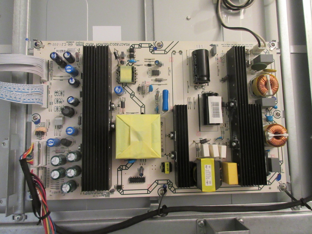

                          I just realized that i started this thread.. It's definitely the power supply.. I picked up another TV with a broken screen and swapped them out, problem solved.. Didn't get a chance to troubleshoot the old one... my wife broke the danm thing throwing it at me.. Joke gone wrong....SMH
                          Kept the other boards just in case i was wrong tho, but it's been the main TV for the last year no issues..

                                    Bad power supply. I have same problem. I replaced mainboard before seeing this post. Main did not fix problem. I am now trying to find powerboard problem. Going to replace N802. While poking around on pins it would turn off. I will update if I have any success
