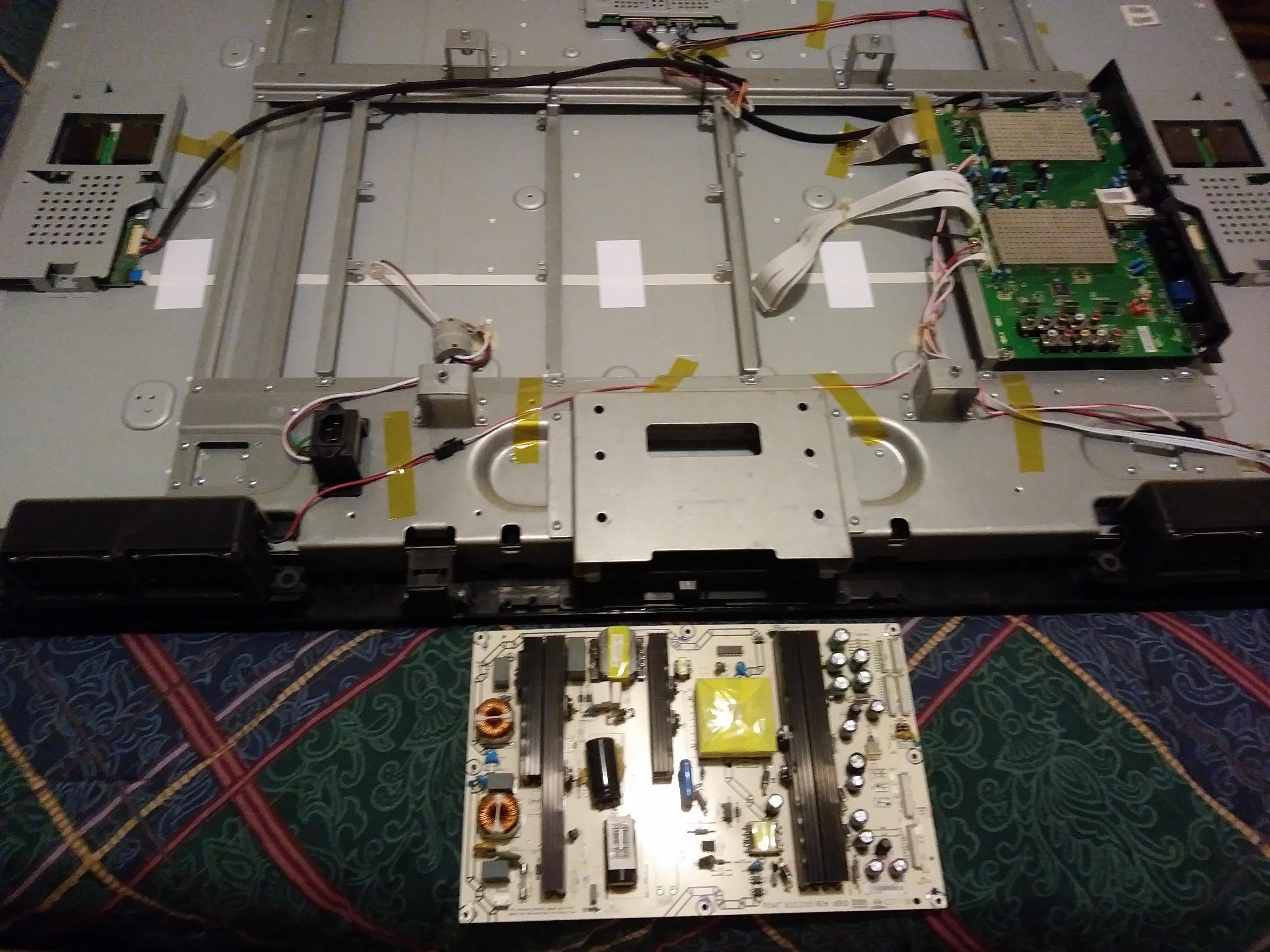

                Re: DYNEX DX55L-150A11 Randomly turns off

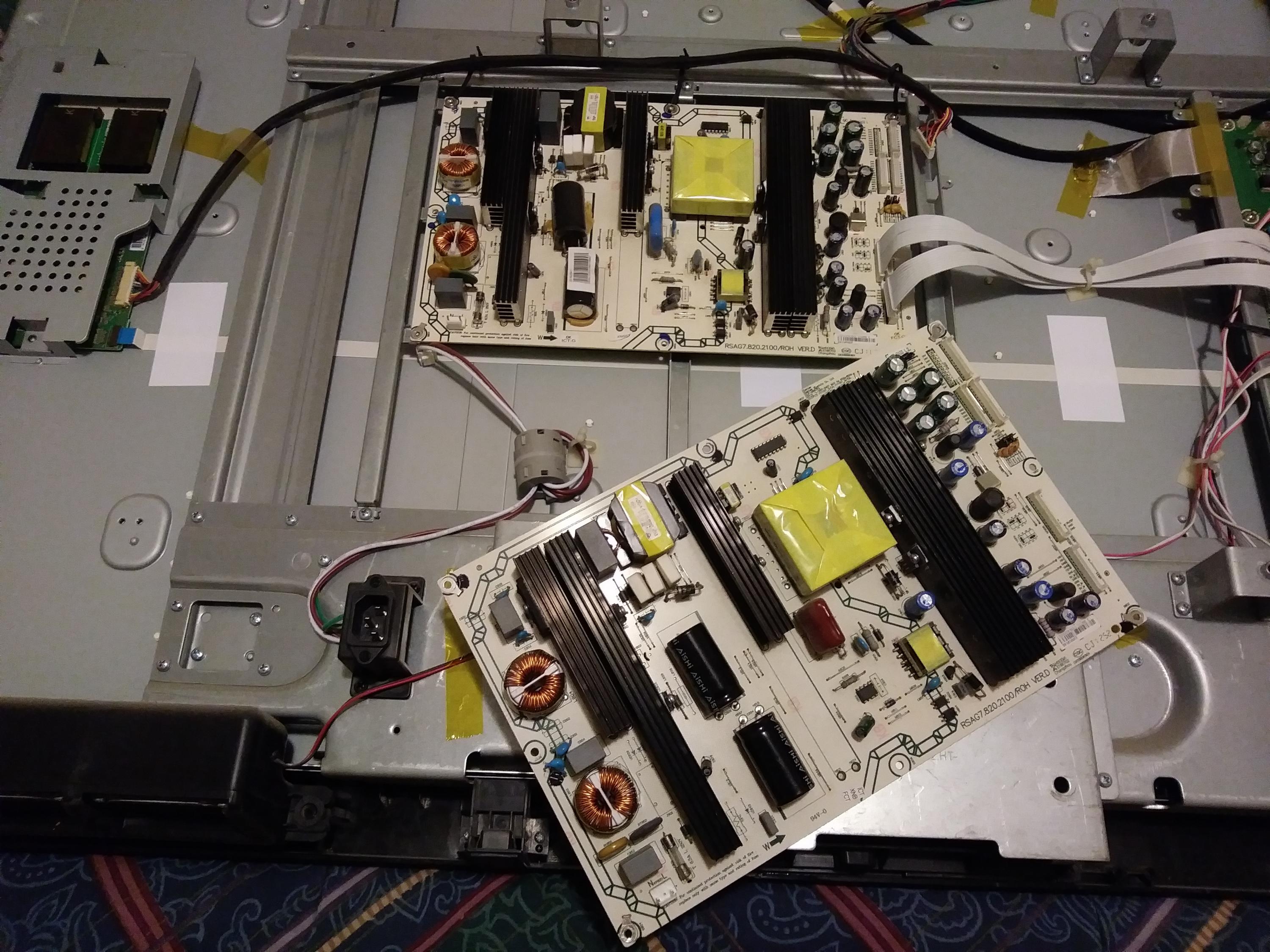

                I did a research on the internet about how can I fix my DYNEX DX55L-150A11 55", then I red some posts here and decide to buy a used LCD Power Supply Board Unit, I found 3 on e bay: https://www.ebay.com/itm/162736635194 (this is the link)
                So I swapped it and voila! IT WORKED and no more shut offs.

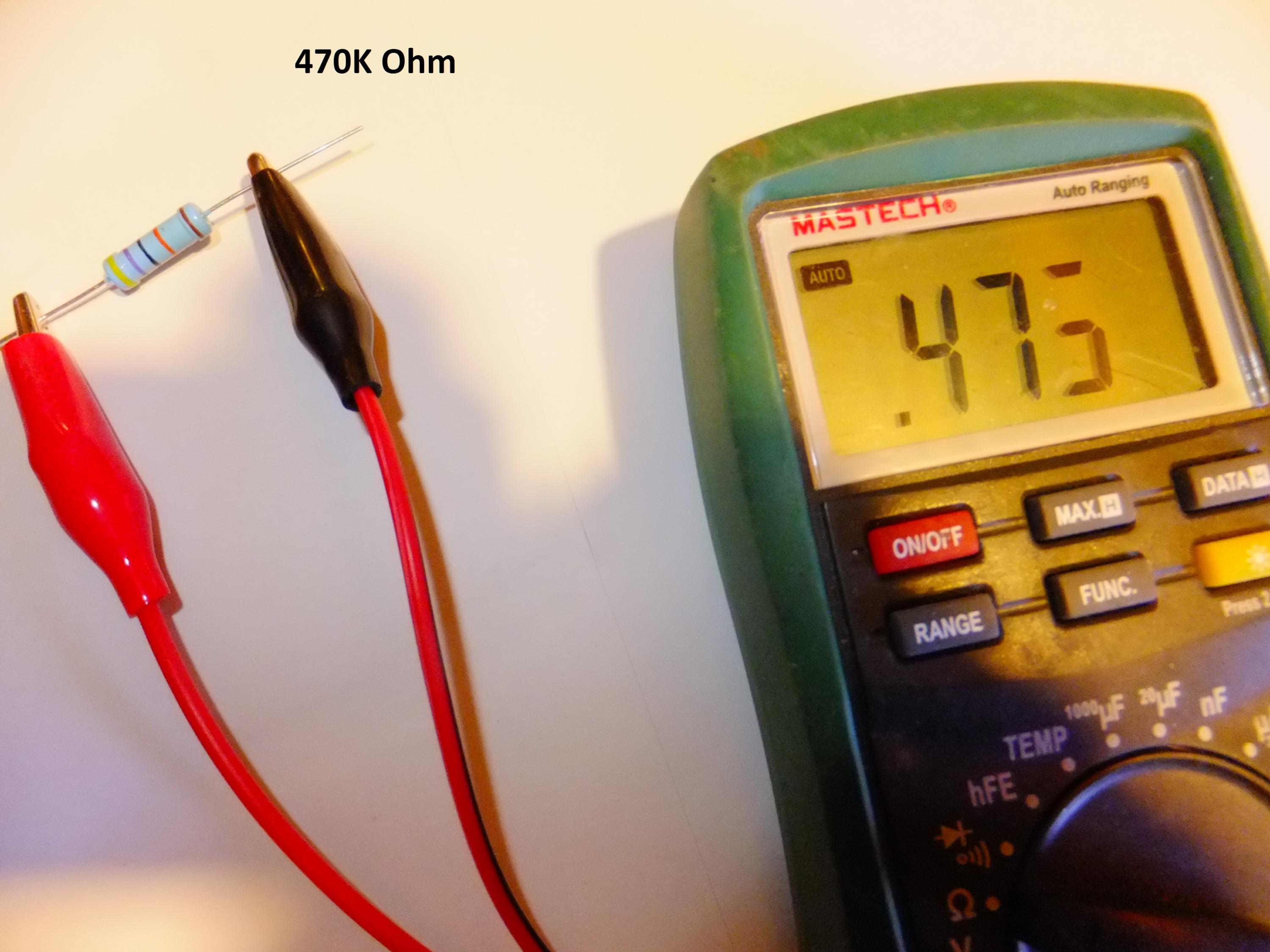

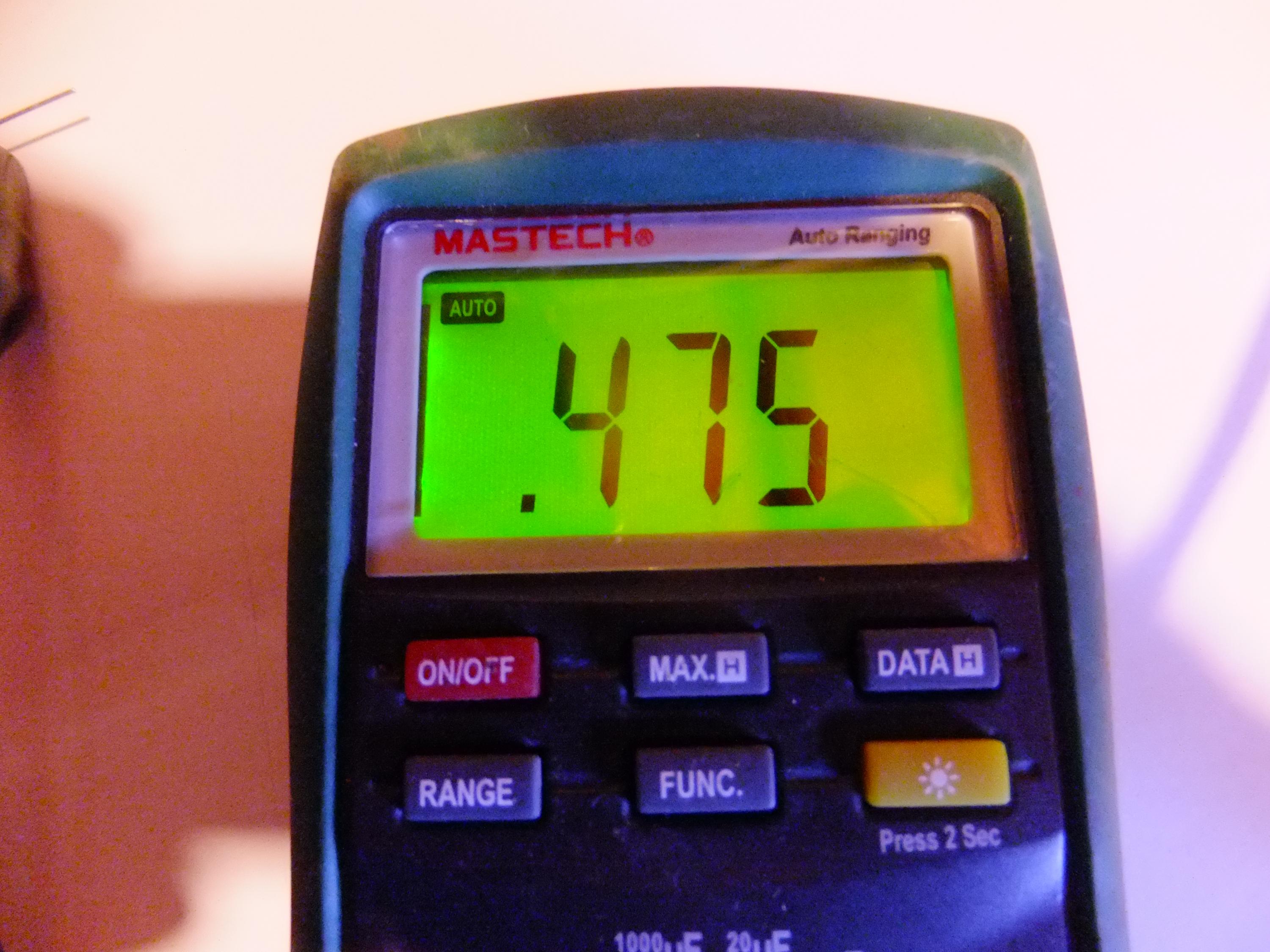

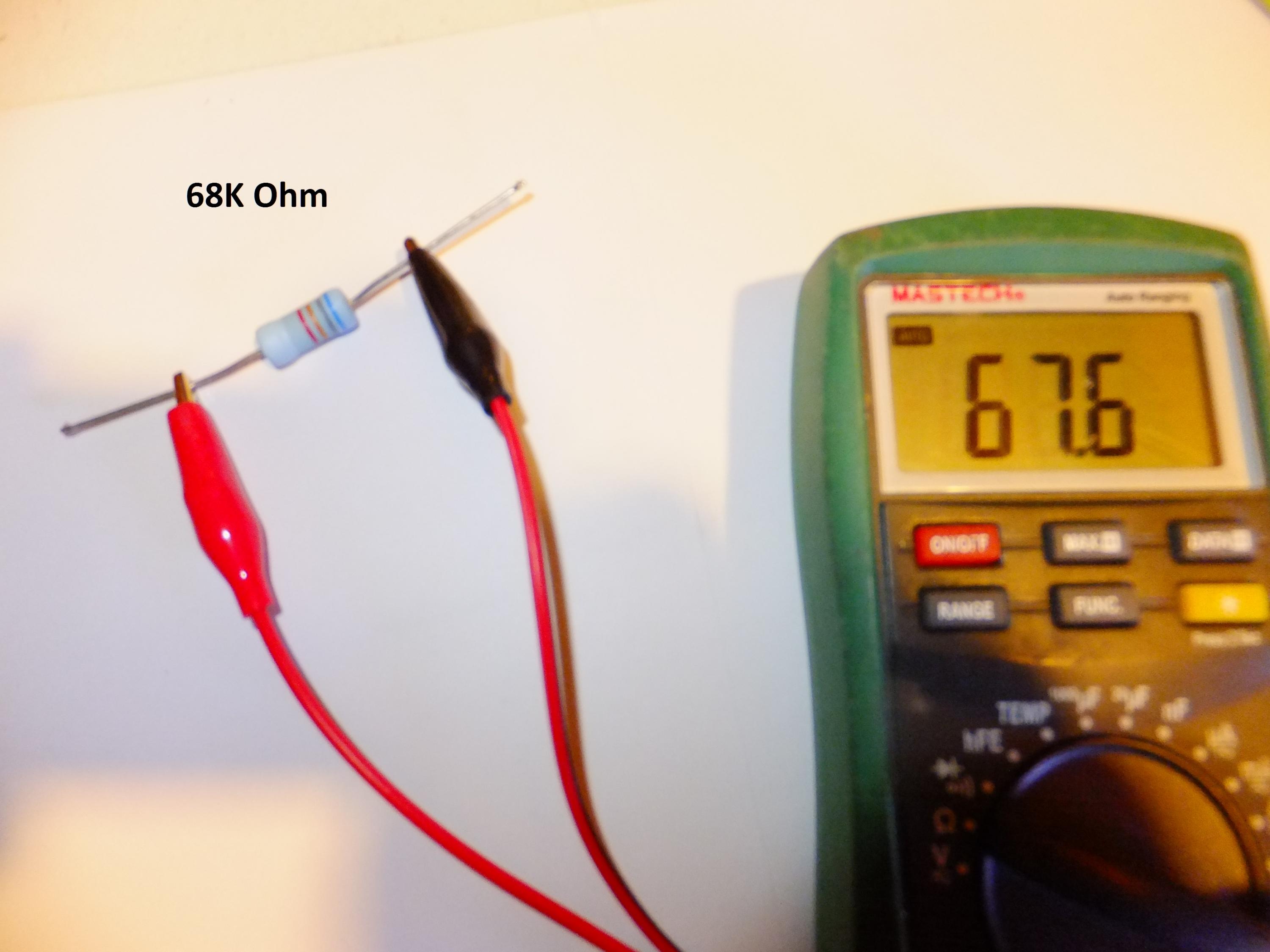

                    What about adding a 10k resistor? And why does my meter read 0.620 instead of 620.0 ohms? Some of my resistors read 68K 68.000 as such and some read 470K 0.470 so I am confused about that.
                      #90
                      Do you mean 0.620 with 'K' on your meter display?
                        #91
                        Yes, I have tested some resistors all that are K ohms and some read 0.620 but others read 62.0 and I am confused as why.
                        Maybe my meter is bad, I don't know. I think it is possible I am not reading the meter right, it is auto ranging. I will get the El Cheapo meter out and see what I get.

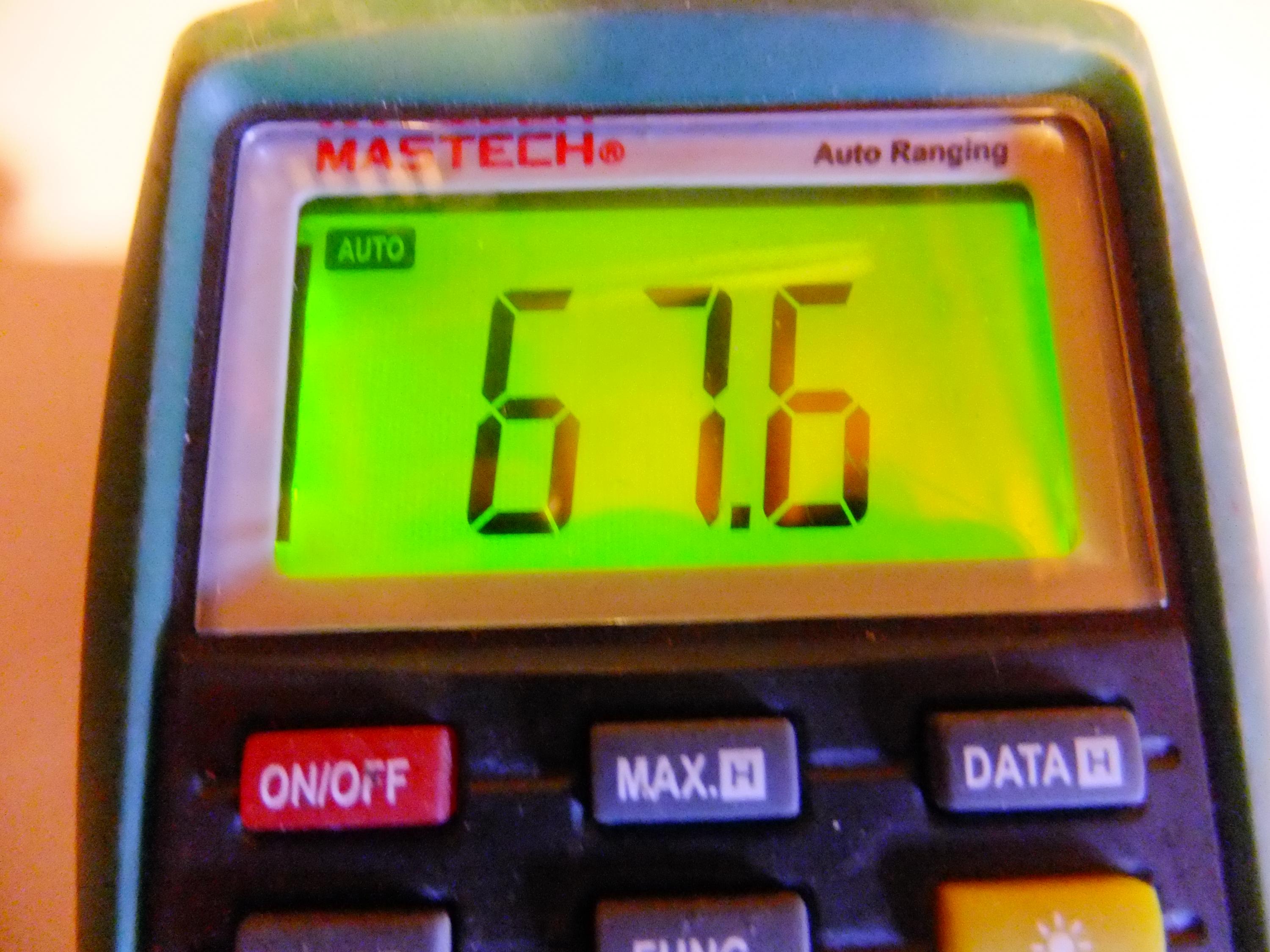

                            0.620 K Ohms = 620 Ohms.
                            Look at your meter display or post the pictures to show what it is showing on your meter, you should see letter 'K' right on the display.
                            Just remember one thing, wrong DATA will cause bad troubleshooting.

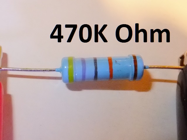

                              #94

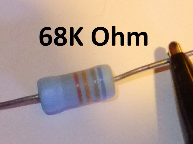

                              I think the problem is my meter (Mastech MS8221C) It is not showing any symbols such as K or M.
                              These pictures are a 470K and a 68K resistor
                                #95
                                OK well since we understand what your meter is telling you go ahead and take a resistance reading of all 3 resistors individually and let us know what you get.
                                My rule of thumb for this power supply design is even if they're reading good replace them anyways if you have the resistors available. Preventative measure. If they're not reading bad they will go bad eventually.

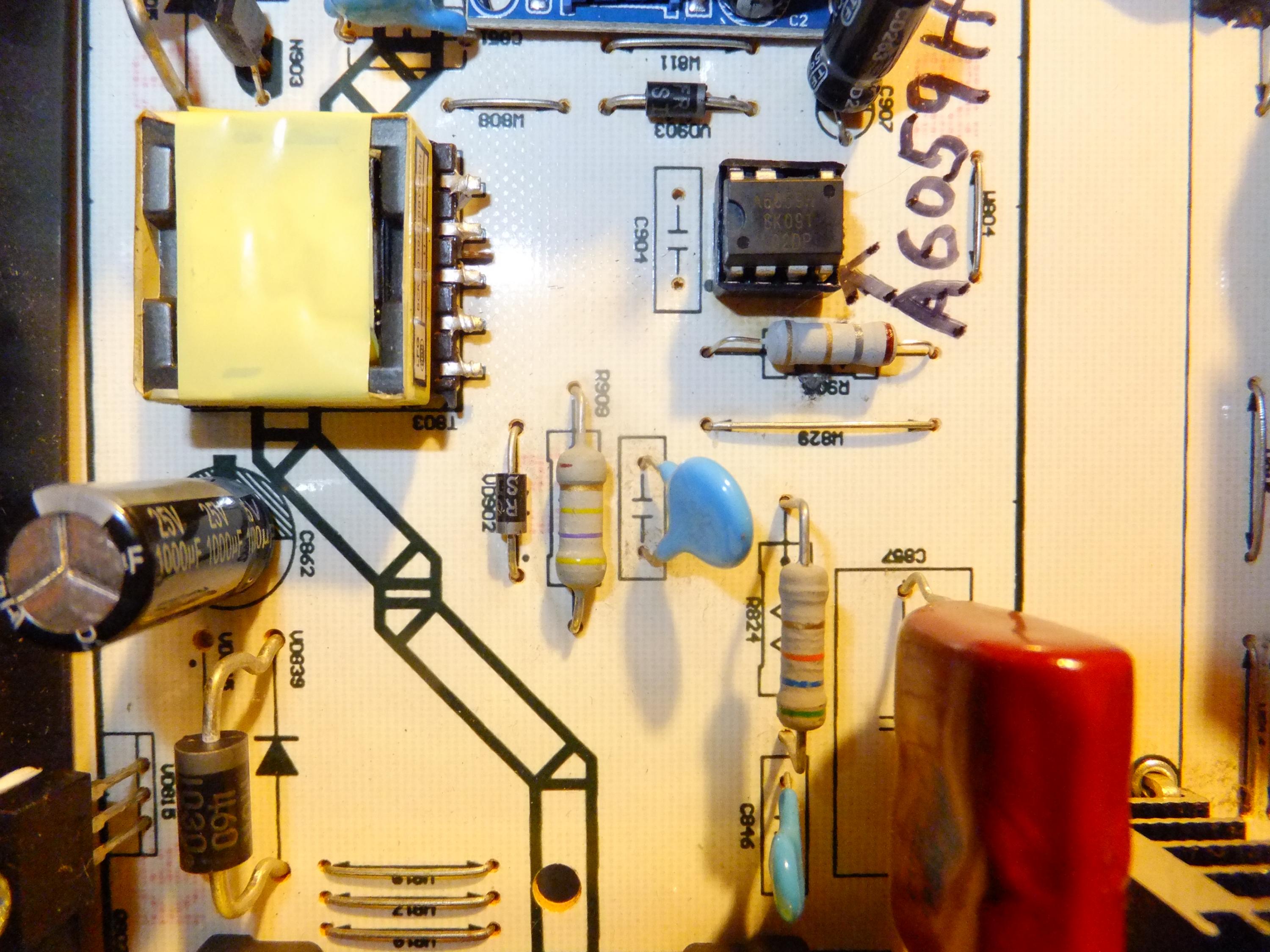

                                        #99

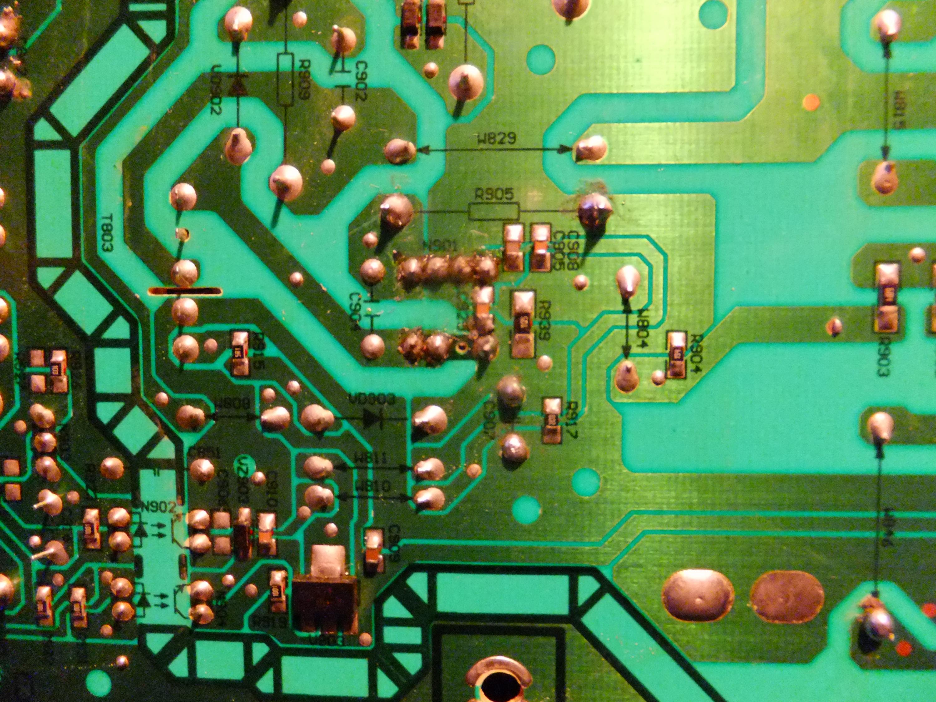

                                        Before the 5V standby went out the TV would shut off. I thought I fixed that because there was some bad solder joints and the TV was working great. About 3 days after the fix the Power Board exploded. The IC A6059H (N901) exploded and took out R905. I may have replaced R905 with the wrong value, does anyone know the correct value of R905? I replaced it with a 1.8 ohm resistor but I am not sure if the color of the second band is grey or black, the original was burnt. Here is a picture of the board on shopjimmy
                                        http://assets.shopjimmy.com/media/ca...1886-top_1.jpg
                                          What would cause my 5V Standby to fluctuate? It goes up and down from 1 volt to 5V but will not stay steady.
