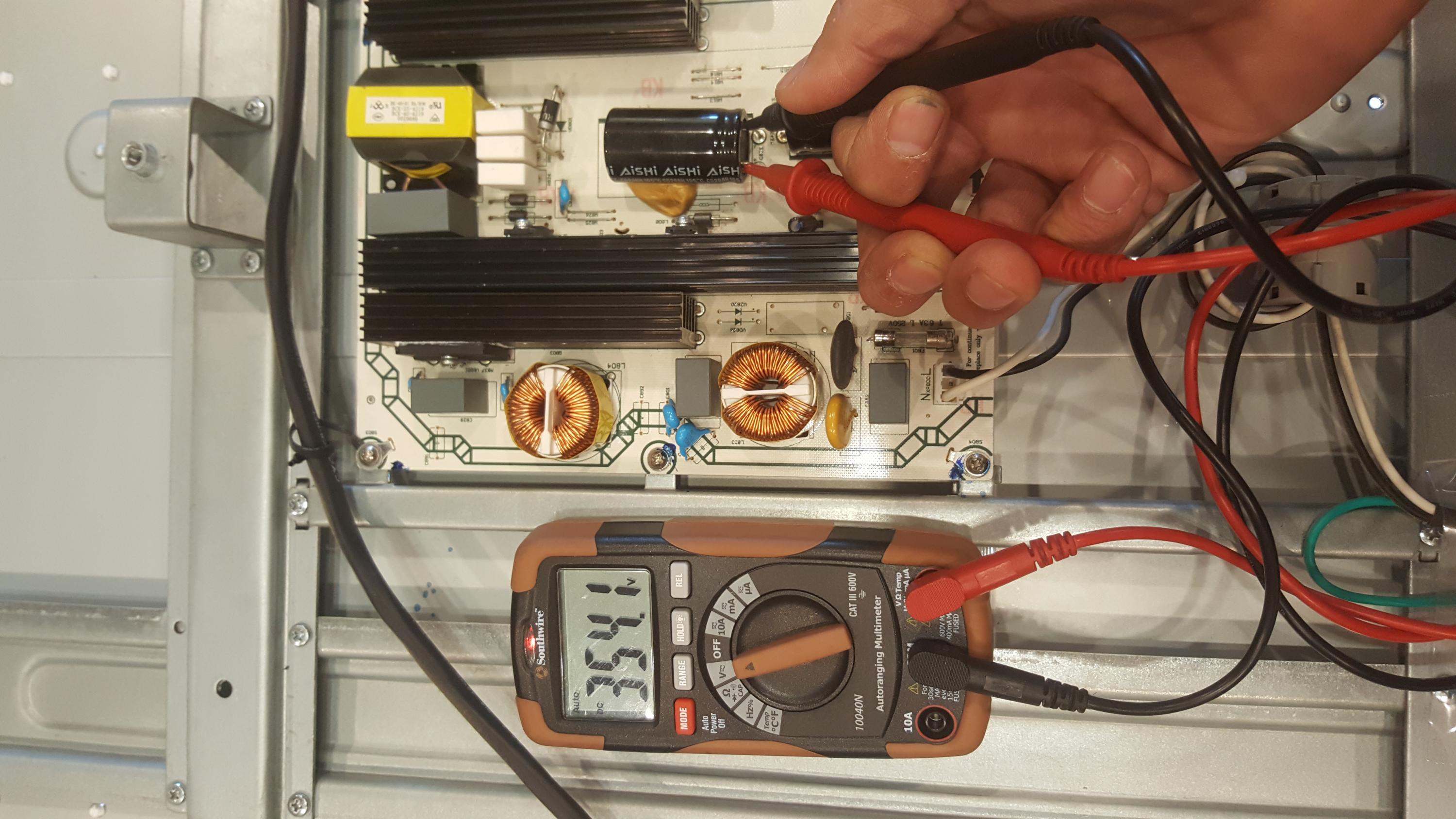

    These are what you are looking for. Yes, please report your findings of what the voltage is across main capacitors on power supply while tv is on. This is the large capacitor, there are two but only need DC reading of either one.
    Suspects are R085 and R086. My R084 seemed ok.
      #62
      Re: DYNEX DX55L-150A11 Randomly turns off

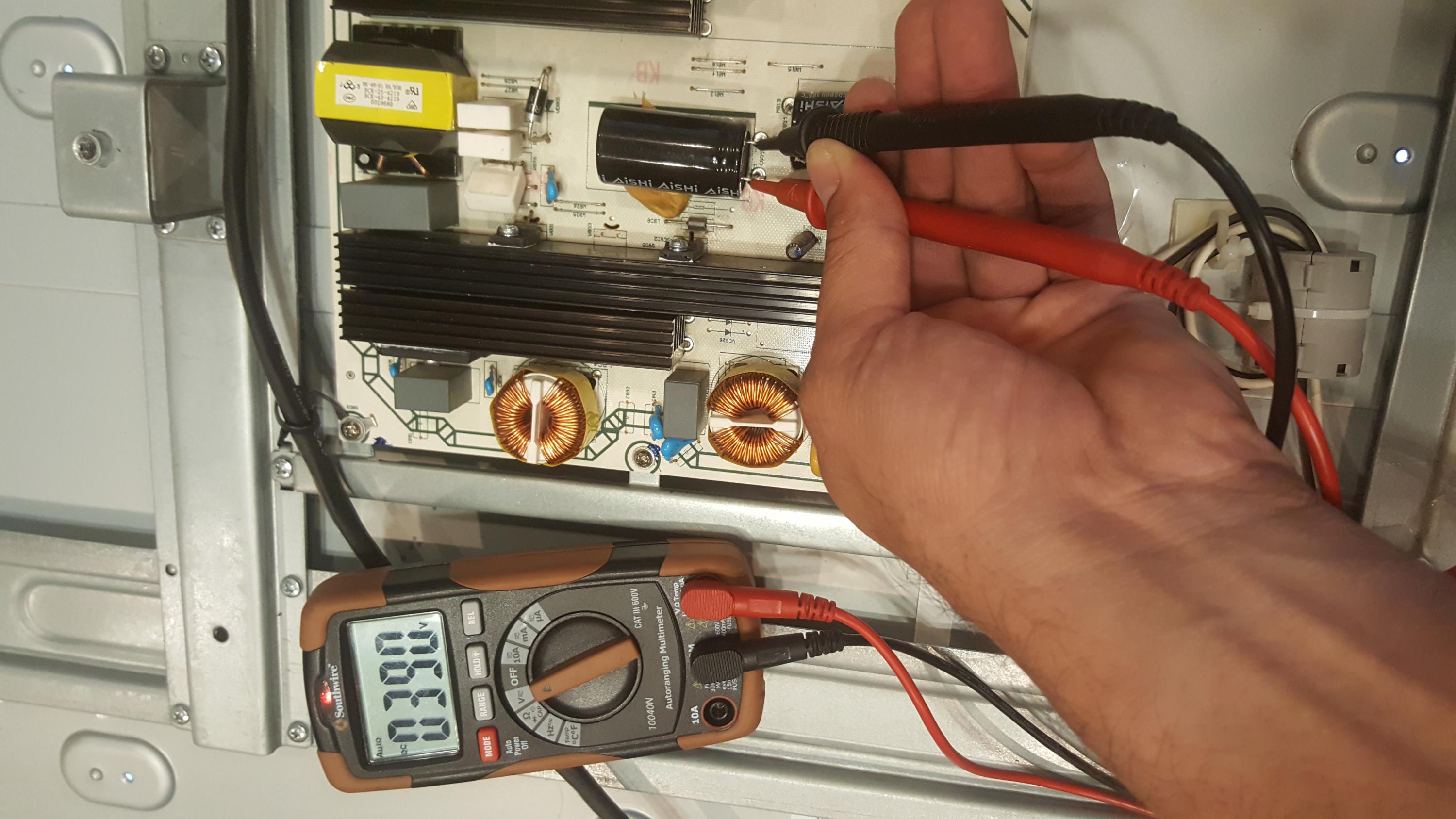

      Thank you for the reply guys I really appreciate it. I took a reading of the top capacitor and it read 354.1 volts. The one below that read 353.4 volts. Here's a picture of the top results. Once again, I really appreciate you guys helping me out. thank you

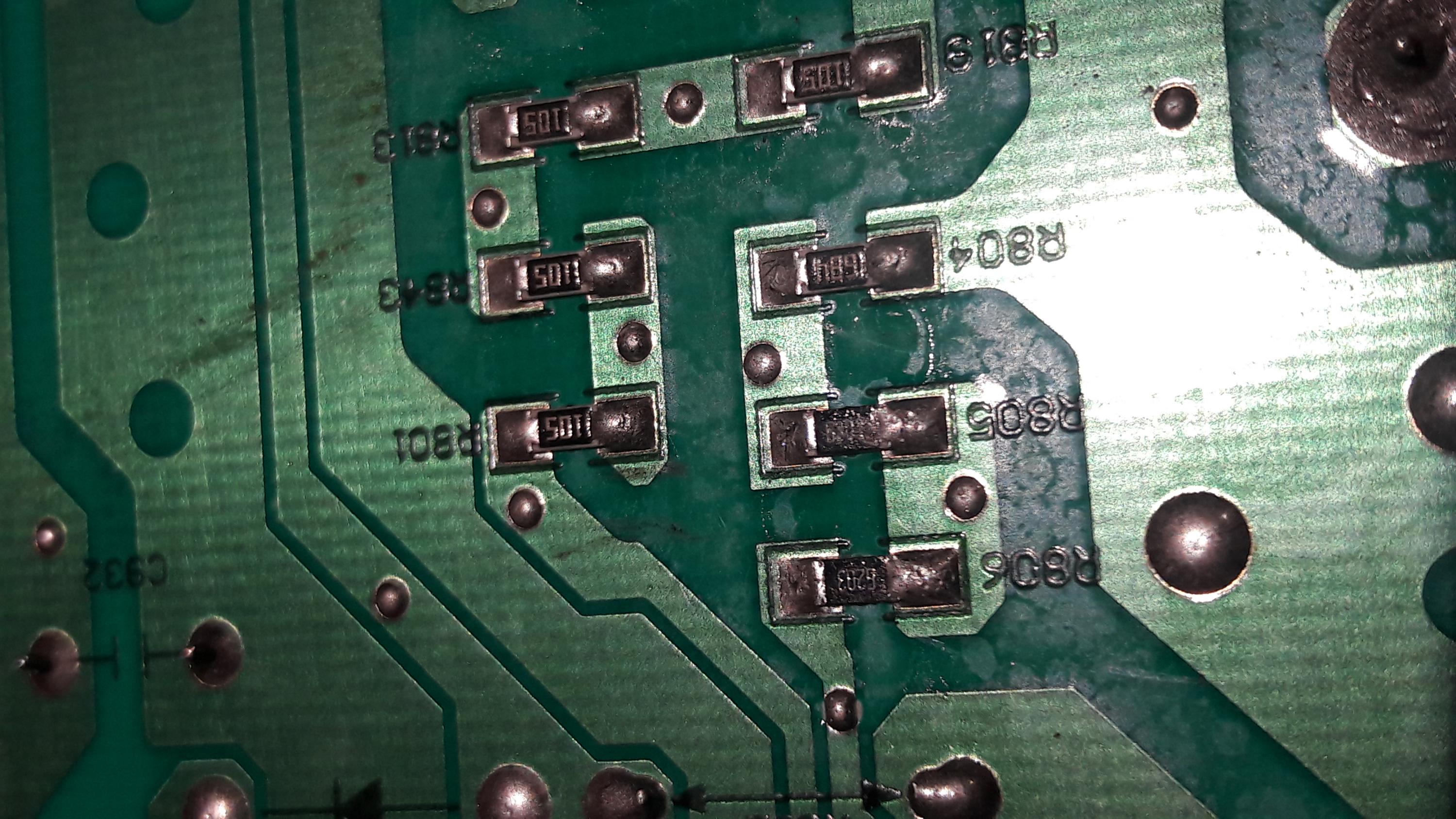

        Check R804,5,6 on back of powerboard. The two smd 620k resistors are probably reading low. You can replace with regular resistors. Your main cap needs to read around 390dcv

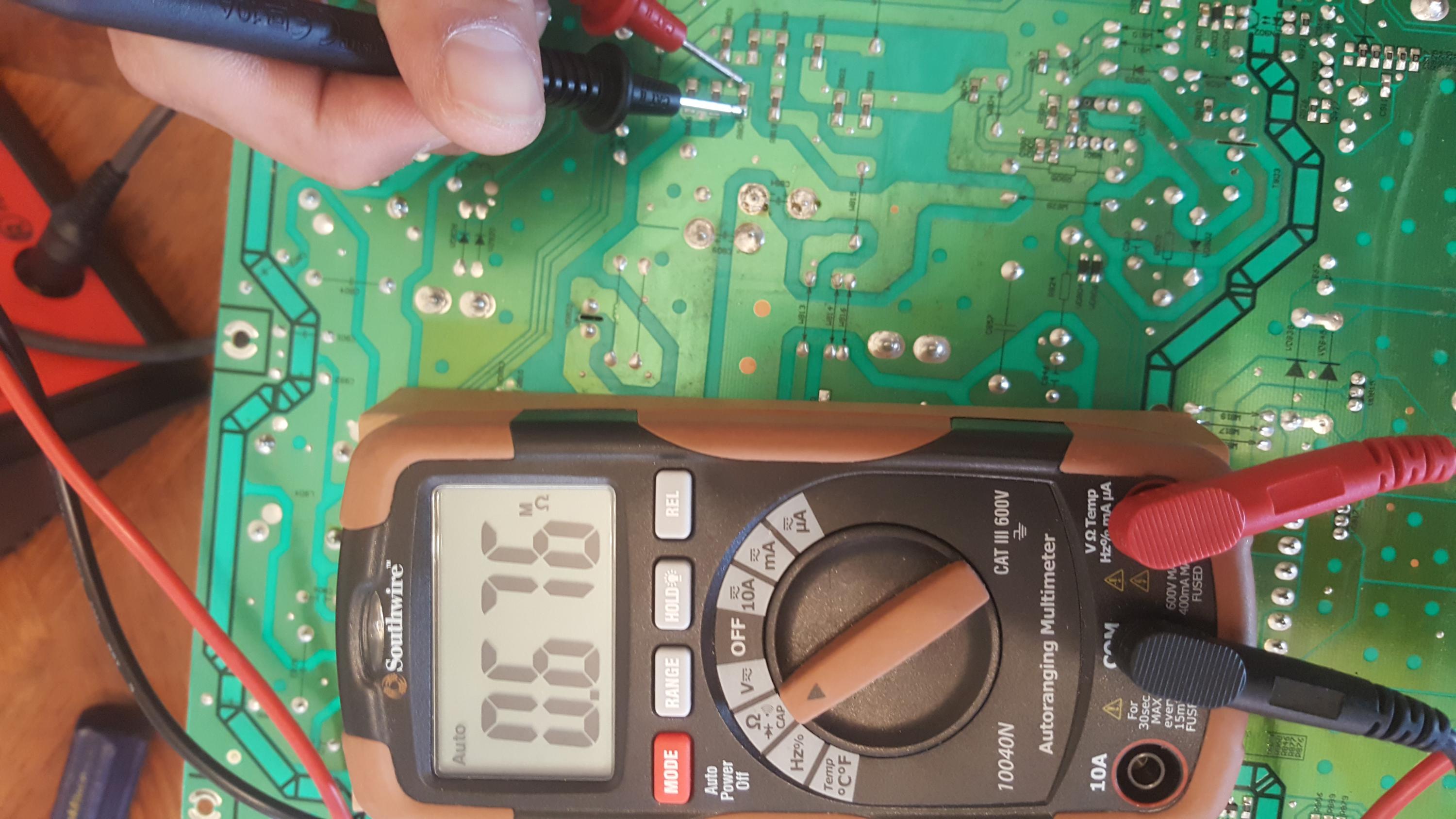

            Remove your power board. Make sure you have no voltage on main cap you measured. Read across each R804,5,6 with meter on ohms and report readings.
              #66
              I discharged both capacitors and measured
              R804= .676
              R805= .545
              R806= .583
                #67

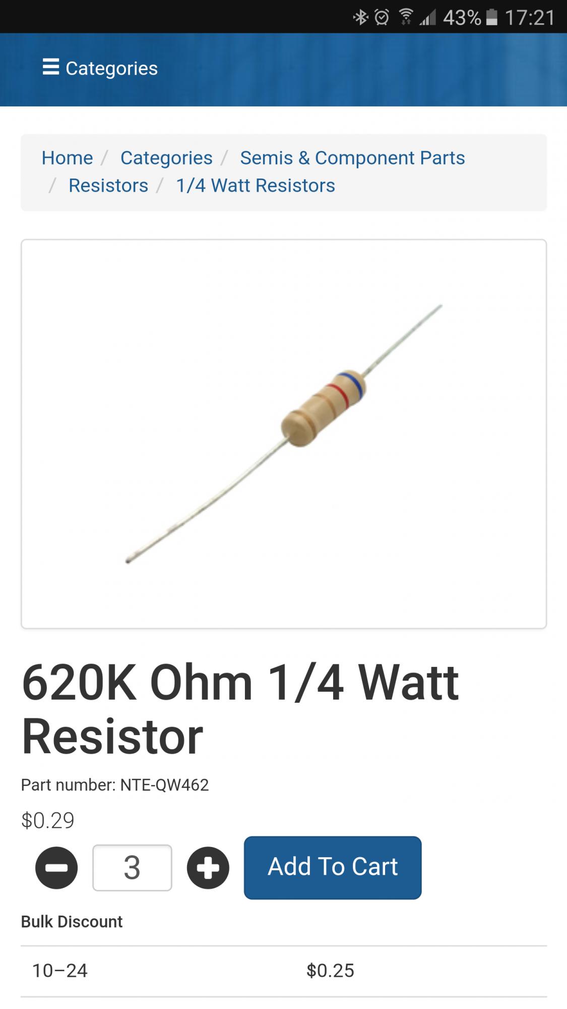

                You need to get a couple of 620kohm 1/4 watt or higher and replace 805 and 806. Don't replace with one resistor as it takes at least three to divide the voltage as they are not rated each for that much voltage.
                  #68
                  You think these would be ok?
                    #69
                    Should take care of problem. After replacement check main cap voltage should be around 390vdc. Let us know results.

                                  It worked! I installed the two resists then checked the voltage for the main capaciter which was 390v. I turned on the tv at about 2pm and left to watch the draft. When I came back home around midnight, it was still on with no problems! Looks like this problem is solved! Thanks a lot guys and go Raiders!
