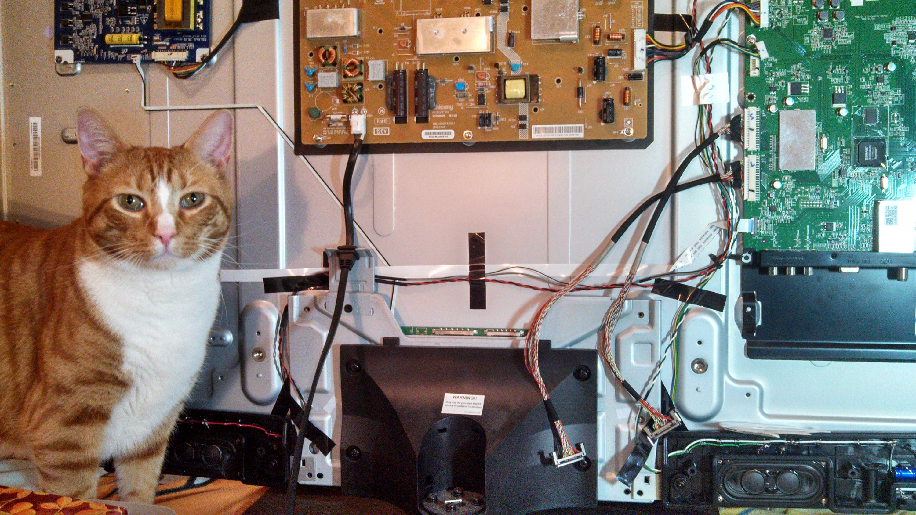

    The TV was working fine, just over a year old. Turn it on one day and the screen is blank. Here are some observations. turn on tv, front small power on green light is on, the red toshiba name comes up and can see fine on a dark gray background. the toshiba goes away, and the screen turns from dark gray to black/blank. Can still hear sound, channels work, input selection works, on/off works, but screen is blank. Changed input to dvd (by guessing at the menu choice since screen bland...), same results. TV model is 46L52000U1. I've disconnected from AC (left for hours), and powered up again, same results. Toshiba forums say this is common, with only answer is to see a repair shop....My question is if someone can point me to a specific module or board that might be bad. I'm very willing to open her up and troubleshoot/replace parts. Thanks in advance. MDluffy

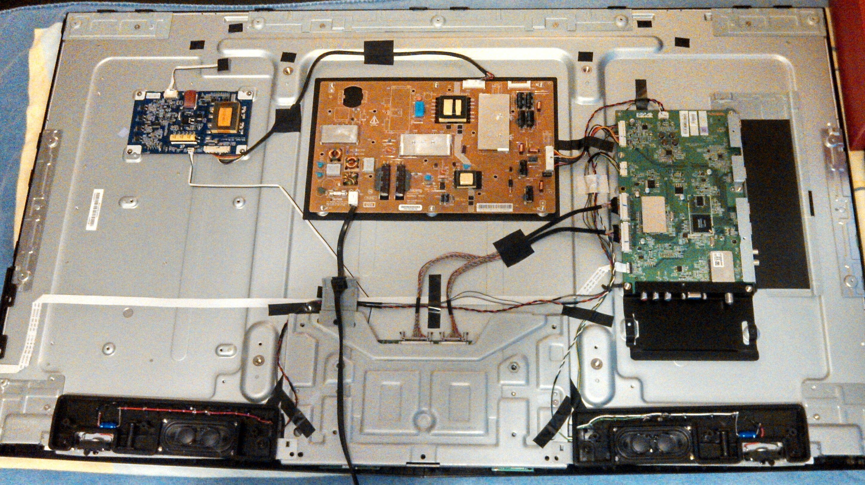

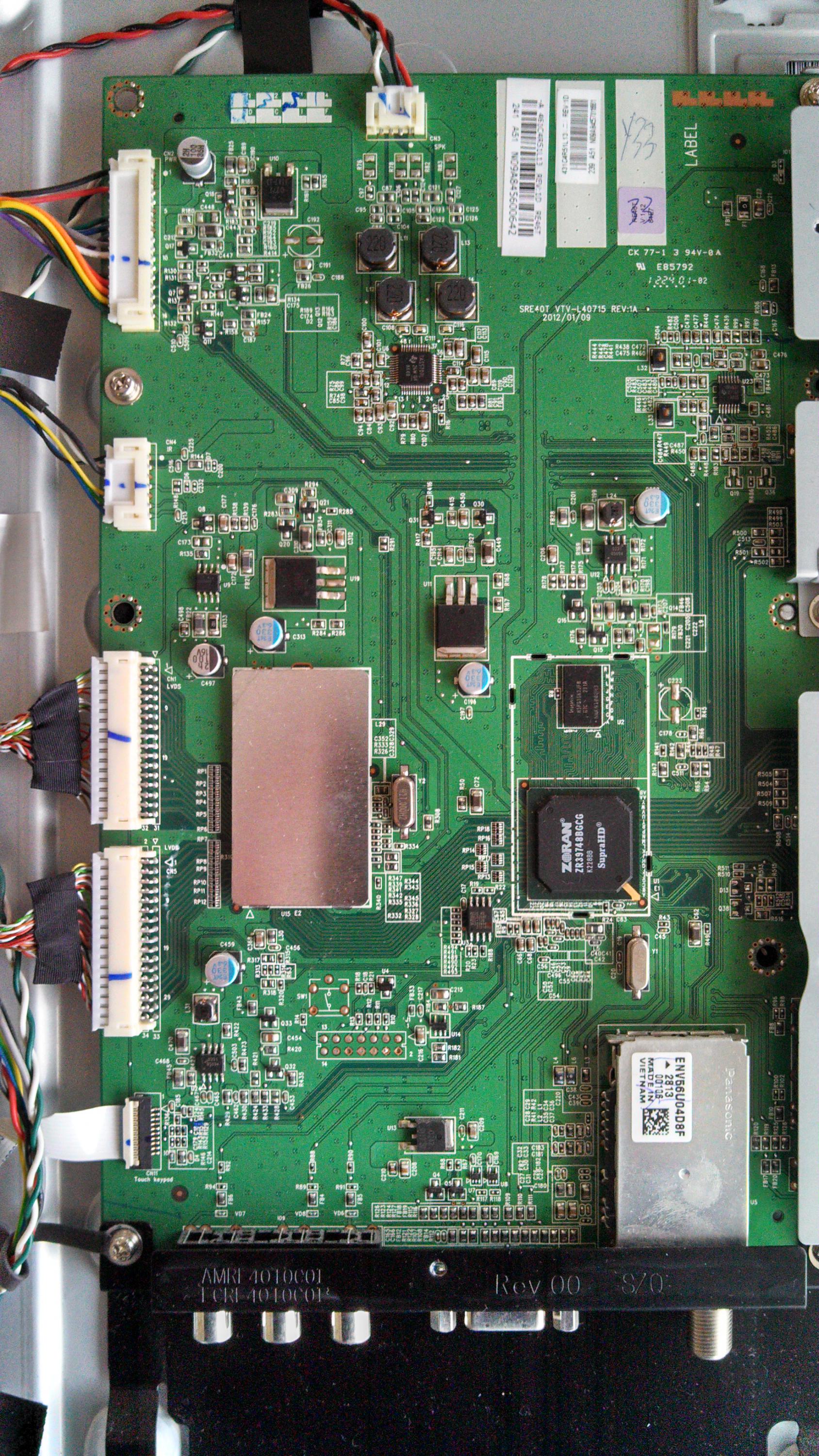

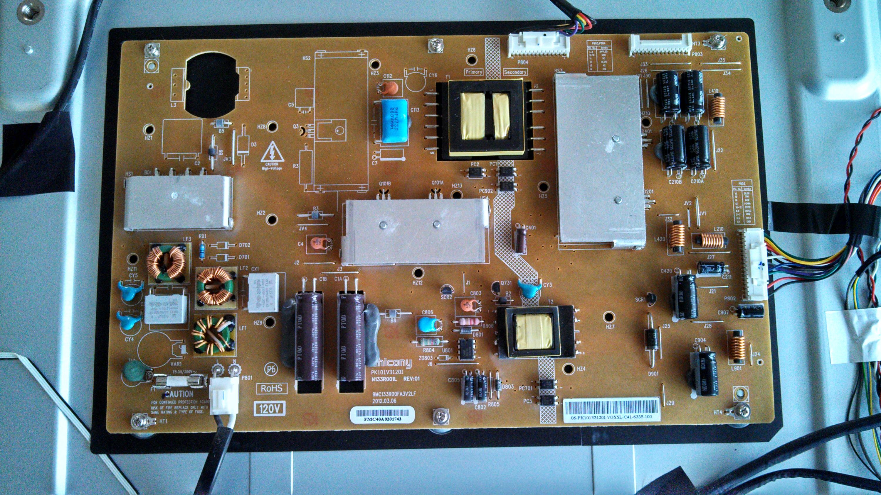

        Re: Toshiba LED TV, blank screen [46L5200U1]
        Here are pictures of the boards. I could not see any obvious vented caps, or other damage. Thank you for any help you can offer. MDluffy

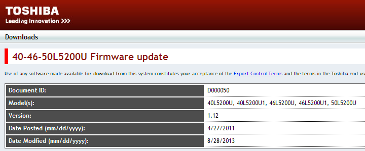

                    It sounds like a firmware/software problem to me, which would probably require replacing the main board. However, there's a small chance you can fix the firmware with a USB update. Try downloading the latest update from Toshiba and putting it on a USB stick. Hopefully it has a method like "hold OK button while turning on" to update, rather than having to do it through the menus (which you can't access.)

                        Hello, I've googled quite a bit and have had no luck finding FW or SW for this model toshiba, 46L5200U1....any ideas on where to look? Thanks!!
                          Unfortunately the only place might be Toshiba themselves. They don't always publicly releas the firmware.
                            https://web1.toshiba.ca/support/ceg/...?docid=D000050
                            This was the FIRST item when I googled it?
                              Interesting... I was searching for "46L5200U1" which shows no drivers available, but when I searched "46L5200U" it did show drivers available as you replied. My TV nameplate indicates the U1...I will dig in to see what the difference is, unless someone here knows. Thanks for your patience and assistance. MDluffy
                                My bad... the link clearly shows the U1 model! Will try and report back. Thanks.

                                    So for heck of it, found a control board on ebay. $43usd, free shipping... Figure that the picture circuitry could be working since we are seeing the red toshiba and gray momentarily. Maybe something is telling the screen to go blank, or not telling it to turn on.... Anyway, will install and report back to all. Thanks, MDluffy
                                      Got the control board. Only challenge swapping out was the disconnecting and reconnecting of the connectors....Need to take great care and not tug on wires. CN11 the small ribbon cable for touch keypad is tiny! and very difficult...with some assistance, finally got them swapped. No change in symptoms Moving on to TCON replacement, just purchased on ebay $19... Will keep you posted.
