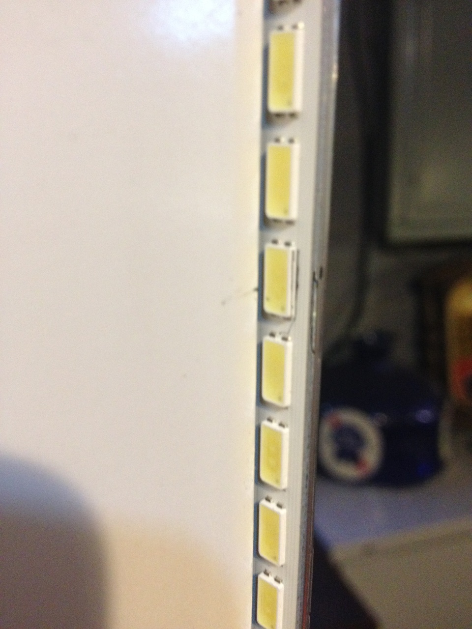

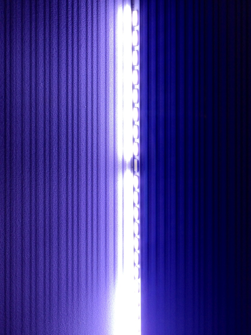

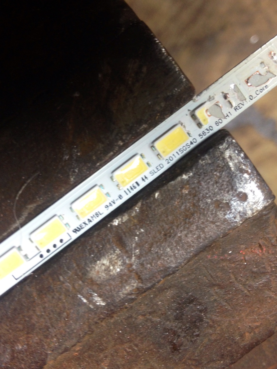

                        #111
                        Re: Toshiba LED TV, blank screen, LED Replacement
                        Okay I finally took the TV apart to see how many LED were out and it was one! What's the easiest way to remove one of these LEDs? I have a light strip from another TV that I can use to replace the LED. I am having trouble removing the led without damaging it. Check the pictures

                          #112
                          That's what hot air rework tools are for.
                          You may also be able to do it with a heat gun on low from the bottom side of the board.

                            #113
                            BTW, the LEDs in that Video are Dual-LED (two LEDs connected in series inside one package) that is why the Vf is so high.
