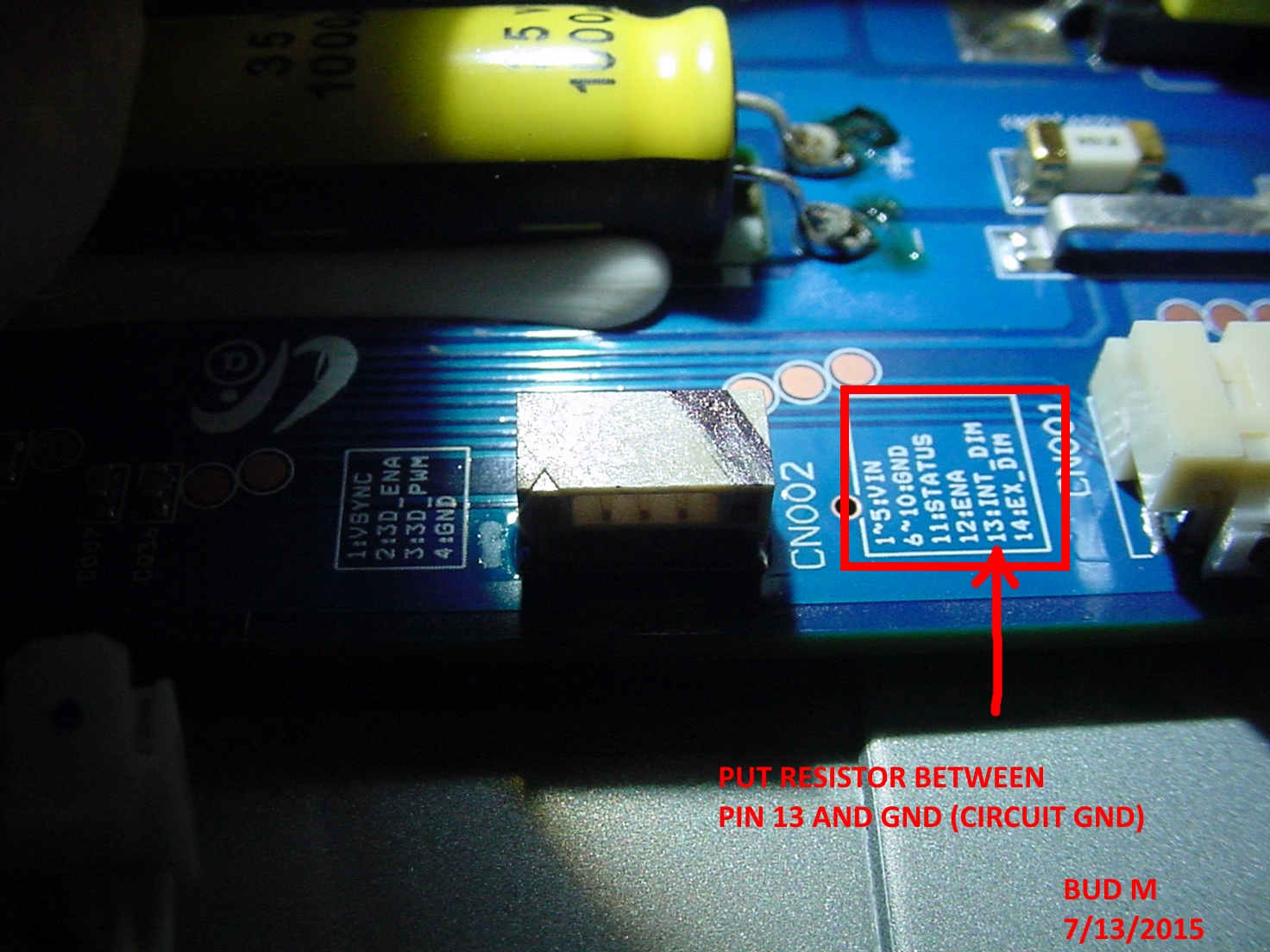

    Thanks Bud, for helping me.
    I don't understand the resistor part, though.
      #82
      Re: Toshiba LED TV, blank screen
      The analog dimming (not used by TOSHIBA, the TV uses the PWM dimming) has pull -up to full 5V for max backlights level, so I use the resistor (between analog dim and gnd) to drop the Analog dimming line down to about 3.5VDC or so. When PWM wire is disconnected, the ANALOG dim becomes active so you can vary the backlights by varying the ANALOG diming Voltage.
      If the PWM line stuck low, then it will force of the backlights off. If you monitor the PWM line and see <1V then the PWM line is not working.
      The one shown in the pictures, when you first turn ont he TV, the PWM line show around 4V (it is actually AC 200 Hz PWM, 0~5V pulse, 10% pulse width = min brightness, 90% pulse width = max brightness) which you will see the screen flashes on for second then the PWN drops down to 0V which then the baclikghts go out, in my case I have two problem, one is the PWM signal and anther one are bad LEDs strip that goes out if they driven full on.

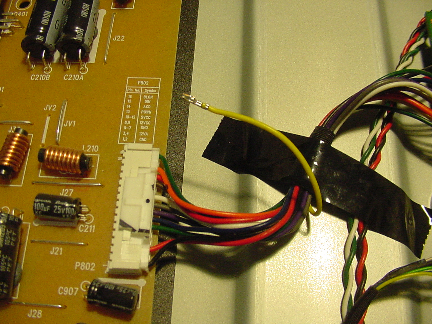

        I have just removed that yellow wire and the TV keeps working. I have left it over night and in the morning, it was still working.
        I will keep monitoring for a couple of days, but to me it seems like it is repaired.
        The right side(watching the TV), it's very hot though.

              With that PWM_dim is disconnected, you no longer have control for the backlights dimming, it is on full blast, the user menu has no idea that the wire is not connected.

                It seemed to me that when I was adjusting it, nothing changed on the screen, so you are right, that it runs on maximum brightness.
                What size resistor did you use?
                I'm a bit confused, on what did you do.
                Did you remove the wire, or do you have it connected?
                  #88
                  Take the DCV reading on pin 13, then start by using 100K resistor between pin 13 and GND, take the reading, to see if the voltage does drop down. I do not remember the value of the resistor I use but I end up with around 3.8Vdc on that and it is still bright enough for me and the LEDs stay lit all day. You can use a pot too for adjustment, if the Voltage goes too low you will see the screen flash on for seconds then goes off.
                  Leave the wire off, see the wire I removed.

                      No need to remove the wire from pin 15 on the LED driver board, I remove the wire at the power supply board as shown in picture #2. You already removed the PWM wire so no need to remove the pin 15 wire at the LED driver board, as you can see I leave it connected.

                          It is the main board problem, when the TV is first turned on the PWM signal is present (>4VDC) for seconds (backlights flash on) and then it drop down to <0.5V. I never spend the time to troubleshoot the main board to locate the root cause of the problem.

                                    OK, I have added two resistors in series, total value is 231Kohm and the voltage is 2.8V.
                                    That is, a 80% value from 3.5V.
                                    I will leave it at that.
                                    To me, it looks good.
                                    Thank you everybody for the help, specially Bud.
