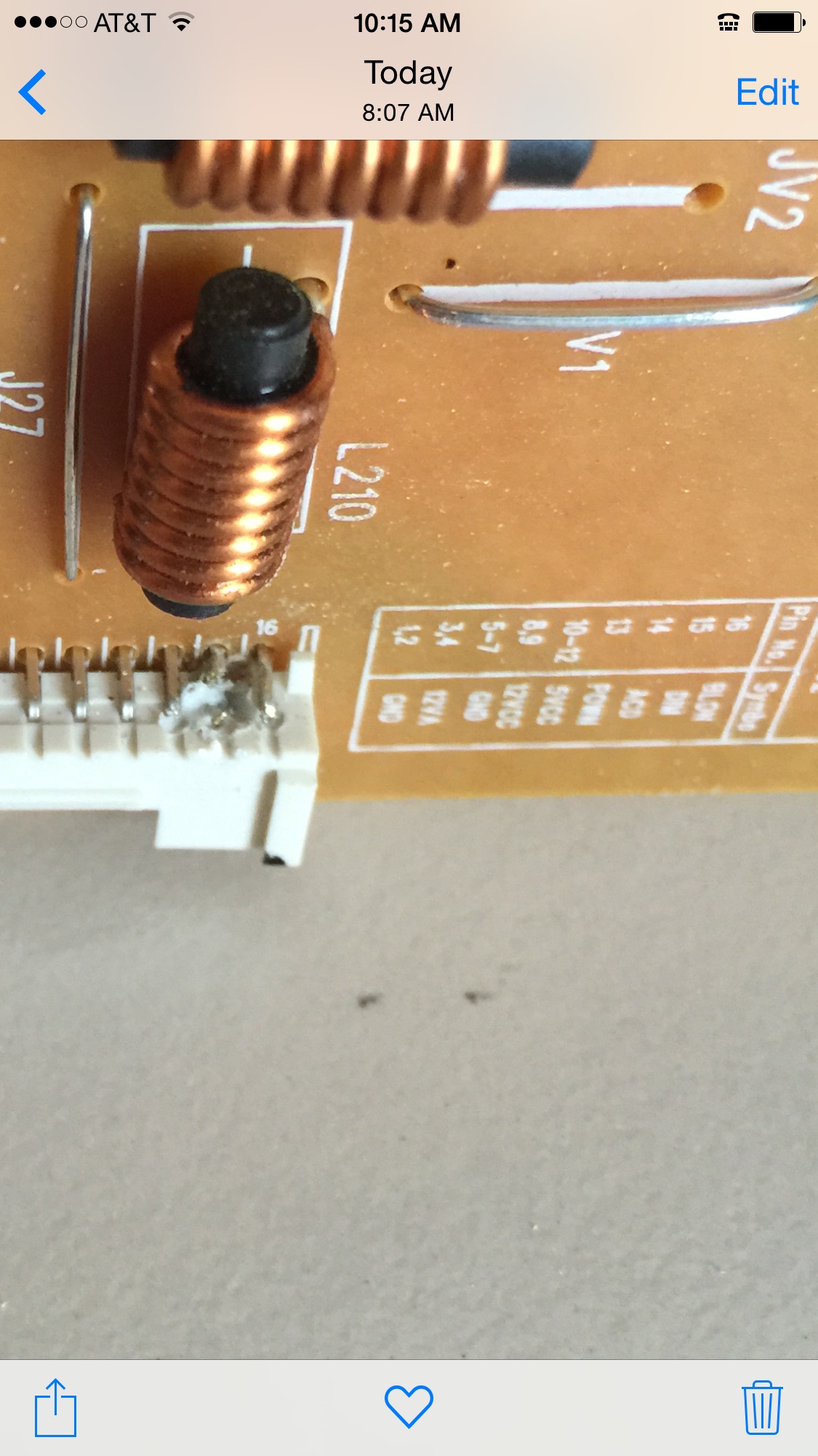

    Cut lead
    • Carmine JP
      • Feb 2015
      • 5
      • US
      #62
      Re: Toshiba LED TV, blank screen
      Cut lead again
        #63
        Originally posted by Carmine JP
        Well I cut the lead that goes to pin 15, and the problem is still there. Any assistance would be GReAT
        Can you please report the DCV Voltage readings of all the pins?
        BTW, if the BL-ON (pin 16) is not present, removing pin 15 (dim) is not going to make backlights come on.

                      A very common cause of this symptom in these sets is failure of the LEDs themselves. They fail shorted which is unusual for LEDs and this causes the inverter to shut down. Unfortunately the LED strip is buried inside the panel and is a real pain to access. You can test easily though, the strip is wired as four series strings of 16 LEDs with a common anode and there are test points near the connector on the inverter. Power on the set while watching the voltage between common and each of the four cathode test points. It should show about 100VDC on each one, if one or more is significantly lower, you have one or more shorted LEDs in the backlight strip.
                      It isn't unique to Toshiba, some other TVs use the same Samsung LCD panel.
                      • alfredomfr1
                        • Oct 2014
                        • 318
                        • usa
                        #71
                        I have a Toshiba 46L5000U with same problem: turn on, Toshiba logo for 1 second and dark screen after that.
                        I disassemble the panel and found it 2 led shorted.
                        Ordered in ebay for 24.99, will post again when arrive.

                          #72
                          LED received and installed, LED strip ok now, but still Toshiba logo for 1 second and dark screen.
                          • Agent24
                            I see dead caps
                            • Oct 2007
                            • 5035
                            • New Zealand
                            #73
                            Did you verify they all light up even if for just one second? Are you sure you did not miss any shorted or open LEDs?
                            -David VanHorn
                              #74
                              Did you replace the LEDs or the LED strip?
                              Do you also see the DCV at the DIM goes up to >3V and then drops down?
                              • alfredomfr1
                                • Oct 2014
                                • 318
                                • usa
                                #75
                                I replaced 2 shorted LED and yes DIM goes up to >3v and then drops down to 0.2v
