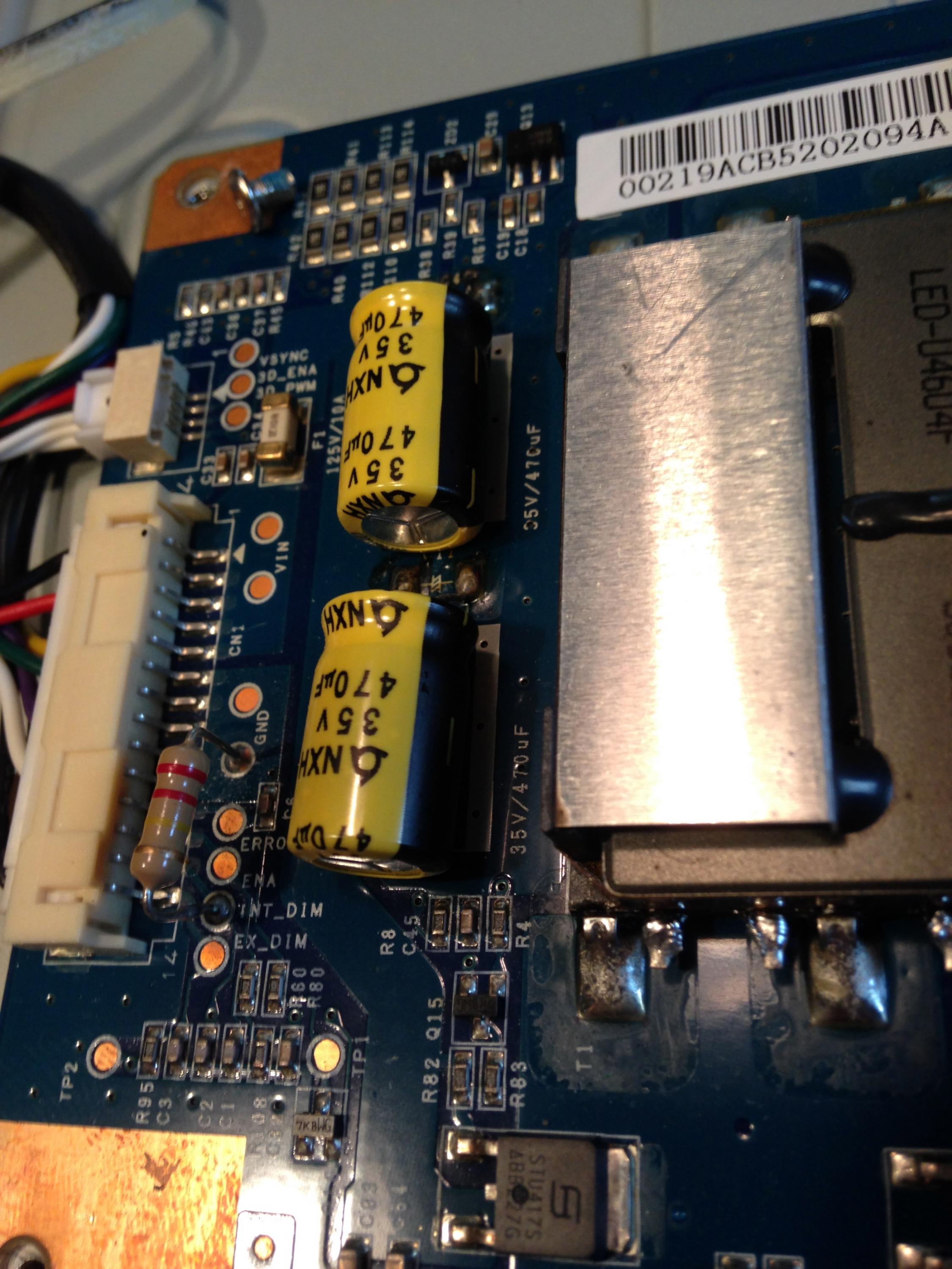

                  Originally posted by budm
                  The analog dimming (not used by TOSHIBA, the TV uses the PWM dimming) has pull -up to full 5V for max backlights level, so I use the resistor (between analog dim and gnd) to drop the Analog dimming line down to about 3.5VDC or so. When PWM wire is disconnected, the ANALOG dim becomes active so you can vary the backlights by varying the ANALOG diming Voltage.
                  If the PWM line stuck low, then it will force of the backlights off. If you monitor the PWM line and see <1V then the PWM line is not working.
                  The one shown in the pictures, when you first turn ont he TV, the PWM line show around 4V (it is actually AC 200 Hz PWM, 0~5V pulse, 10% pulse width = min brightness, 90% pulse width = max brightness) which you will see the screen flashes on for second then the PWN drops down to 0V which then the baclikghts go out, in my case I have two problem, one is the PWM signal and anther one are bad LEDs strip that goes out if they driven full on.

                      Okay. I soldered a 220 kohm resistor from pin 13 to ground. Powered it on, got the Toshiba logo, "no signal" screen, went to menu just before it blacked out. Here's a picture of the resistor soldered to the board, the replacement I bought from China. I'm also posting a picture of the original board next to the replacement so you can see how different they are. It worked great for a couple weeks, though. It's worth noting that when I plugged it in after adding the resistor the plug sparked when I pushed it into the outlet. I'm beginning to think the resistor was too low a wattage. I have no clue what I'm doing.

                                I discovered how to disable the detection circuit that turns off the LEDs here: http://www.riddledtv.com/forums/tosh...ard-t3541.html
                                Obviously this is for troubleshooting purposes only.

                                    It seems nobody bothered to figure it out, because it was easier to disconnect the wire.
                                    I haven't re-read the thread, but from the name "ext dim" it seems to be dimming input signal to the inverter?
                                    What does the inverter expect? What signal is being fed in? Perhaps the power and signal sequencing has gone wrong.
                                    Getting a waveform of the inverter control signals with a logic analyser from a working set and comparing them to a non-working one may help narrow down where the problem lies?

                                        Quick question to those familiar with this issue. I disconnected the Yellow Wire..#15..and the screen blanks out after a few seconds..with the initial flashing first...did I do something wrong or is this telling me there is a shorted LED really causing the screen shutdown?..
                                        Any help would be appreciated...

                                          You probably have some other fault with the same symptom. Reconnect the wire and start troubleshooting the backlights normally.
