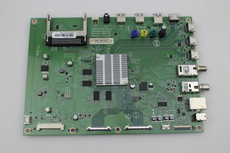

              I'm not sure your problem was tcon, that series has common problems at the processor solder joints, try to heat a bit the cpu and see if more problems comes..

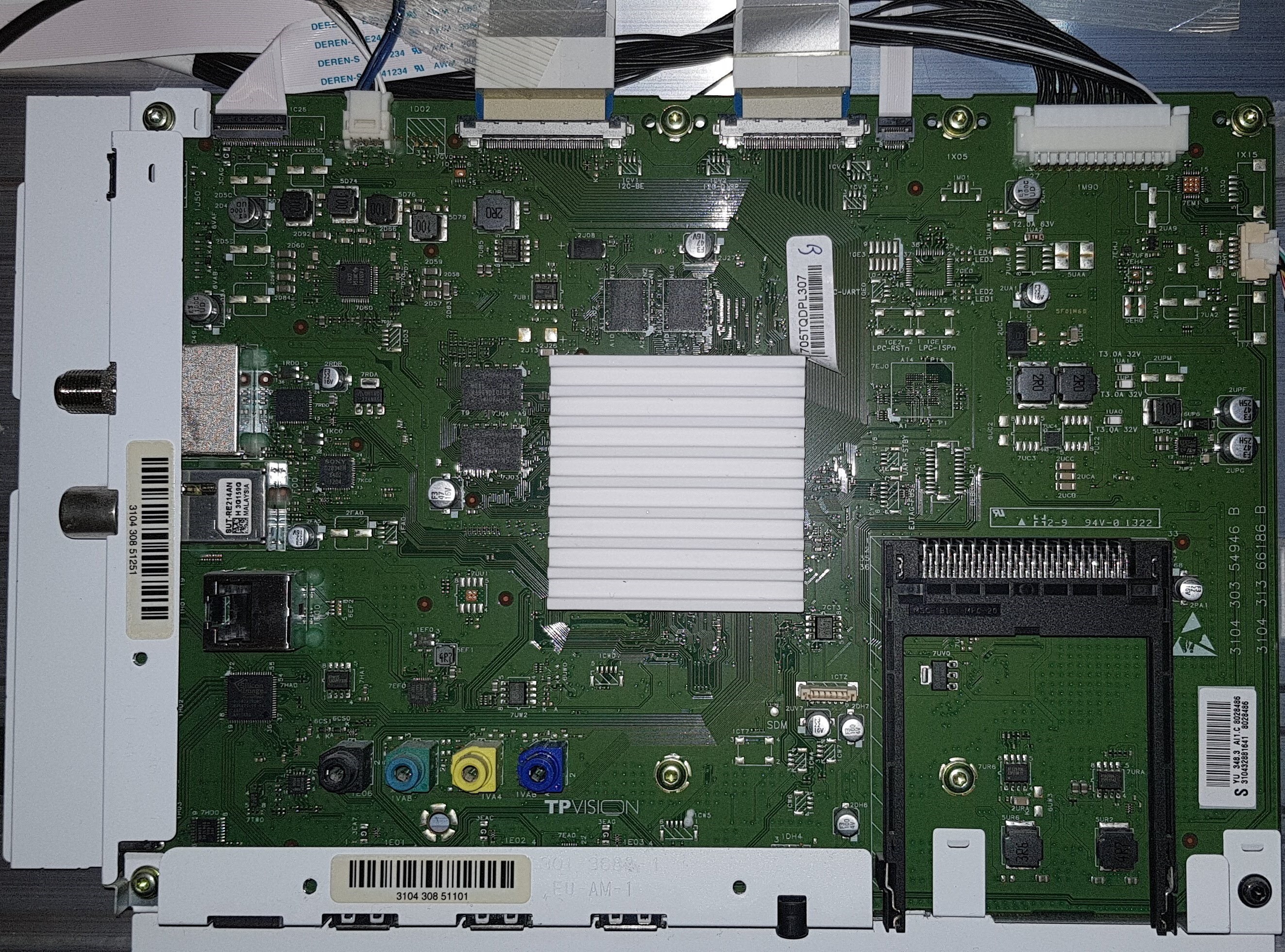

                Additional information: Standard this tv is not an Android, that upgrade_loader only works when there is an upgraded mainboard inside. The original mainboard has a white ceramic cooling block, the upgaded verion has a metal cooling block
                  yes this true... but all home normal user never upgrade the MB
