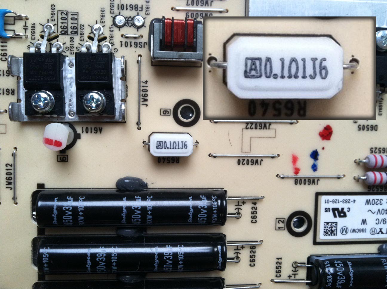

    Hello I am trying to repair a power supply board.
    where can I get this fuse resistor 0.1 ohm 1J6

          Perhaps a picture of it would help - what wattage is it and what sort of voltage does it have to carry - what does 1J6 mean( is that 1.6joules ?)
          What physical size is it?

                    I think he wants something like this FKN200JR-73-0R1
                    available from digikey
                    http://www.digikey.com/product-detai...MCT-ND/2813098
                    But till the OP comes back with more info I dont know
                      where to buy fuse resistor 0.1ohm1J6--Photo and size
                      Thank you all for you help.
                      the size is 1/2 inch x 1/4 inch x 1/4 inch
                      see the photo, PIP is enlarged.
                      Could I use regular 0.1 ohm to replace it?
                      It is in a Sony 55EX610 LCD TV APS-299 power supply board.
                      part number R6540
                      I read someone in this form replace it but he did not say where to get.
                      Thanks again

                        You can use this one:
                        http://www.mouser.com/ProductDetail/...vDYlHVHIbYE%3d

                          There is some detail here
                          http://www.tvserviceparts.com/.1OHM12WFUSE.html
                          You should try and check the pads for shorts
                          They are a bit expensive to have it blow again
                          Sony number seems to be 1-202-933-61
                          EDIT Budm's are a bit cheaper!!!!!!!!!

                            Thank you!
                            I ordered already. I replaced dps-78 board which may caused this fusible resistor blown
