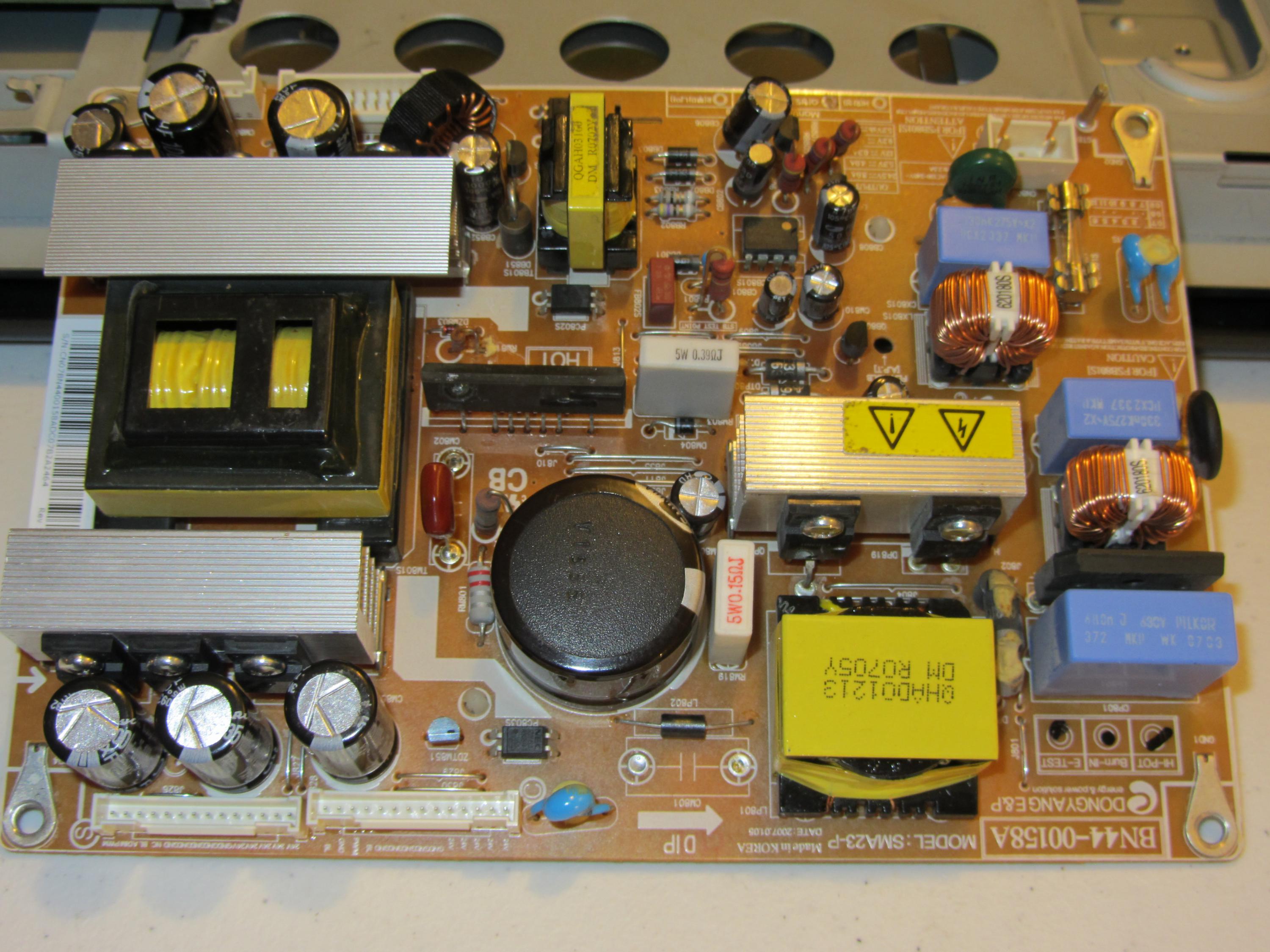

    I have this TV that has a bad power supply. I thought it was just going to be a bulging cap on the output. Replaced all the caps but still no go. So I started checking my voltages on the output and the only thing that is working is the 5V standby. All other voltages are missing. They all show 0V. When I have the PSU in the TV it Cycles on and off... I have since taken it out and jumpered with a resister the standby 5V to the PS_ON to turn on the Power Supply and the Voltage across the large cap comes up to 385V from 190V But still get nothing on any of the outputs. There should be another 5V, 12V, and 24V, but all are missing.
    I've researched this board on the forums and other places but can't come across anyone that has had the exact same problem that has fixed it...There is one thread here of someone trying to fix one, but they are still trying to fix theirs as well.
    https://www.badcaps.net/forum/showth...ight=LN-T2353H
    Not sure what to check next. It has to have something in common with all the voltages???
    I have the schematic for the board if anyone needs it.

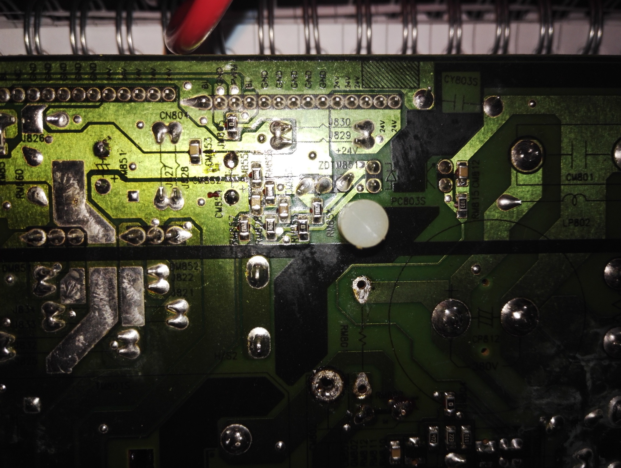

                            Re: Samsung LN2353H - Bad Power Supply BN44-00158A
                            Hi, i know is an old thread but I have similar problem with my TV : power supply bn44-00158a power supply model. I replaced the bulg capacitors, but no luck.
                            The voltages fluctuates and not stable. Few questions
                            I do not see cm602? Nor on the schematic too.
                            CM855 looks darker, but what is 50v224k_2012?
                            Removed Rm801 out of circuit to measure and it measures 0.4ohms but schematic says 0.22k? Is this k for tolerance?
                            I also need to replace cm802 but what is 630v183j? And where can I purchase these components?
                            Thanks.
                            Ps: the person that open this thread, did you manage to fix your TV.
                                Hi thanks for the reply, apologies for not attaching the images of the board/component in question, because I have the same board, though it was not necessary. I have now attached the images.
                                So measuring 0.4ohms is the result of having a standard multimeter, It looks abit burn so decided to remove and currently looking for the component.
                                In previous comments, people have mentioned Cm602 is this a typo!? I can't find this device in the schematic you attached.
                                  I have had problems uploading images, here is the front part
                                    It is CM802 (0.018uF 630V) which is part of the switched 12V/24V power supply, if that cap loses its capacitance then the 12V/24v will be low.
                                    There is no designator for CM6xx for the switched 12V/24V SMPS power supply section they use CM8xx for capacitors. RM8xx for resistors, DN8xx for diode.
                                    You have indicated that the power supply Voltages are unstable, which one? The standby power supply or the switcched 12V/24V?
                                    How about the DCV between the two legs of the main filter cap? Are you getting >380VDC when the PS-ON (PWR-ON) signal is present?
                                    You must also remove ALL those bad brown/yellow glue, they are corrosive and conductive.

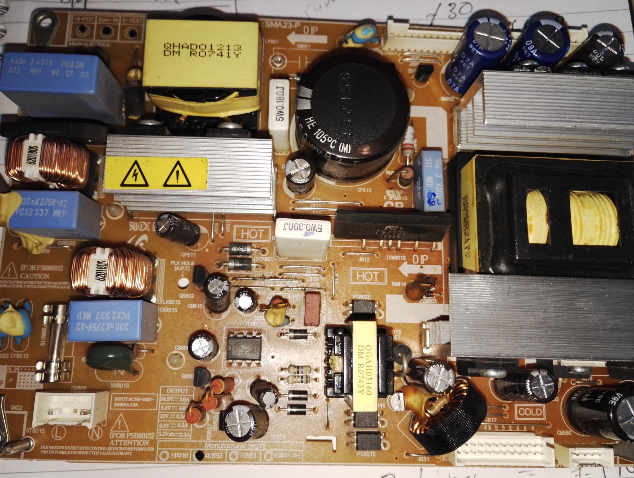

                                      Hi budm
                                      All my voltages where fluctuating, as the capacitor cm802 and cm855 was dark, indicating a sort of burn and bulged caps. Therefore as a big time amateur with the voltages fluctuates i went ahead and replaced the bulged capacitor and removed cm802, rm801 and f9222l. Now I am struggling to find replacements for
                                      Rm801- 0.22ohms 1W fusible resistor, all I can find is:
                                      0.22 ohm 0R22 0.22R 1W /1 Watt Metal Film Resistor
                                      Will this be good enough as this is not fusible resistor?
                                      Cm802- = 0.018uF 5% 630VDC, all I can find are:
                                      WIMA PET film capacitor, MKP10, 0.018uF, 18nF, 1000v, 1kv,
                                      Or
                                      condensateurs 0,018uF 18nF 1000V 5% Wima FKP1
                                      Although they have higher voltage rating but should be ok, what is your thought and advice?
                                      I have not measured the DCV between the two legs of the main filter cap, when I purchases these new component I will measure this. I know it was a big mistake in removing the components without fully diagnose the problem. I can't put them back as the legs are damaged. Learning from my mistakes ....
                                      Ok I will remove the yellow glue, thanks for the advice.
                                      Before I purchase these components, can you please let me know if they are ok? Thanks
                                        0.22 Ohms: you can use MOX (Metal Oxide) Flame proof resistor.
                                        the cap 0.018uF cap has to be Metalized Polypropylene type 630V rating minimum, higher Voltage is OK.
                                        For example:
                                        Resistor: http://www.digikey.com/product-detai...0CT-ND/2021740
                                        Cap:
                                        http://www.digikey.com/product-detai...2122-ND/585189
