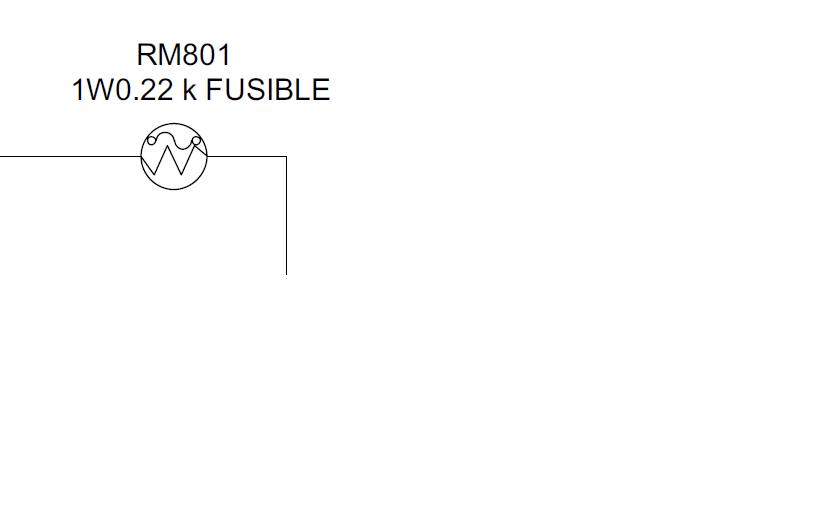

                    Re: Samsung LN2353H - Bad Power Supply BN44-00158A
                    great thanks again for your help i am going to purchase replacement part from ebay hopefully that is only issue one other question i have replacement 1w 0.22k resistors but they are not fuse able do i need to use fuseable ?
                      #30
                      Do you mean 0.22 Ohms, not 0.22K because 0.22K = 220 Ohms?
                      • R_J
                        • Jun 2012
                        • 9588
                        #31
                        The diagram has a (K) but in this case it means Tolerance Code of 10%. The value should be 0.22 ohm 1 watt. I would'nt be concerned about using a regular resistor, or maybe use a flame proof if you can
                        • Kylemcmahon21
                          • Feb 2018
                          • 8
                          • Ireland
                          #32
                          the resistors i purchase on ebay listing says 0.22 ohm 1w carbon resistor ( OR22 resistors ) are they correct ?? colour code is red red silver gold ?
                            #33
                            0.22 Ohms is the correct value.

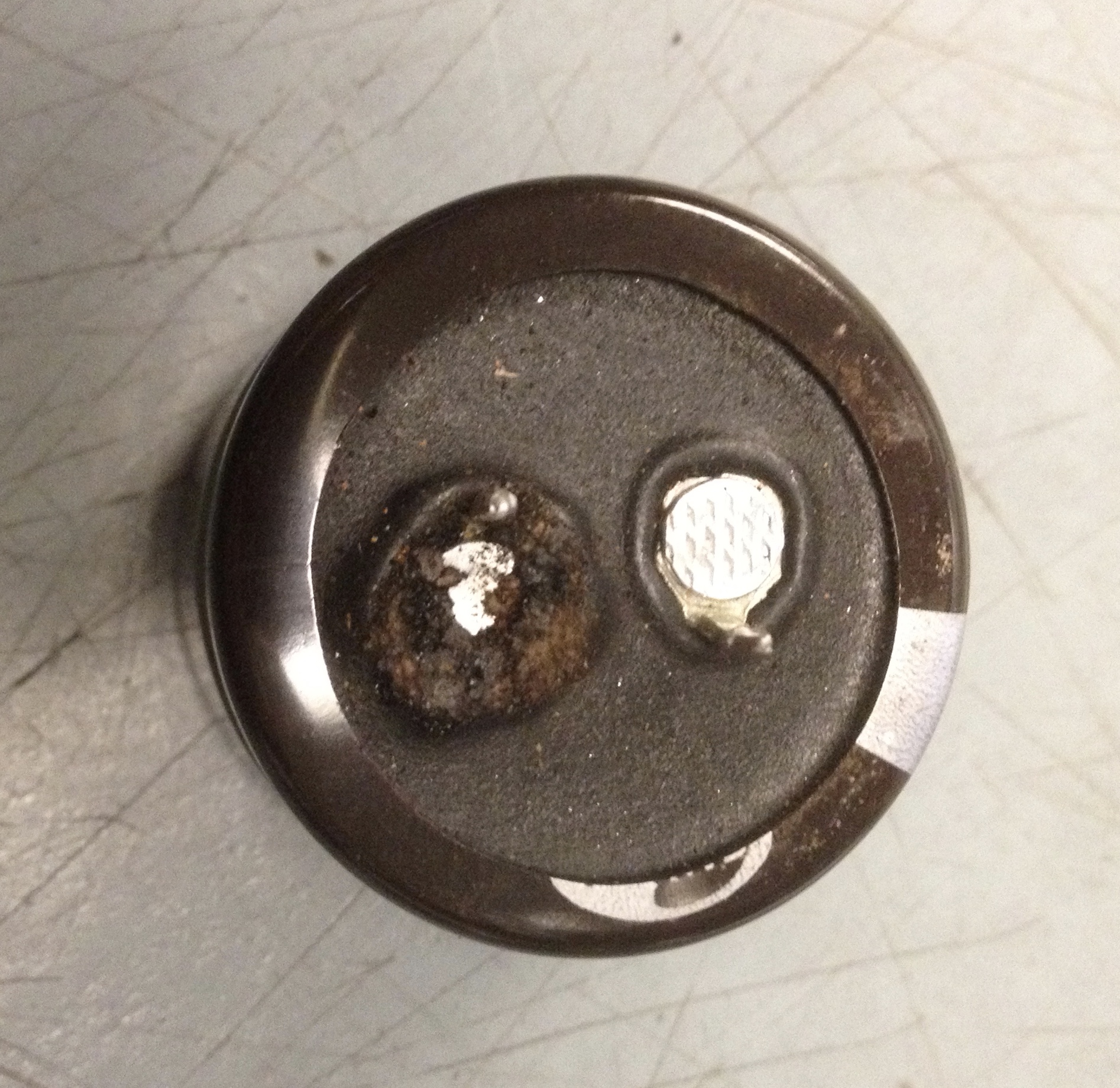

                                      I have one of these boards; TV has no power whatsoever. CM 802 checks at .0176 uF, RM 801 is good at .2 ohms. I also checked CP 812 (the really big cap) and it checks at 82 uF but when I pulled it out the bottom has either a leak around the + terminal or heat melted the plastic. Not sure I could post a picture yet but it smells a little burnt and was sort of stuck to the board. Replace it anyway even if the value is OK?
                                      • nomoresonys
                                        • Jan 2013
                                        • 12274
                                        • U.S.
                                        #39
                                        Yes replace for sure.
