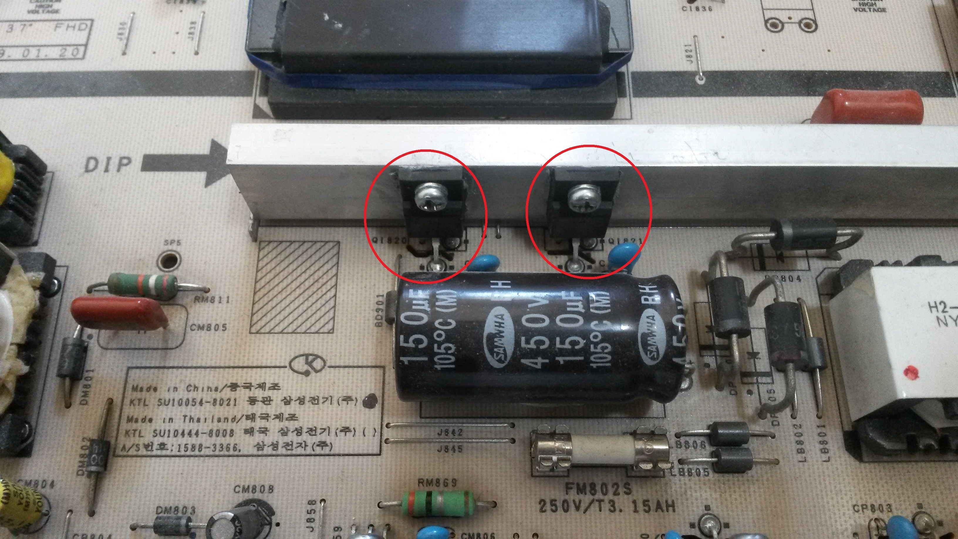

    This Samsung combined power supply and inverter was replaced a while ago from a Samsung 37inch LE37B530P7W TV. However I would like to repair this one.

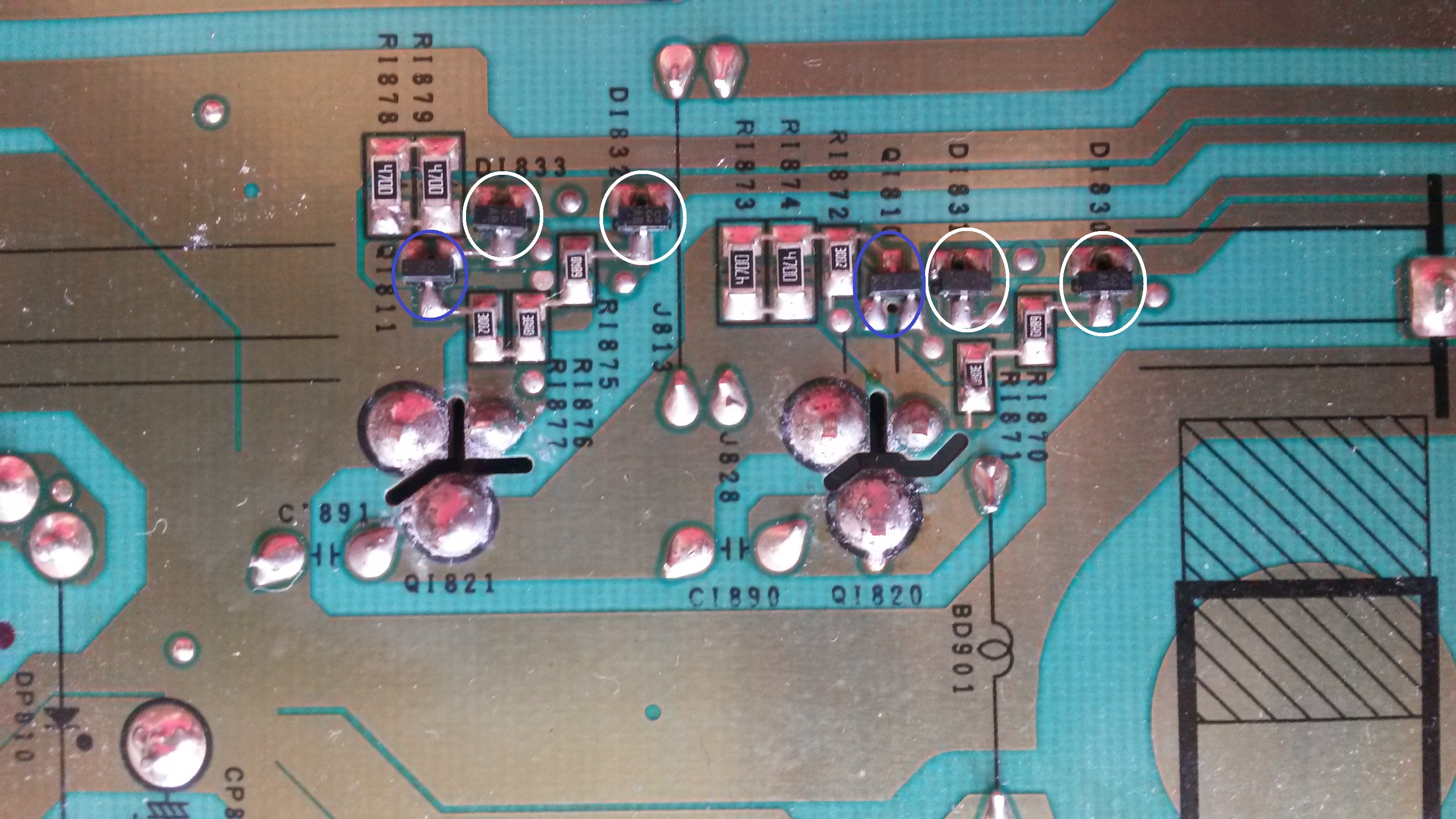

    I have replaced the Mosfets Q1820 and Q1821 ( FDPF7N50U) which were both blown and the fuse FM802S. The schematic for this power supply that is attached doesn't relate to this power supply as the driving transistors and diodes are D1830, D1831, D1832, D1833, Q1811 & Q1810 are nowhere on the schematic!
    Does anyone know what the components for D1830, D1831, D1832, D1833, Q1811 & Q1810 should be? I ask as I did change the Mosfets Q1820 and Q1821 ( FDPF7N50U) however they blew again (these Mosfets replaced could have been fake ones from China). I did replace the diodes (D1830, D1831, D1832, D1833) with KDS184 as I did find one blown. However the schematic doesn't show Q1811 and Q1810 and I suspect the KDS184 (D1830, D1831, D1832, D1833) might be wrong as well!
    The Mosfets Q1820 and Q1821 ( FDPF7N50U) are circled in red on the images.
    So does anyone know what these diodes and transistors should be D1830, D1831, D1832, D1833, Q1811 & Q1810 ? Circled in white for diodes and blue for Transistors on the back of the pcb.

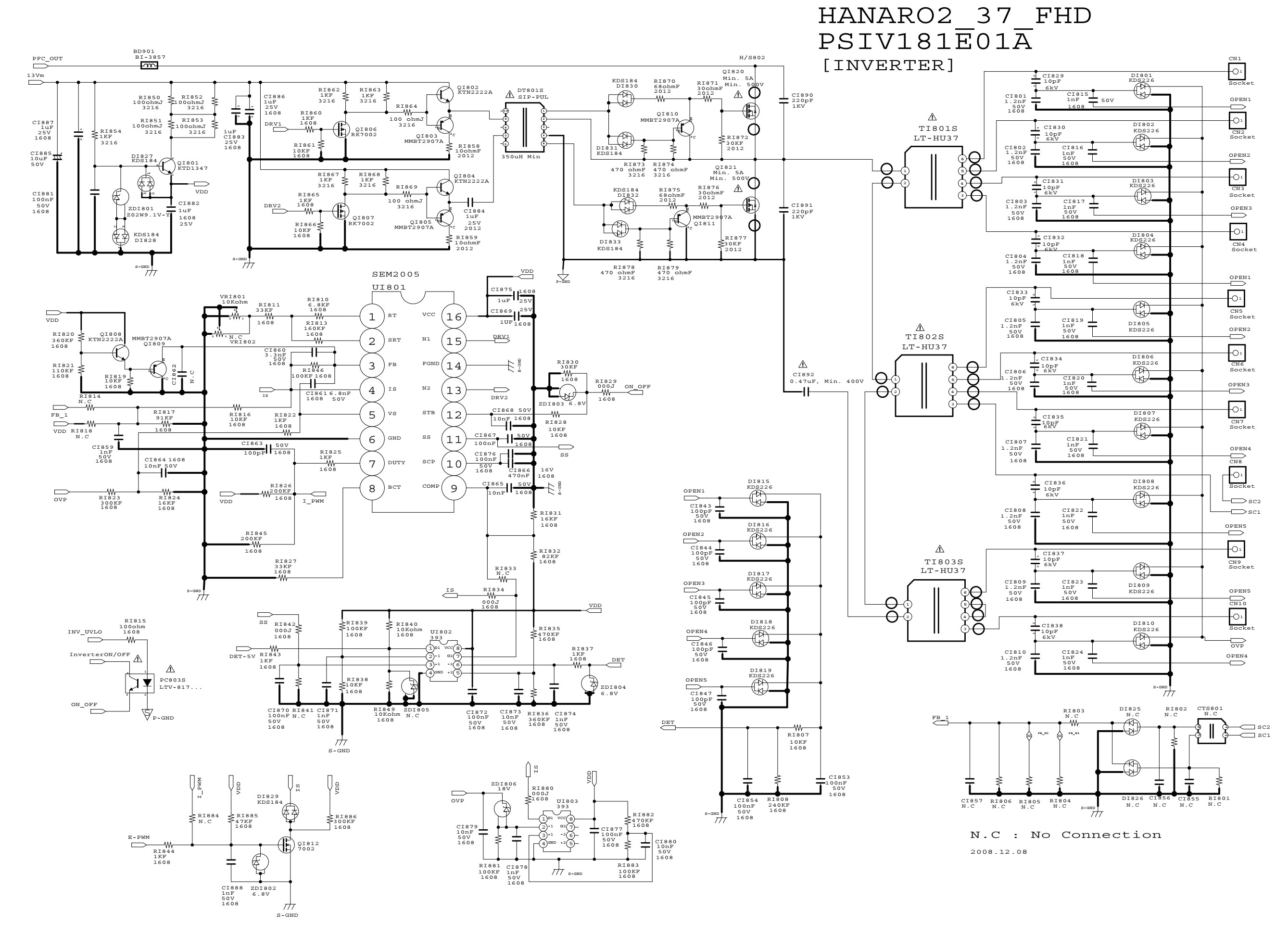

    Just managed to find an image of the schematic see attached file.
    Which turns out D1830, D1831, D1832, D1833 are KDS184 and Q1811 & Q1810 are MMBT2907A

      You have to change the blue caps next to them also
      • cheeky2
        • Dec 2012
        • 337
        • uk
        Thanks I assume you mean C1890 and the C1891 the 220pf 1KV if they are 1KV I may just uprate them to 2KV as I have some.
        • EazyBone
          • Jun 2023
          • 1356
          • United states
          Yes, when the mosfets go or vice versa it blows the other one. And if they didn't blow, they probably will soon. Yes change the caps and see what happens, of course the mosfets again now
