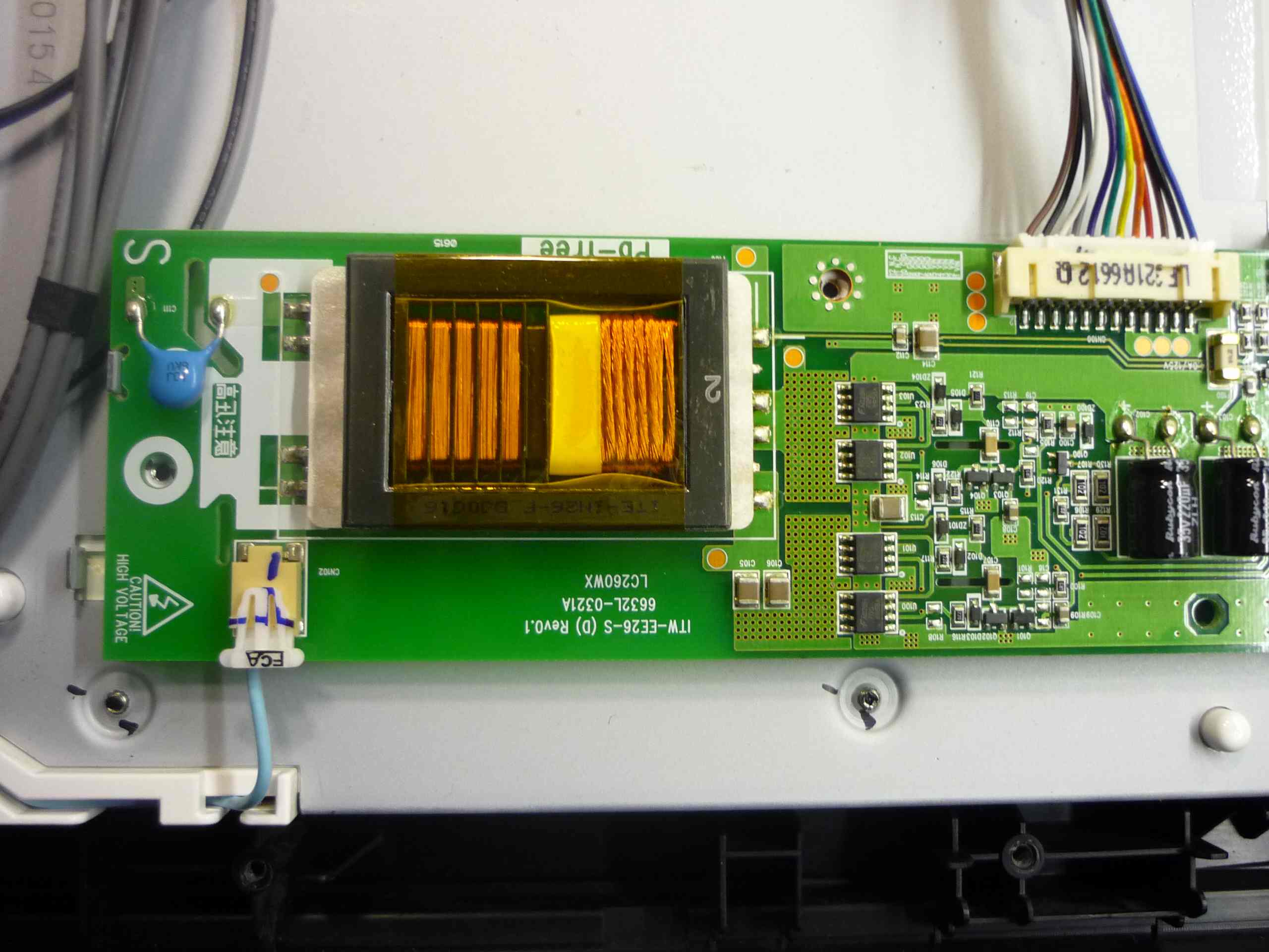

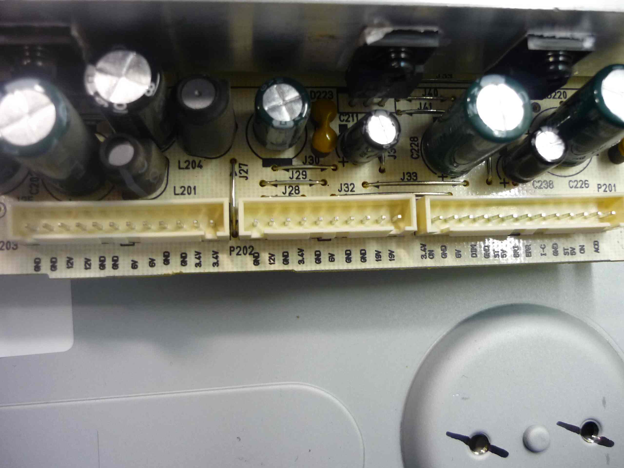

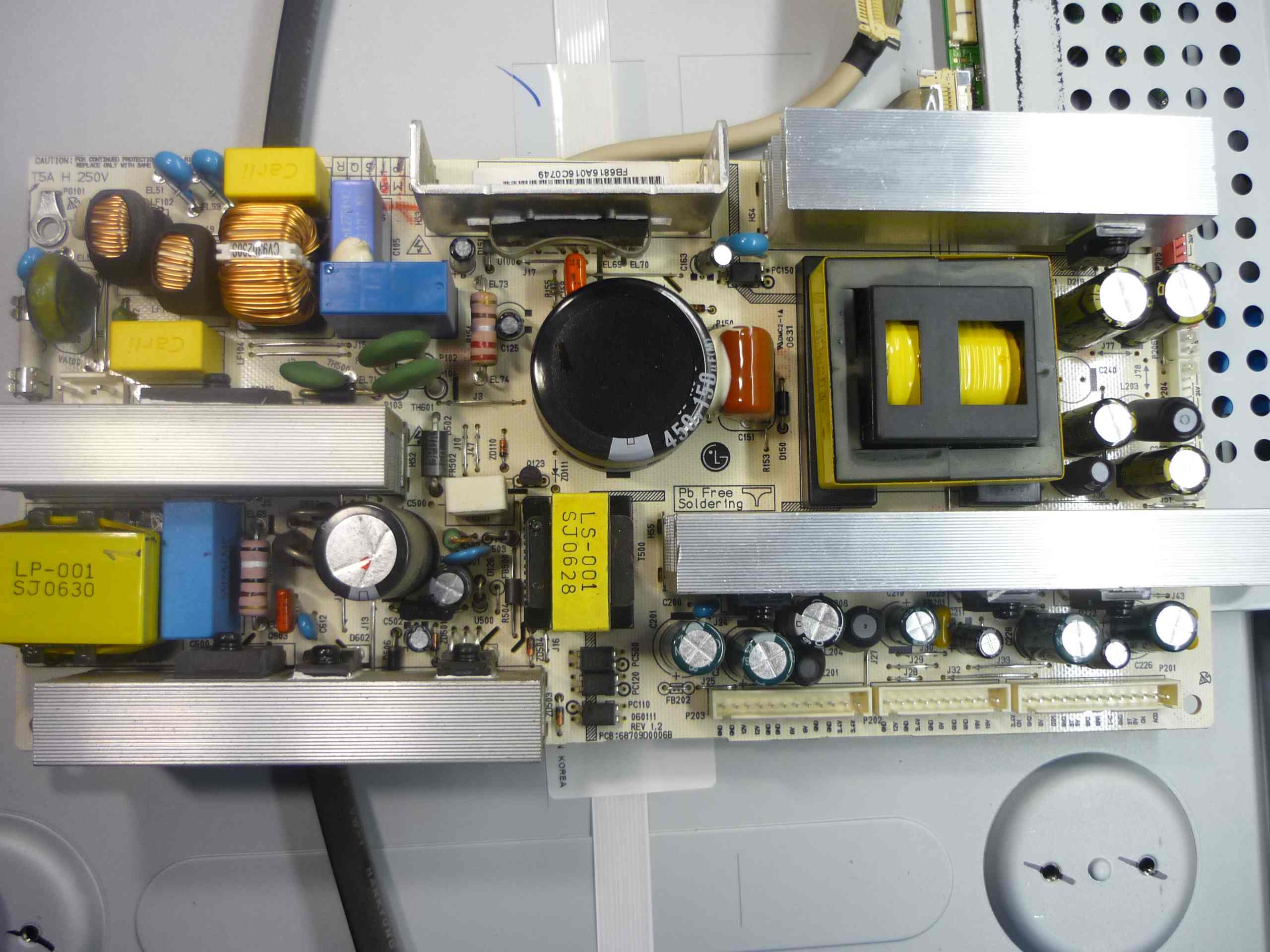

    hi.
    i have a lg 26LC2R lcd tv which backlight is turning off. there is 24v going to the inverter. when backlight off still 24v present. BL-ON voltage good too.
    so i think there is a fault with the inverter or lamps. But I'm not familiar with these kind of inverters. I think it's EEFL. don`t know how to troubleshoot.
    anyone have suggestion=

    Re: lg 26LC2R lcd tv backlight turns off

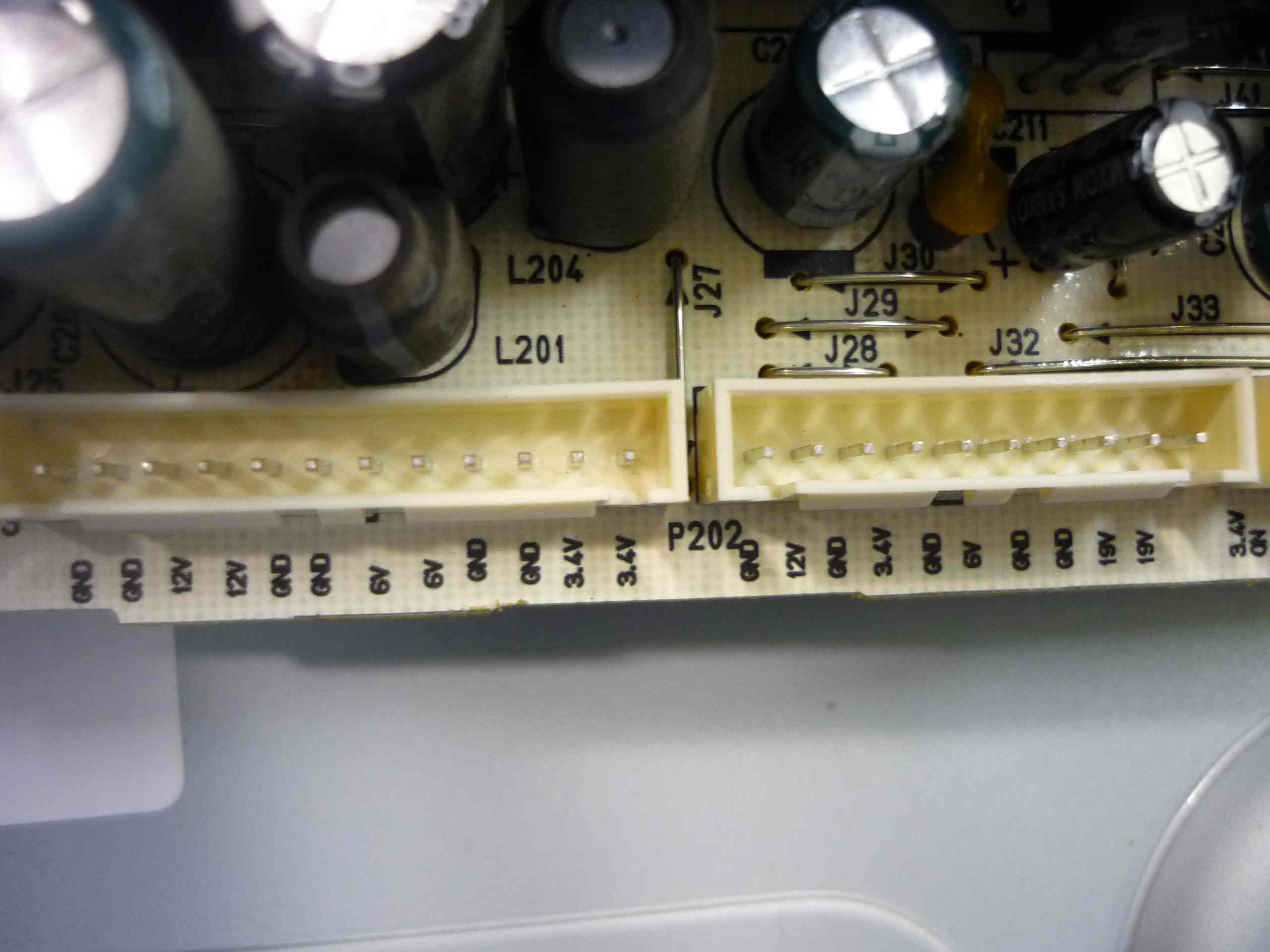

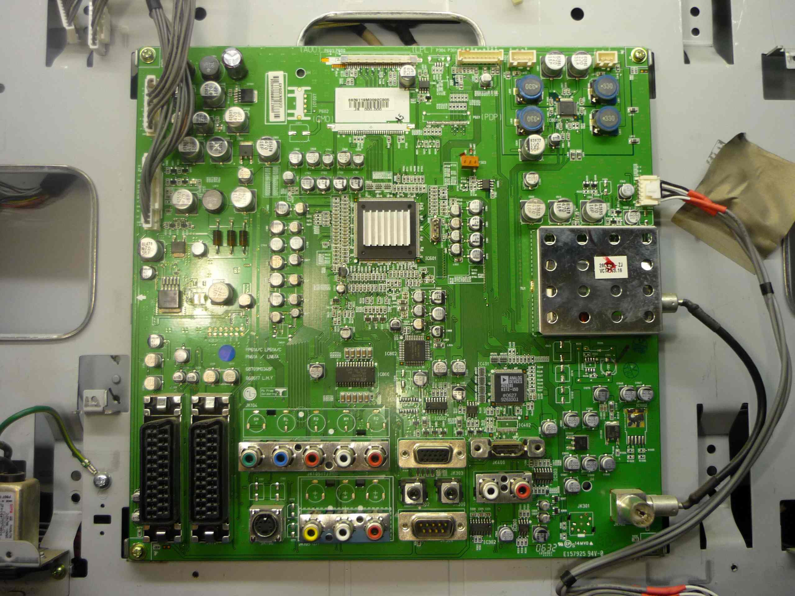

    post up good quality pics,of ,inverter,psu,mainboard,showing the connectors also
    fixed so far...376 lg lcd tv's,24 onn tv;s,24 panasonic lcd,16 jvc lcd,12 marshall jcm800 amps,refurb of various disco equipment lighting,old style disco decks ,and a flymo!
    please let us know if everything works ok if your tv gets fixed, as it will be and aid for anyone else having the same problem and wishing to fix it.it would save people clogging up this site with topics that are duplicated,and can be found easily using the search function.,and taking up valuable space.enjoy your fixed tv!,hopefully!

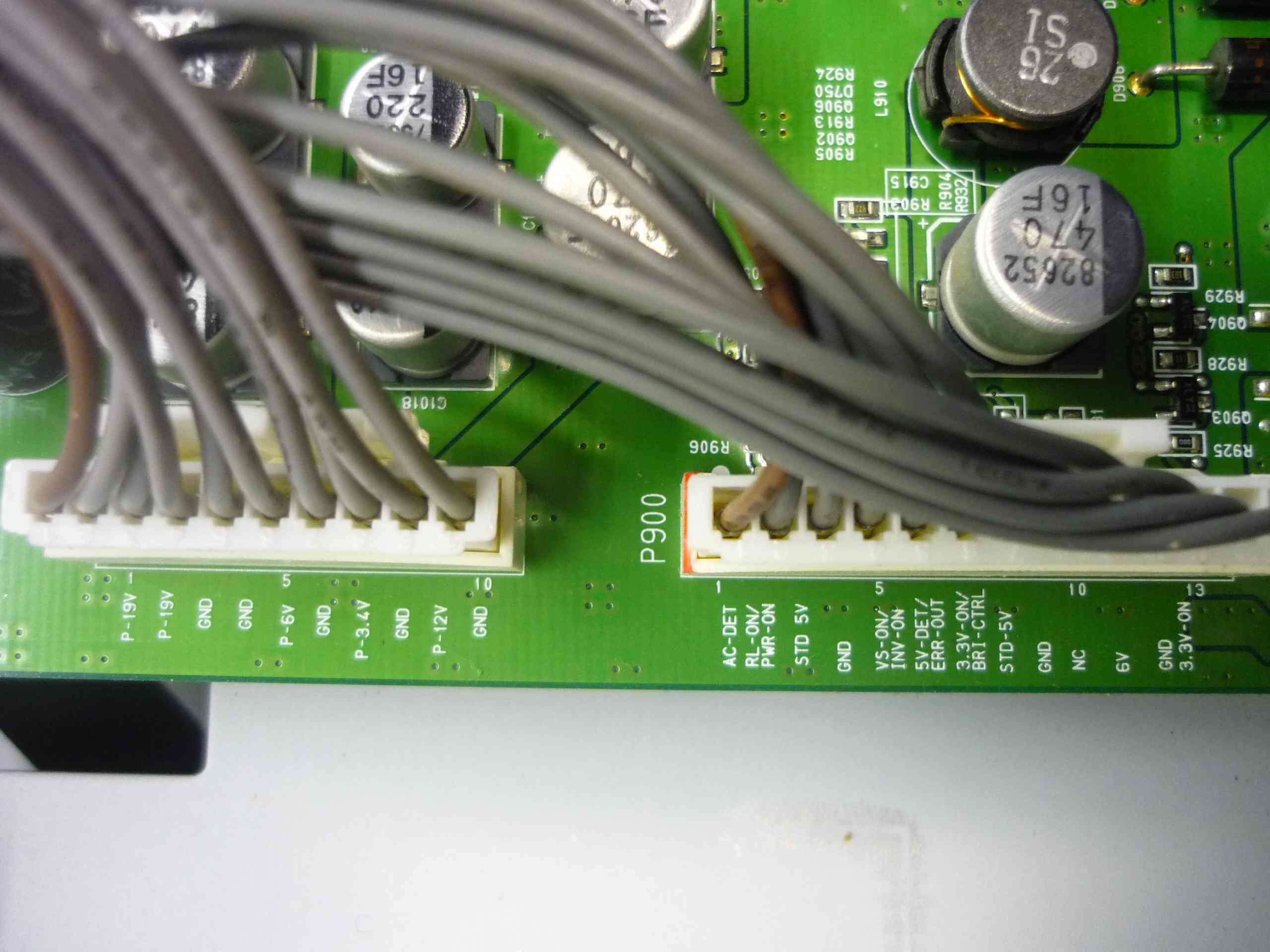

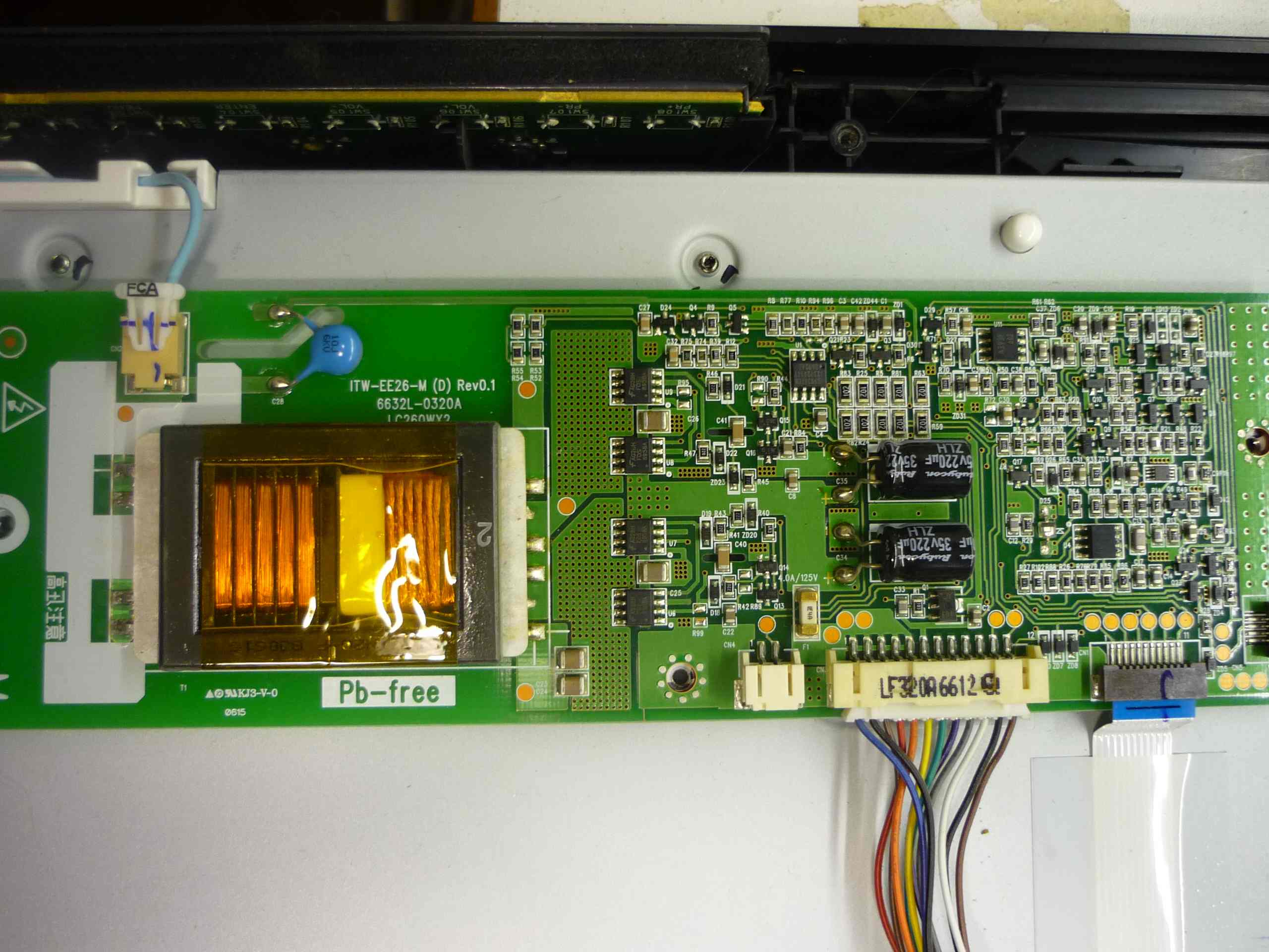

      here are some pictures

        So the backlights did come on for seconds?

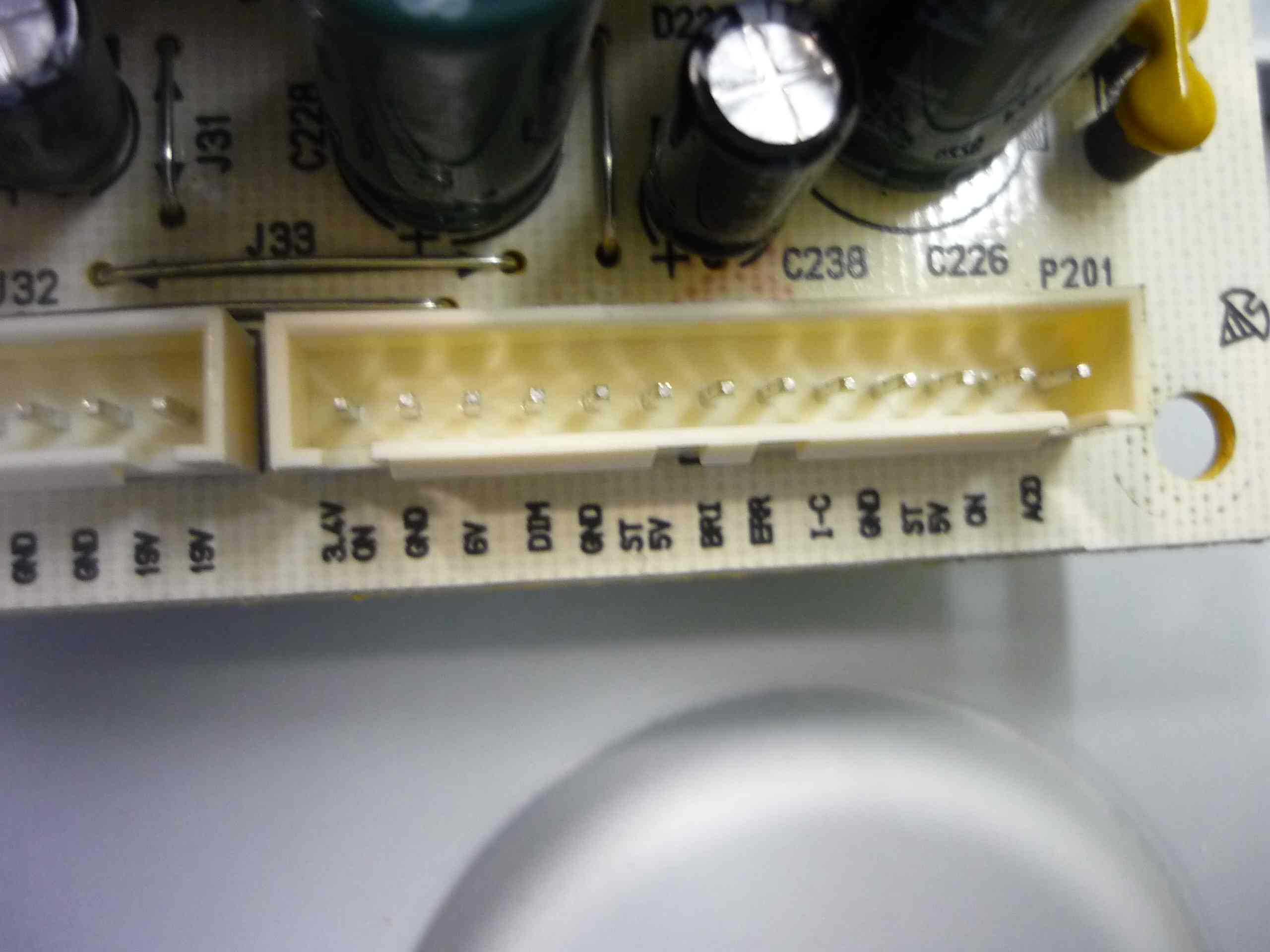

          does voltage REMAIN at 3.4vON pin(INV_ON) when backlights go off?
            the backlight is on for 2 seconds then off. The Inv_On voltage remain 3.4v
              im wondering wether there are no feedback circuits on the inverter,sending back an error signal to the main board to shut itself down,so the inverter stays powerd up,and isnt detecting faully ccfl tube fail
              the tubes??
                    Those two caps on both inverter boards are good? Try heating them with hair dryer, also those MOSFETs and the resistance of the high voltage windings of both transformers should be checked.
                              "i checked the components on the inverter, but could'nt find a fault" So those 4 MOSFETs checked out OK, P/N?

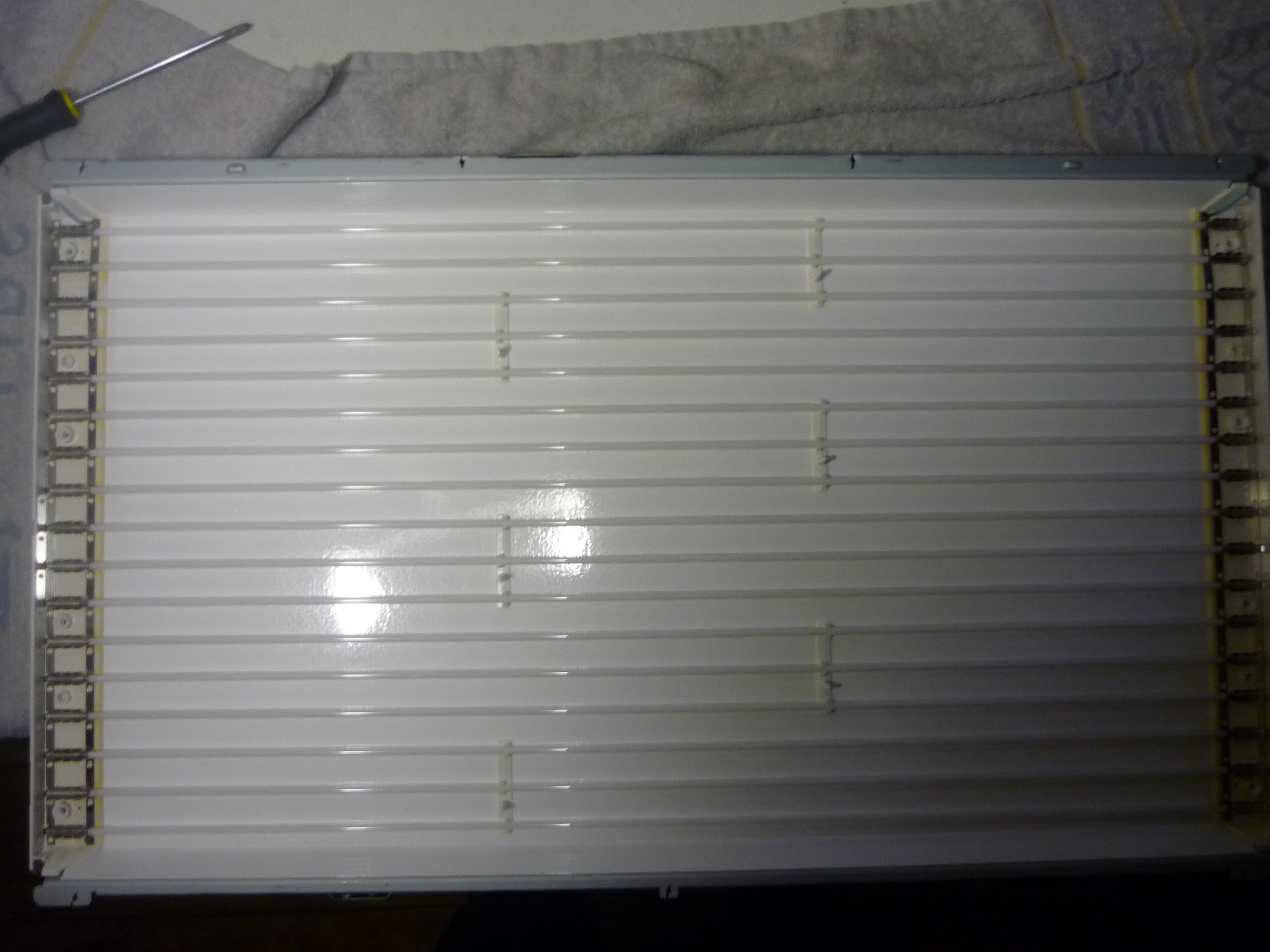

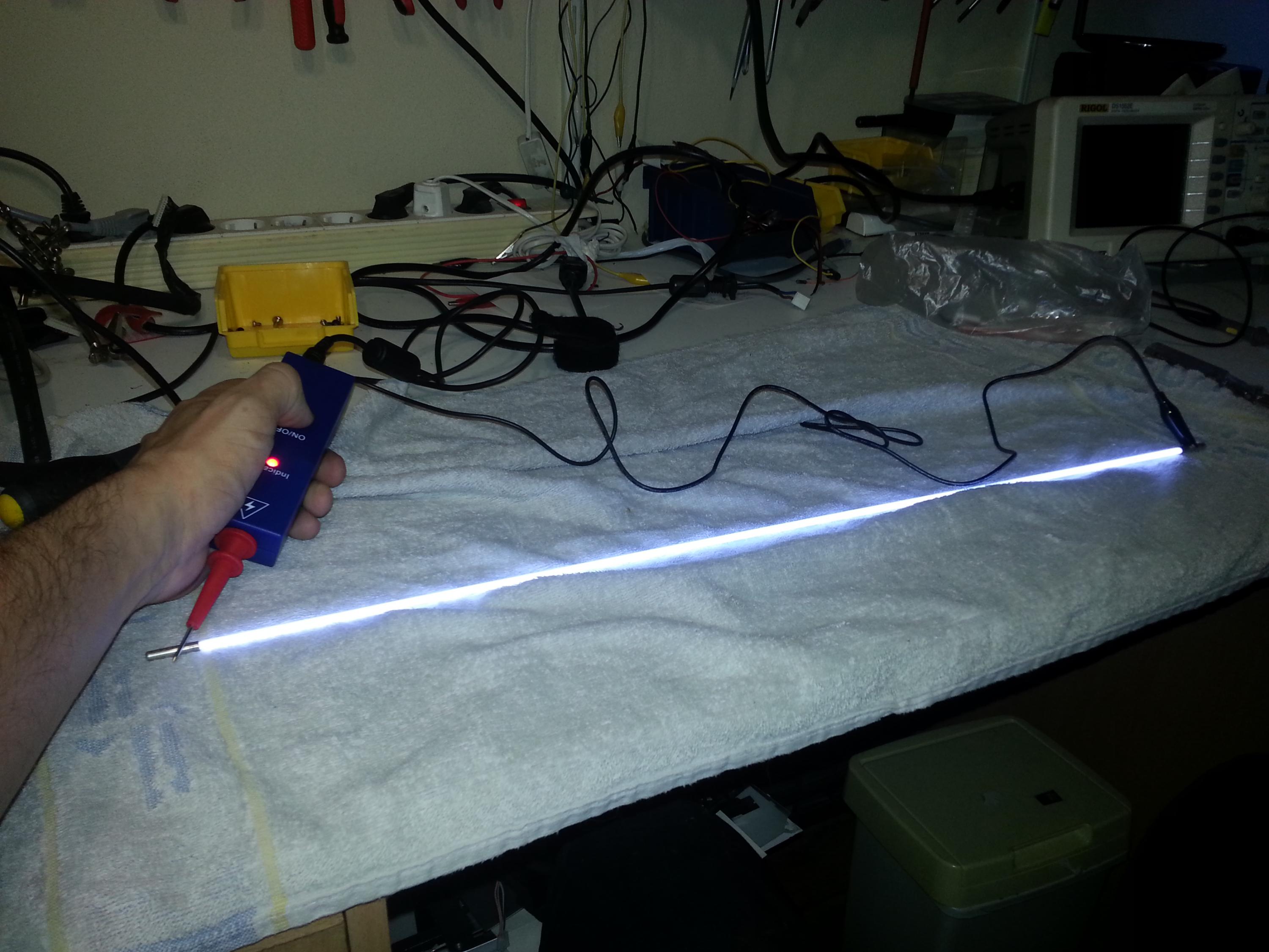

                                    Ok i found out i can test the EEFL lamps wit a CCFL tester of ebay
                                    i tested all lamps. you can test each lamp seperatly or all lamps together. all lamps light up. so the backlight eefl lamps are fine.
                                    or maybe inverter is going into protection because of age of lamps, maybe using more current
                                      Inverters don't sense lamps which are ageing, unless they've stopped working entirely. That looks like a neat gadget, might have to consider one of them myself.
                                        ok i see. Yes it's nice and cheap gadget. works ok.
