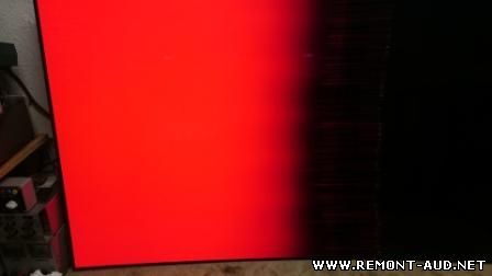

    Hi Diah
    There is a difference
    Collors are right and no black beam
    Bernt

      Hi Davi
      I will try to get a picture of the "inlet" to the screen

          Originally posted by Bandsei
          Hi Diah
          Bernt
          log in INSTART service menu... and show the option of first page and OLED option.... i think we have now close issue at yours replacement T-CON,,,, also try send INSTOP to make Hard reset

                • Diah
                  • Feb 2013
                  • 6647
                  try to downgrade the firmware to old version... then upgrade it to the last one... after each downgrade and update need to send INSTOP for hard reset... hope your screen come all on in case not be sure the ribbon you play before with them not damaged..... if are fine we still have issue at your replacement t-con

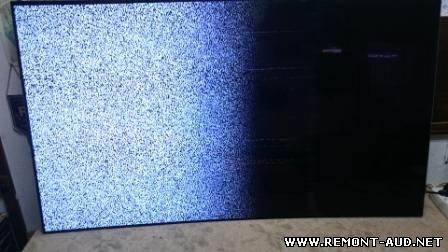

                  • lotas
                    • Jan 2016
                    • 4968
                    • Russia
                    #29
                    On this “ED42D” chassis, matrices are dying all over again, no T-CON or repairs will help here, only replacing the matrix.
                    • Diah
                      • Feb 2013
                      • 6647
                      #30
                      this is wrong.... take look at first post with original T-CON... what you showed are the ebay replacement one.
                      • lotas
                        • Jan 2016
                        • 4968
                        • Russia
                        #31
                        Here you can identify this if this matrix had “ears” on the outside, that is, tabs, side cofs and on the affected side they could be removed, but on this matrix they are hidden in the glass.
                        And what I showed in the photo is the same malfunction, from the same model and no service center could fix it, everyone says only replacing the matrix.

                        • Diah
                          • Feb 2013
                          • 6647
                          #32
                          i am person don't believe on other or service center said... much enough OLED i have under hand not only for repair but for QC test and report..
                          yes its curve one had side edge COF. but since original T-CON didn't cut the right side,,, but it had color fault... and the replacement T-CON from eBay... show correct color but cut from the right side.... allot need to tell and test and at low coast to bring back to normal.... so please don't tell users end result while you heard or read some where ells.
                          • lotas
                            • Jan 2016
                            • 4968
                            • Russia
                            #33
                            Okay, let's wait for the result of this repair.
                            • Diah
                              • Feb 2013
                              • 6647
                              #34
                              it depend not on me or you... its up user and his equipment for traces signal... oscilloscope
