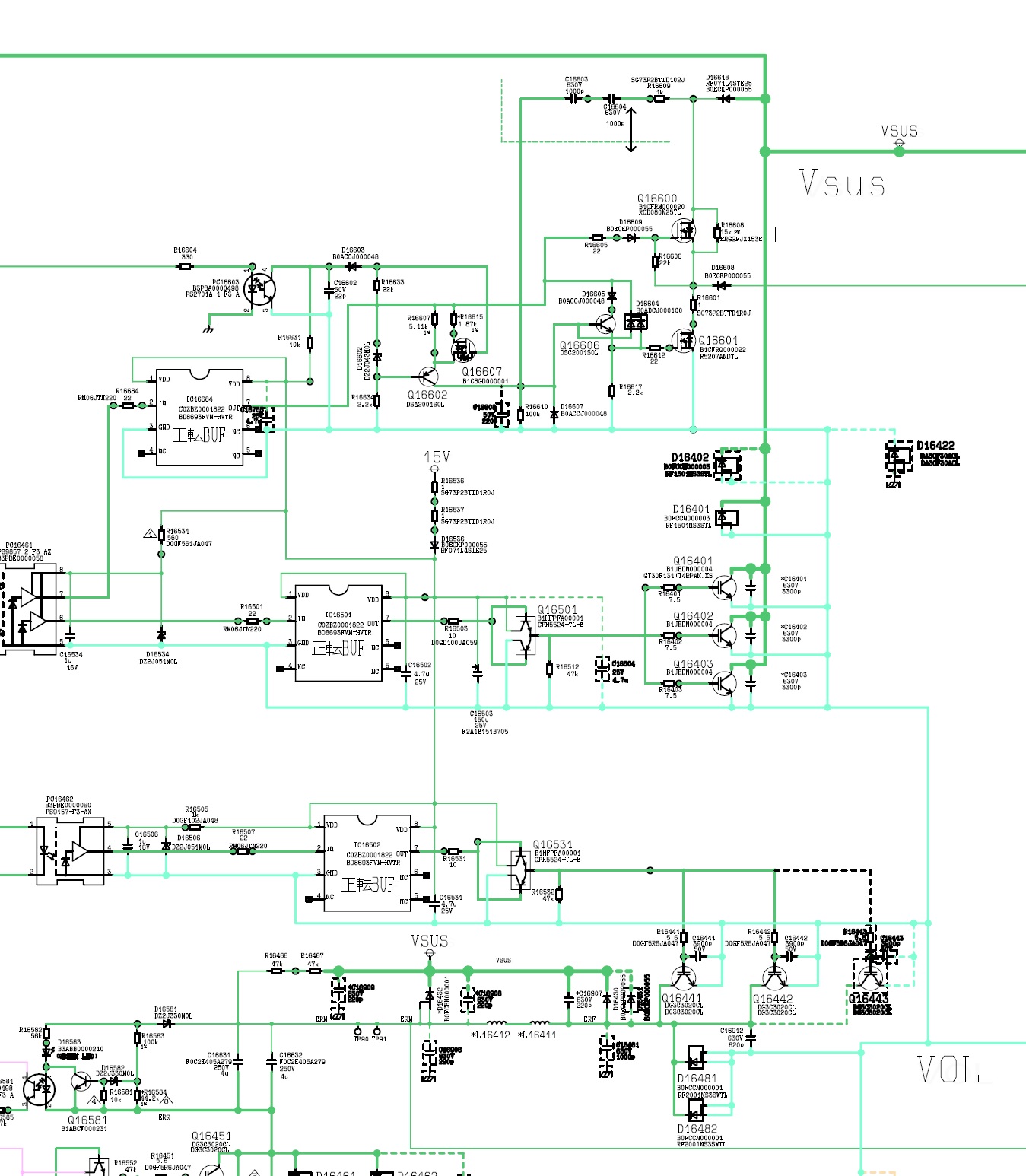

            I think replacing the driver Ic could be a place to start, what board number is this?

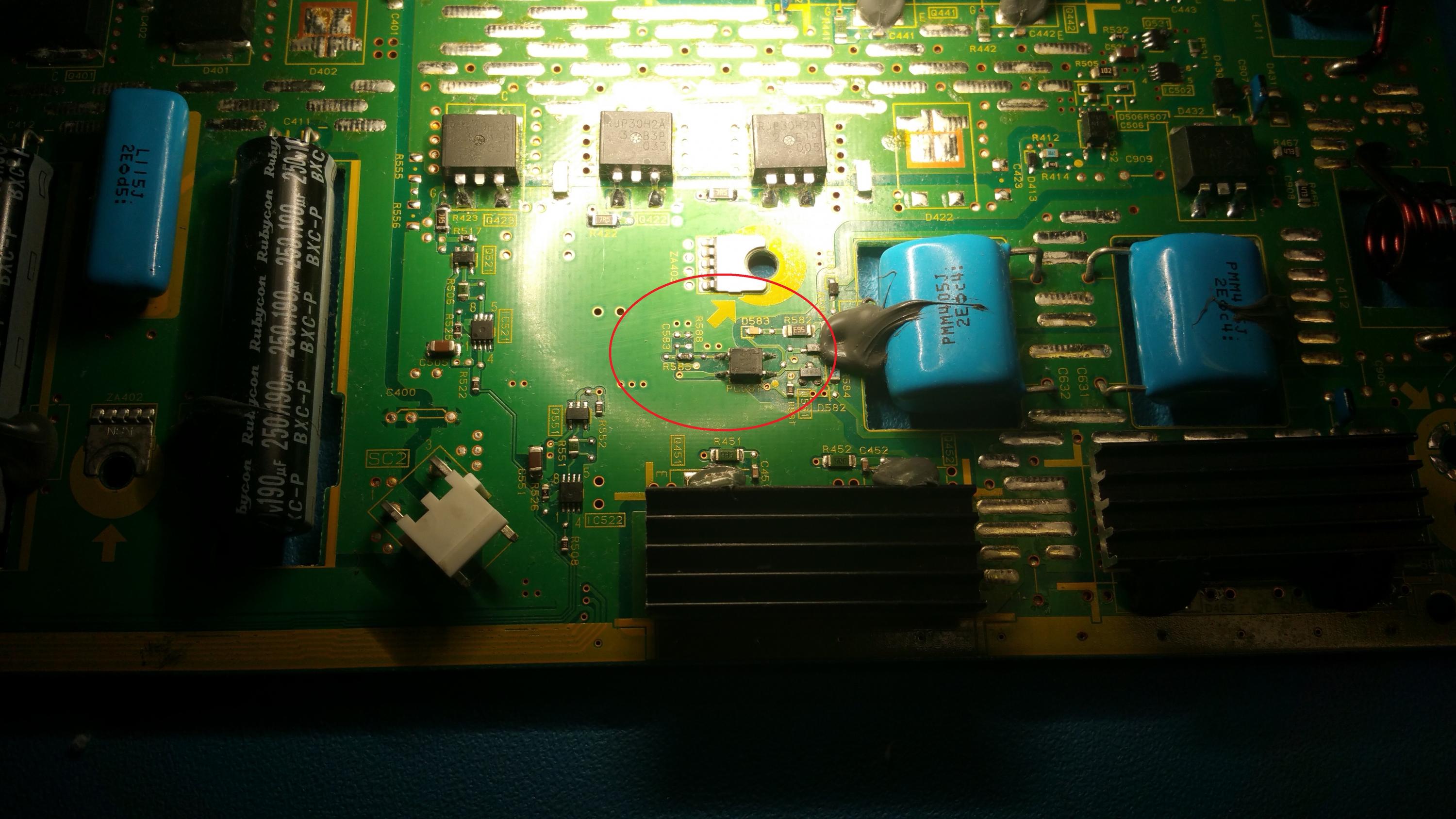

                have a look at this kit. usually this guy has the most complete kits and has done a lot of work with panny boards
                You can see a driver ic and also the associated driver transistor Q531 IC502
                D401 D421 Q401 Q402 Q403 Q421 Q422 Q423
                I don't know if it's just these that you need or try working your way back in cct from q601 etc to that other driver and parts there after.
                there's probably a few different types of failure, very hard to find a kit that covers all

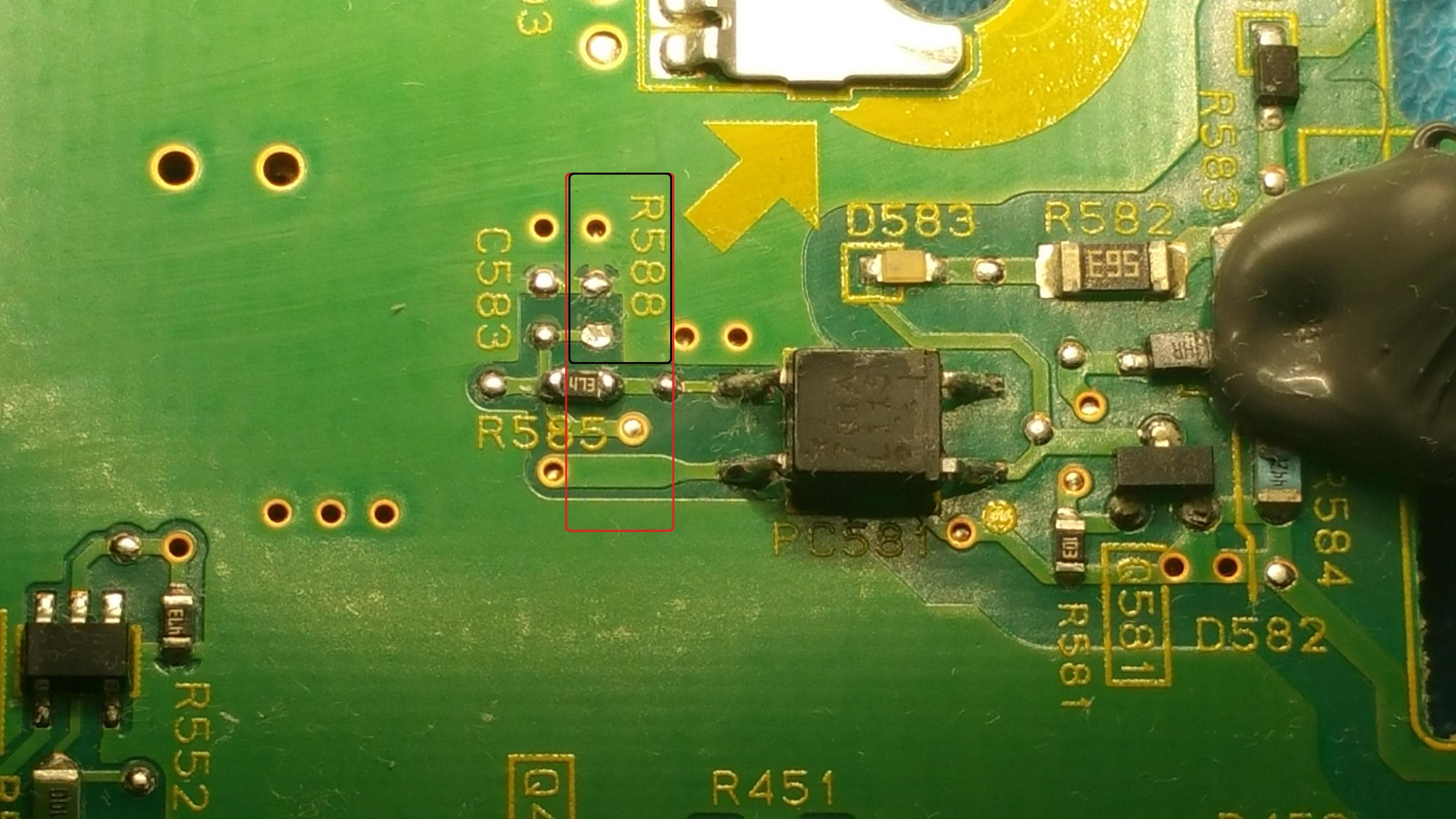

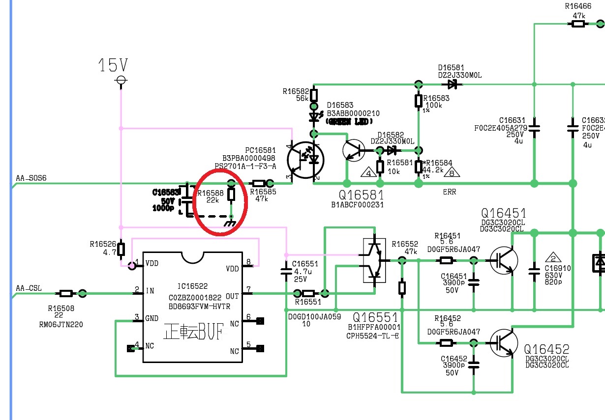

                                    Rookie mistake - I know.. I'm hoping one of you Gurus can help me out.. I was working on the SC board (TNPA5335 SC) of a Panasonic TC-P50GT30, and the soldering iron slipped and I accidentally knocked 2 small resistors off the board.. I found one, but I can't find the other one. I would be grateful if some one can tell me the value of Resistors R588??? or just read off the numbers?

                                      Re: Panasonic Plasma TC-P50GT30 7 blinks SC board shorted
                                      Glad I only had to respond to two posts.
                                      https://www.badcaps.net/forum/showthread.php?t=57665
                                      22K ohms
                                      Of course if you simply went to the service manual and located it in the spare parts list that too would tell you.
                                      R16588 D0GB223JA065 M 22KOHM,J,1/10W
