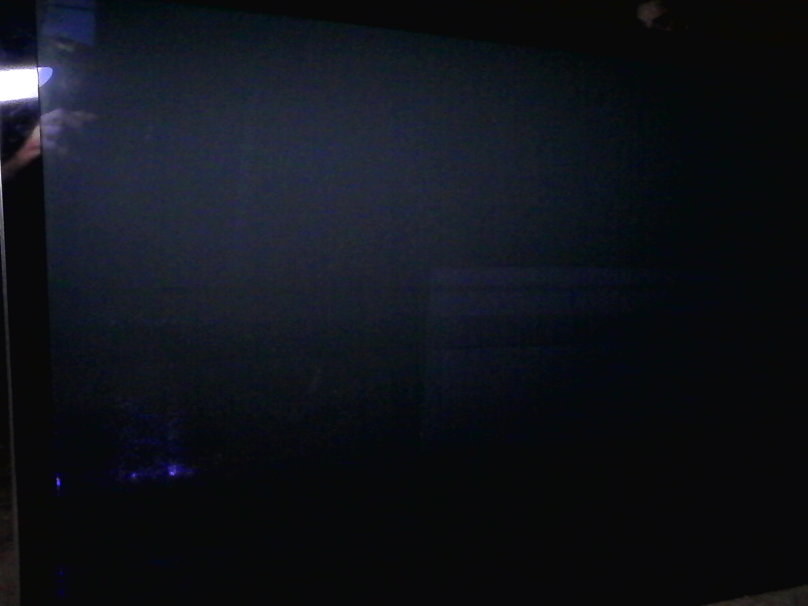

                        #111
                        Re: Panasonic Plasma TC-P50GT30 7 blinks SC board shorted
                        I have replaced all of the 30F131 and RJP30H2A in the SC Boards. There are no longer any shorts yet, I still have a Static screen with brightness but, NO video. The same thing happened on all 3 SC Boards I have tried.
                        Buffers test perfect, SS No Shorts.
                        The same exact thing is happening with 2 different Exact same models
                        Is there something I am missing?
                        See the attached pics
                        This Forum absolutely the best and, the most helpful forum I have ever found anywhere. thanks to all the fantastic members here
                        Help keep these from the landfills

                          #112
                          double check the Sc transistors, i'm seeing kits with RJP63G4 and C08N25 transistors i n them plus 7.5 ohm resistors for the 30f131 and RJp30H2
                          I can't make out brightness or static in the photo. is that a couple of weird bright streaks in the bottom left corner?
                            It turned out that some of these models do need the Exact Suffix or, at least need to be from the same size TV. I was using a SC Board from a 55" and, the picture it produced was similar to a Bad SS or X/Y Board, weird picture with only static and red dots
                            I also want to add that we have rebuilt many (over 50 of these SC Boards so far) and, have gotten away with using ONLY the 30F131 IGBTs. In fact, the kit that ShopJimmy sells provided these in place of the RJP30H2s. We have never bothered using any of the other components (as long as the resistors are tested not to be open) and, they have successfully worked on both the TC-P50XXX AND THE TC-P55XXX SC Boards Since, we order the 30F131s by the roll of 100pcs, which ends up costing about $4.00 or so per TV
                            We also use Heatsink Strips on ALL repairs in order to keep the IGBTs cooler Which I highly recommend either using a small fan or heatsinks with Silicone adhesive because these IGBTs do run quite hot and, this has extended the longevity (Have not had one returned yet.(Knock on wood) : )
                            Good luck

                                #115
                                'tw2005' IF you look at the center of the screen, you will barely make out the image which is supposed to say "No Signal" in a square (Supposed to be Blue Box)
                                Thank you very much for your response
                                Hopefully, this info will help someone in need out there
                                I can tell you now. It was a very Arduous task learning these Panasonic's Problems and, took a bunch of time and tinkering to finally get it. It was very frustrating task.
                                Now, I would like to pass on our success.
                                Thanks again
                                Aimee

                                            Panasonic P58V11B 8 and 12 blinks error "fix"
                                            by Biruslapio
                                            Bought this TV used not working, panel flashed briefly on power up and it was blinking 8 times, a quick look on SS board revealed a common fault on the 3uF 250V capacitors, C201 to C205 (C1620X in the service manual), the solder joints were all cracked, C201 and C205 pins were darkened and some sparking had occurred on them, C201 was split open and clearly overheated in its last hours, replaced that one and resoldered the others, 8 blinks fixed.
                                            Also the previous owner broke the antenna connector by taking the TV out of the wall mount forgetting to unplug it, I desoldered the tuner...
