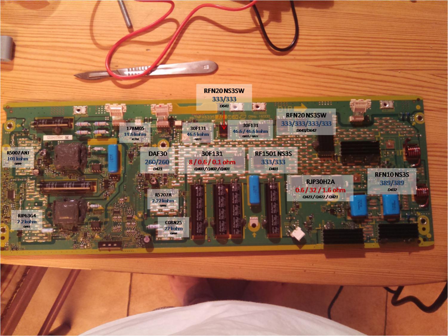

    I've managed to disconnect all pins of shorted MOSFET. Added a bit more solder to it and they went away smoothly.
    Diodes still appear shorted although I'm not sure what they should read. Good thing is after disconnecting all 6 shorted mosfets (3 30F131 and 3 RJP30h2a) sc2 shows 150+ kOhms, so it's not shorted anymore. I've soldered cms components long ago, a bit hard but I pulled through, so I'm probably going to buy a repair kit and see how it goes. Anyway, without that the board is fried so...!
    I've also managed to find a spare board from an electronic shop for 90 euros, I've bought it just in case. Best case I end up with a fixed board and a new one!
    Edit: corrected auto cow wreck typos from this stupid iPad...!
    Edit 2: what should daf30a (and these diodes in general) read when I test their resistance ?

      Re: Panasonic Plasma TC-P50GT30 7 blinks SC board shorted
      All these sets damage is usually caused by arcing at the screws that ground the circuitry some of the better rebuild kits give replacement screws and it is recommended that some solder should be carefully added to the ground pads at the screw holes!
        with those diodes, set meter to diode, test centre to each of the outer legs, if it shows short or continuous beep then I would remove (or lift legs)and check again , check also the pads on the board just in case something else is shorting in cct.
          That I know. When I mount a board back in my TV (either a new one or this one hopefully fixed) I plan to add some metallic washers to the screws and loctite to secure them.
          Here are my measurements so far. In red are what I believe is shorted. I'm actually sure 30F131 and RJp30H2A are dead short (that make for 6 igbts).
          As for the diodes, I'm gonna test the way tw2005 just told me and report back!
          (Red: supposedly dead / blue: supposedly OK)
          edit: testing from leg 2 to 1 and 3 for all diodes doesn't show short (same value for both 2-1 and 2-3, I assume this is logical considering the layout of these things).
          Readings (each time, 2-1 and 2-3):
          D401: 333/333
          D421: 260/260
          D432: 389/389
          D641: 333/333
          D643: 333/333
          D642: 333/333
          I'm actually relieved to see that all 4 RFN20 show the same values. So after all it doesn't seem "that bad". Still have to check the buffers and hope ICs were not fried, too.
          edit 2: and thank you very much for you help, it's really nice to find people that knowledgeable who still share and help like this!!
            diodes appear to be good, bit confusing with q661 but on 2 legs on one of my 2010 boards, I get that, that would usually fail dead short all pins so ok. On that 178M05 5v reg, I don't know what that should read. Seems off to mine in cct but different board and what pins are you measuring to what?
            Looking like 6 IGBTs and this may work again but I'm wary of FET driver ICs.
            Can you locate q531 an measure resistance. 5 pins, you want across the pins as in my picture

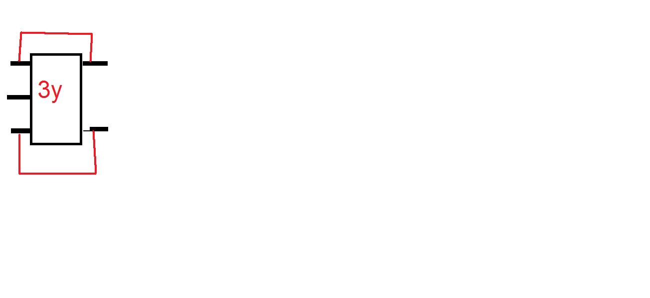

                unfortunately the one i have here stops at 2Mohms... I might get a hand on a better one at my friend's shop though.
                edit: tested with 2M setting, it's stucl at max value. So I don't know if it's 3 Mohms, but it's more than 2, which is a good start
                edit: for the 178m05 I was measuring the same way as igbts. This probably makes no sense anyway so I'll live this one aside for now. I'll grab a repair set off eBay, this seems like an affordable option. best case scenario I end up with a repaired board that works and have a spare "new" one in my closet.
                      does not tell me much, don't know what way you did some of those transistors either. there's 3 combinations I'd try, 1-2,2-3,1-3
                          I've tested everything again from drain to gate and drain to source, as you suggested. Before that I had absolutely no clue of how a MOSFET (ar any transistor, actually) worked. Going through some datasheets help me understand that (and why to test from 2 to 1 and 3). The 6 shorted igbts are short from gate to both source and drain (tested in diode mode, cotinuous beep for 1-2, 2-3, 1-3), so they're really dead short. I'll replace them asap.
                          Q531 seems fine (tested yesterday as you suggested), and IC724 (178M05) seems fine too, with no short between (source|gate) and drain (> 2Mohm), and something like 20kOhm between source and gate.
                          Just to clarify for other diodes (eg. RFNxx, DAF30A...) they show an identical drop value (is that the correct term?) for 2-3 and 2-1, and closed circuit between 1 and 3. Is that normal (judging by the diagram seen here , this seems normal). Am I correct so far ?
                            looking good then although it's Vin gnd,Vout for the reg don't know what pins but I'd say ok.
