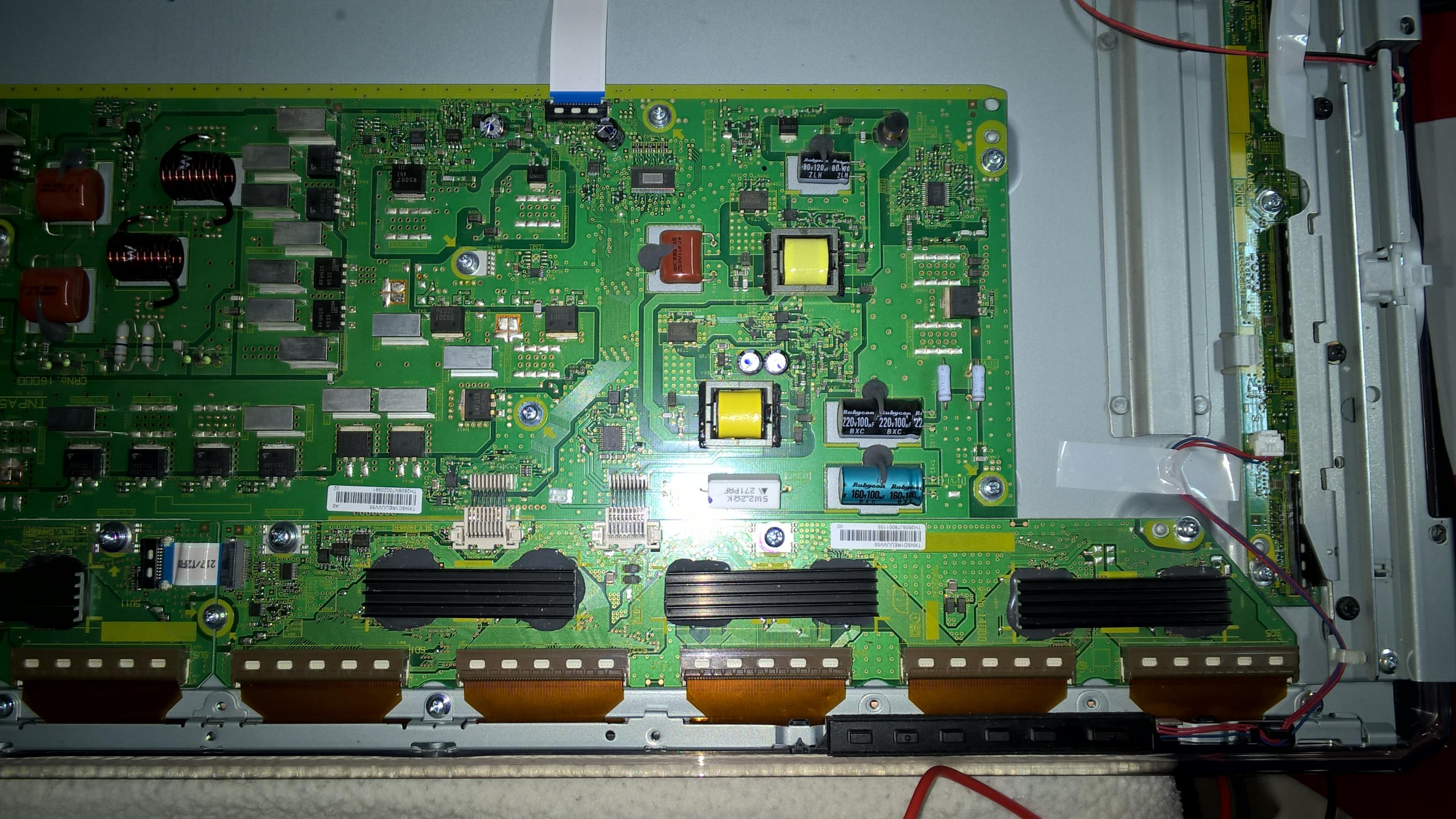

            New member. First post ever. Working on 7-blink issue. I've read all posts.
            After replacing Q401,402, & 403 w/ parts from a 'Shop Jimmy' kit. I no longer have a short across SC2. At this point is it stupid to continue replacing parts, or should I proceed directly to the SC jig test w/ SU & SD disconnected?

                Update! I found one more IGBT shorted on the SS card after I wrote my last post, Q661 (RJP63G4). I have ordered it off eBay and waiting for the part to arrive. Will give you an you update once I receive the part.

                      First step, verify what is shorted. Will probably find 30f131 rjp30h2 are, if they are remove and then check those diodes as there is a good chance they are ok so you won't need them. There probably are others that can do the job, just a matter of getting the specs and searching.

                                Hi, I didn't risk it and ordered rjp30ha2 from another shop. Yesterday I had some time, so I opened tv and replaced( 3 30f131 and 3 rjp30h2a ) now tv work perfectly but I have a question about firmware. Is it really necessary to update firmware on 7 blinks of death? My firmware is 2117

                                          Update:
                                          I finally got the RJP63G4 IGBT's and replaced, fired up the SC board with SC50 jumpered and once again fired up for a seconds and died with 7 blinks. This time I found the replaced Q661 RJP64G4 shorted and also found Q600 C08N25 shorted (between D and S). I have ordered C08N25 MOS FET and once I get it will test it and hoping it will work.
                                          I Checked all gate resistors and all of them check out fine.
                                          I checked measured all other IGBT's and no shorts.
