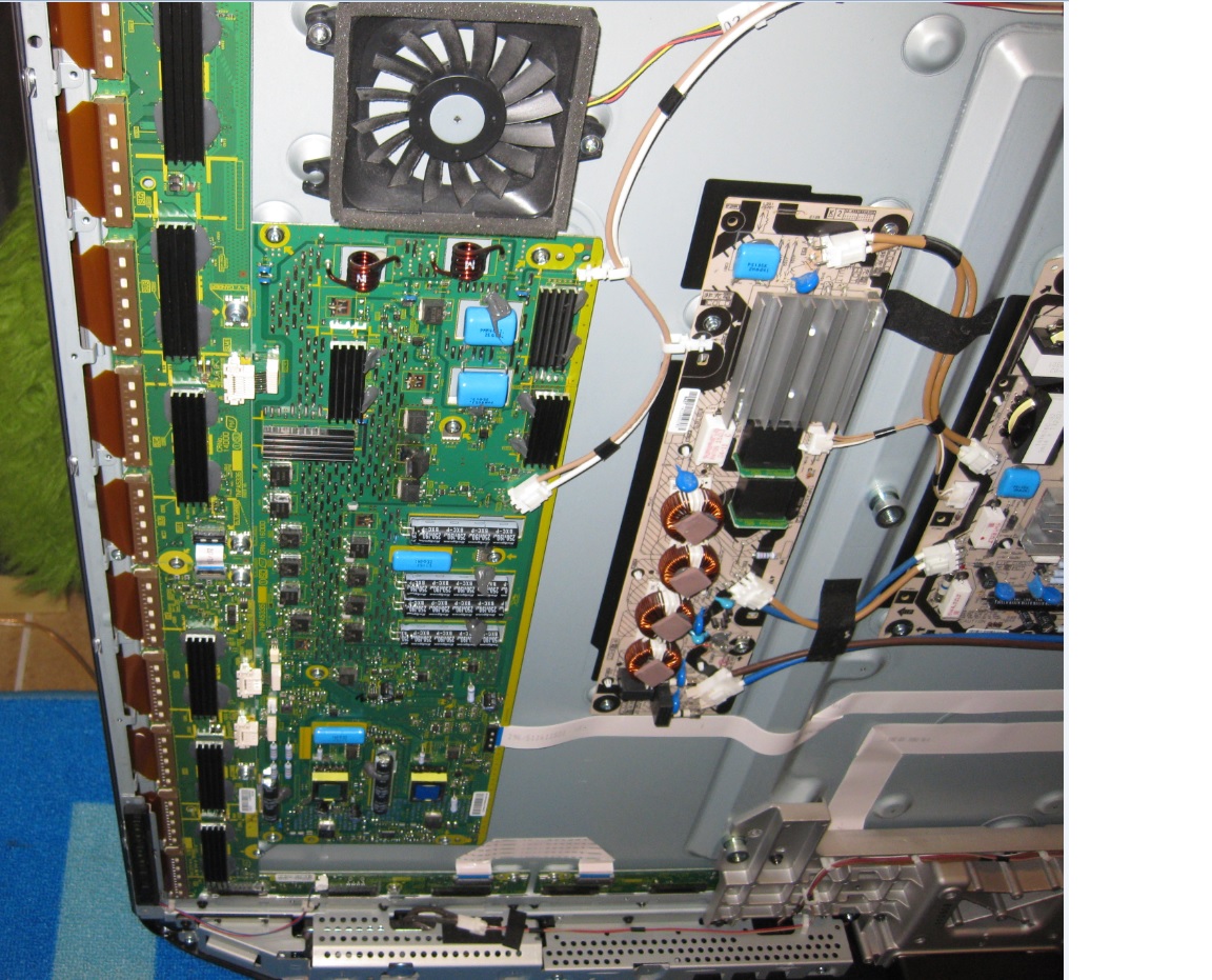

    Panasonic Plasma TC-P50GT30 7 blinks SC board shorted
    Panasonic 3D Plasma TV 2011 model TC-P50GT30 7 blinks, open the back cover and found Q422 (RJP30H2A) was blew. Took it out, the Power connector was still shorted.
    Check another two RJP30H2 shorted two. I took them out, and still found 3 MOSFETs shorted (30F131).
    Looks like this is a common issue for 2011 Panasonic Plasma TVs.
    I ordered the parts on ebay, hope to replace all 6 parts can fix the problem, though still not know if there are some other damages yet. I'll update once I get the parts.

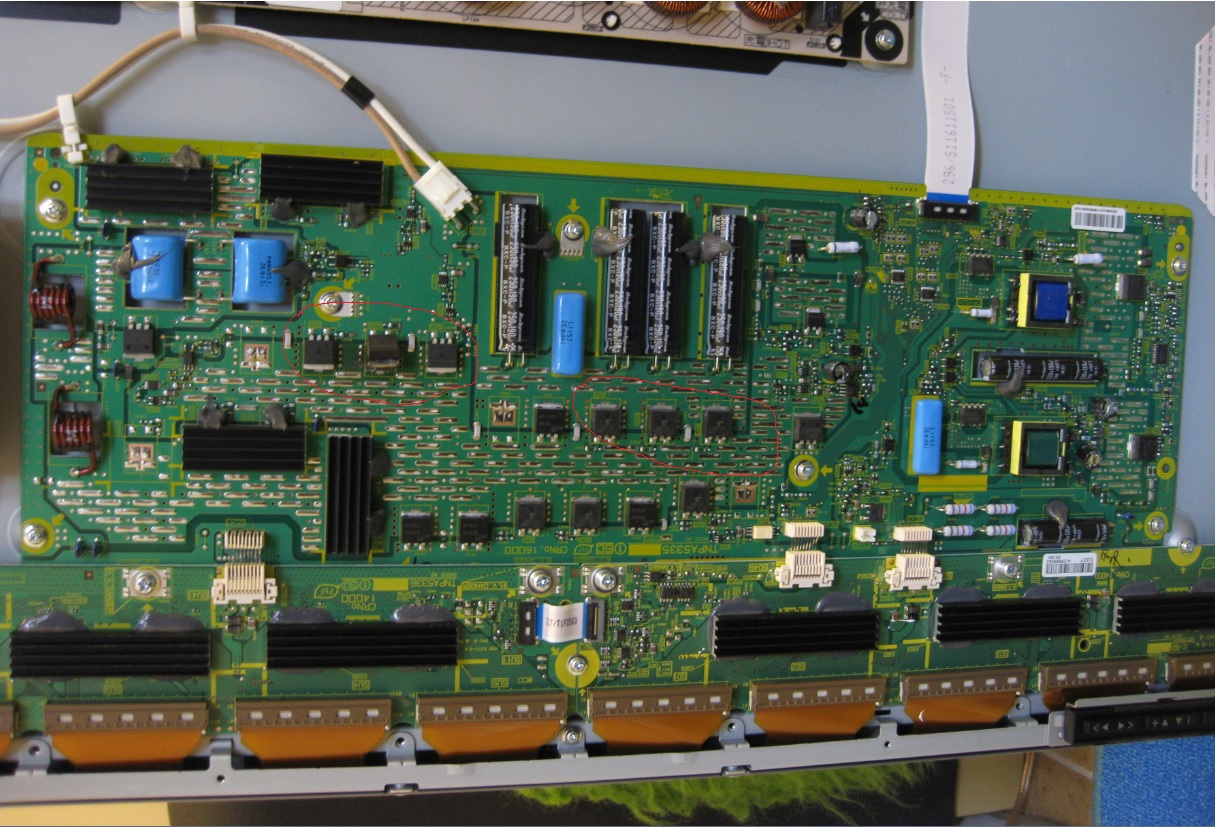

            Re: Panasonic Plasma TC-P50GT30 7 blinks SC board shorted
            Update:
            Received the parts today, replaced the 6 transistors (3 RJP30H2A, 3 30F131), TV works great now.
            Steps:
            1. Replaced the bad 6 transistors with the new one.
            2. Install the board back to TV, but NOT connect to the buffer boards (SD/SU) (I even disconnected the grounds, no physically touch between the SC and the two buffer boards).
            3. Shorted the SC50 (I used an old IDE hard drive jumper)
            4. Plug and Turned on the TV, it powered up constantly, no blinks any more, TV response to the remote control.
            5. Unplug the power cord from the wall, wait for 5 minutes.
            6. Connected the SC board with the SU/SD board firmly (connectors and grounds).
            7. Plug and turned on the power supply, TV lite up ! Everything works !
                          They're IGBTs, insulated, gate, bi-polar transistor.
                          Generally you will find they will simply go short so no 2 pins should show short.
                          They will be 1.gate,2. collector, 3. emitter. viewed normally and the tab is collector or center pin.
                          There are repairs kits out there since this is a very common fault.
                            The first step is to measure if the power pins short or not (the two pins from power supply, white color), if shorted, then most probably the MOSFETs were shorted.
                            If not shorted, measure others on the board the way as tw2005 mentioned.
                            If no shorts in the SC board, then isolate the SU/SD board, and jumped the SC50, turn the TV on to see if it blinks. If no blinks, the power stay, then this may be the SU/SD board issues, or even panel problem.
                            30F131 is very common N channel, tw2005 gave enough info. I bought 10 pcs from China cost only a few bucks.
