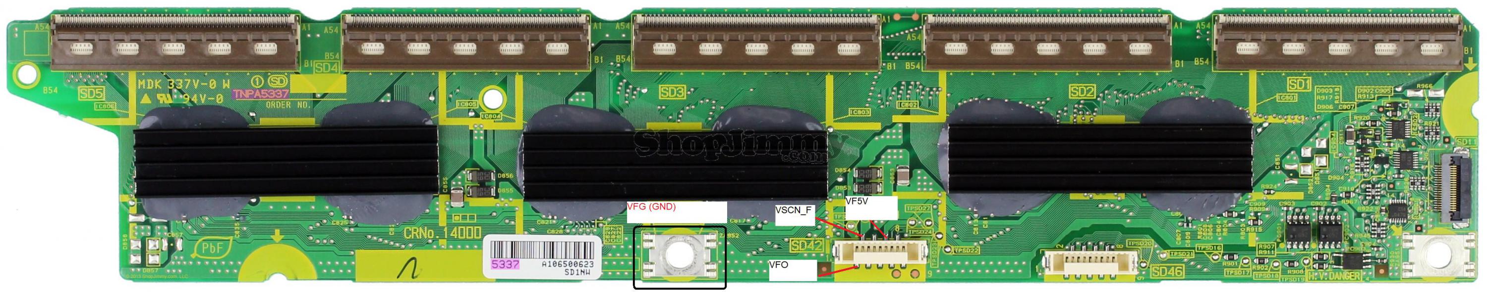

        What have you got to do the test? How high can your meter go for resistance?
          #84
          Re: Panasonic Plasma TC-P50GT30 7 blinks SC board shorted
          TRY THESE FOR RESISTANCE, TO GND. do both polarities(reverse the probes) and write down results
            #85
            I think my meter can go up to 40 M
            When I test the junction of R696-r9=699 I have 4M (not stable)
            to pin 3 of IC 724 2.6K (stable)
            When put on sound mode for continuity, no sound for short
            other test can I do ?
              Why don't you just disconnect the SD from the SC and also the ribbon between the SD/Su and measure the points I highlighted in the picture.

                      My result
                      with all connector unplug betwwen SC and SD and between SU and SD
                      VF5V : 39 M
                      VSCN_F : 40++
                      VFO : 40 ++
                      Probe invert
                      VF5V : 4,5 M
                      VSCN_F : 40++
                      VFO : 40 ++
                        #91

                              but when i replug the SD42,
                              i have for VF5V : 2.6K only
                              and 4-5 M for the other one....
                              normal ?
                                #95
                                normal ?
                                don't know, 2.6K would be correct as the 78M05 regulator has that resistance which ids the 5v supply and I suspect you are on the wrong pin on the other board? If it's working fine, forget about it.
                                      Finally i change 3 30f131 and 3 rpj30h2a. Unplug the SD and SU board and jump sc50.
                                      Start TV and grenn Light and fan run. Reconnect the SD and SU, and boom! Perfect picture, no more 7 blinking red light and no horizontal bar in the low part of the Tv on startup.
                                      Thanks everyone for your support and help !
