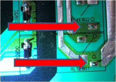

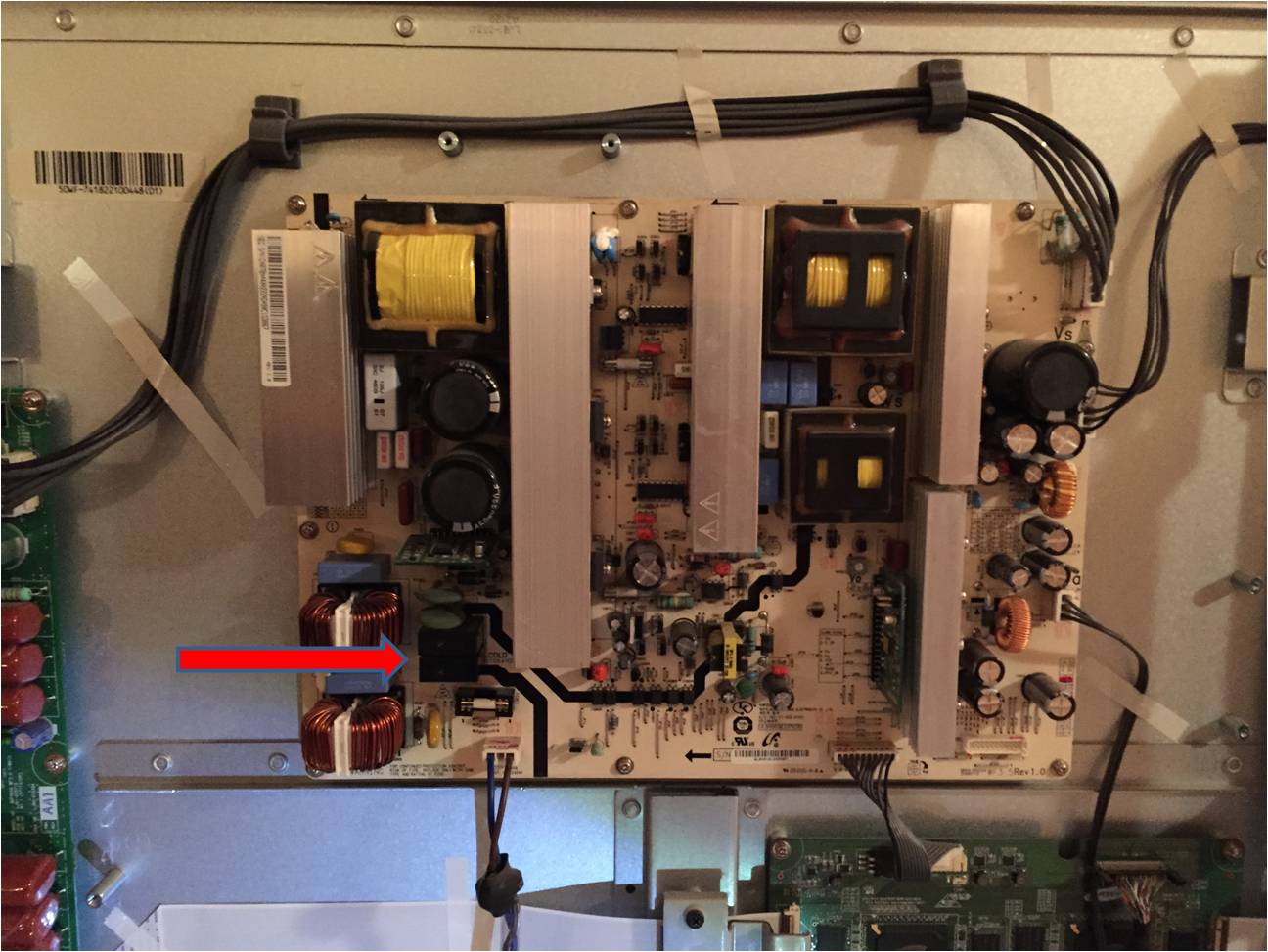

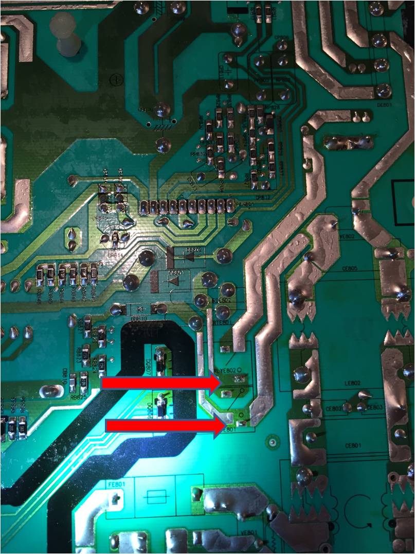

                        I found this forum while looking for fixes for my Samsung PN50A550. Same problem as described by others. TV goes into a clicking mode with no picture or sound. I wanted to share my final fix for this.
                        As suggested in this forum, I replaced C102 and C131. Both of the original caps ended up checking out OK once I measured them out of circuit. No luck with this fix for me.
                        As I was observing the set powered up with the back off, I isolated the relays that were clicking to two on the power supply board. By pressing on the board in this general area I manged to get the set to start working again. Most likely a cold solder joint or cracked trace on the PC board. The set worked fine for a couple of months and then it re-occurred.
                        This time I removed the power board and found two cracked solder joints on the back side right under the relays. I attached pictures to show the location.
                        It appears that the through holes are actually sized a little big for the pins. I noticed when I touched them up with the soldering iron, that the solder fell into the hole leaving a gap between the pin and the hole. When the board was initially wave soldered, not enough solder was there to fill the hole and over time this caused the joints to crack. Not sure which one or both were the culprits but I touched up both and the TV is now working fine.
                        Hopefully this will help others with the same problem where the cap replacement did not work.
