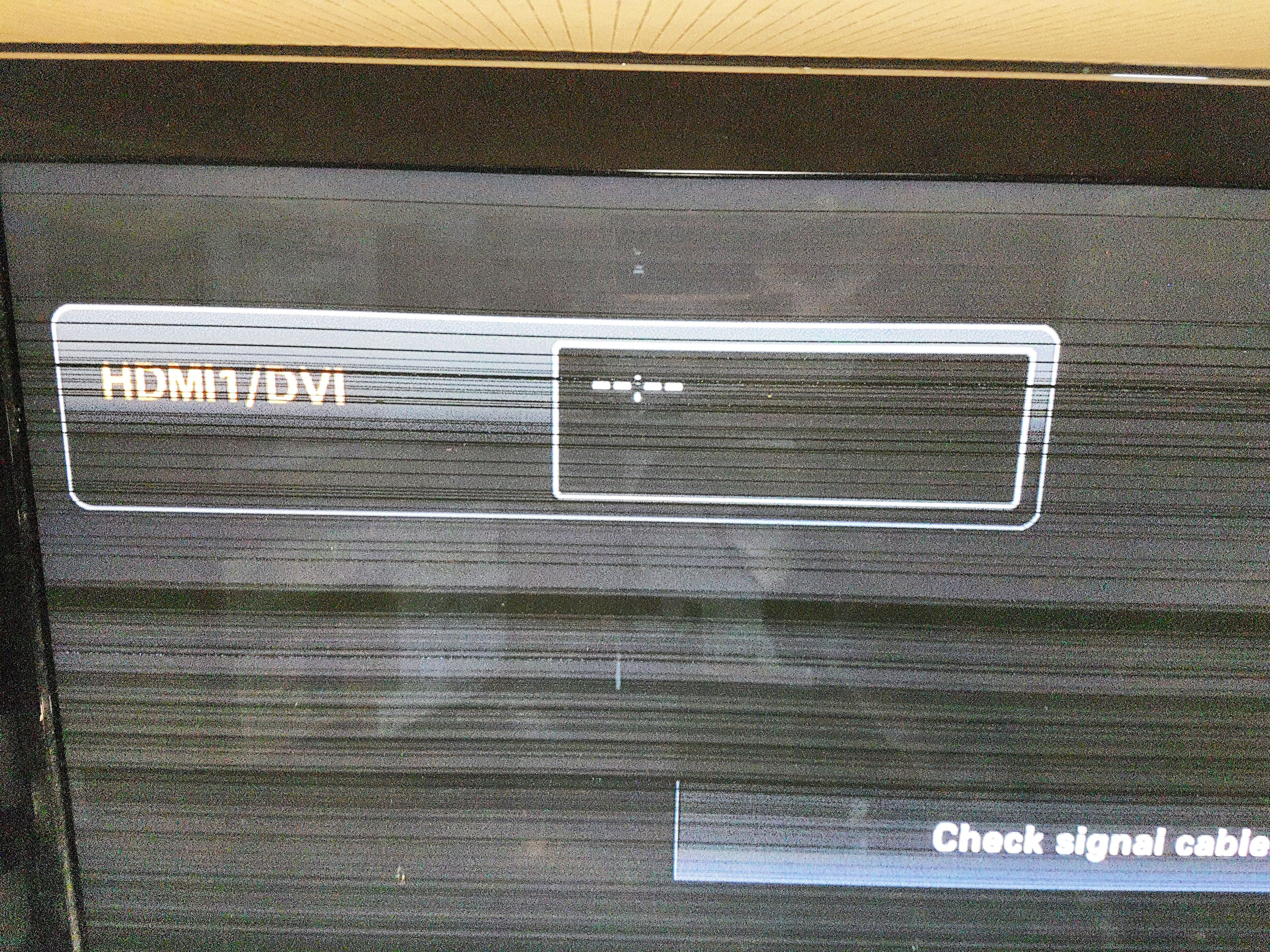

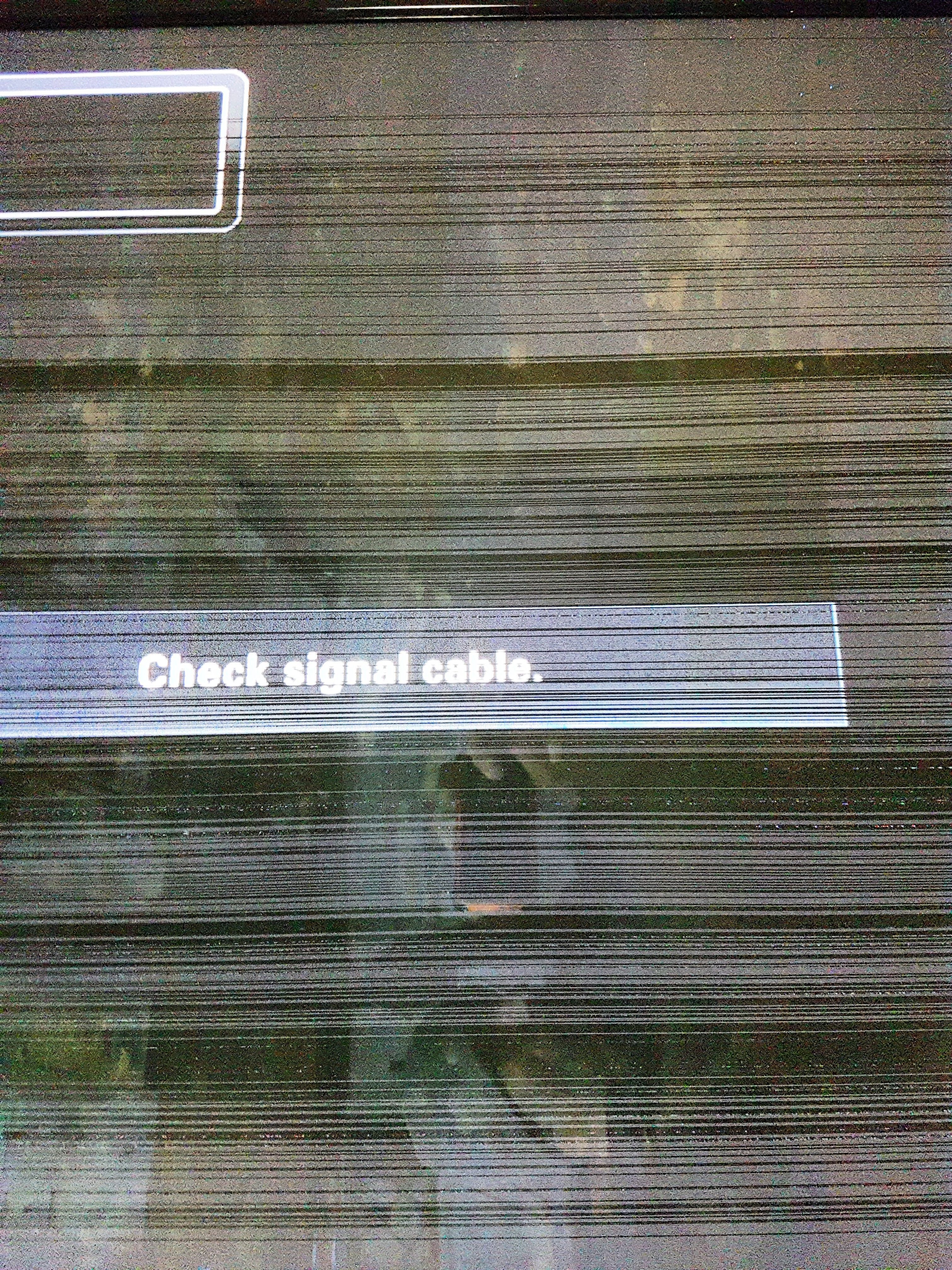

                      Did some solder rework on the SMPS and X-Main boards. Inspect & test the "new" Y-Main board, looks good and significantly less heat damage.
                      Installed & test. Was getting some hissing noises from the Y-Buffer and the screen looks like this:
                      Click image for larger versionName:	IMG_20231227_153549_DRO~2.jpgViews:	0Size:	4.63 MBID:	3169007
                      Click image for larger versionName:	IMG_20231227_153603_DRO~2.jpgViews:	0Size:	4.35 MBID:	3169008
                      • nomoresonys
                        • Jan 2013
                        • 12307
                        • U.S.
                        Make sure y-buffer to y-main connections are as they should be. For testing unhook y-buffer from y-main, because a faulty buffer can kill a y-main and vice versa, maybe test the little mlc caps on y-buffer at least for shorts and retest y-buffer IC's , testing there if needed: https://www.youtube.com/watch?v=5hVi5gd0aec
