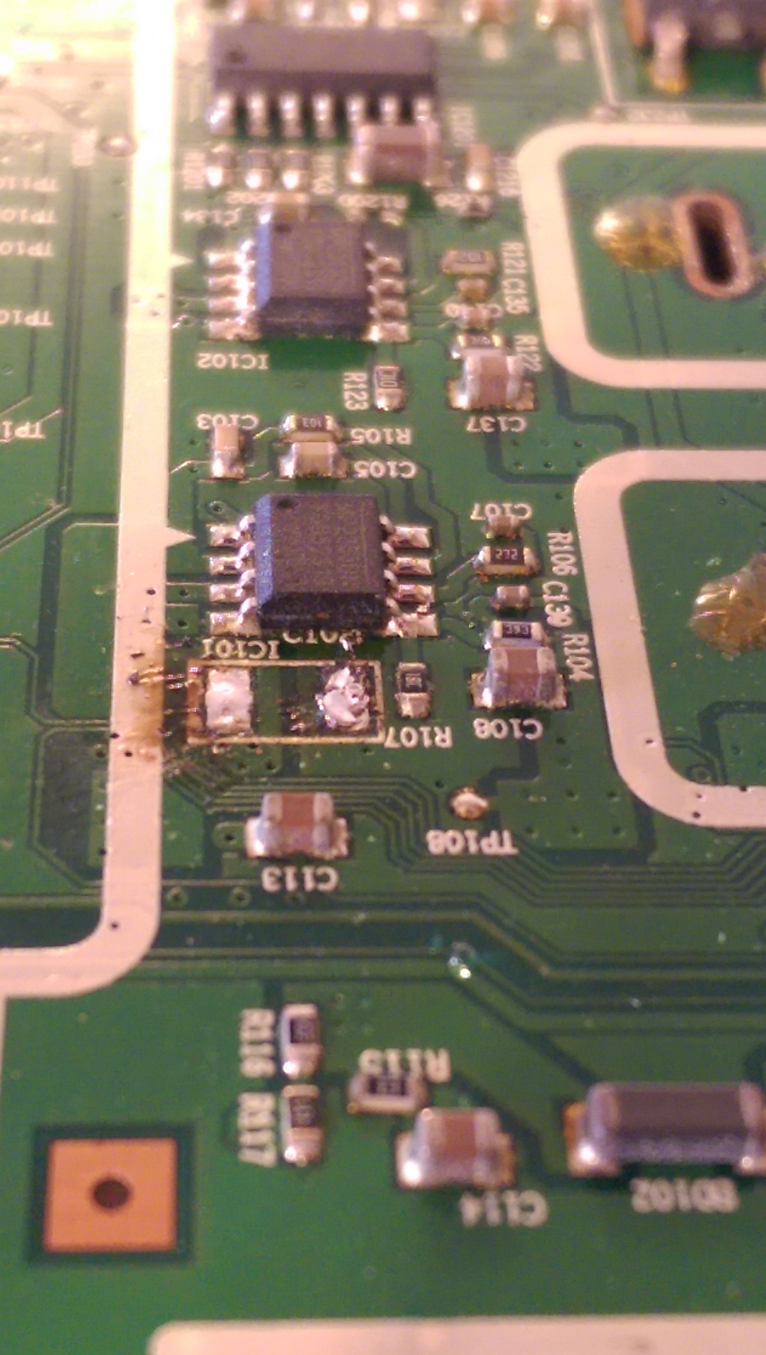

          Actually, my iron has a similar tip. I was worried about to much heat flowing into R107, which was extremely close to C102. I was afraid I might throw the resistance value off by the heat on the body of the resistor. I have a weller iron as my mainstay with a magnostrictive heating element which really runs too hot for this kind of work.
          As for the cap I chose to use,I powered up on a bench supply two electrolytics and a
          poly? and tested for leakage current. the electrolytics settled down to about 1 mA at 15V, but the poly? dropped down to 1 uA I'm going to button up the set and run with it.
          I figured a cap of that value was not that critical. probably filtered the supply rail for the speaker driver chip. Could be wrong. set powered up perfectly.
          I "assumed" that C102 was leaking too badly and was pulling down a supply rail.
          An interesting note: I found a self tapping course thread screw in place calling for a machine screw, and visa-verse when I pulled off the back cover.
          UPDATE:
          Same symptoms have reoccurred a few times this winter when the tv is cold.
          one reboot and the set comes on (and the cat runs around the house from the ultrasonic noise blaring out of the speakers) and all is fine.

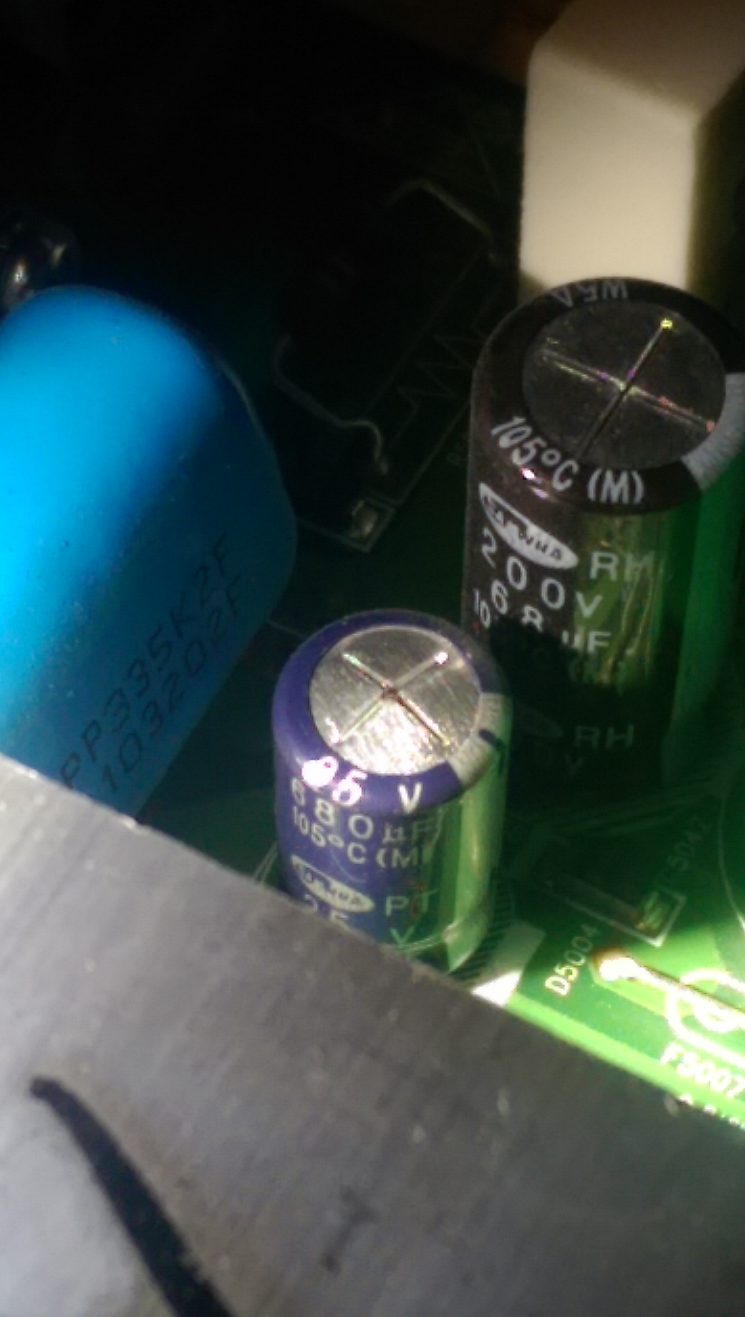

          Guess I'll have to go back in and do the power supply caps next. Still have an excellent picture, no bad pixels.

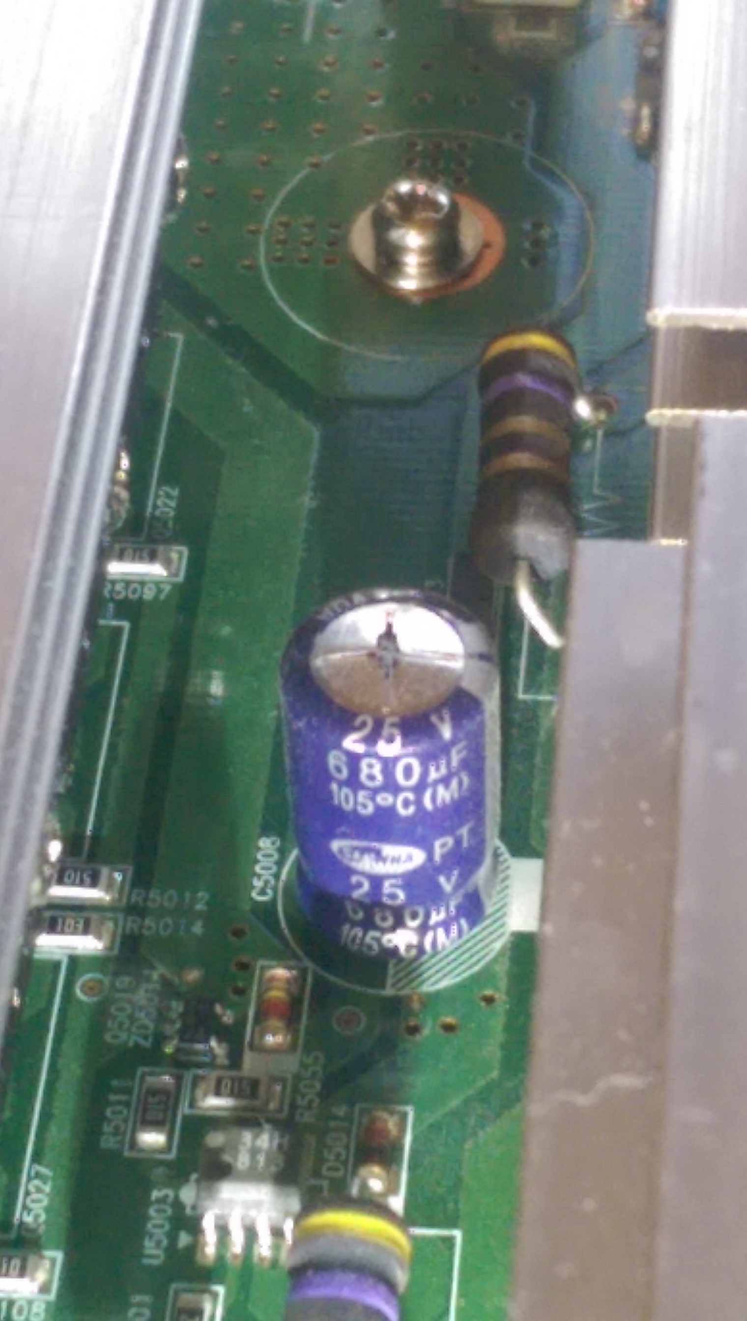

            Had a PN50A550 that started with squealing and power cycling on start up that go worse over time.
            Thanks to those who contributed to this thread. When I first opened it up, I had two blown (bulging) capacitors (C5003 and C5008 both 25v 680uF caps) on the Y-sustain board. I replaced those, but it did not fix the issue.
            I ordered P16230CT-ND from digikey and replaced C102.

            Also, when I pulled C5008 off the board to replace it ripped the soldering pad from the board off with it. Just an FYI that you can solder to the pad on the opposite side of the board and it will work just fine (for through hole mounts).

                SAMSUNG BN94-01658E C102 location number is under IC101 if you are looking for that first, good luck.
                The kit from ShopJimmy is a ceramic replacement cap with no polarity which can be installed in either direction.
                Shopjimmy offers no support at all!
                IC1203 - STA335BWS (SSOP-36) I could only find this on Ebay!
                IC101 - (MP2363DN) Digi-key P/N 1589-1366-ND
                C102 - 47uF 10V Tantalum Capacitor Digi-key P/N P16230CT-ND
                I used an iron to mount C102 after I mounted IC101 due to size, worked nice for me!
                Hope this will help someone!
