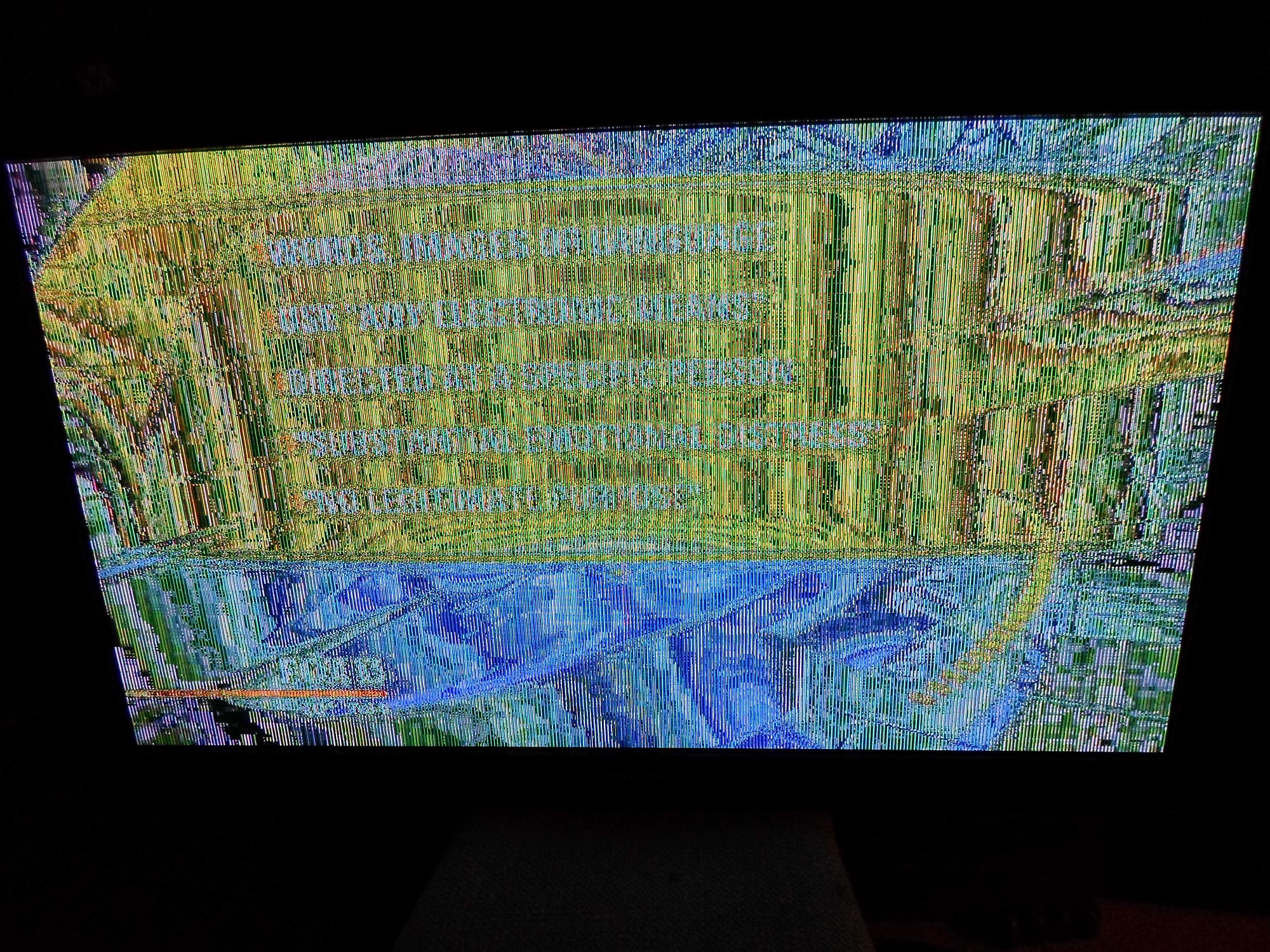

          I replaced the main with a board from ModusLink, and the TV came on. After testing for a few days, the last 2 mornings when turning the TV on from being off overnight, it shows a distorted picture like below, and after a few seconds, cycles off and back on again several times until the picture finally becomes normal.
          This is what the original owner had described happening to me as well. Any thoughts?

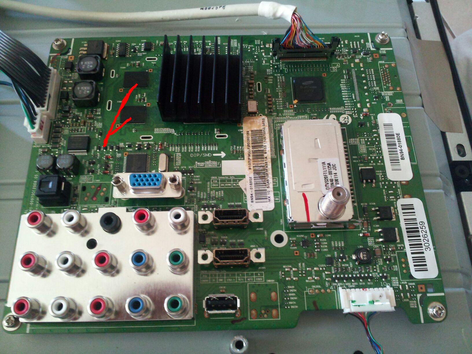

                  Since this seems to happen when TV was cold I was experimenting with the freeze spray on the main board. After some isolating, it seems like when I freeze the two IC's in the pic, that the problem happens. I tried to isolate to one but can't. After the defrost it usually comes back on normally.
                    Re: Samsung PN50A510 P3FXZA Plasma Cycling On/Off
                    That seems possible. They are the RAM chips for the video processor. It is a very common issue with this model. You could try reflowing them with hot air and flux, but I would not expect that repair to last.

                      I will give it a try.. How are the pins arranged underneath all I see is a black rectangle. And it seems to be the top one.
                        Typical pin layout

                          What temp would you set the hot air station to? Ill try it on the old board.
                            230°C is typical. That being said, I would not want to sell on a TV with a reflowed main board, due to the high possibility of future failure in just a few months.
                                  Should I use something to press on the chip when heating it or no?
                                    Not usually required. Just remember to circle heat between the areas and swap between chips every 10 seconds -- you're not trying to remove them! I recommend around 3 minutes of heating.

                                      Tom, I tried the reflow, did not work. It seems the person I got this TV from had the same issue I am having now (with the new board) and it got progressively worse, perhaps eventually corrupting the eeprom from all the on/off cycling to where it won't come on at all.
                                      We will see what happens with the next board and if I get a chance will ask a tech at ModusLink and see if they can provide any info..
                                        After you do get the new board, I'd advise some fix-on heatsinks for the RAM to give them better longevity.
