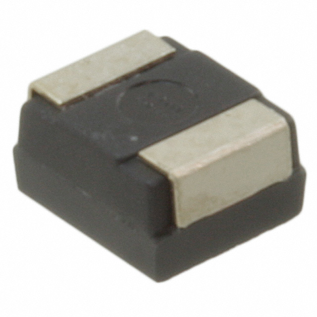

                  Actually the Poly cap is closer to the size than the tantalum, which actually is larger than the original. I ordered both caps. The values are the same and being a beginner I had no problem soldering. I simply put a spot of solder on one side, using tweezers solder it and then the other side. TV is still working great. My neighbor suggested I could have used scotch tape to hold it and then just soldered thru it. I did not have to use that method. My tools are very limited so anyone with a steady hand can do it. The poly as my neighbor (electrical engineer) explained is a better cap and will last longer.

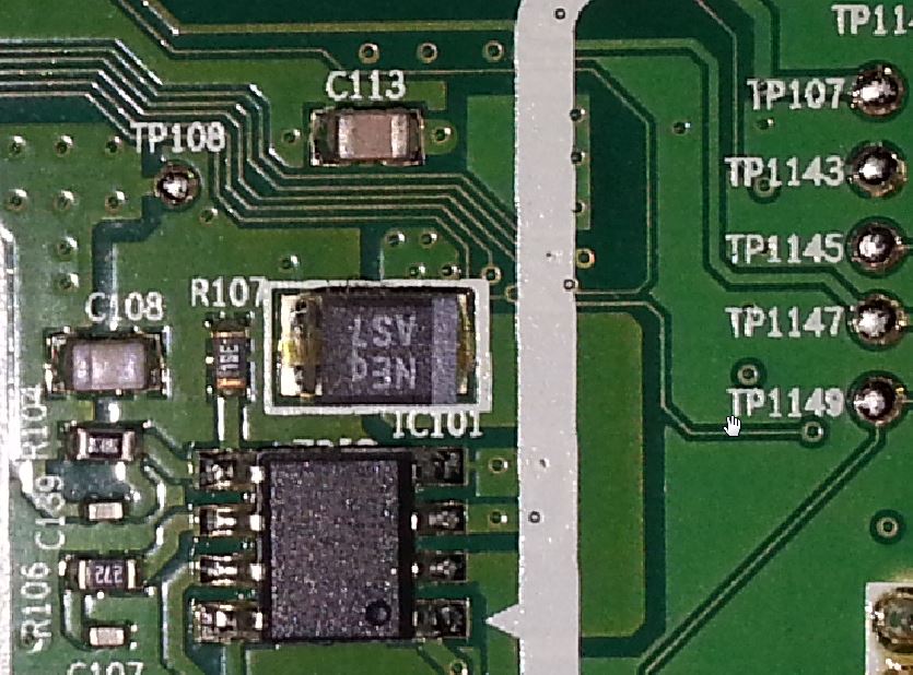

                    I forgot to mention that the C102 on my main board was not labled either. I meant to take a pic and post it with the same information as you, but was so pumped to get it assembled back together and on the wall, but forgot. PN58A550S1FXZA

                        I ordered the cap bkjeight recommended, part number of 399-10532-1-ND. It is smaller than the original cap but found I had no problem getting it soldered in. Just make sure to position it correctly and it will sit enough on each pad. I used two cheap soldering irons at the same time so I could heat each pad and remove the original cap. It came off with no problem.
                        I have now turned on the monitor twice since replacing the cap and each time it came on perfectly. Previously it usually took 2-3 times of cycling on-off before the picture was correct. I will post again if any updates.

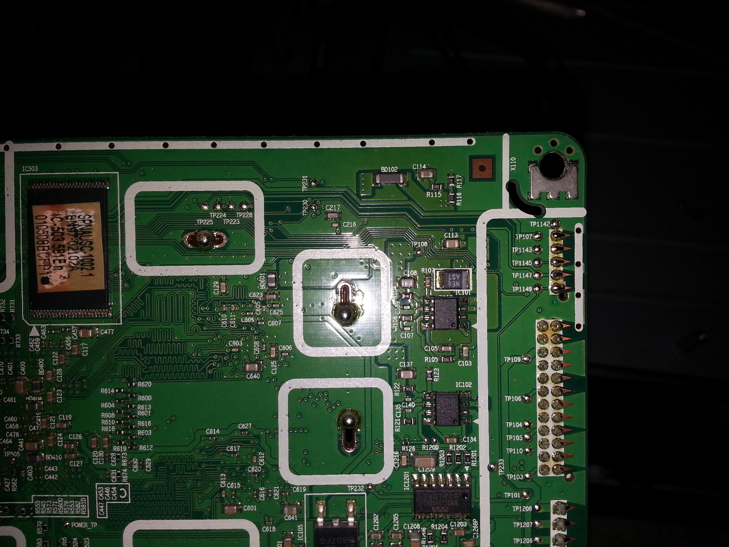

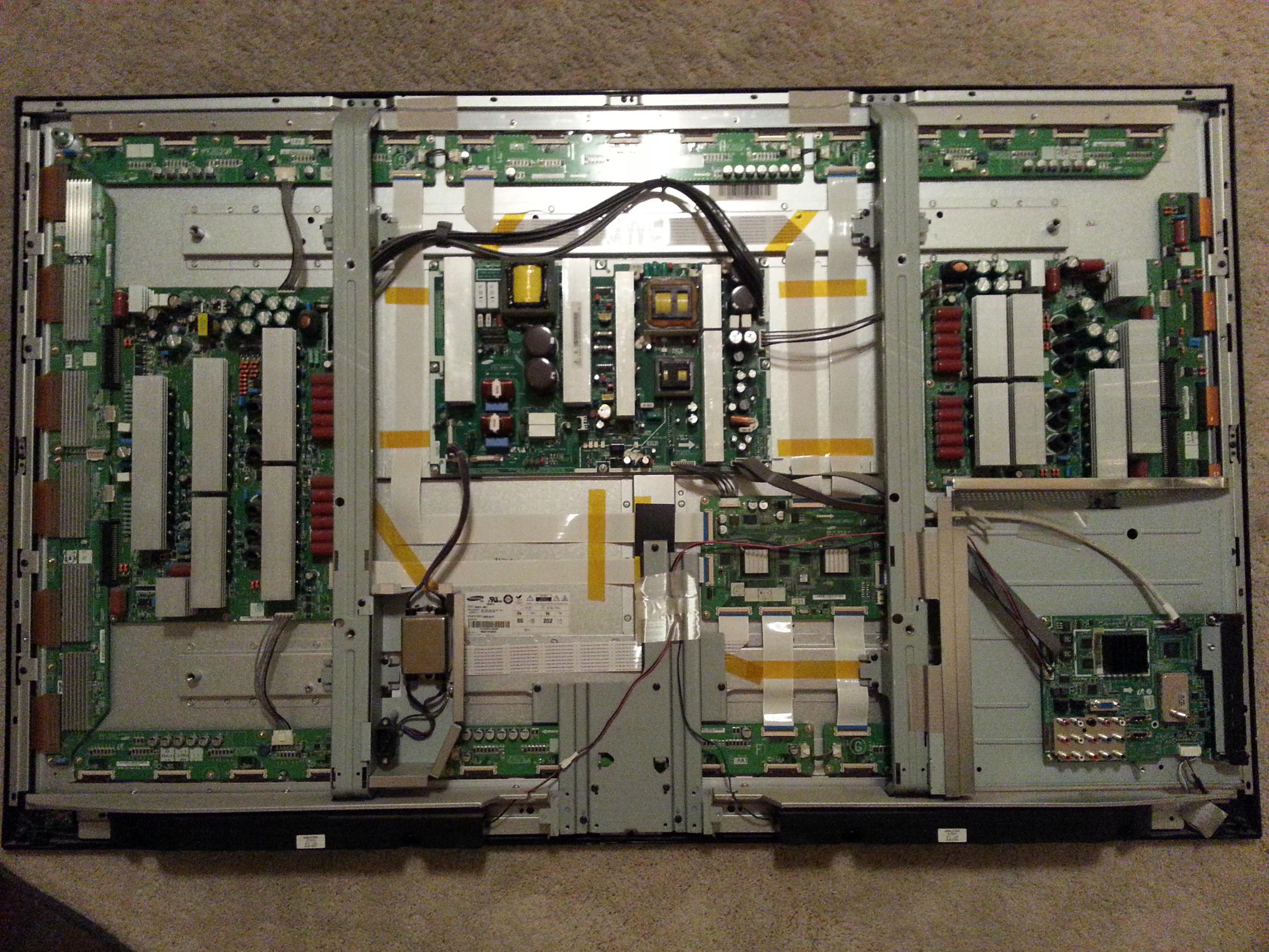

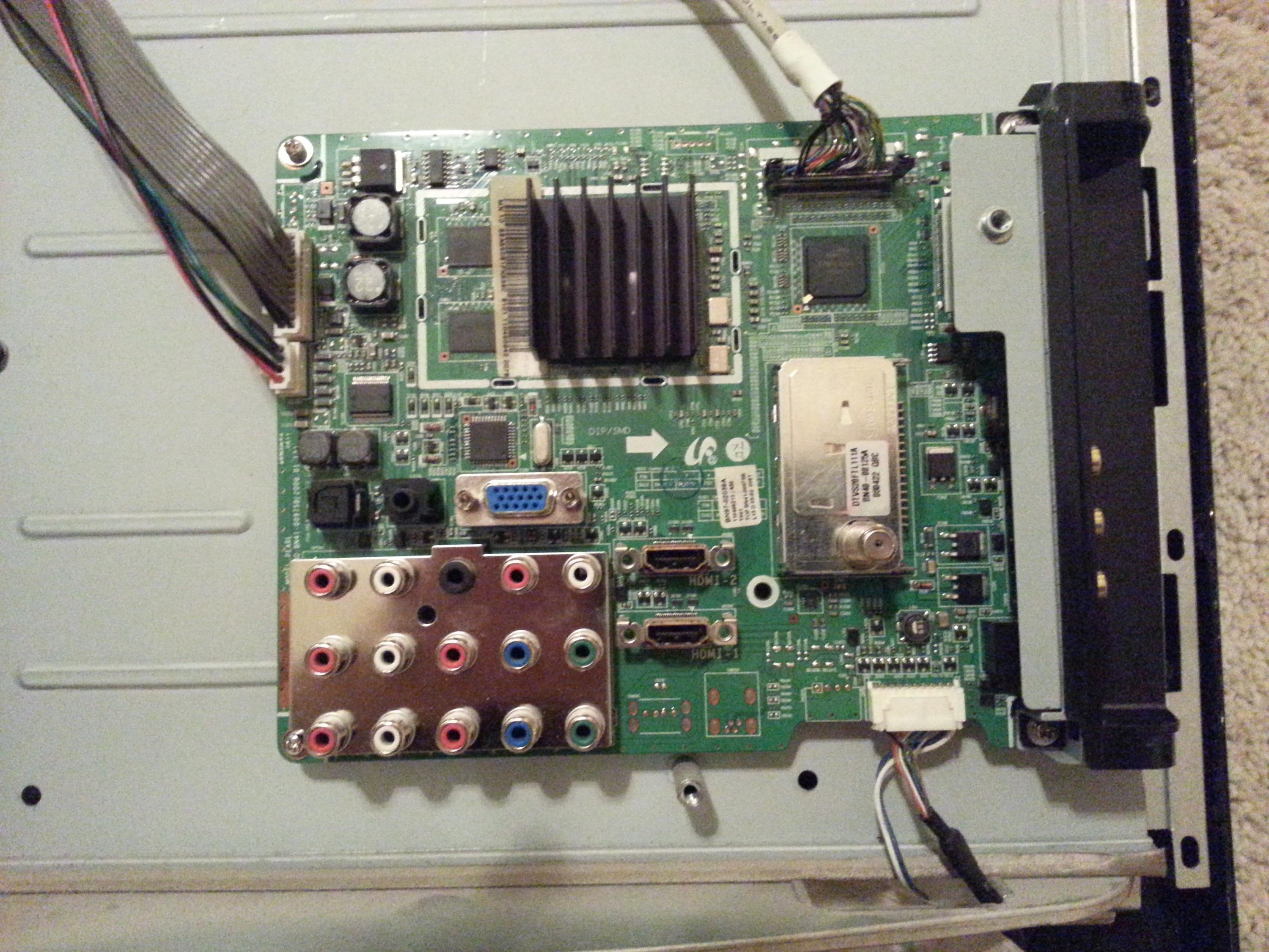

                            The board in question is the main board which is the one on the lower right with all the inputs like HDMI, component video etc. The capacitor is on the reverse side (next to R107) so you have to unscrew ( and unlpug some connectors, and wiggle out) the board to see it. My part just came in and I'll be doing it this week. Good luck!

                              I had purchased a mainboard repair kit from shopjimmy.com, which included a replacement for C102. However, the components did not come with a placement description (front/back of the board, etc.). I had searched high and low on my own board and finally guessed its location by process of elimination, but still wasn't sure. Like others, my board also did not have C102 identified. Kevinm34232's pictures were truly instrumental! Thanks also to rwcroson, who first confirmed that this was in fact the unlabeled cap and attached the pics for everyone.
                              Thanks also to tom66 and everyone else here who has provided their feedback; it's nice to know which Samsung model numbers this applies to. Perhaps it would be a good idea to put a "master" list together of model numbers for which this replacement has been a confirmed fix.
                              So, now it's my turn to provide my feedback. My Samsung TV's model number is LN40A530P1FXZA, which is not a plasma, but an LCD model. My mainboard number is BN94-01723C. I have not yet replaced the cap, so I can't confirm that this is the fix for my TV. However, all the symptoms are the same, and I don't doubt that the TV will work properly again after replacing this cap.
                              This brings me to my reason for not having replaced the cap yet. As sargeslaughter and others have asked, I too have questions about the replacement process. In particular, I am interested in the removal of this component, as simply trying to apply heat from a soldering iron on both sides of the cap has not gotten me very far and I've been afraid of leaving the iron in a spot for a prolonged amount of time due to possible component damage. I do not own a hot air iron or rework station, and I am asking the question if it is either required or highly recommended for this type of replacement (of a SMT component). Hopefully, the answer to this will help other people prepare for the replacement process as well. Regardless, I'm leaning toward purchasing one at this point and any product recommendations would be welcome.

                                    First off, thank you 'sargeslaughter' for the images!
                                    I just got done soldering the part on (C102). It was my first time ever soldering anything in my life. The hardest part was getting the defective piece off of the board. It took awhile for me to figure out how to get it off. All I did was I went back and forth between each side of the defective piece with my soldering iron while slightly pulling on the piece with tweezers and it eventually came off. I was careful not to touch any other part of the board with the hot soldering iron while I did this. After that I used the tweezers to place the new piece onto the board while heating up the solder. I did one side at a time.
                                    After this I put the board back on the tv and plugged everything back in. I turned it on and it worked on the first try! HAHA I was kind of skeptical about this working as I have never done anything like this before, but it flippin worked. I'd like to thank everyone again on this thread for all of the great information. I hope everyone elses project works out.
                                    Sidenote: When I went on Digikey to order the part, it said there it is on backorder for like a month. Someone else recommended an alternative, which is what I ordered and it works fine. The part number is: 399-10532-1-ND and it can be found here:
                                    http://www.digikey.com/product-searc...399-10532-1-ND

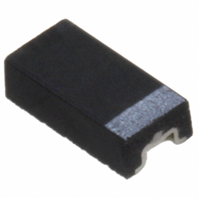

                                      I replaced mine tonight with the yellow Kemet one and have a success http://www.digikey.com/product-detai...1-1-ND/1129710 . As hockey_!01 mentioned, it is slightly difficult to get the cap off but definitely used tweezers to gently pull up on it but not so much to risk pad damage. Also afraid of hitting R107 as it is super close to the side of the cap. I filed my soldering tip so that it was more flat / thinner to get in there. I soldered the side next to R107 first.
                                      Just saved the $2400 I was going to spend on a 70" 4K tv. Hats off to kevinm34232 and all you guys for the tips and advice.

                                          Just replaced mine used the Panasonic poly very easy and works great. Thanks for all your help saved buying a new TV
