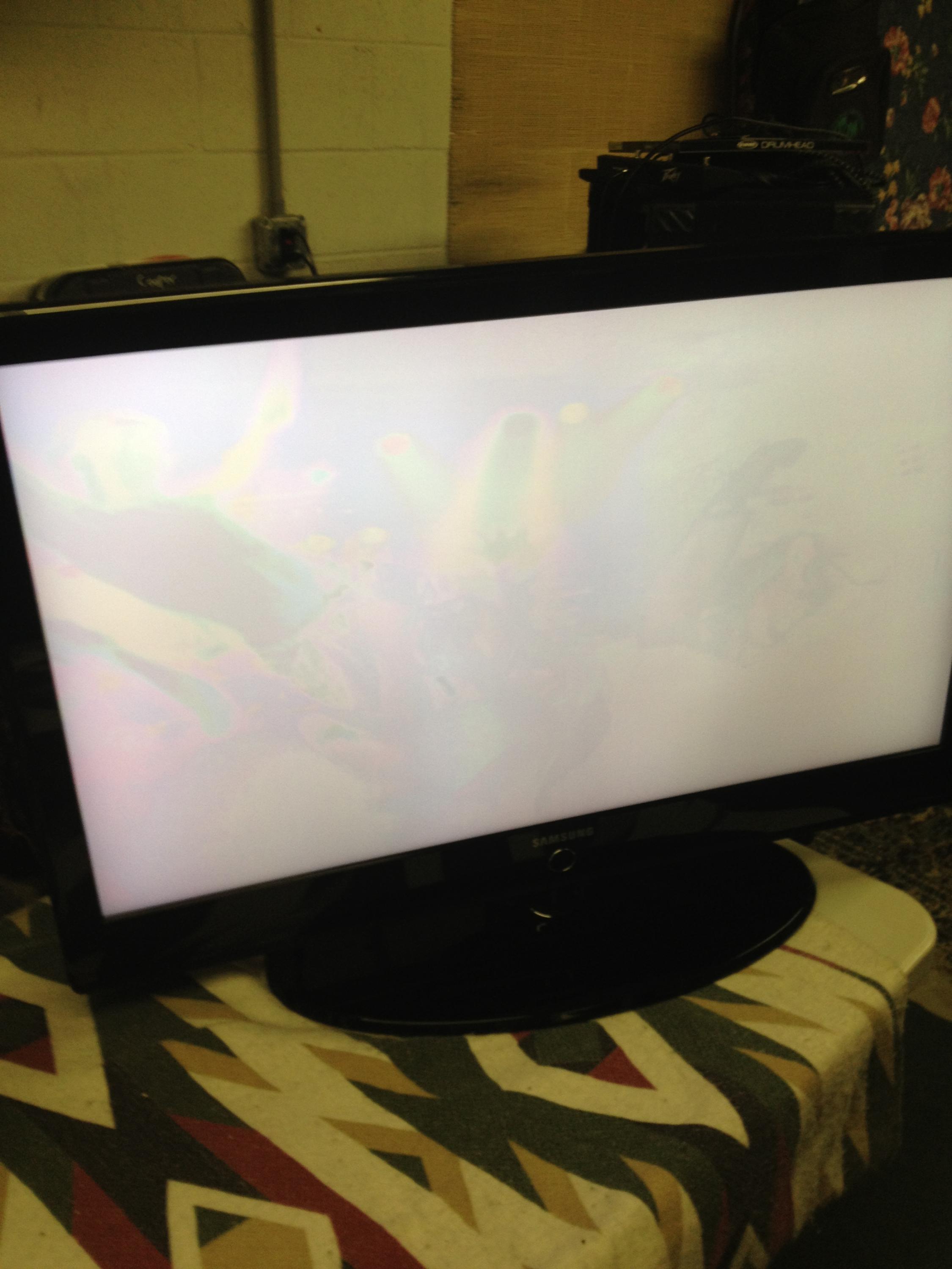

    Hi. I have a Samsung LCD tv that has a very bright picture. I've tried the picture reset in the menu, did'nt help. It powers on normally. Has good sound. I've taken the back off, and inspected it. I did not find any burnt parts or bulging caps. Any advised will be greatly appreciated. Thanks.

    Well, without any testing my first guess would be the tcon board. Let some other people with a bit more experience chime in but if that's the problem it should be a cheap fix.
      Re: Samsung LCD TV has Very Bright Picture - LN40A500T1FXZA
      I would say t-con gamma IC.
        I second that it has Gamma IC problem.

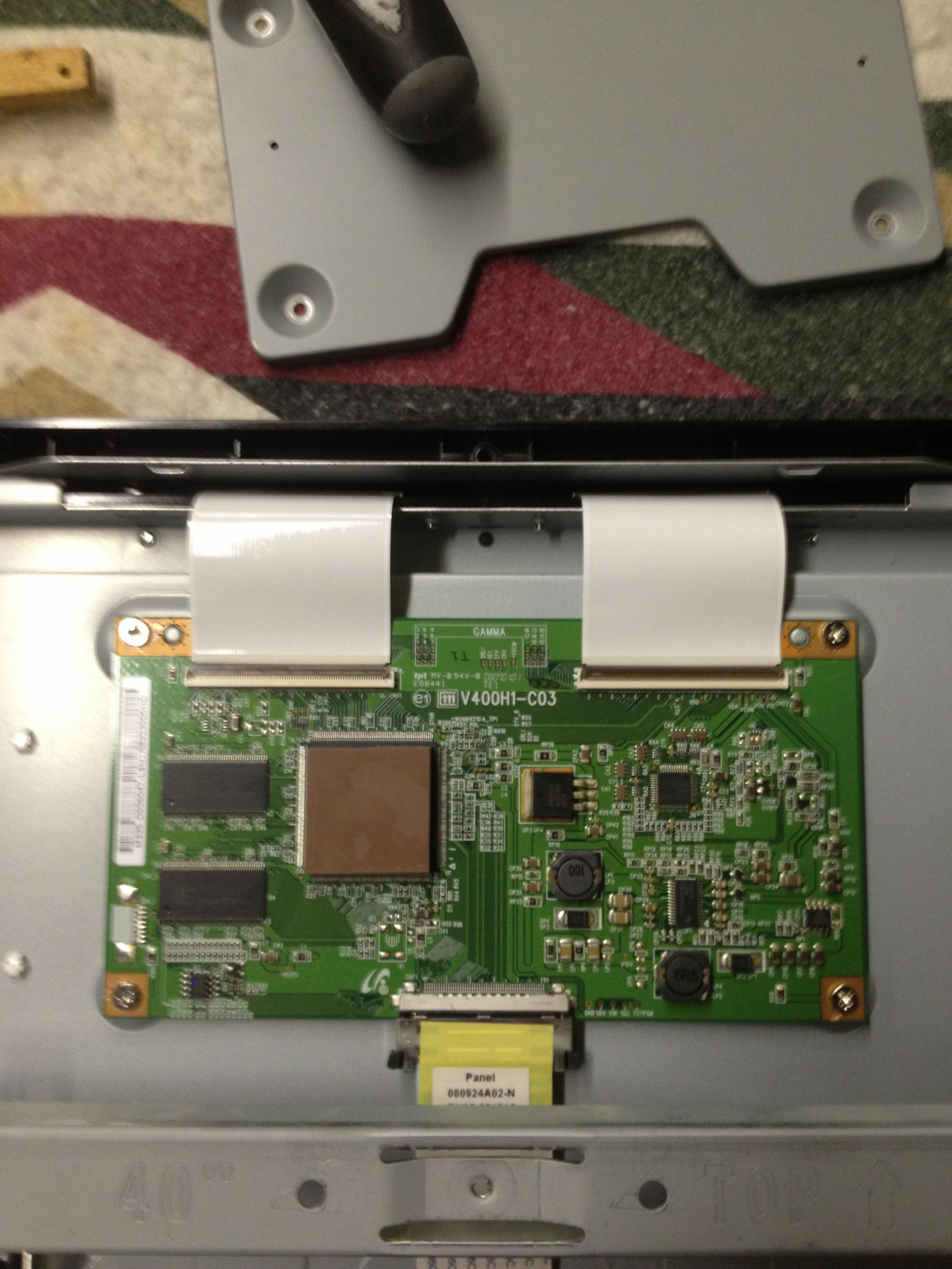

              I would suggest testing the gamma voltages first, to see if the T-con you have is defective ("brand new"? or "used from scrapped TV"?). If it is not, then it is probably panel. A small chance the main is bad.
              If you need help testing the gamma voltages, post a close shot of the T-con.

                Here is a pic of the T-con board. The board I purchased, was brand new. And yes, I would like to test the gamma voltages. Thanks.
                  Between the two white ribbon cables is a box marked GAMMA. This is your test area. On each gold pad marked with a number measure the voltage there. Red probe on test point black on chassis. DC20V range. You're expecting a monotonic (same direction) increase or decrease from 1-17, in the range of 0-15V.

                      Hi, tom66. Here are the gamma voltage readings:
                      1. 15.7v
                      2. 14.9v
                      3. 12.4v
                      4. 11.5v
                      5. 11.6v
                      6. 12.9v
                      7. 13.1v
                      8. 9.6v
                      9. 8.1v
                      10. 7.5v
                      11. 11.2v
                      12. 7.1v
                      13. 8.8v
                      14. 8.7v
                      15. 8.8v
                      16. 3.7v
                      17. 2.6v
                        Definitely a defective gamma IC there; the voltages are all over the place.

                          That's what I thought when I seen the eratic voltages. This is the original T-con board. I've already returned the new board, Personally, I don't think the new board was "NEW", it had several scratches on the back of it. Should I get a different board? And Thanks for your time.
                            I would try that. New boards usually mean used on eBay, everyone lies it appears....
                            • TubeJunkie
                              • Oct 2012
                              • 107
                              To tom66: Bought a used board from a working TV with a broken panel, and it worked perfectly. So yes, those so called "NEW" boards on Ebay are used and untested. Thank You so much for your help.
