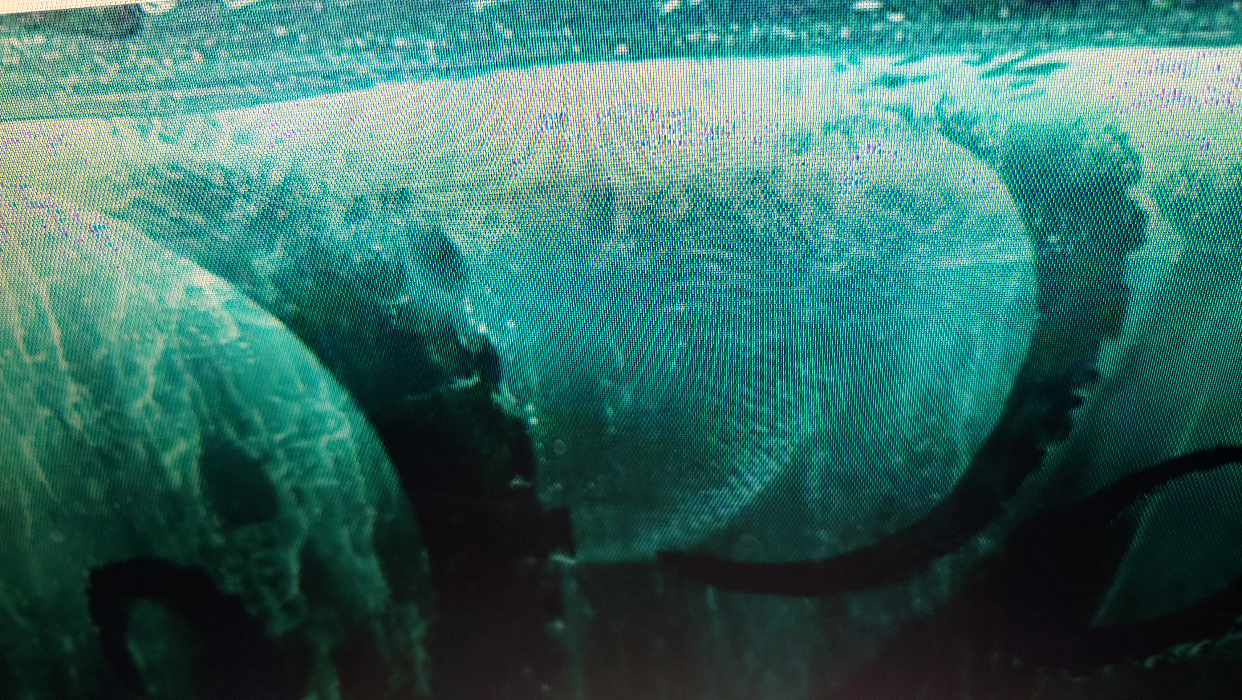

Philips 243v5lhsb00 Monitor Picture too bright
  • Schwoin
    • Mar 2023
    • 3
    • Deutschland
    Philips 243v5lhsb00 Monitor Picture too bright
    Hey everyone,
    the picture on my philips monitor looks way too bright so that black appears grey and colors also seem too bright.
    While i tried to tilt the screen a little bit while it was displaying a picture, i´ve noticed, that there appeared some purple pixels. In the following picture
    you can see them on the top half of the photo.
    At a certain point during the tilting, the picture looked normal again but as soon as i laid it back down, the purple pixels were gone and the picture was bright again.
    Ofc i tried different inputs and different devices to test the monitor. This problem appeared with all combinations (HDMI, VGA, DVI) on different pcs.
    The OSD also appears way too bright.
    I have measured the voltages coming from the power supplay board and they all were stable as they should be.
    So i thought maybe it´s an issue with the t-con board so i measured all the testpoints there.
    Here are the results in volts:
    VDD 5.15
    VGH 27
    voff -5.5
    avdd 12.5
    vcom 3.7
    dvdg 3.3
    lv+5-0 1.25
    lv 1-5 1.29
    lvck 1.28
    xcon 3.3
    0vdd 3.3
    acing 3.3
    dvddc 3.3
    cpv 1.5
    de1 1
    stv 0.02
    oe2 2
    load 0.2
    mpol 1.6
    V1 12
    V2 11.4
    V3 9.5
    V4 8.9
    V5 8.6
    V6 7.6
    V7 6.8
    V8 6.2
    V9 5.2
    V10 4.1
    V11 3.7
    V12 3.1
    V13 0.95
    V14 0.3
    ud 3.3
    csc 0
    pwr c1 0
    pwr c2 3.3
    dir 3.3
    vmidsl 3.3
    vmidl 6.5
    I´m not sure about all these but i think for the most parts they should be fine? Only pwr c1 seems a bit off to me but i don´t know, what exactly that measures because i couldn´t find anything on the internet.
    So does anyone have an idea, what pwr c1 is or what else could be wrong with the monitor?
    BIG thanks in advance!
  • nomoresonys
    • Jan 2013
    • 12306
    • U.S.
    Re: Philips 243v5lhsb00 Monitor Picture too bright
    If it's a settings issue maybe this video will help?: https://www.youtube.com/watch?v=6fCH1bxS0wg
    • Schwoin
      • Mar 2023
      • 3
      • Deutschland
      Re: Philips 243v5lhsb00 Monitor Picture too bright
      Thank you for your reply but idon´t think that it´s an hardware issue because i´ve already tested all settings and nothing changed. Also the screen appeared normal for a moment, when i tilted it, so i guess the problem is hardware related.
      • nomoresonys
        • Jan 2013
        • 12306
        • U.S.
        Re: Philips 243v5lhsb00 Monitor Picture too bright
        Strange, if it was ok at a certain angle look over the solder joints very closely, reflow any that look suspect, careful not to bridge any, examples of bad joints for any who need it: https://www.google.com/search?q=bad+...ih=607&dpr=1.5
          by momaka
          03-15-2023, 10:17 PM
        • Rauni
          Philips 58PUS7805/12 showed no picture; after T-Con replacement, shows halo
          by Rauni
          Hello, this is my first post on this forum, and my first attempted to repair a TV.
          My Philips 58PUS7805/12 stopped working recently. It is not that old, about 5 years. We were on a trip for a few days and when we came back, it had stopped working out of a blue (Perhaps our house was hit by a lightning strike? Don't know.)
          Read from a guide that I should test if the screen shows picture with one of the T-Con cables disconnected. Did that, it showed perfect picture (first on left, later on right side).
          Read also that we should test what happens if we...
          10-01-2023, 12:06 AM
        • logocar3
          Philips 288P6LJEB/27 monitor PSU outputting 8V instead of 12V
          by logocar3
          I am having problem with fixing Philips 288P6LJEB/27 monitor PSU, board number 715G6457-P01-000-0010.
          Data:
          - Schematic is attached to post
          - Photos can be found on flicker: https://www.flickr.com/photos/198547898@N03
          Problem:
          - PSU board have power outputs at 5.2V, 12V and 24V - board is correctly outputting only 5.2V (correct), and not 12V (without load only 8.16V) or 24V (without load 0V)
          State of PCB / monitor:
          - Bought defect monitor from a company auction
          - There were some attempts to fix...
          06-19-2023, 11:40 PM
        • madyoyo
          Philips 37pfl560: Yellow picture
          by madyoyo
          HI.
          I have a weird problem with an old Philips 37pfl560 TV i put out of storage: the picture have a noticeable yellow hue, and its not caused by the settings (did a factory reset). I've never seen this before. I will try to get a photo with a real camera, with my phone its hard to see because of automatic white balance, but in real live the whites are really yellow.
          Anyone have an idea of what can cause this? Can CCFL tubes get "warmer" with time? This tv have several analog inputs,so its nice for retrogaming....
          05-30-2025, 10:16 AM
        • charlesdutcher
          No picture issue in Philips Chassis FTL2.1
          by charlesdutcher
          My Plasma Philips 37inch chassis FTL2.1 does not show picture. It automatically goes into protection mode after 30 seconds (red led blinks at 3Hz)
          Is there someone having any symptom like this? How to fix it?
          Thanks in advance!​
          08-06-2024, 09:55 PM
