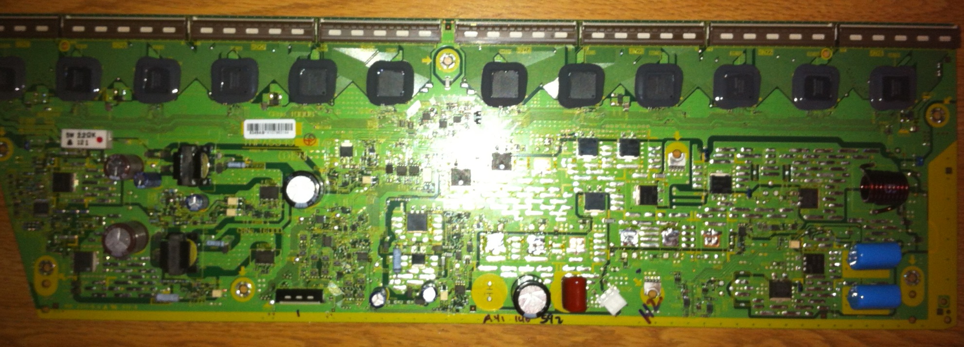

                    Hi folks, complete novice here with the same issue on Panasonic TC-P42S30 set. I am a veteran DIY'er but not very knowledgeable of electronics. However, I'm ready and courageous enough to dive in and give this a shot.
                    Thanks to tw2005, Tom, and other users on this forum, as well as austech forum and the great training manual that Tom uploaded, I have narrowed down my issue to the SN board.
                    I would like to continue troubleshooting the board, but I am unable to do so without a bit of help. I hope that some of you might step to my aid...
                    I believe I have identified 4 bad IGBT's and have lifted their legs, but would like to verify that and continue to test other components on the board if possible. I don't know if I am testing the resistance at SN2 pins properly. With Com lead on pin 1 I get 31k Ohms, but with leads reversed i get a short. Which one should I believe?
                    And, how should I proceed to test other components on the board? I am trying to test mosfets but am getting varied readings and can't figure out which ones, if any, are bad.
                    Could it be that the four I found are the only bad parts... (the gates don't close when i try to short drain-gate, so I'm guessing this means they are bad.)
                    Would love to continue this project, so if anybody could offer a good place to start I'd be very grateful.

                      Would anyone care to walk me through the troubleshooting of the SN board?
                      I have removed q401, q402, q421, and q422 from the board. Bit of a pain with a 25 watt iron...
                      I am still getting a short at SN2 from pin 1 to pin 3 (though I'm not sure i'm doing this right - assume com goes to ground as always i.e.- red to pin 1 and com to pin 3)
                      However, I am testing other components which are included in the #$# repair kits on ebay and can't be sure if 1) the results are correct, since they are all in circuit and 2) what kind of results i'm looking for and 3) If I remove all failed components without replacing them would the short at SN2 miraculously disappear?

                          Thanks, Glitcher... Is it possible to test the mosfets that remain without lifting a leg? I did just lift a leg on one common culprit and it's reading 0 ohms now, whereas is was 46K ohms before lifting the leg so perhaps i'm doing something wrong?

                            Perhaps only 3 of these igbt were bad - 3 read resistance of 9-12 Ohms, while the fourth reads 0.2 Ohms. nevertheless, still getting a short at SN2
                            • Hok
                              • Apr 2014
                              • 70
                              Re: Panisonic 42inch TCP42S30 not working!!
                              ok just found 4 more - apparently shorted fets, lifted the legs and they won't pass voltage (tried the open gate then test for falling voltage) neither do they have any resistance, so i've either destroyed them or they're destroyed already.... these are Q451, Q441, D621, D622... Still have a short, but only in one direction (red to pin 1 and com to pin 2) other direction reads great
                                some of the fets are actually in parallel so if one is shorted, both will appear shorted, so youll have to lift the leg to actually figure out which is bad.
                                Also keep in mind, that not all of them are fets, but some are also diodes which will measure shorted from pins 1 and 3 (this is normal).
                                What are the part numbers for the ones you found? and can you post a photo of the entire board?

                                  will attempt to post a photo of the board, (TNPA5349)
                                  those with no reading at all are the 2 DG302's (Q451,Q441) and 2 of the 30F131's (Q621, Q622)
                                  Have already removed 401,402,421,422 and already I doubt whether or not I should have. Very confused so your advice is welcomed.

                                    easiest way to do a quick check is set the meter to diode or continuity check and probe between the legs. generally they'll go shorted across all 3. metal tab is what would be the center leg if these were through hole components.
                                    Anything that constantly beeps is short would need to be removed or lift the legs as glitcher mentioned and confirmed bad out of cct.
                                    No reading is normal as there is a special way needed turn the transistor on to check it but if it's not short I'd move on.
                                    looking at some of the kits for sale, hard to tell if you'd get away with just the shorted IGBTs.
                                    Here's the list which gives most locations, the rest would not be too hard to work out.
                                    Q401,Q402,Q421,Q422,Q621,Q531,D401,D421,IC502,Q6??,R???,R???,R???,R???,R???

                                      Thanks, TW. You've been very helpful in the Panasonic threads i've been through here and elsewhere. You have caught on quickly to see that I'm having knowledge issues with testing the components...
                                      Just to recap what you've said so that we're sure I'm clear:
                                      1) using the diode (audible) test, which measures resistance, if I get a beep across the mosfets and igbts, then the component is likely bad and should be tested out of circuit. (To prove how much of a dummy I am, I thought it was the opposite - goes to show my lack of education in electronics would not get me far..) If this is the case, there appears to be a lot more mosFets than usual that are fried. [D642,D641,D461,D481,
                                      2) How should i test them out of circuit? I have seen 2 ways - one with mm (open gate and check waning voltage,) and one with a power supply and small load that lights up when the gate is opened.
                                      3) on the miniscule smd resistors - It appears that all 6 of those R's give a beep, even on the 2 'good' igbt's, and the 2 'good' DG302 at Q441 and Q451 - does this mean that all 8 of those are gone?

                                        diode mode measures voltage drop.
                                        Constant beep is short or low resistance. short beep and a reading is not but on low resistance it will be a continuous beep. Depends on the quality of the meter. I think with mine anything below 100ohms will beep constant.
                                        The only items I would use the buzzer on are the semiconductors, eg transistors and diodes. For the resistors go resistance and measure in cct. If they measure their value or a bit lower that would be ok. generally the resistors burn out and either go high resistance or open cct.
                                        Sometimes if you look real close there will be burning or an exit hole where they've failed.
                                        To keep this simple, set meter to diode, on the smd transistors place one probe on the tab and the other on each of the legs one at a time and observe. If the meter beeps constant and reads low like 0 or 0.01 etc, that's dead short, then would have to remove or lift legs to confirm in case another transistor is shorting the tested one.
                                        On the SMD diodes, do the same, one polarity no reading, reverse probes and if good will get short beep then reading, could be 0.3 -0.7 as a guide. leg to leg though will show short as they are both the same . tab is cathode, legs are anode. again a constant beep in both directiions would indicate bad but again lift the legs to confirm.
