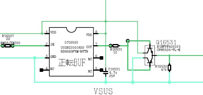

        Here's the cct around that IC502. Vdd = the 15V line .
        you can see the relationship between IC502, R531, Q531. What was the resistances on Q531, I'm curous.
        the only tests I'd do and not sure what to expect would be resistance on pins, 1,2,7 to gnd.

            Q531 resistance on both sets of pins is 25+ Mega Ohms
            TP82 to GND 17 k Ohms
            "They're stuffed" - is that Aussie for "junk"?
            ic502 pin 1 to gnd .47 mega ohms, same for pin 2... pin 7 to gnd is 28.3 mega Ohms

                  nothing looks shorted there so i would say ok.

                                      I got an idea. I think I missed something with your readings, 25Meg ohms Q531, IC502 28.3 megohms.
                                      There's probably another FET driver on the board. Since they say some need those replaced I'm thinking this could be the issue but i'd like to see if we can compare the cct to the other drive cct.
                                      It may not be a loss yet. Don't know why i did not click, 25Meg is very high probably as good as open cct.
                                      Go to the same IC and transistor set at IC501, Q501 and perform the same resistance checks as done in posts 63 & 65
                                      There's 5 of those IC on the SS and 5 on the SN.

                                          working on it now. There's a slight frame of reference issue.... If pin 1 is on the upper left side.... The only identifying mark on the ic is a small dot, which is either on the upper left side or the lower right side... Didn't even occur to me that I may be testing the wrong pins on the IC502... How can I adjust my frame of reference for the pin numbers?
                                          Actually: IC502 has no numbers imprinted on the surface, just the small dot. However, IC501 and IC684 each have the following numbers imprinted on it... (the O is the dot)
                                          D 6
                                          9 3
                                          ONS
                                          (The pins run horizontally to the numbers, across the top and the bottom)
