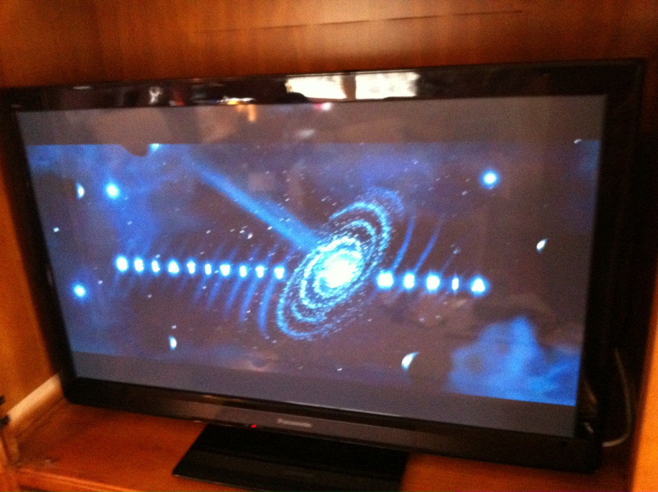

    Ok, the lines will be due to poorly seated ribbons from the panel to the SN.
    Where you have lines they will line up with the offending connector. release the lever and grab the ribbon both ends and gently insert, you will feel it wedge and then it goes in a little more. There are usually nothches on the sides to help indicate they are in straight.
    Compare the ribbons that have no lines to the bad ones to help give you a guide. be patient with it and do this powered off, reseat and secure and power up agin to recheck.
    Then when it's all good upload a picture of this wonderful TV working, it makes me feel good

          Yes , read my preceding post, power TV off, then re adjust, looks like only the 2 connectors that line up with the lines don't touch anything else because the rest looks perfect.
          Nearly there buddy.
            Re: Panisonic 42inch TCP42S30 not working!!
            Here it is.... When I get to Australia I'll have to stop by and buy you a beer or two... Many many thanks, and I hope others will be able to follow this thread.
            Word of advice to other novices: label all the screws when you take off the back of the set... tape them to a piece of paper and write the label name next to them.... I used packing tape, and just pushed the screws through the paper when I was ready for them. Made putting it back together after these two weeks VERY easy.
            What an unbelievable journey... I would have never had the courage to attempt this without badcaps.net

                Intermittent and induced faults are always challenging especially the introduced ones without realising it.
                looking back at it we can have a laugh lookiing for broken part that did not exist, just an air gap.
