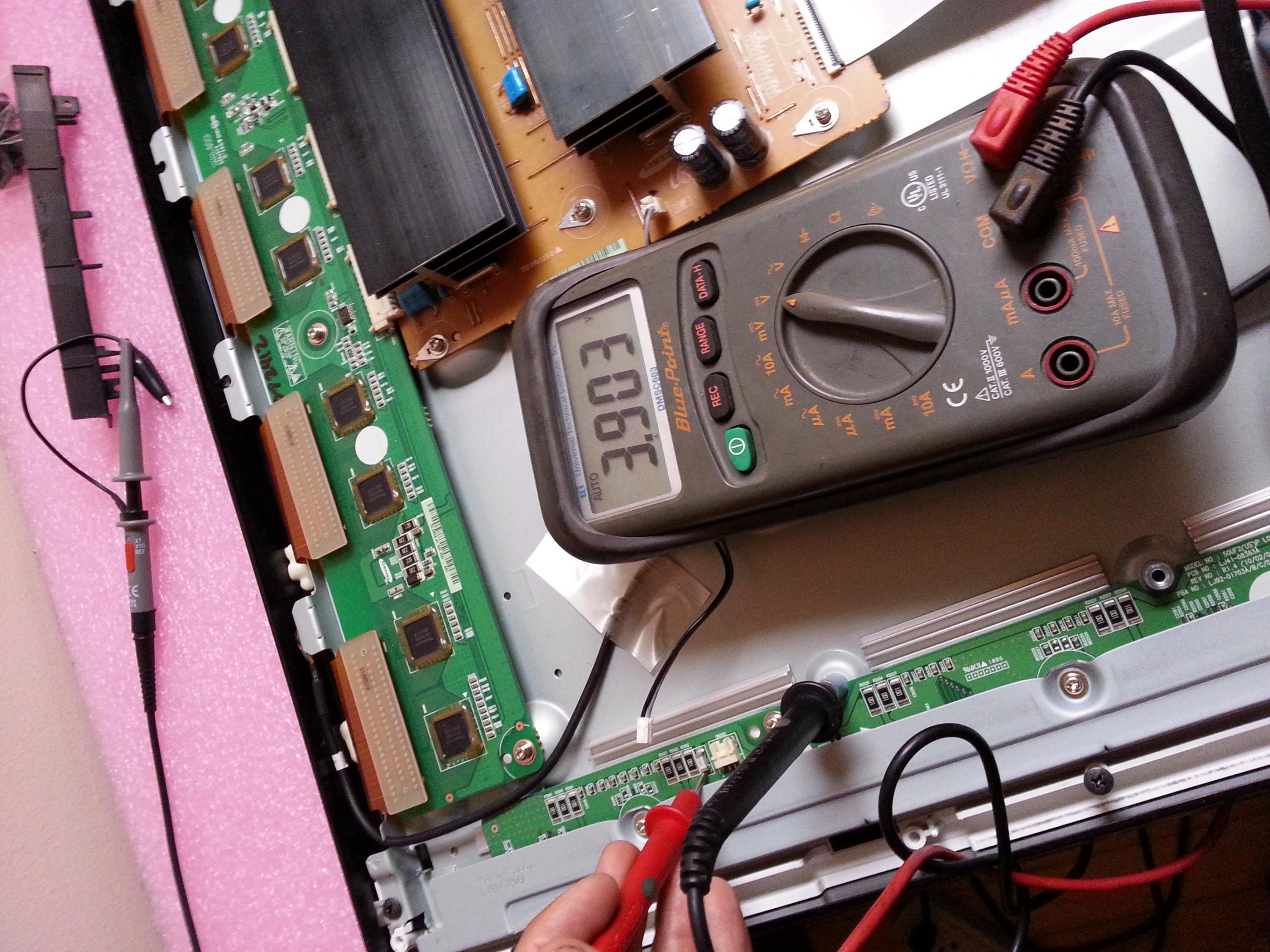

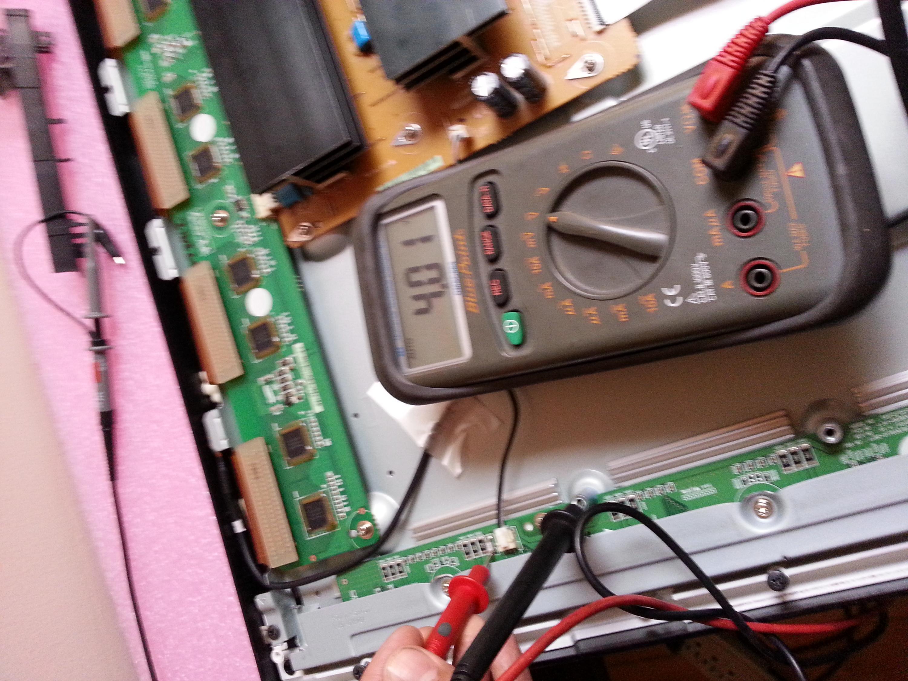

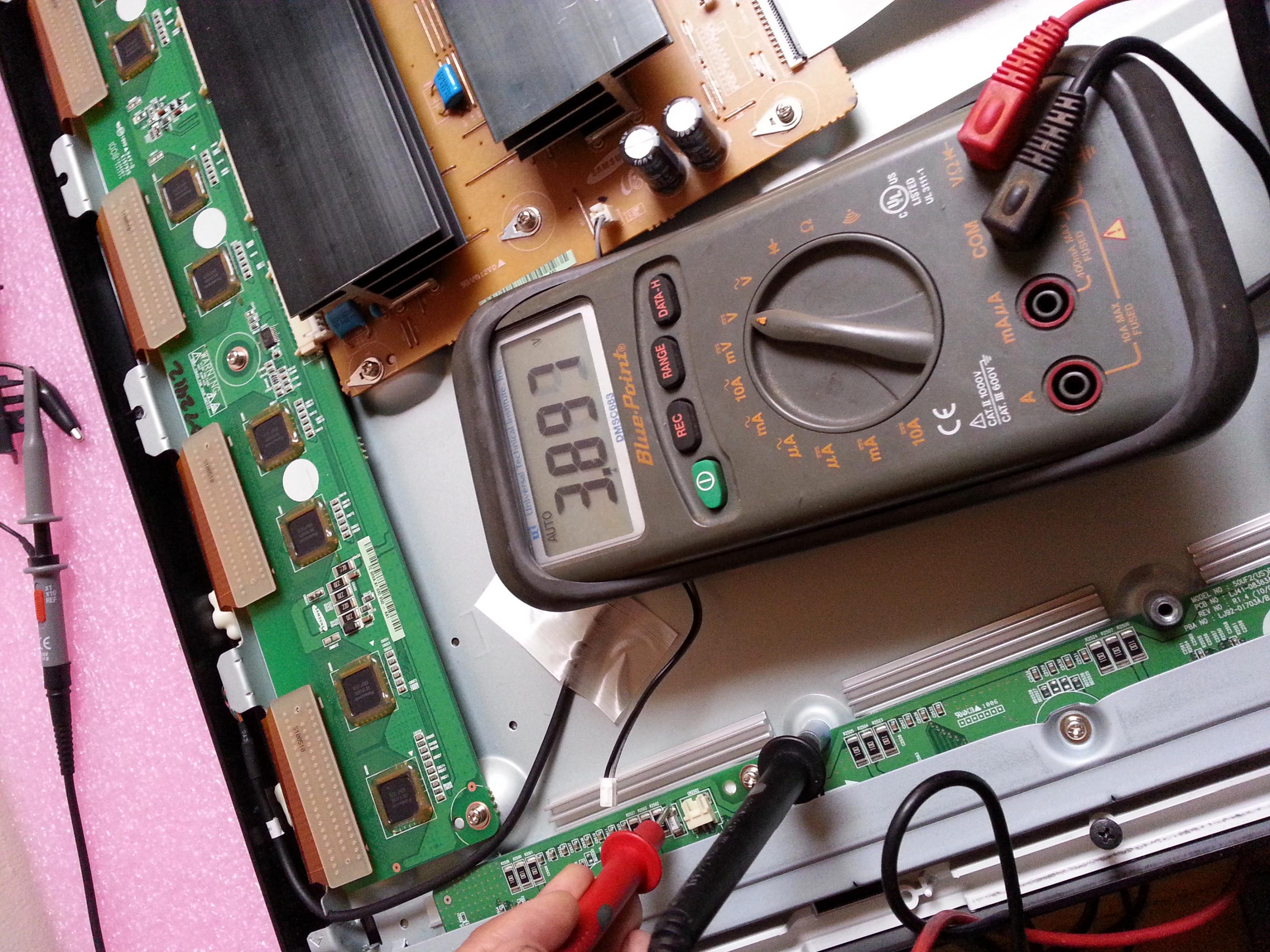

              Tom here is what I did
              First 2 pics
              Power on
              Positive probe on one end of fuse negative probe on chasis ground
              Fuse Reading: 4v
              Fuse reading: 3.92v

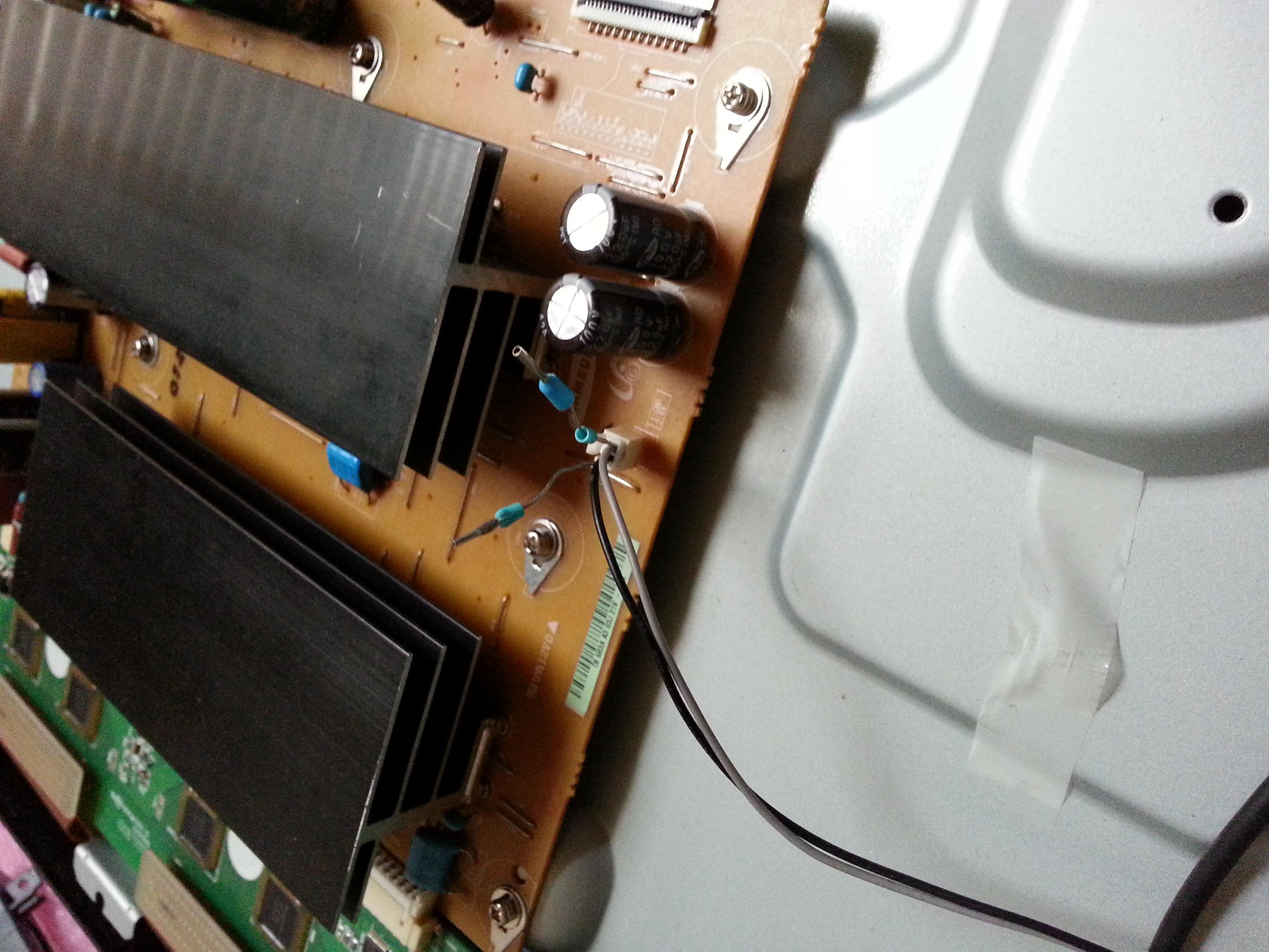

                #67
                Re: no picture on my samsung 50 inch plasma
                Here are pics with board disconnected
                Not sure if I tested it correctly on this one
                • jose6326
                  • May 2013
                  • 707

                    #69
                    You tested correctly, on the first one. But can you please check the connector on the Y-main side too?
