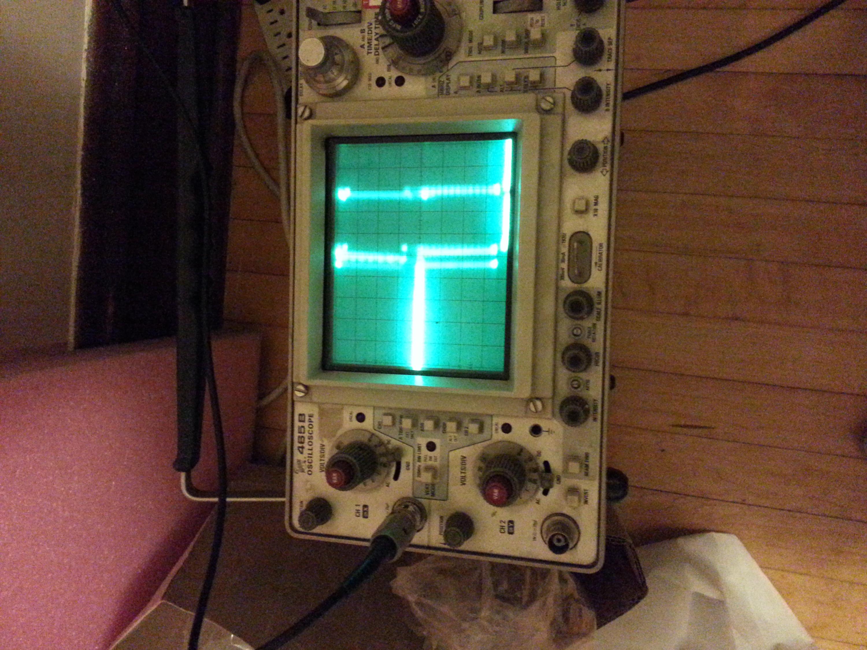

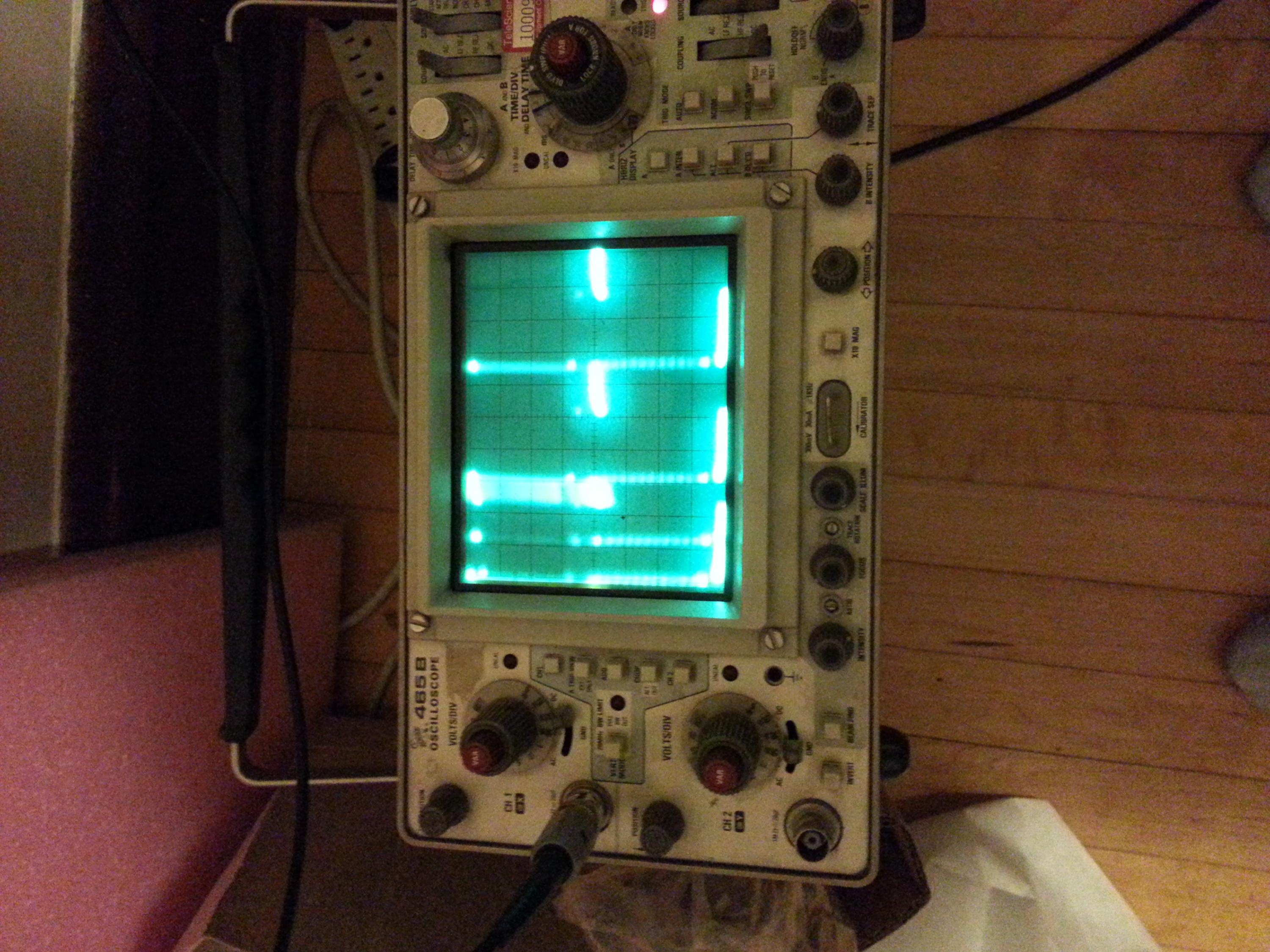

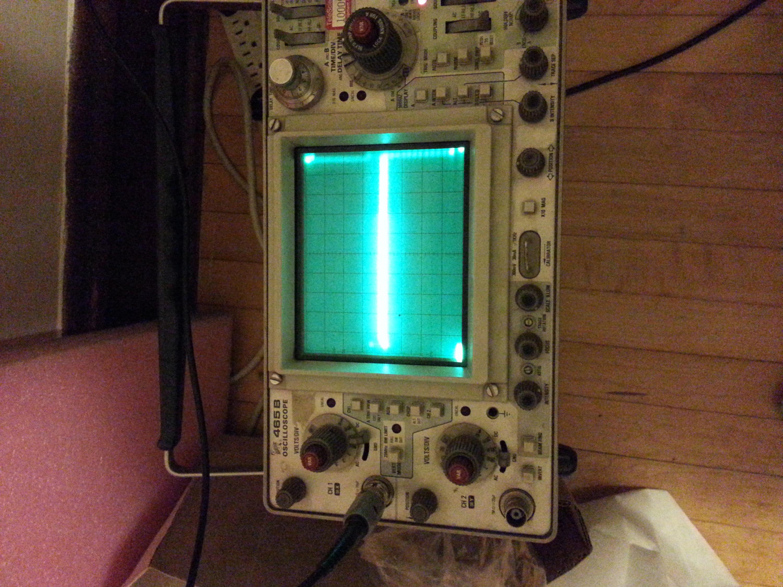

    I still have the scope
    I can retest and take pics if you want
      #82
      Re: no picture on my samsung 50 inch plasma
      Can you repeat the Y-main test? Except this time also turn the intensity/brightness thing down, as that will make the image sharper.

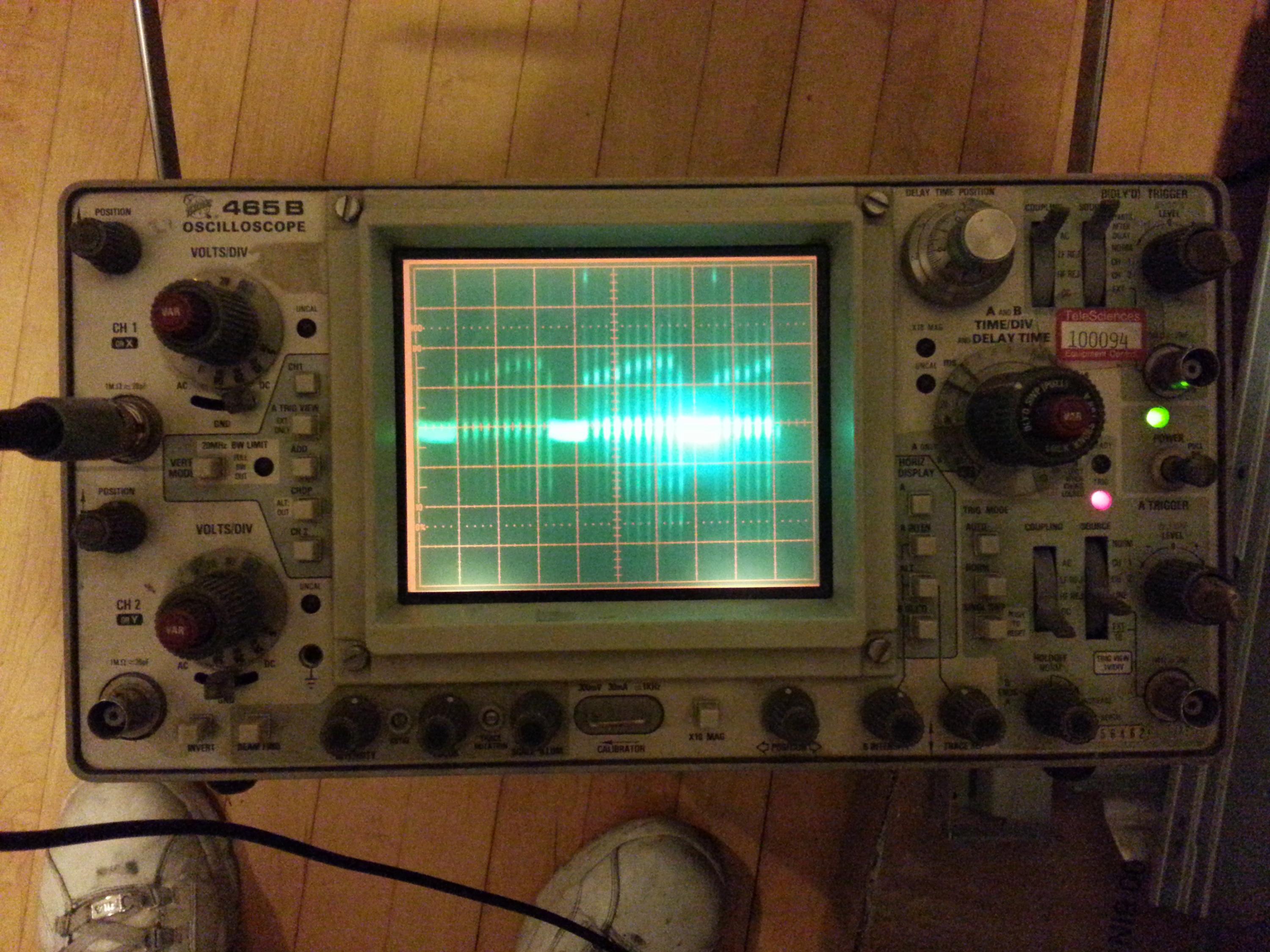

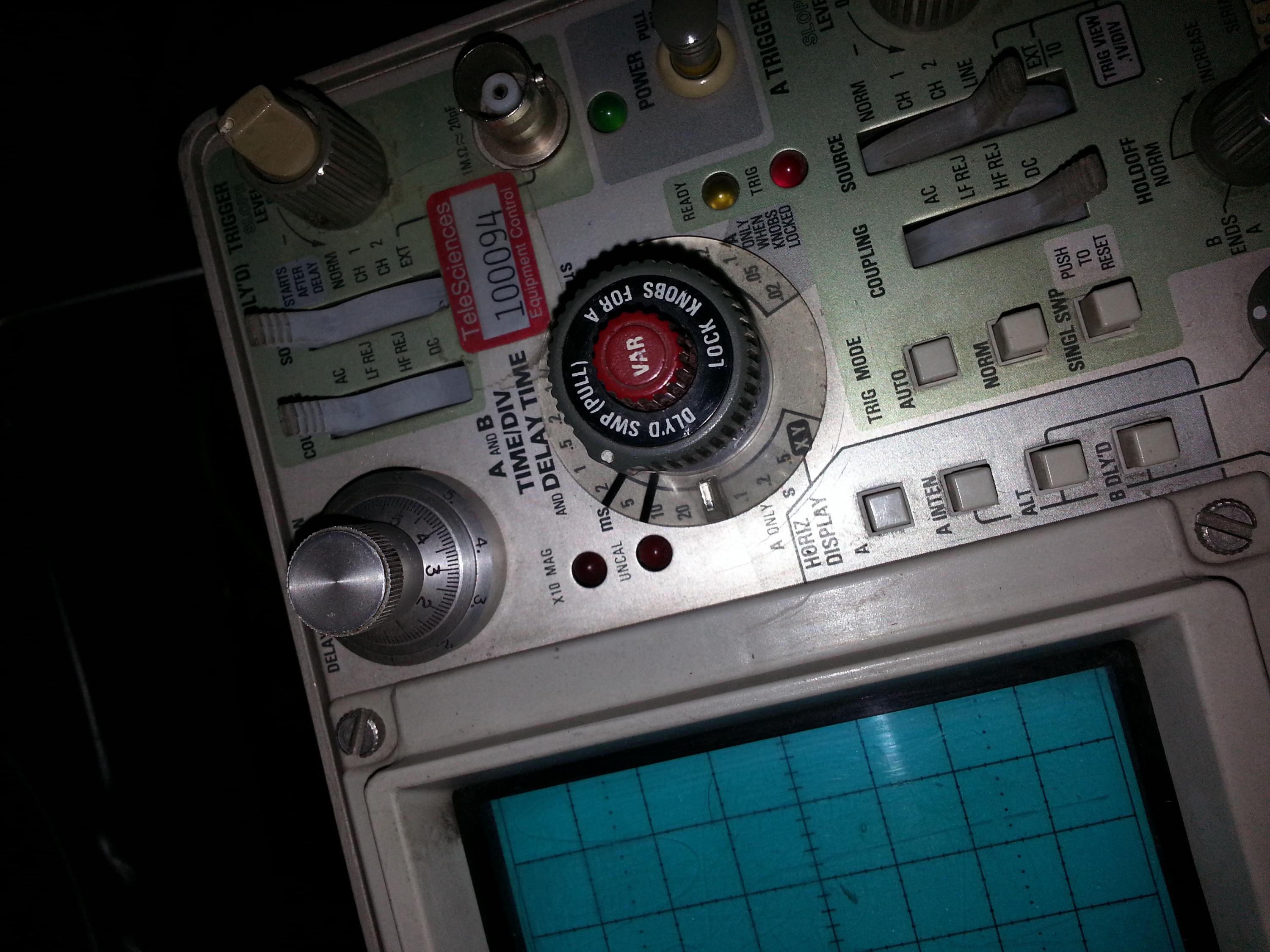

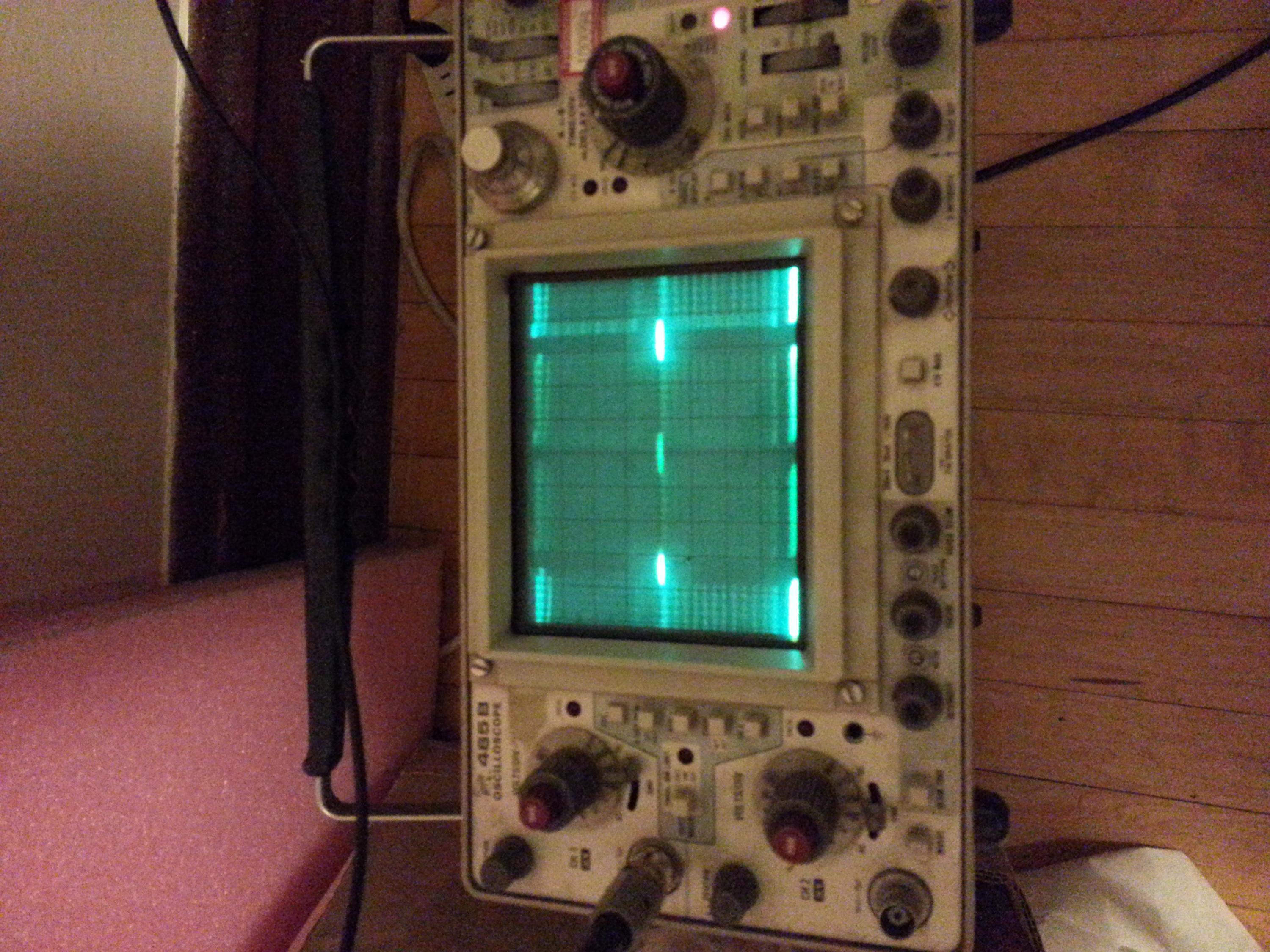

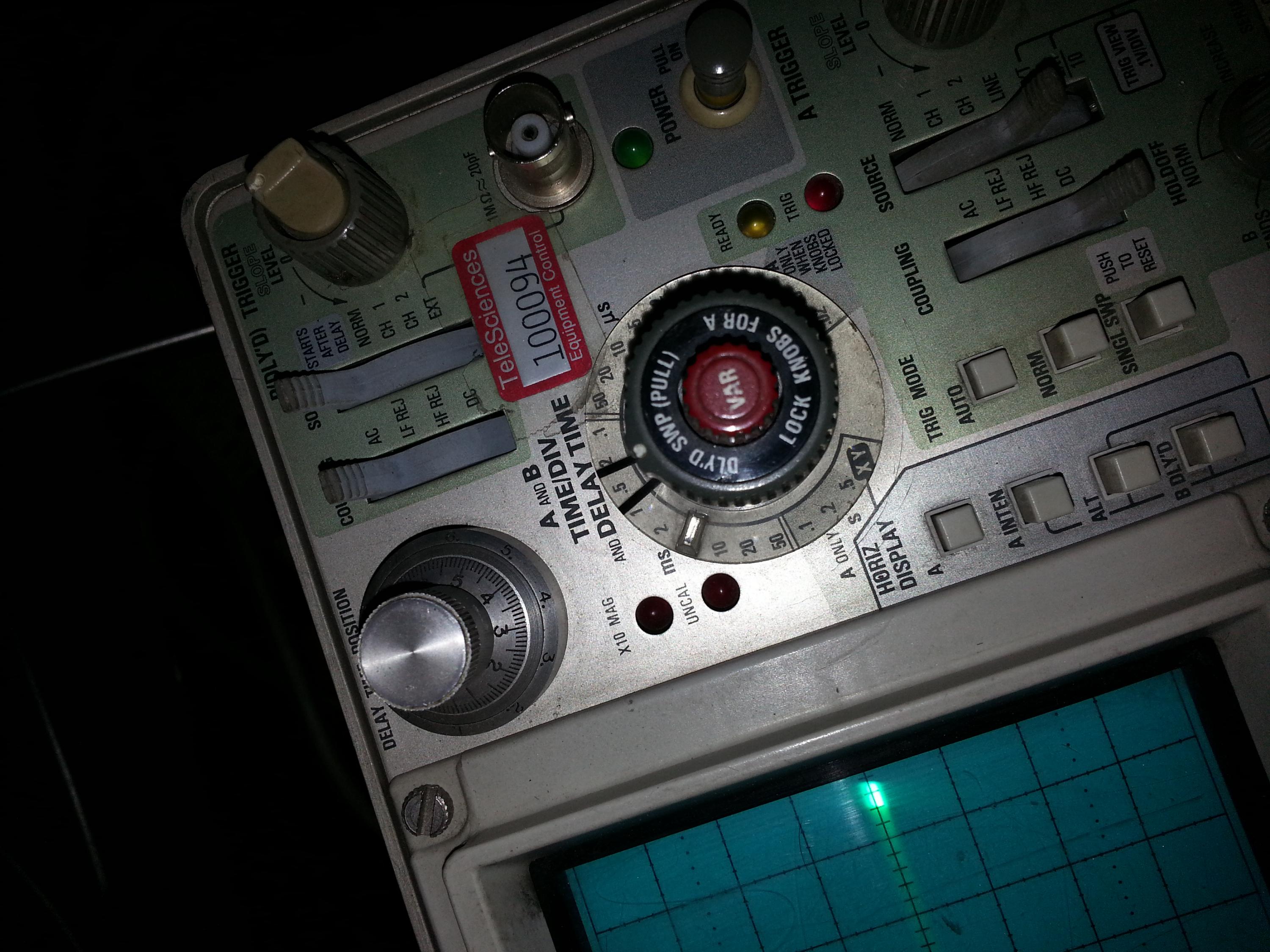

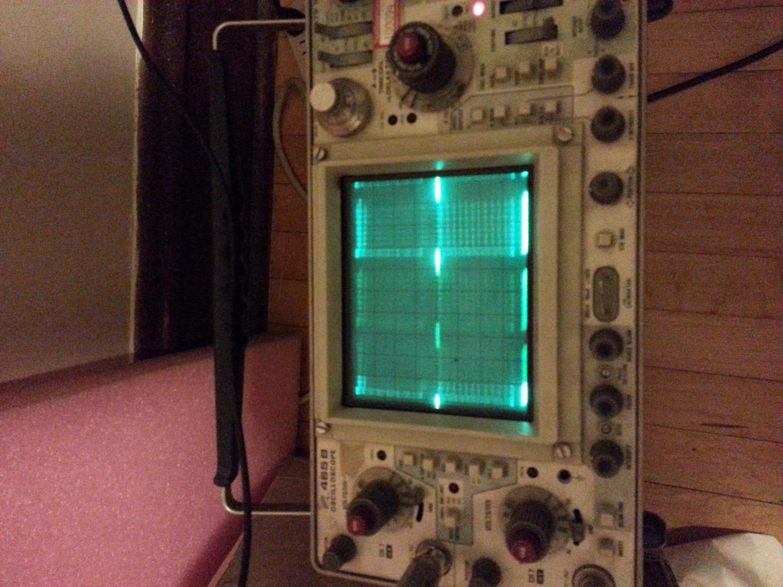

        #83
        Tom please look at pics
        Im not sure if I set the time/div in the correct position
        The dial has a tab and 2 black hash marks
        Is the 5ms supposed to be in between the hash marks or is the tab supposed to be over the 5ms?
        • jose6326
          • May 2013
          • 707
          #84
          I went ahead and tested it with the 5ms in between the hash marks
          Please see pics

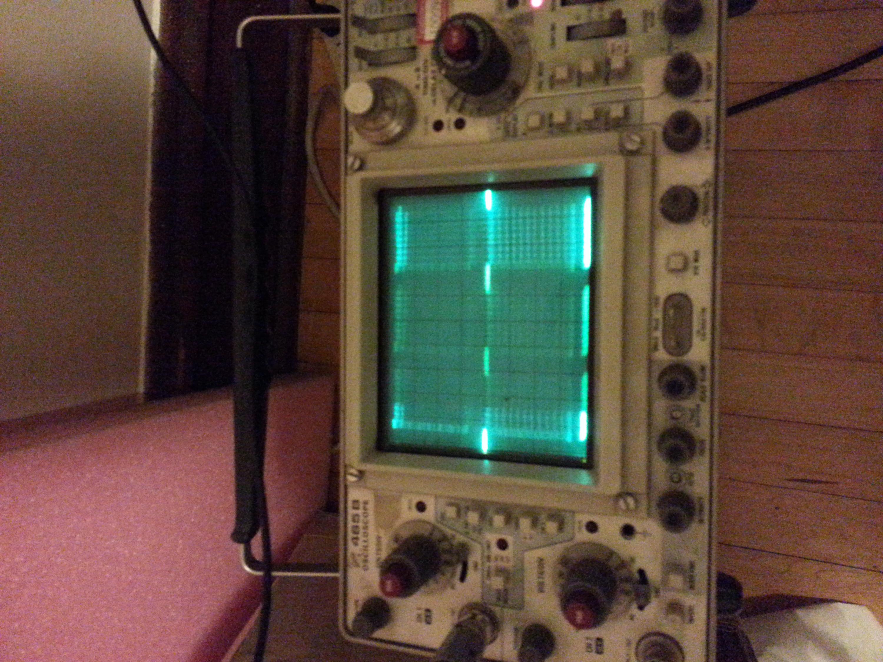

          • jose6326
            • May 2013
            • 707

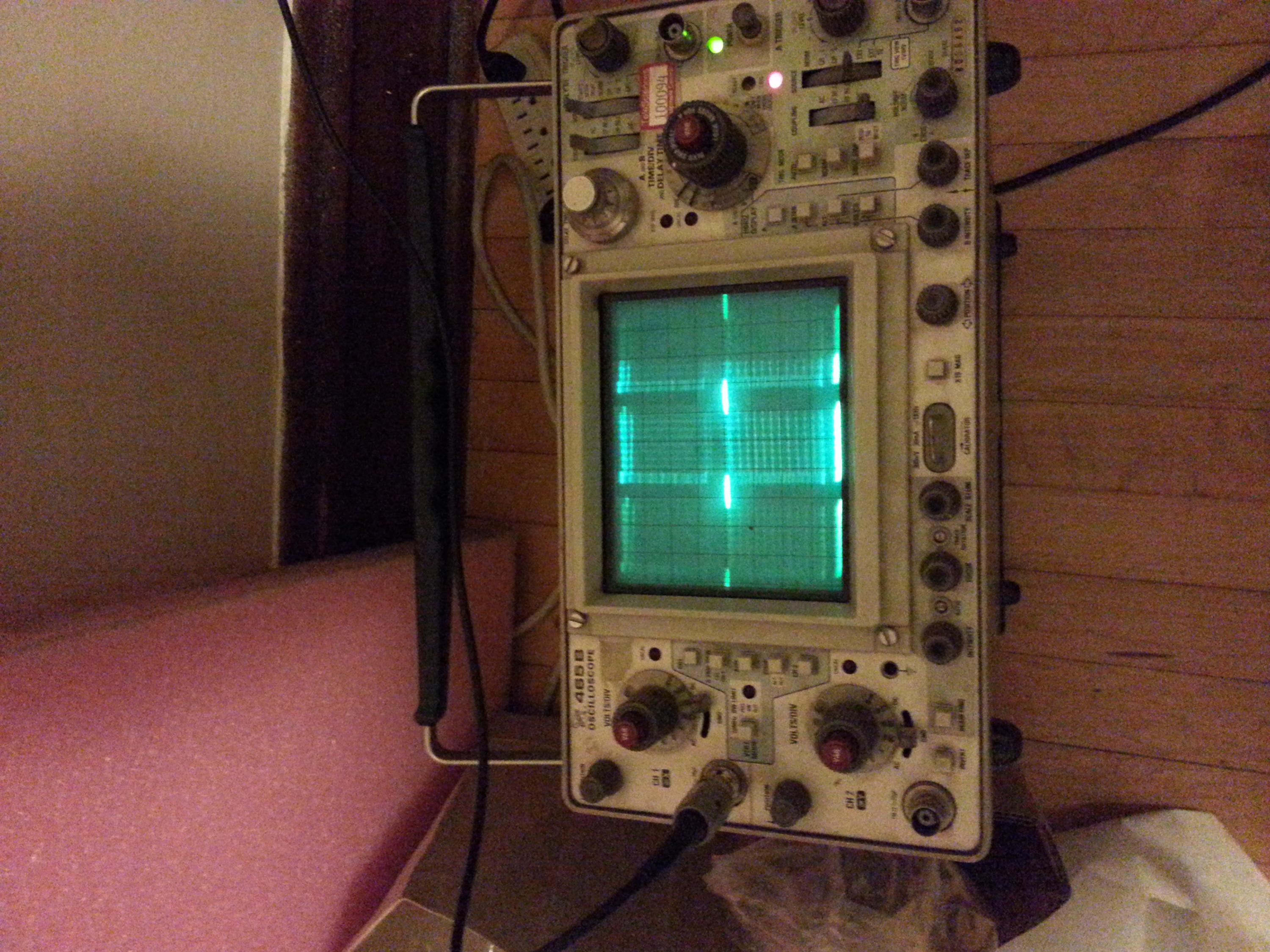

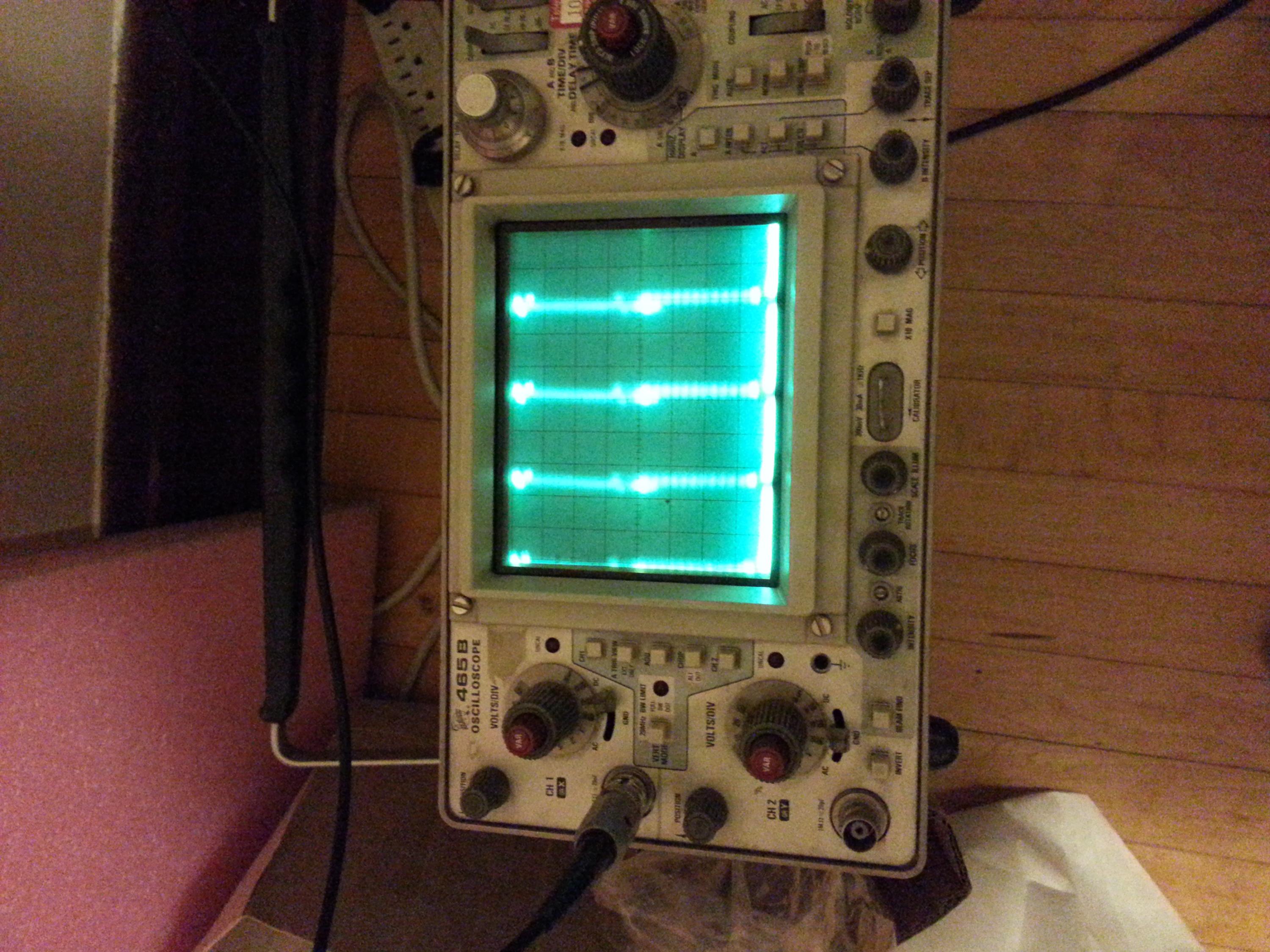

            #85
            Here is the test with the tab over the 5ms
              #86
              The waveform looks OK except it looks to be like the SUSTAIN portion is missing! I am not sure why... A missing SUSTAIN portion will cause no image. Can you go over to testing the X-main?

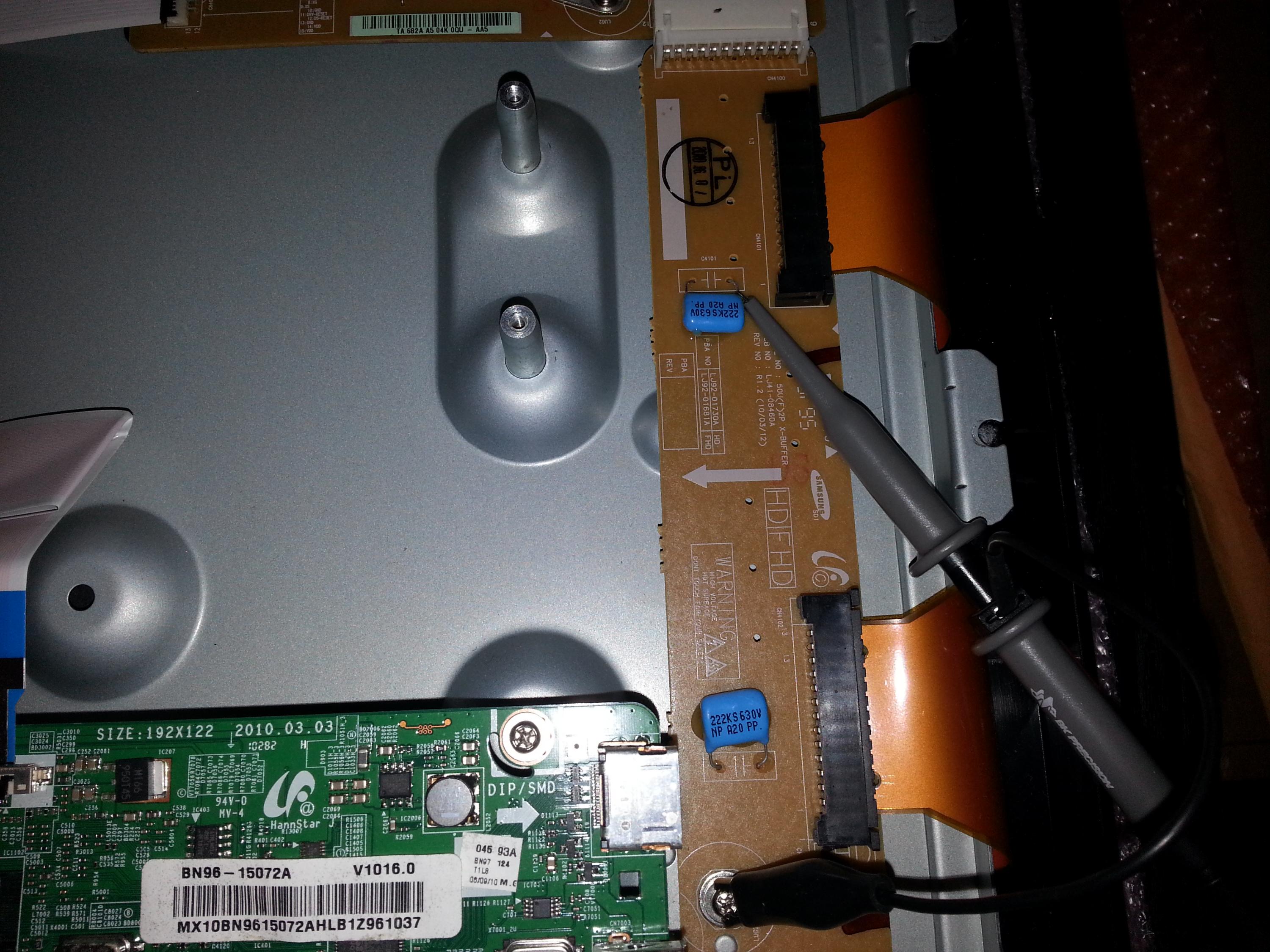

                #87

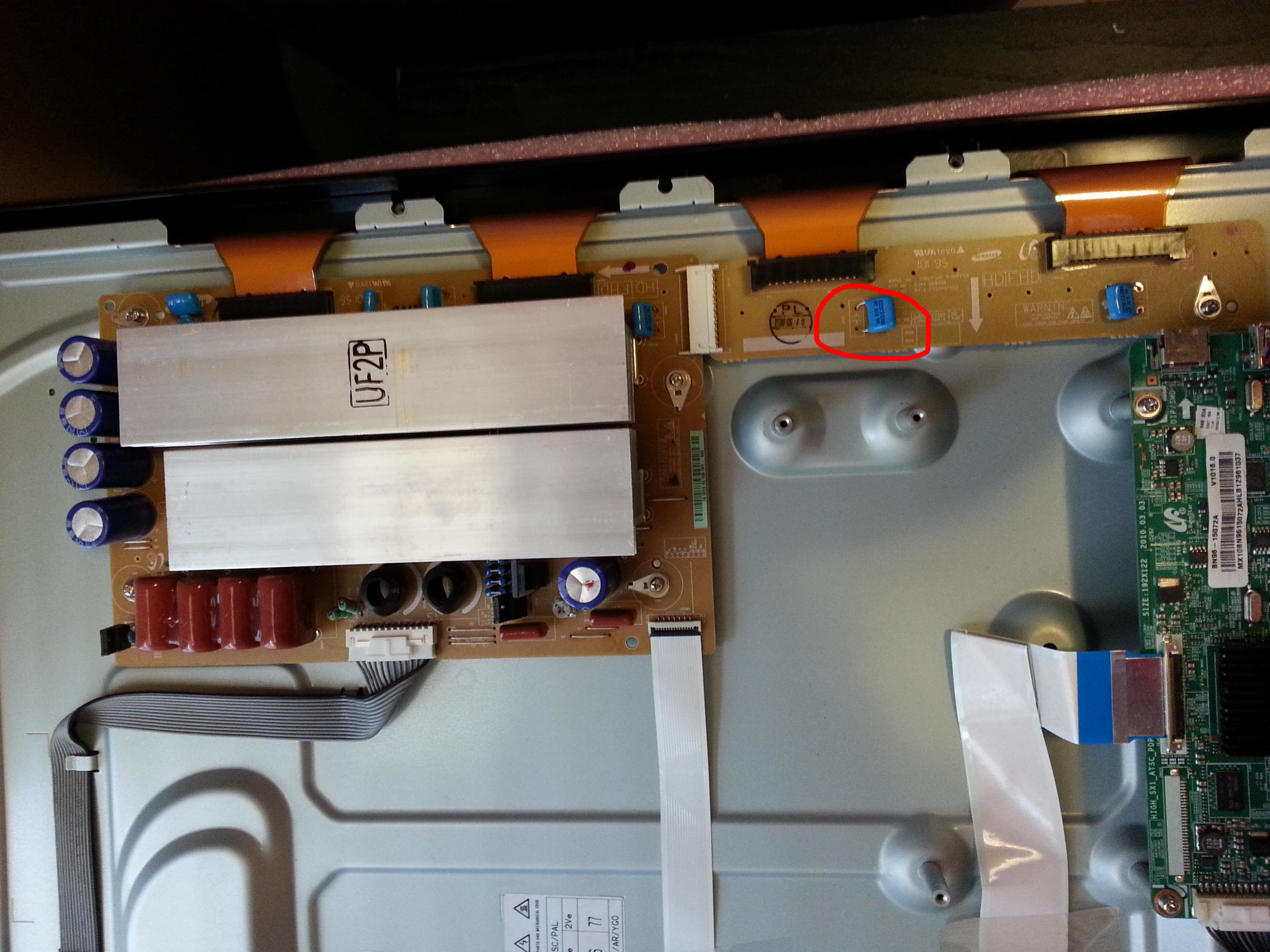

                how do i test the xmain?
                  #88
                  Here -- I think end nearest the connector.

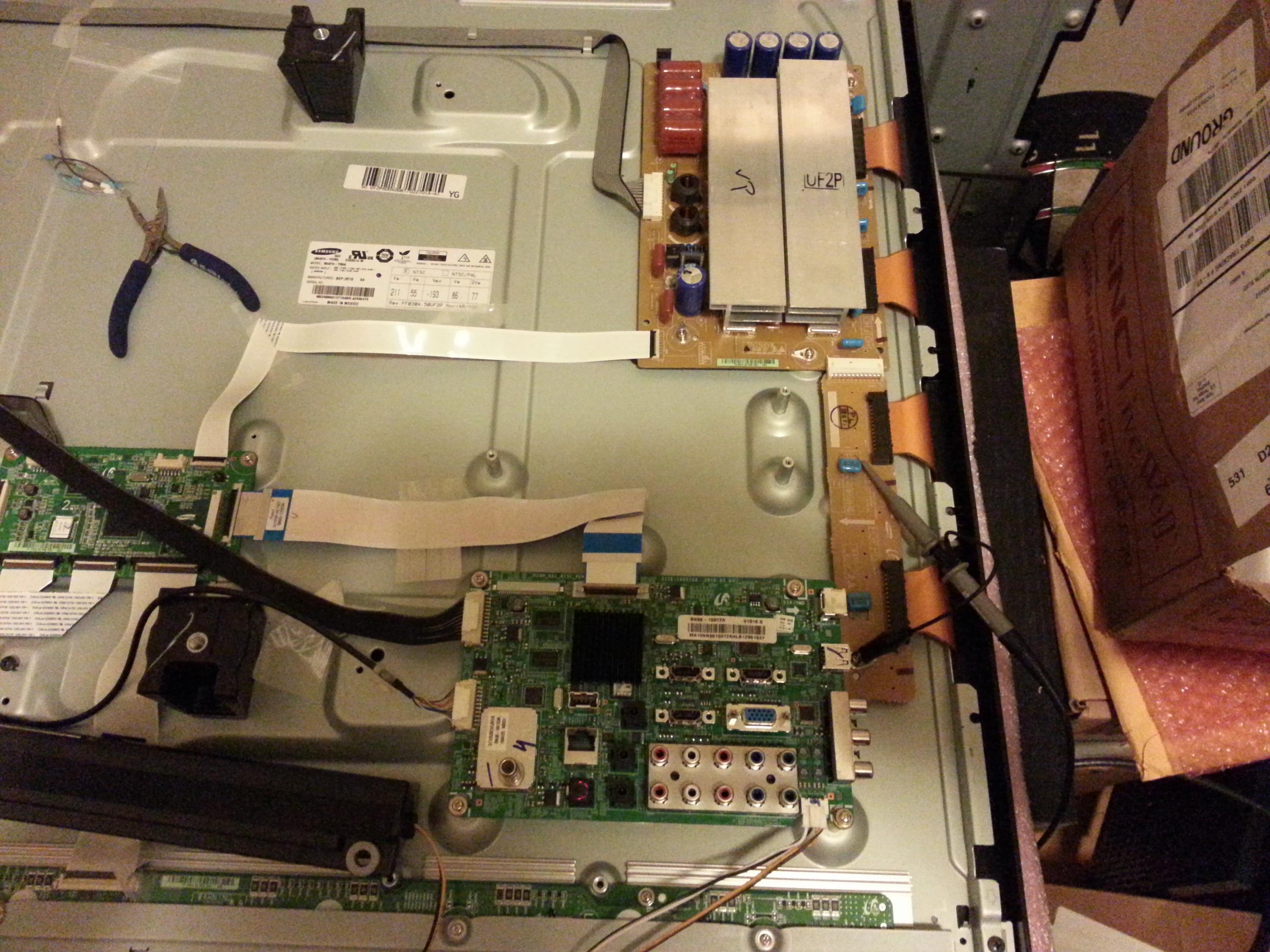

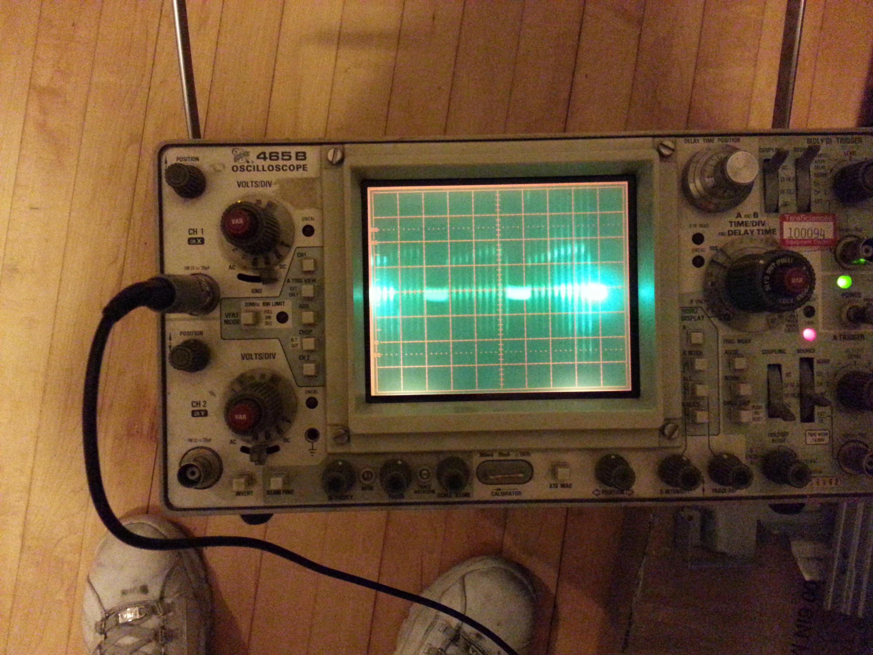

                      #90
                      Hey tom I want to give it another shot at this problem child of a tv lol
                      I put the test lead on the xmain and this is what I got

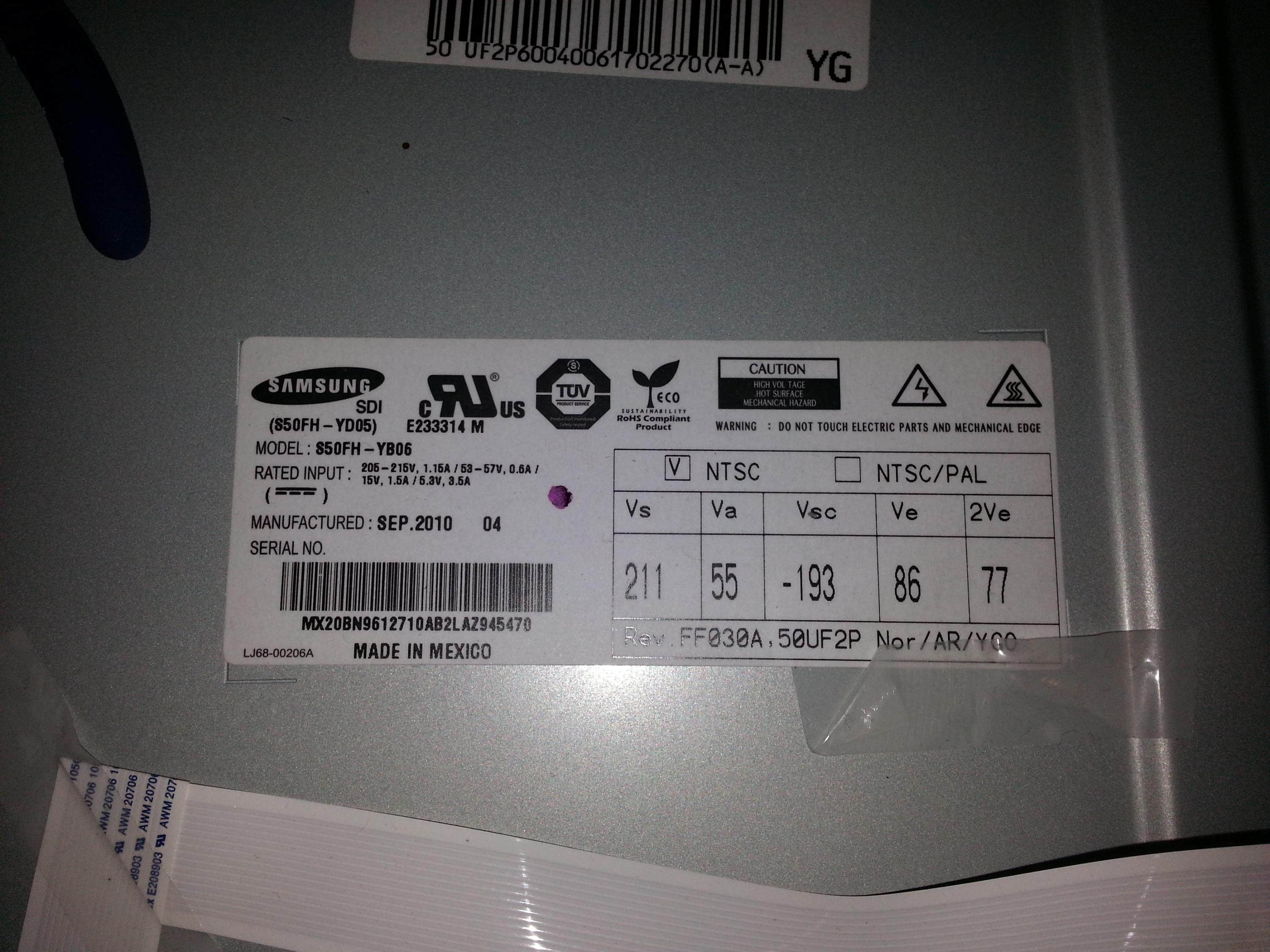

                        #91
                        I don't want to derail you from your testing, but can you post the current panel voltage readings?

                          #92
                          Vs 205.1
                          Va 54.1
                          Vsc -195.2
                          Ve 72.5

                            #93
                            I haven't read the whole thread thoroughly, but the service tips point to a bad X-main (see page 3):
                            http://www.toms-service-manuals.com/...&Search=Submit
                            If Ve is low or missing and Vs is OK, the failure is with the X-Board since the Ve is generated by the X-Board from the Vs supplied by the SMPS. Please note in some rare cases the Ve may be generated by the Y-Board feed to the X-Board.)
                            I'd remove the X-main from the TV to see if you can locate a bad component. Check the heat sink components first. I'd be careful with this TV, since the Y-main and X-main are chained; you risk damaging your Y-main.
