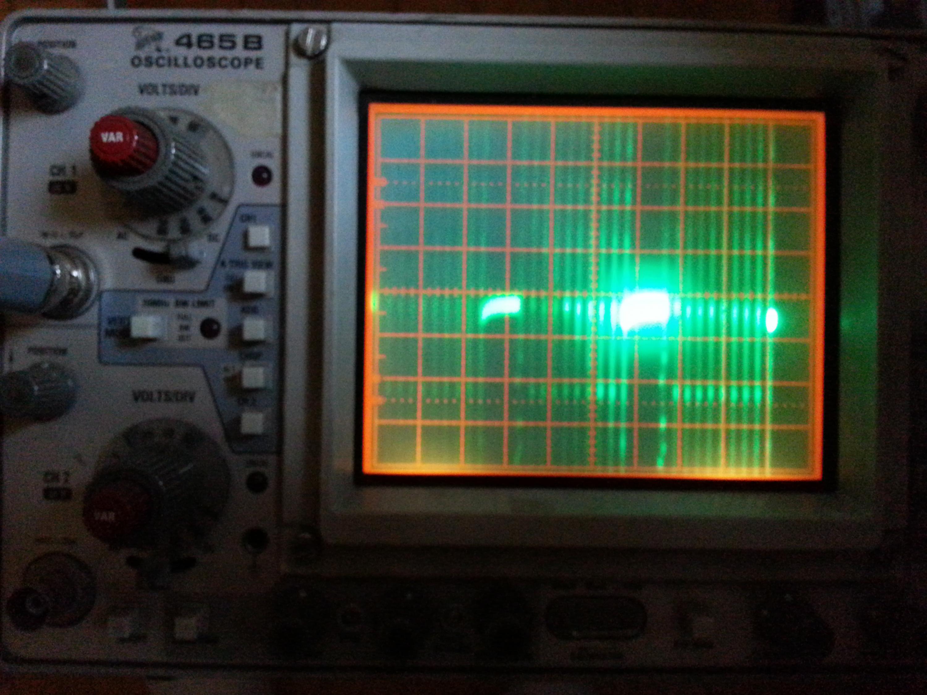

        So, you have low Ve on X-main?
        Do you have low -Vsc too?

          Originally posted by jose6326
          Vs 205.1
          Va 54.1
          Vsc -195.2
          Ve 72.5
          Please see above
            #105
            Re: no picture on my samsung 50 inch plasma
            Ve is a little low... but not a big deal, it's usually got approx +/-20V tolerance on these panels.

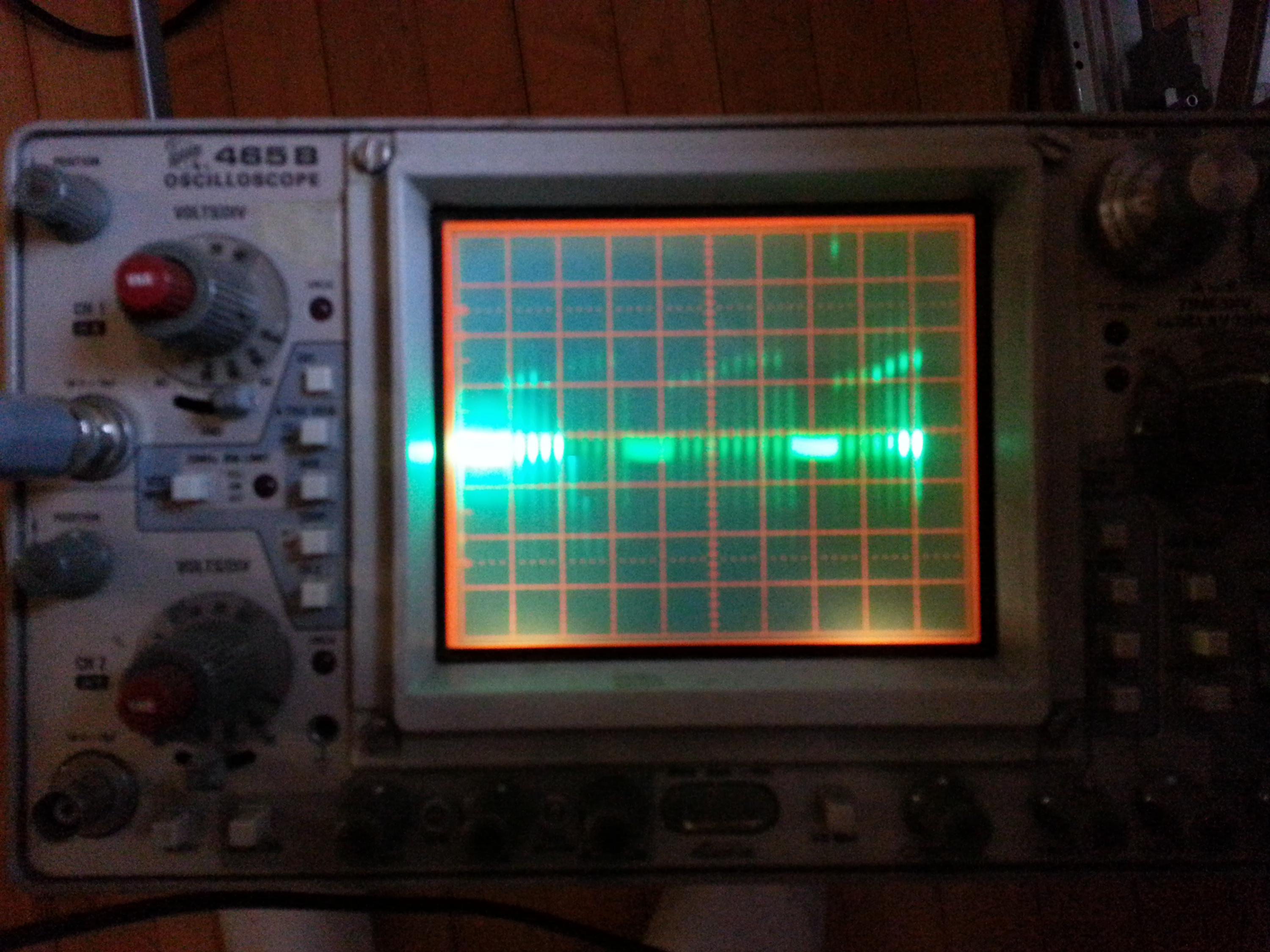

              Did you see the waveform I posted for xmain?
              Should I order the main board or what else should I test?
                #107
                The X-main waveform looks better than the Y-main.
                  I will retest ymain and post pics of waveform

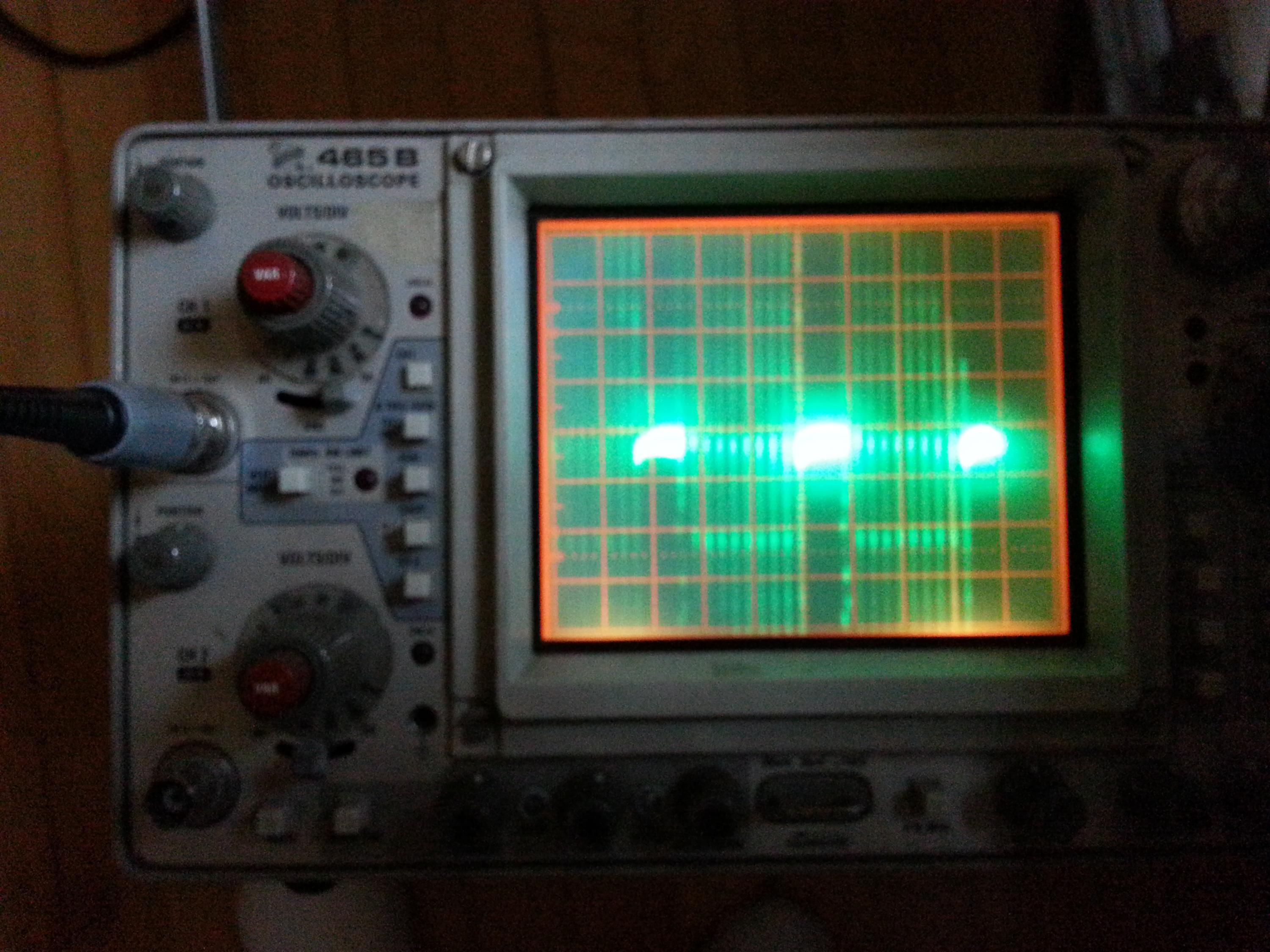

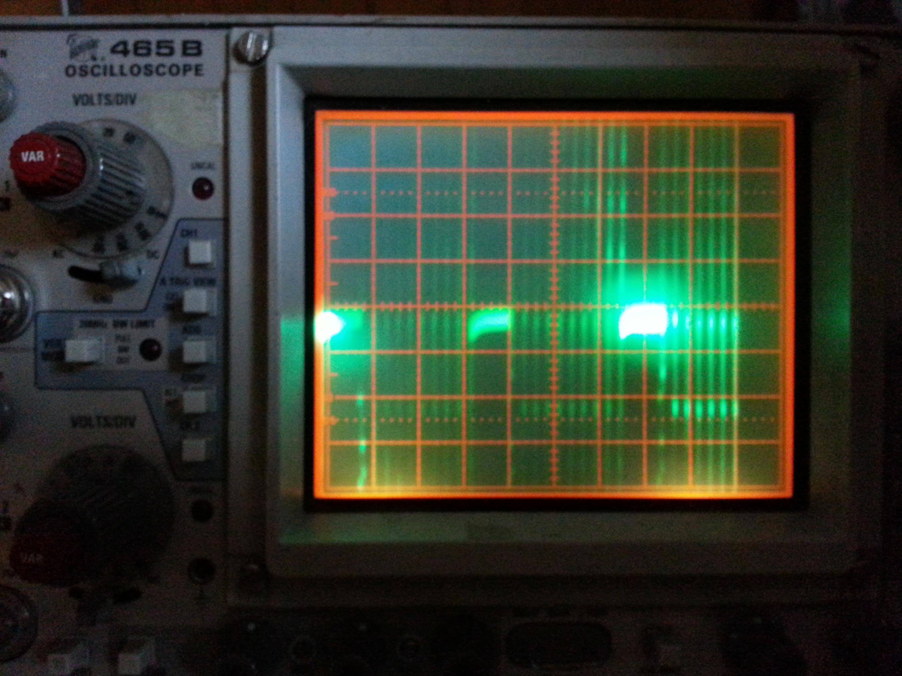

                    Ok tom I retested but I did 2 things which I will mske 2 separate posts
                    1st I put back in the original xmain and xbuffer to see if the wave pattern changed
                    To me it pretty much looks the same
                    But the Ve us a little bit higher but not much
                    Ve: 73.4v

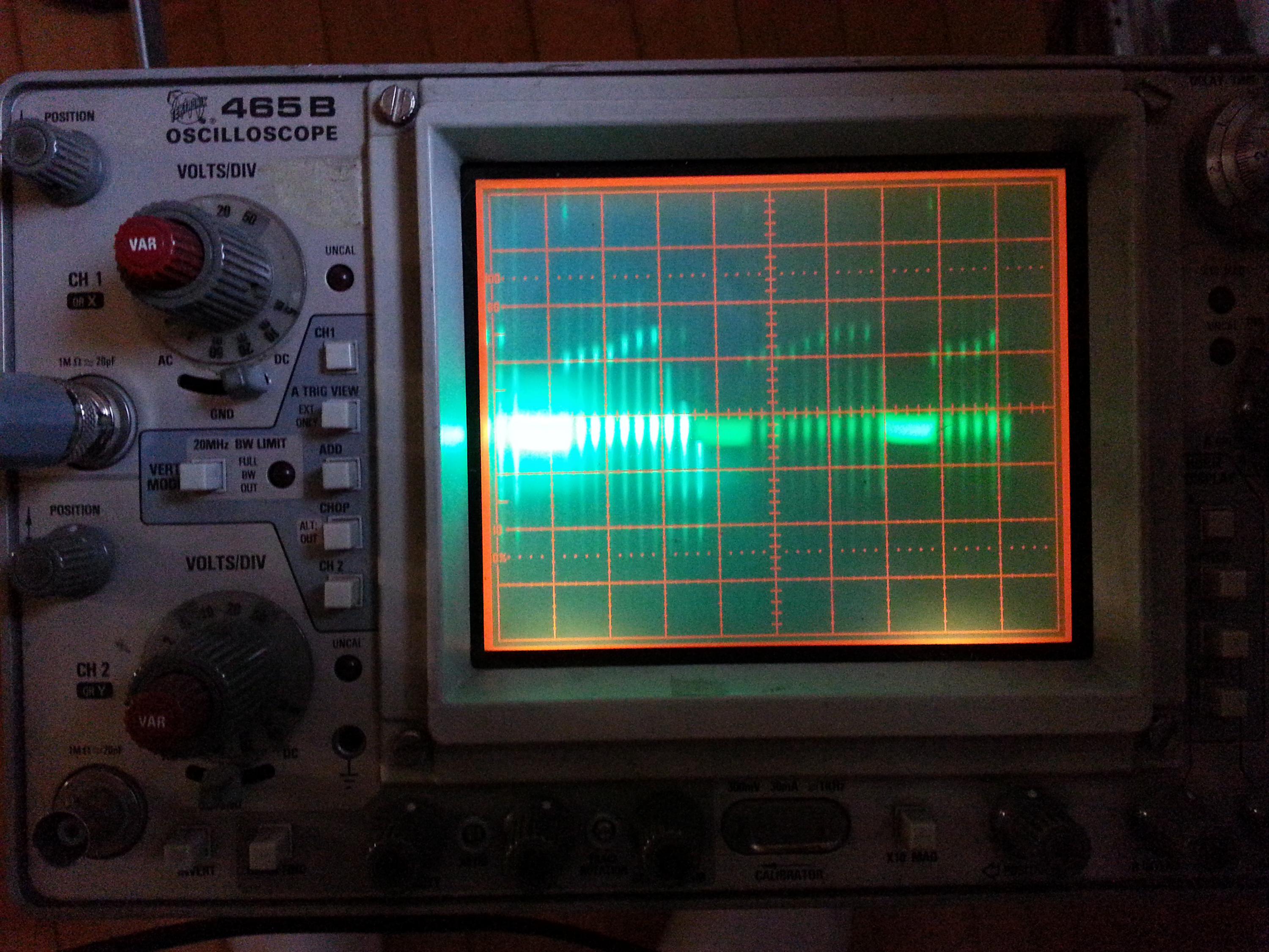

                      #110
                      2nd I retested the ymain
                      Any other suggestions?
                        #111
                        Were the both at the same V/div?

                          #112
                          yes i didnt change any settings
                            #113
                            Can you try dropping the intensity and changing the focus to make the trace sharper? I can see most of both sustain waveforms so it should be working, not sure why it is not.
